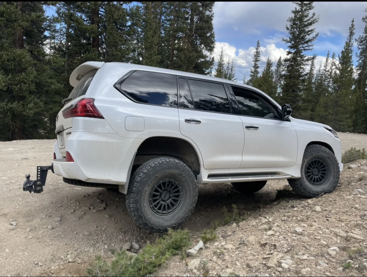

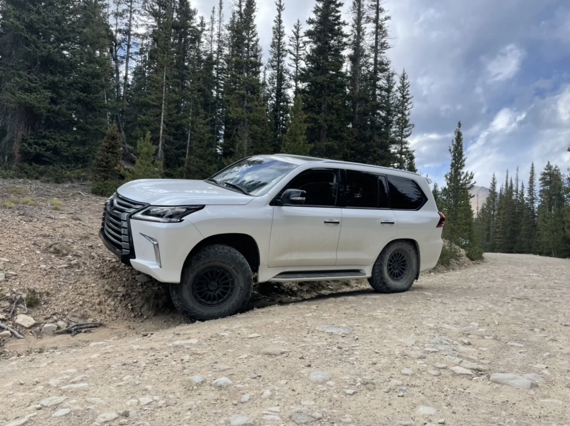

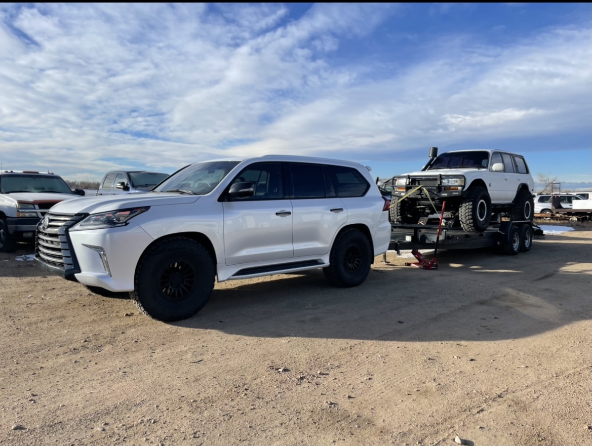

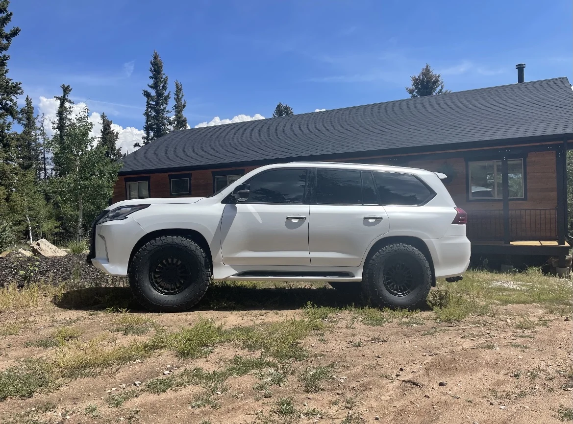

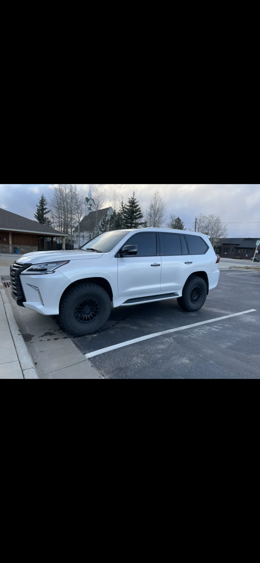

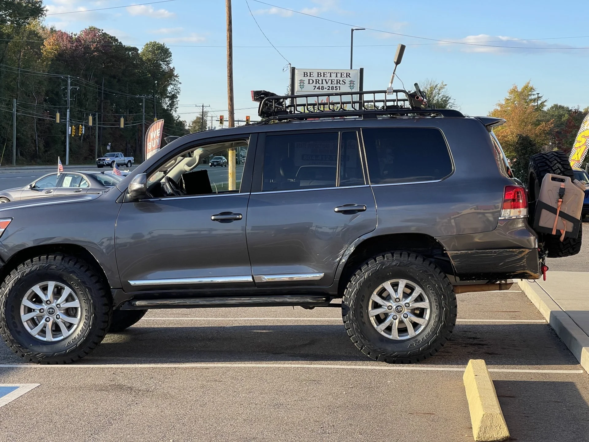

I guess I failed to mention I’ve been running 37’s since August. I hit cattle grates on my drive home on gravel at 70+mph that will fully bottom out most any suspension. Rides much better than stock. No fender cutting. I did however dremel/grind a very small amount from the inner pinch weld on the 10-2oclock position on the rear fenders before mounting them cause I got scared. Wish I wouldnt have.
I do have a slight rub on the front sway bar at full lock sometimes. Bothers me 0%. Bottom pic is in high mode.
View attachment 3320832View attachment 3320833View attachment 3320834View attachment 3320835View attachment 3320836
yup, I recall your posts before! I just have trouble understanding how you’re clearing the fenders, pinch weld, etc, at full bump/lock when everyone else has had to cut significant sheet metal. I was hitting the washer reservoir before I was at full bump. I’d love to see a picture of you on bump stops for no other reason than to understand what I did wrong. It would be sweet if folks could fit 37s without any cutting!

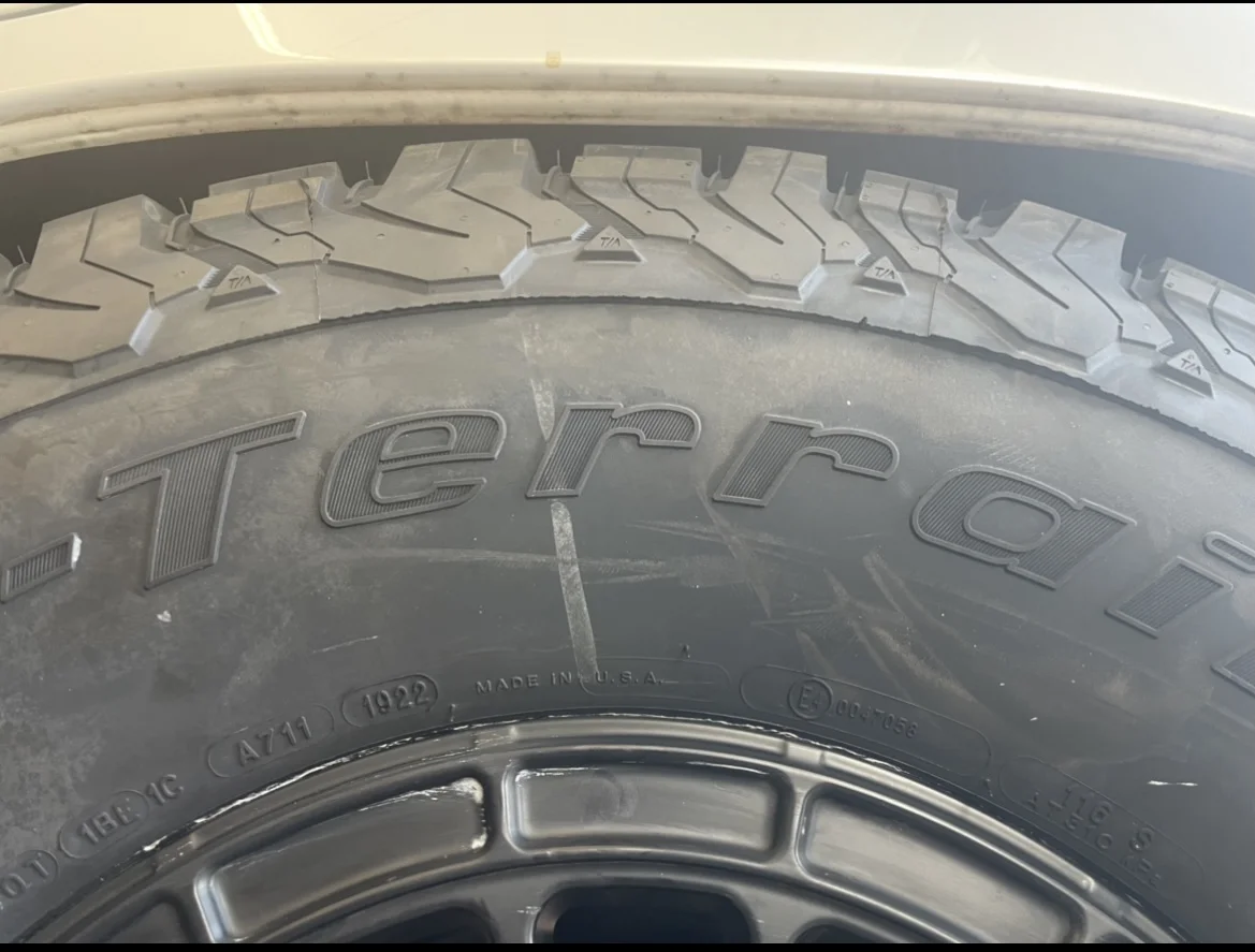

Would also be curious how close to 37" those KO2s are

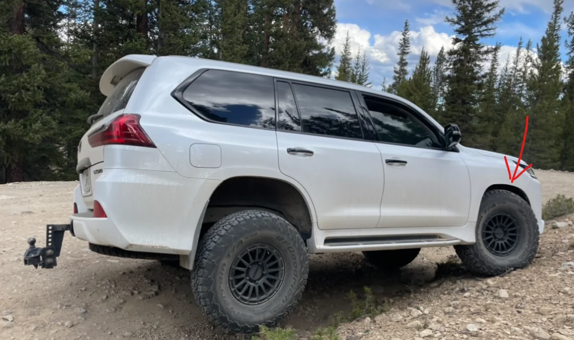

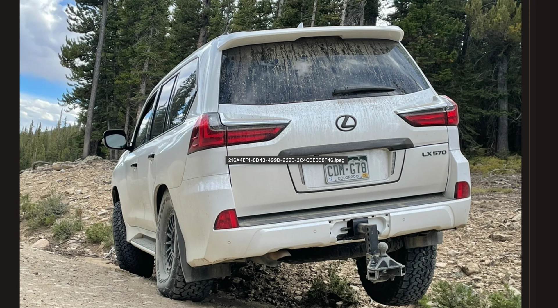

My concern would be up front. Unless you're hitting the bump stops in this photo, if you took this at speed and compressed the spring further you're going to smash up that fender. I've seen photos of that happening and it ain't pretty.
For me the rears are always a concern of mine as well since when towing I've had whoops and bumps on the highway which can hit the bump stops in the rear, so the rears have to tuck in or else have the bump stops extended, but right now my offset and wheel fits fine so if I could find a 37x11.5 that wouldn't be a concern. But mainly for me it's the front fender and then the whole KDSS thing...
Edit: this is the clearance issue that I'm worried about:

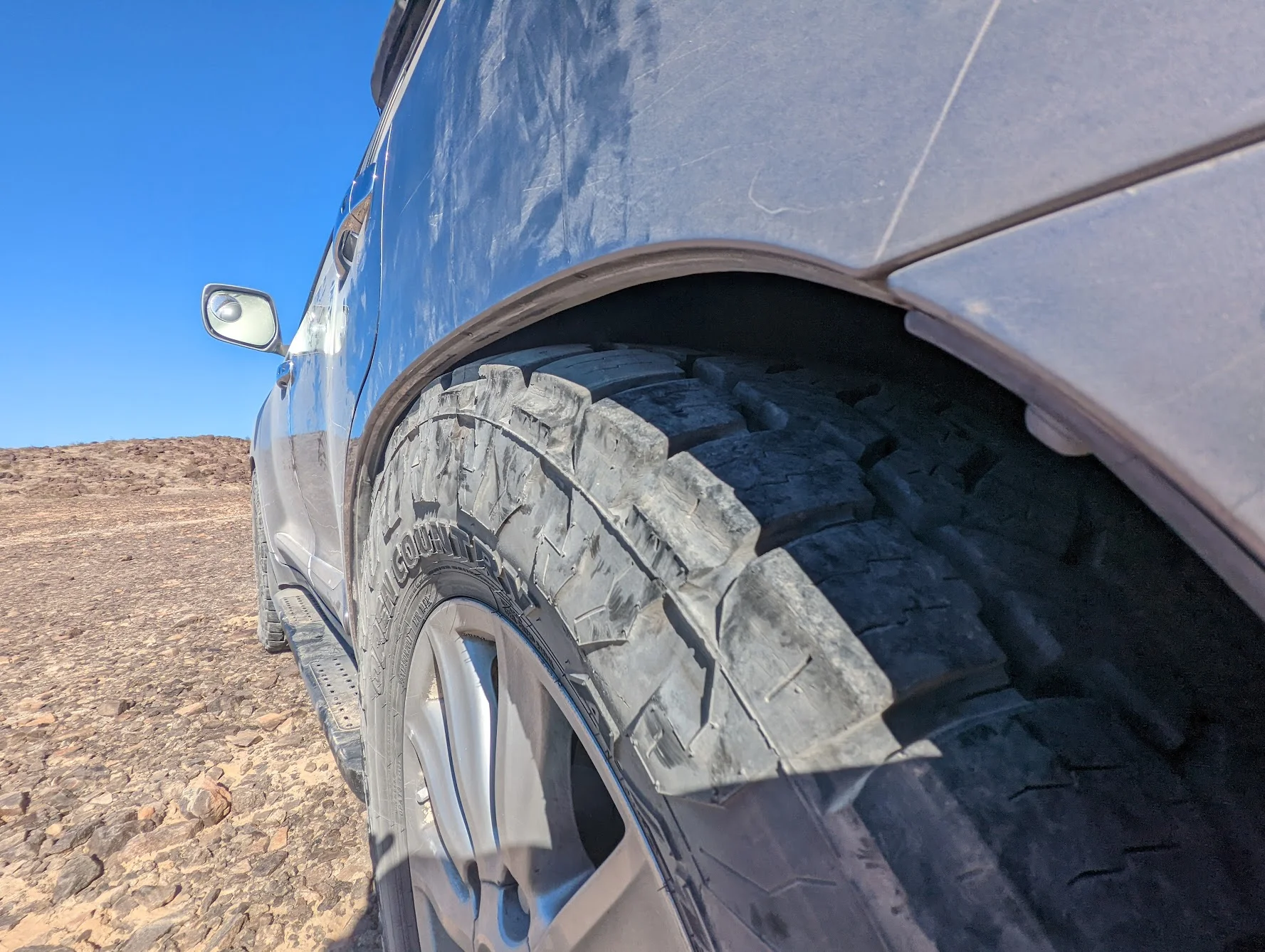

A couple data points of what +35 offset with a 35x12.5" tire looks like in worst case clearance. A 37x12.5 will need another 1" clearance in radius.
Front:
The tire will easily go 1-2" into the front fender without much bump limiting. Here's an example where I have it dumped for camping, and it probably still has another .5" of travel. Then consider that in a dynamic g-out, that the body mounts will compress bringing the body closer still.
Rear
Often rear clearance may look okay in an articulated situation. To your point, when it's a squared up compression, the rear tire will eat the metal fender. I'm just kissing mine enough that I rolled the fender.

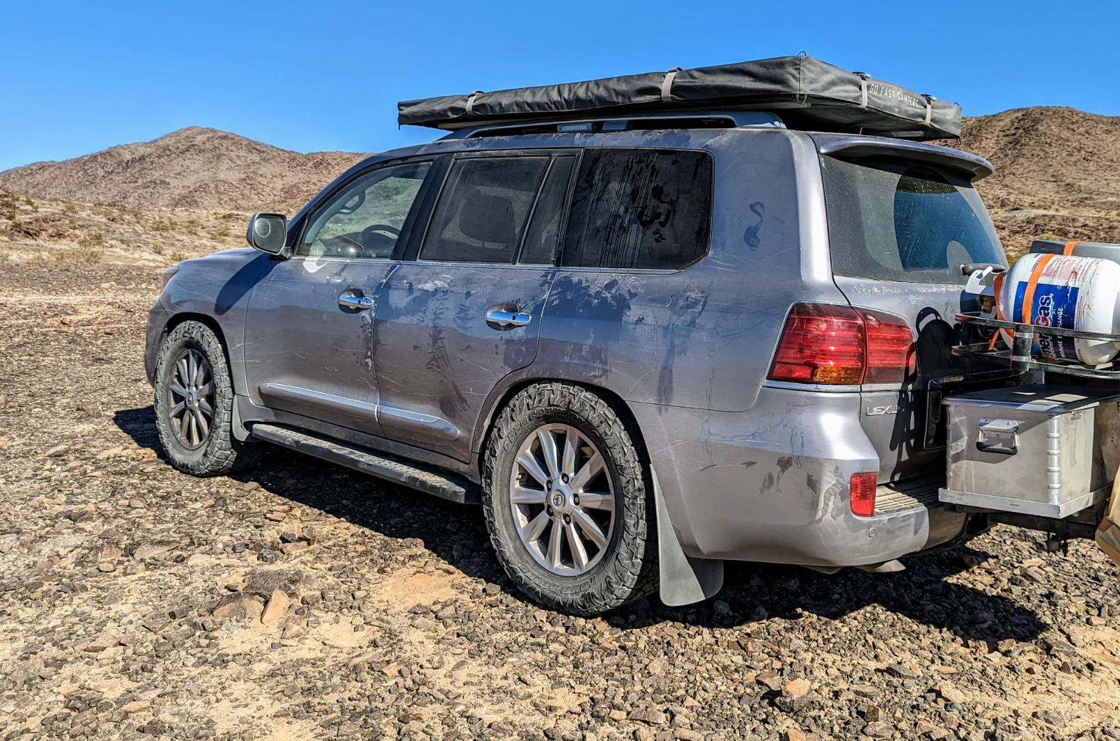

That’s awesome! I wasn’t even able to keep my mud flaps for the rear yet yours are still intact. Are you running a skinnier 37? Or is it 37x12.5?

Yes, they are 37x12.50 KO2 which measure 36.5" tall so a tad shorter than others that may measure 36.7" or 36.8" I have always thought Goodyear MTR's run quite a bit larger.

Yes, I still have my rear fender mud flaps although it does rub on them from visual inspection.

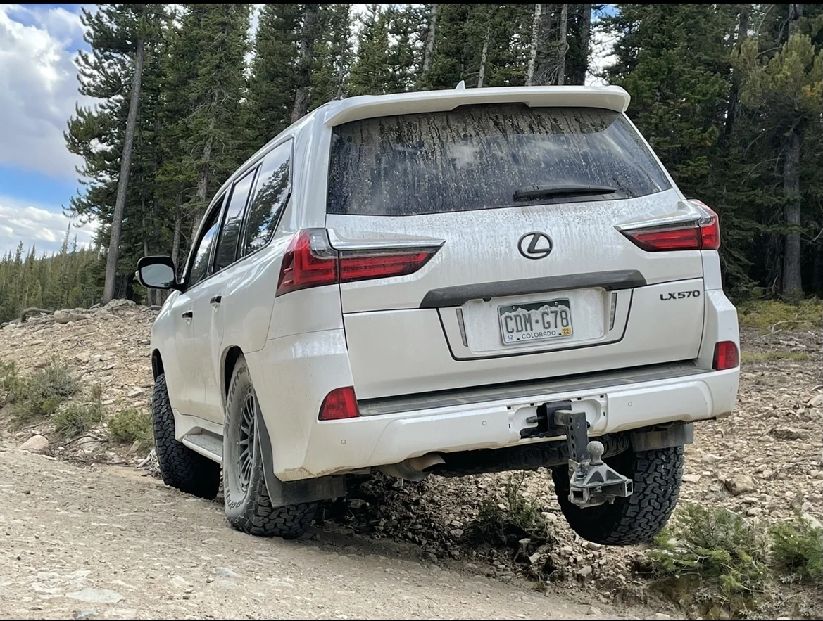

Here is a photo of how the 37s sit in the rear wells on low. This was at the tire shop the first time I tried to mount them and needed to chop more from the front BM. Also why I decided to dremel/grind some of the pinch weld.
