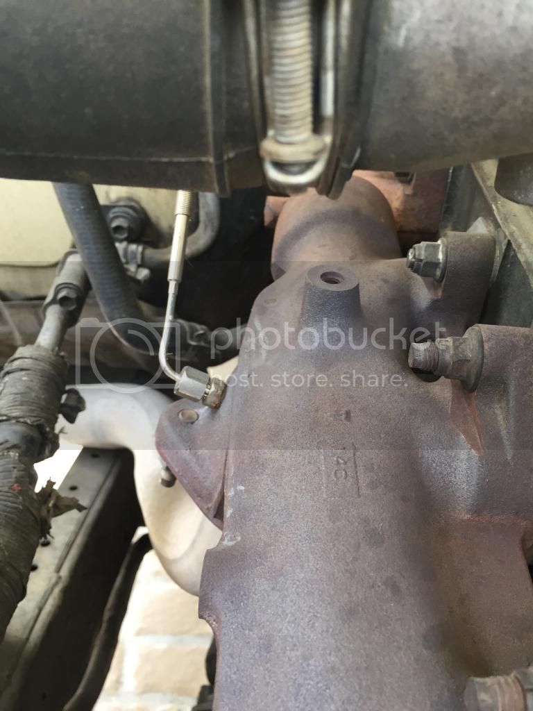

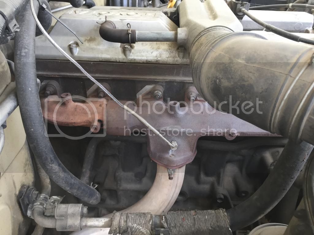

Just had a pyrometer installed. Was walking around the junkyard a couple of months ago looking for a 1HZ for another project when I noticed a whole bunch of them had cracked exhaust manifolds. In fact my 80 had a cracked manifold and the PO had it welded over. I ended up replacing it altogether. Guys here tend to push their diesels hard like they're driving a petrol engined truck, without thinking about the consequences of EGTs. I don't want to be that guy.
So the pyro is a great way to keep the temps in check.

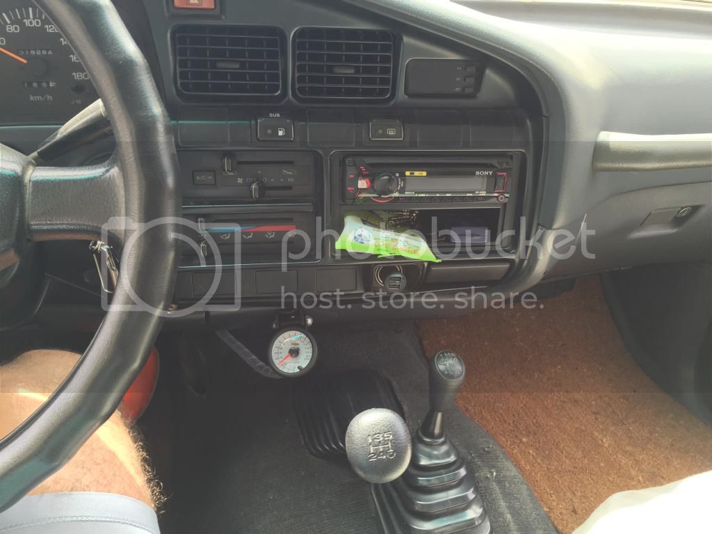

Gauge location.
I was actually amazed at how quickly it responds under acceleration. Temps go right up to 900-950F when I'm pulling away hard in 3rd on a flat surface, before dropping down to around 500 as soon as I change into 4th. The speed the temp dial moves is just as fast as the tacho dial! I also shudder to think what the temps were when I last did a trip up mountain pass to 7000ft!

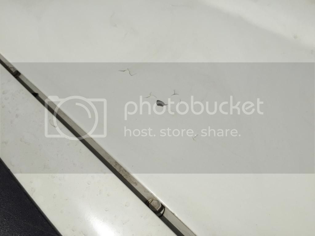

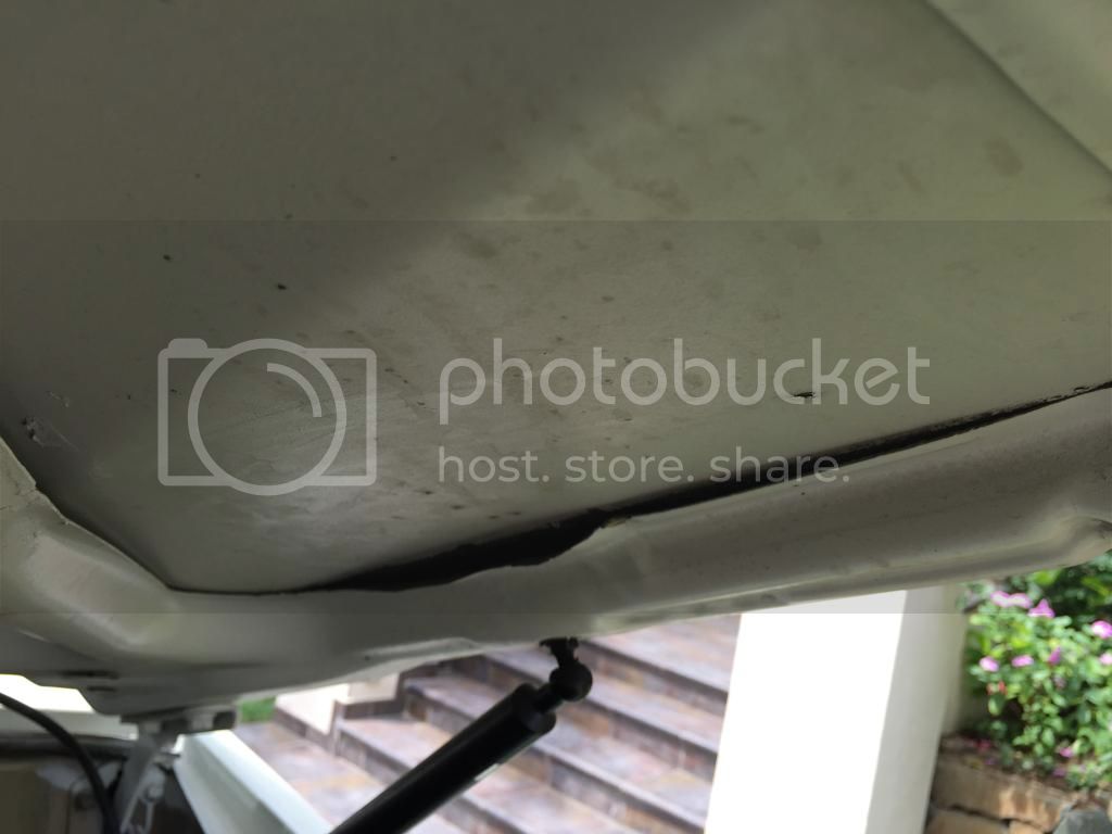

Next up was I installed some bonnet struts. Later model 80s, or perhaps only the VX versions got the bonnet struts. But on all the bonnets the bolt holes are already in place. So I ordered a set from the local dealer and put them on. After a couple of weeks driving, I noticed the paint on my bonnet surface directly above where the struts are bolted on from underneath, started peeling.

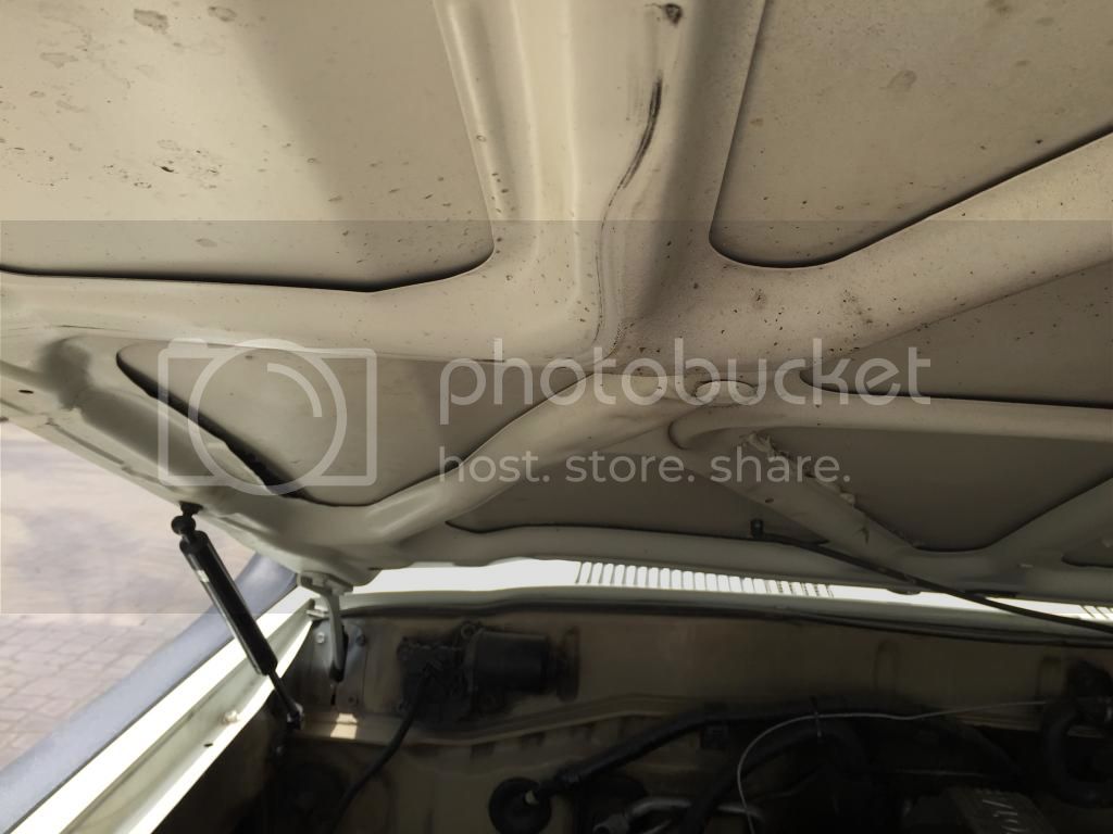

So had a look under the hood
It seems the strength of the struts is folding away the sheet metal. Would a little tack weld keep that in place and stop it bending further?
I checked my mates VX-R which originally had struts from the factory and there seems to be no additional bracing or reinforcement around that area to suggest its susceptible to happening. Both my struts and his are the same part numbers.
The paint peeling may just be coincidence. The struts are attached to the hood bonnet brace, so it shouldn't cause much if any defelection in the actual bonnet sheet metal. Even if it did cause some deflection, the paint should be flexible enough to deal with it.
Did your truck originally have an insulator panel at the underside of the hood? Maybe the heat of your exhaust is helping the paint to degrade? With the EGT you describe, I'm surprised there isn't more shielding around the manifold as well.

Weird that you don't have a heat shield on your exhaust manifold. Did 1HZ not come with a heat shield?? You can probably pick one up from the Toyota store for not too much... it will probably help with paint condition under the hood. Being a G model, Toyota really didn't put any expense into the vehicle I'm sure.
No it did not come with any insulator panel under. I am not sure if it was remove by the PO, but being a G model I doubt they ever had them on. My concern is the bracing under has peeled away from the bonnet sheet metal, right where the strut is bolted.

As for the heat shield, I have been contemplating getting one, but kept forgetting. Thanks for reminding me!
