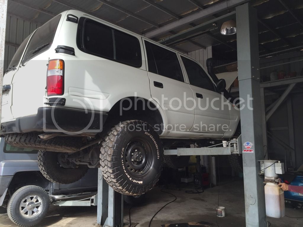

So took the 80 to a well known turbo specialist in Jeddah. He's done hundreds of installs, as well as major engine swaps, (he just completed a LS1 swap into my cousins FJ45 pickup). He's been doing this for over a decade, but has zero diesel experience. I had sourced a Safari kit, and away we went.
The thing about the Safari kit is it comes complete with everything you need. I was worried about trying Gturbo or perhaps trying to source my own CT26 1HD-T kit, but did not want to go through the hassle of sourcing individual parts. The Safari's install instructions are also meticulously detailed, with pics of every step. So that was a major upside, given the lack of true diesel specialist here in Jeddah.

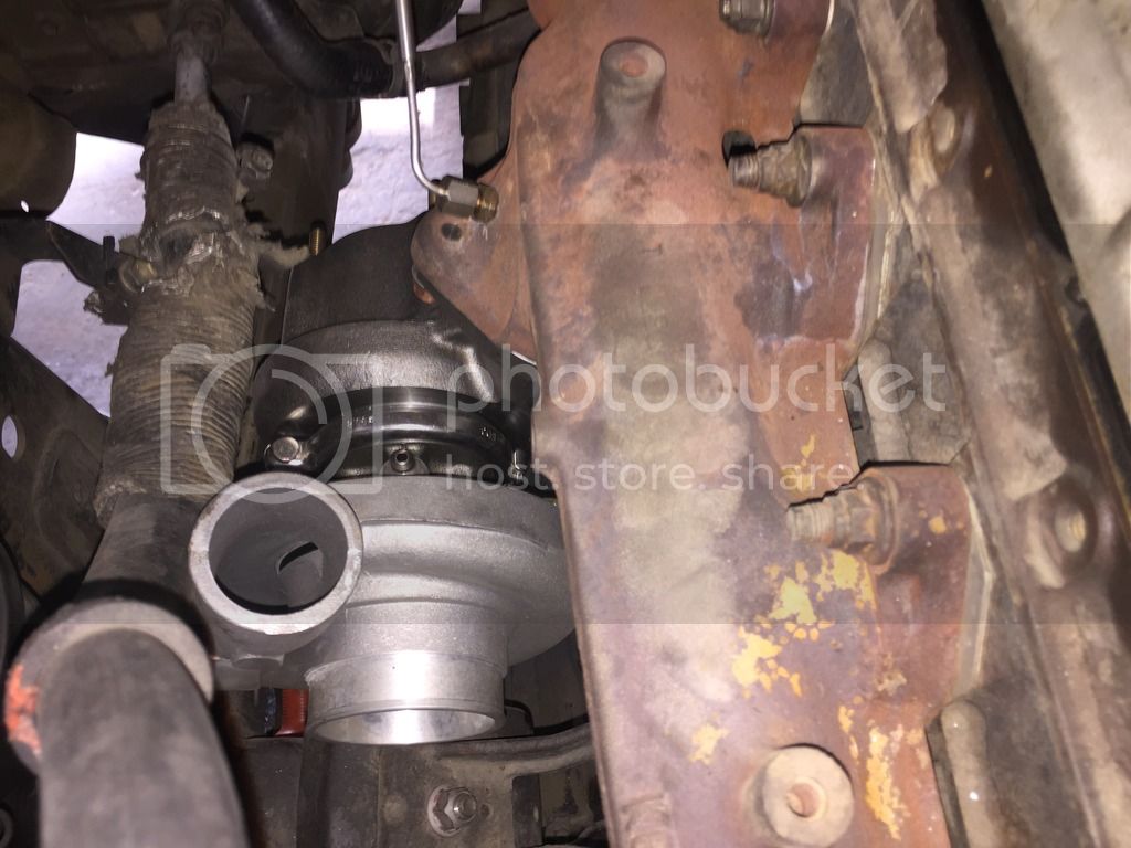

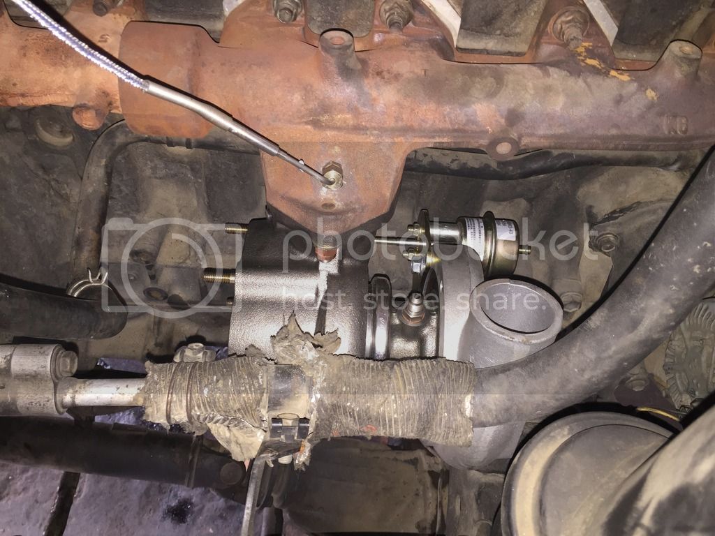

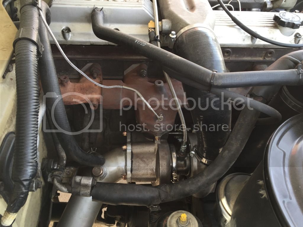

Here's the turbo on.

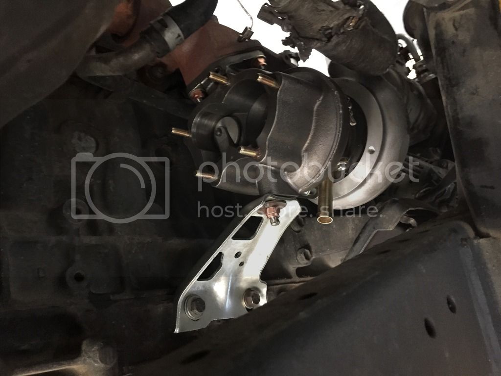

Test fitting the bracket.

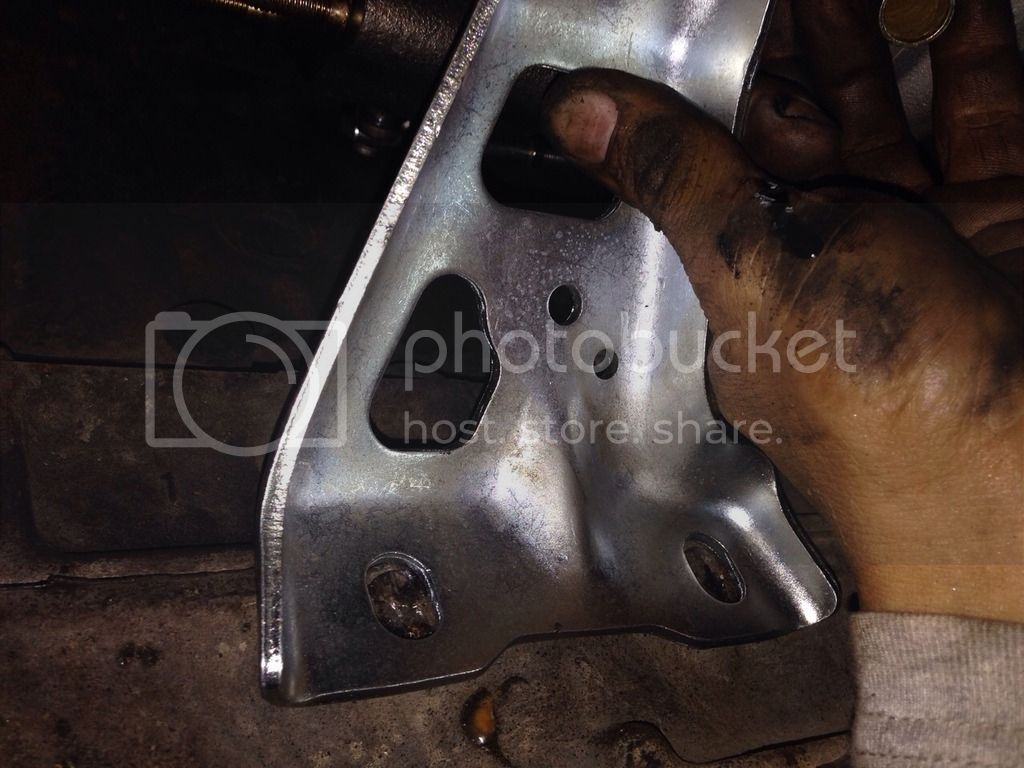

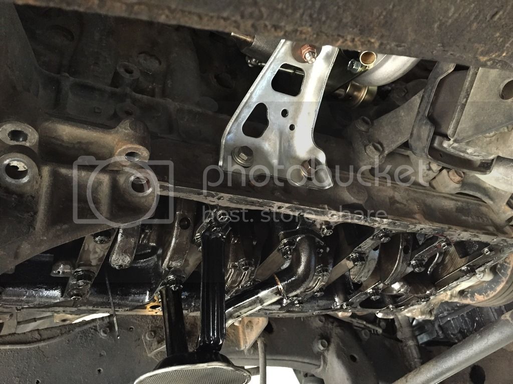

Apparently some 1HZ's come with holes already pre-drilled. Mine did not, so it called for drilling 2 M12 X 1.25 holes at 20mm depth.
Bracket mounted

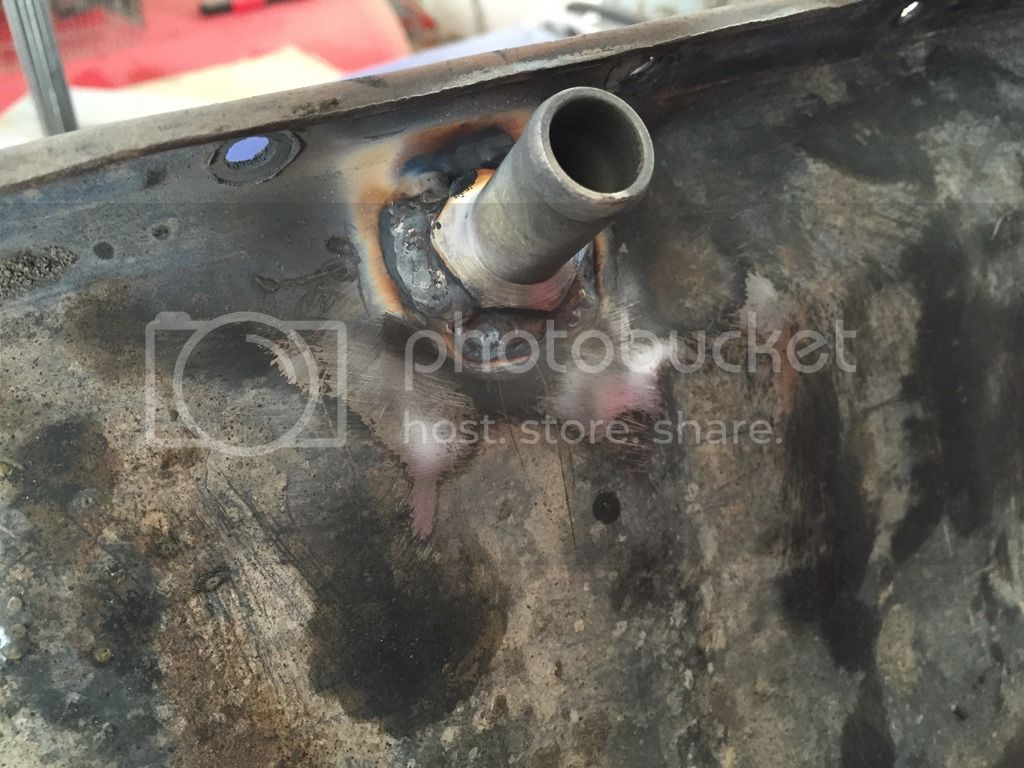

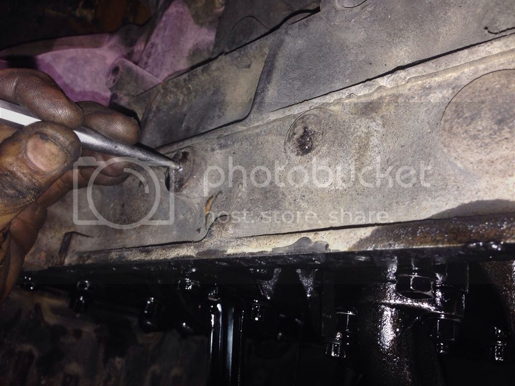

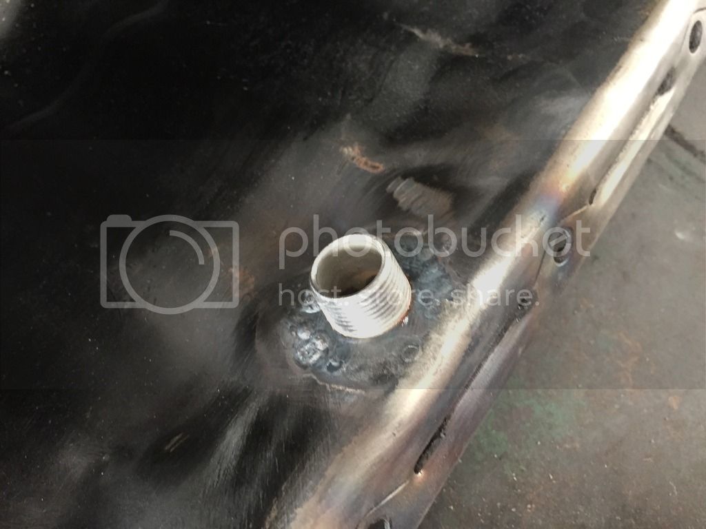

We also had the oil pan off so we could drill the oil return line. The install instructions give you two options for the return line. Either into the block, or through the oil pan. We punched a hole 20mm below the line where the oil pan bolts onto the block.
Inside the oil pan

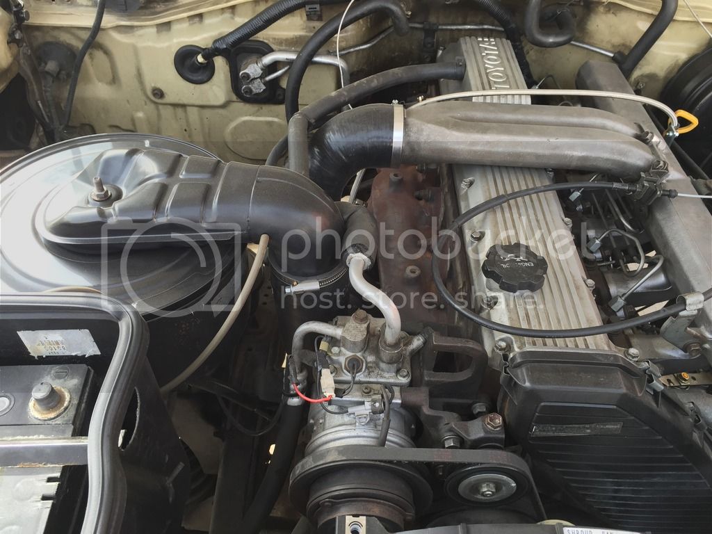

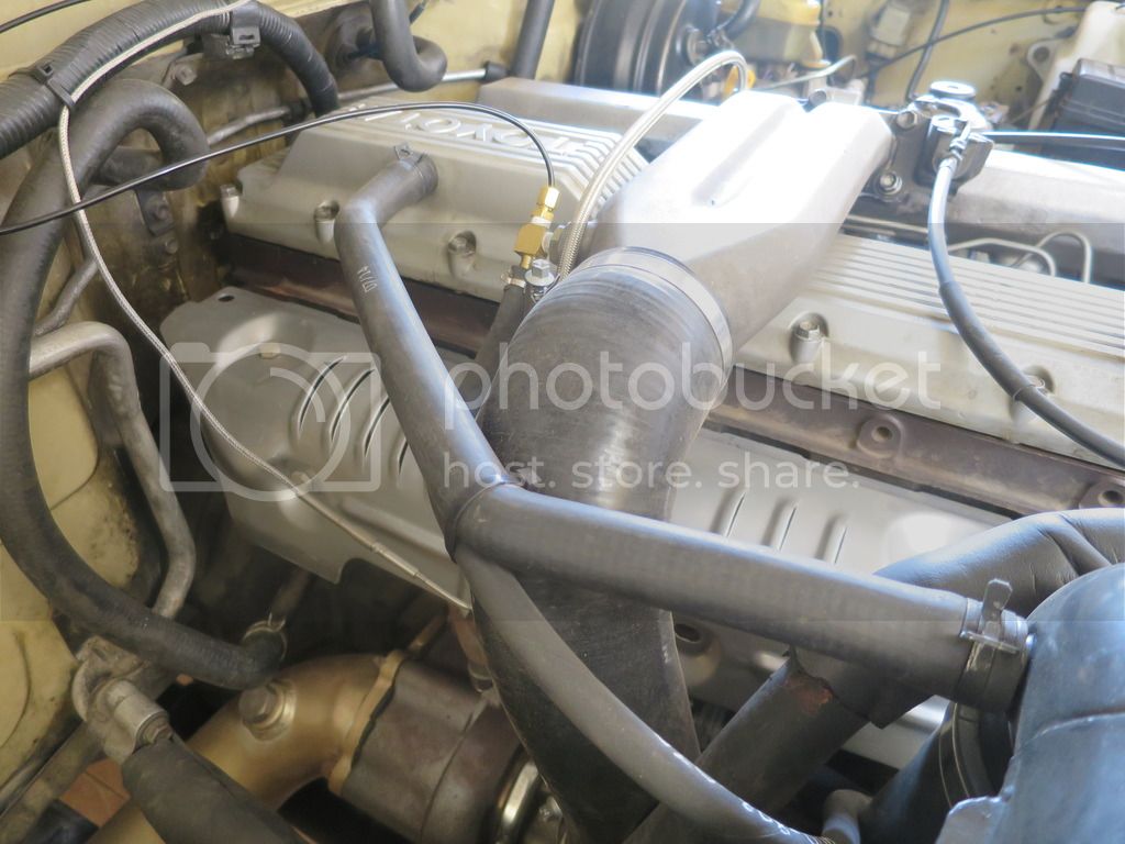

Connecting the intake, as well as the turbine outlet pipe. Oil feed line also routed over engine and into the top of the turbo. We also cleaned up the insulation on the AC line.
The Safari kit also includes the air box cover with the 90 degree elbow
A shot of the engine bay

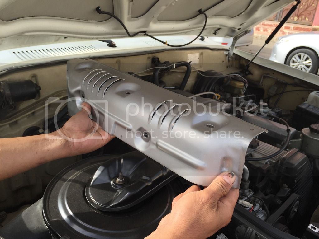

Forgot to mention I finally had the heat shield installed. Was sitting in the back seat and forgot about it

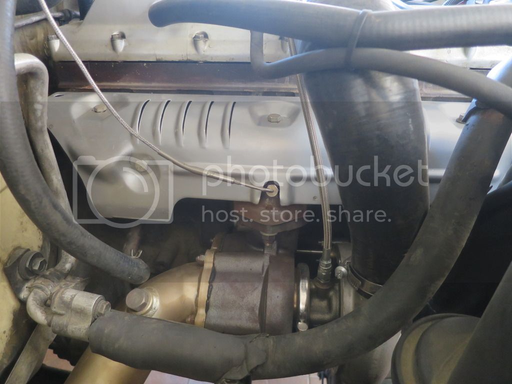

Cut an opening in the shield for the pyro probe

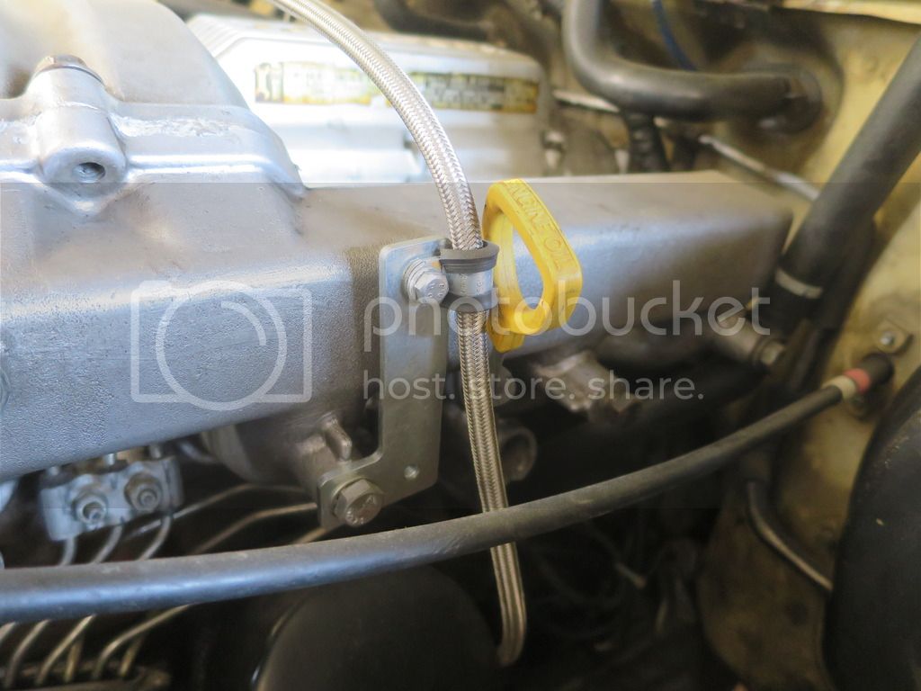

The kit even has all the little details covered, such as the bracket to hold the oil feed line

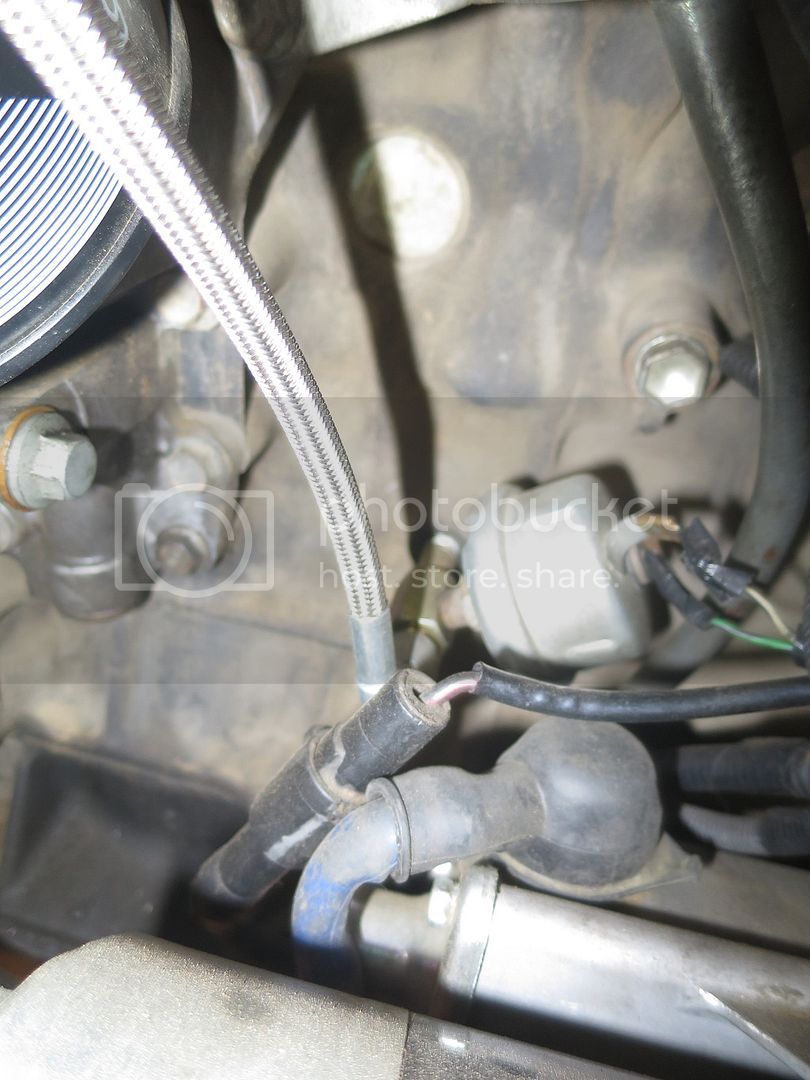

Oil pressure line.Kit comes with an adaptor to accommodate oil pressure sensor

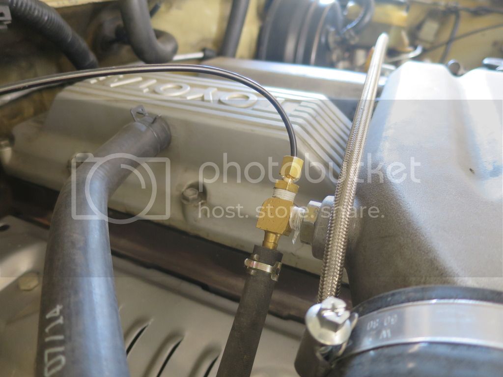

Two piece adaptor for waste gate actuator and boost pressure

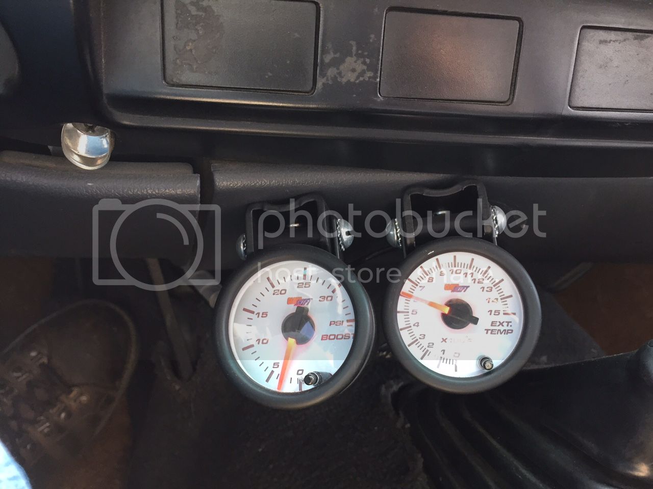

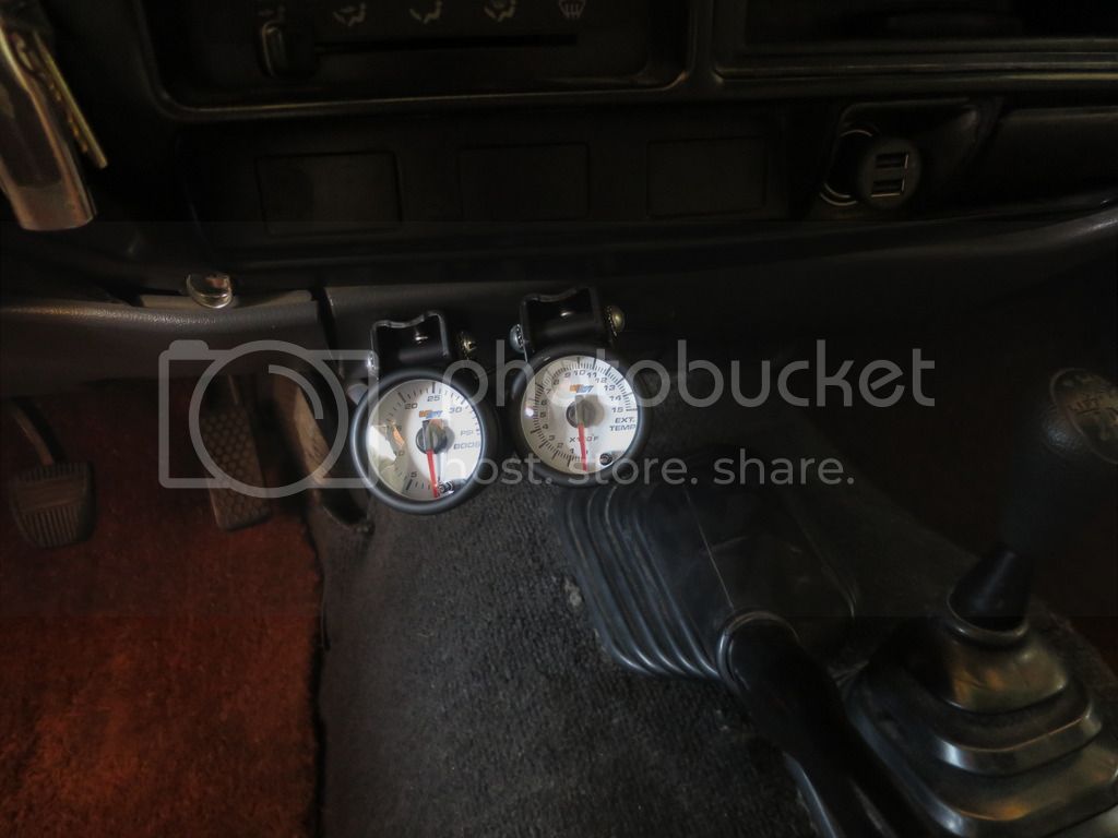

Boost gauge along with previously installed pyrometer

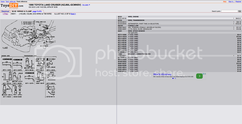

How'd you wind up completing the wiring from the IP for fuel cut/tach?
OE harness extension?
We just cleaned up that connector and plugged it right into the tacho pick up sensor. No extensions were used, as there was a bit of slack anyway.

Gotcha.
The wiring extension that was unplugged on yours, is what I need, but can't determine what it's coined, to figure out a part number.
The issue is on toydiy it shows the wiring as a complete harness, as if you can't get the individual wire for the tacho only.

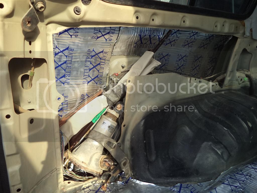

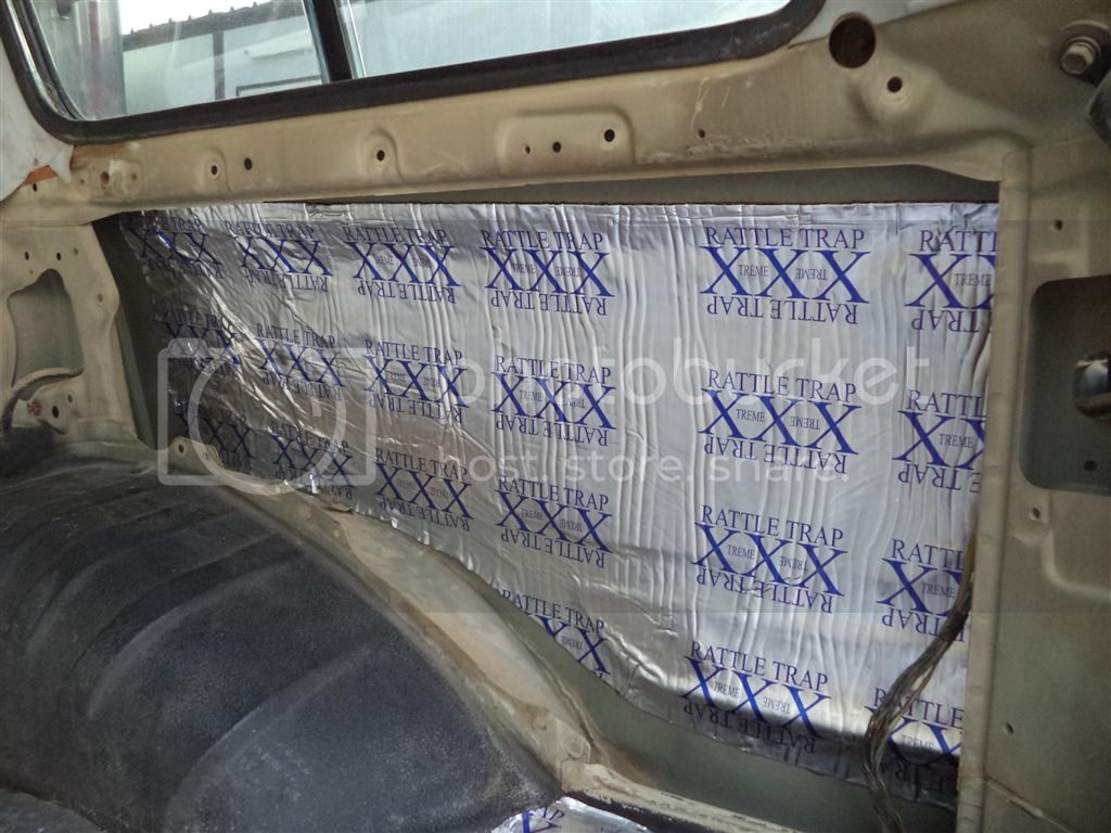

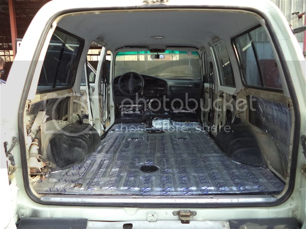

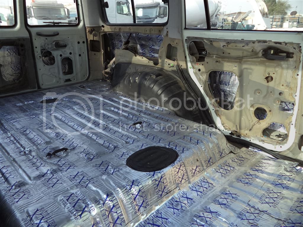

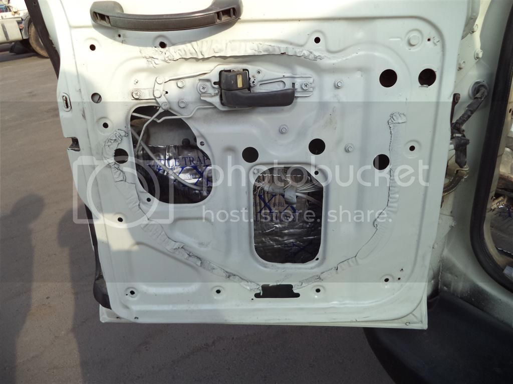

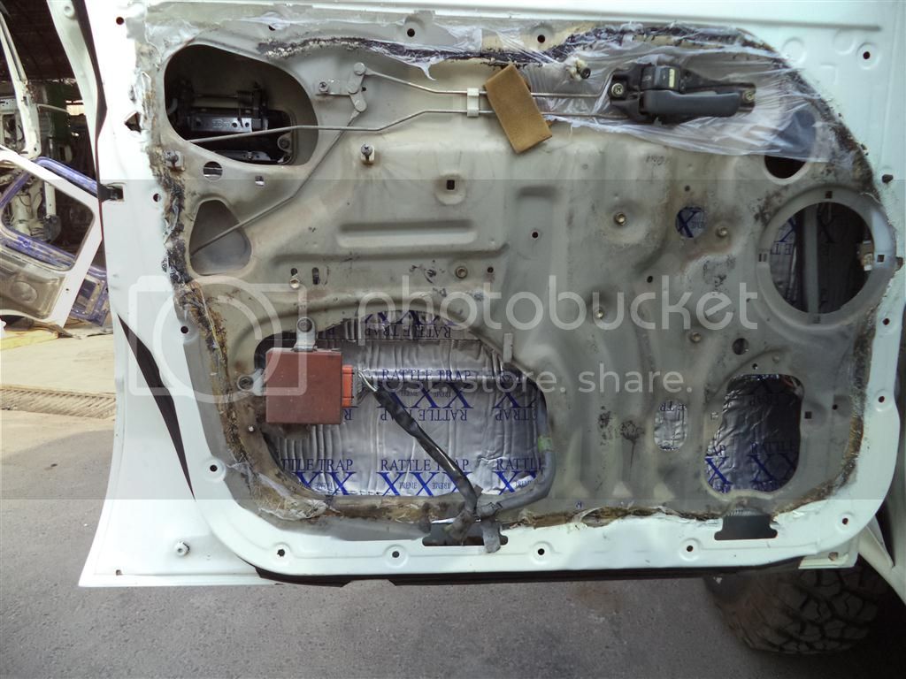

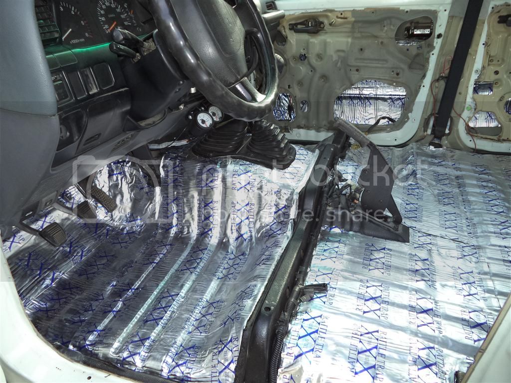

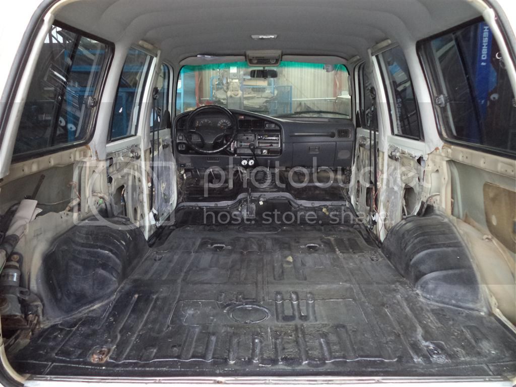

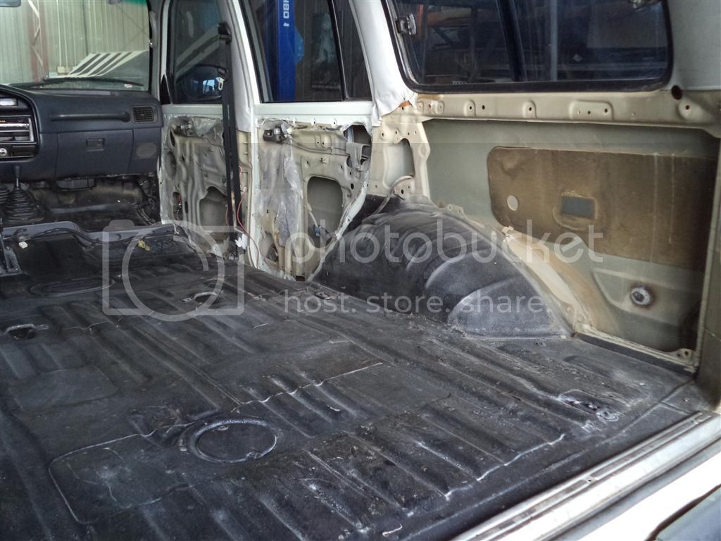

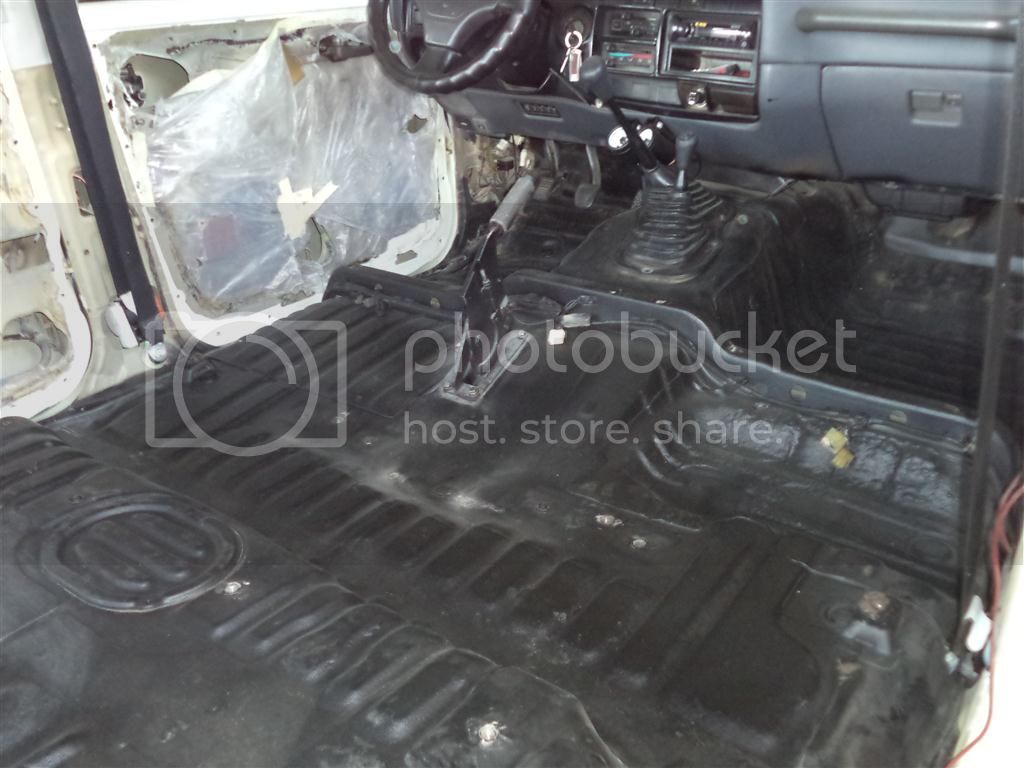

A small update. Ordered up some Fatmat sound deadening material and had that put in. Was a bit apprehensive as I've read around that the adhesive part of it sometimes tend to give off a strong odor thats difficult to get rid of. My uncle ripped out the sound deadener from his restored Jaguar as it was giving him headaches!
Thankfully, the stuff was a breeze to install, an gave off no smell at all. Its heavy as feck though!
Out came the seats and carpet

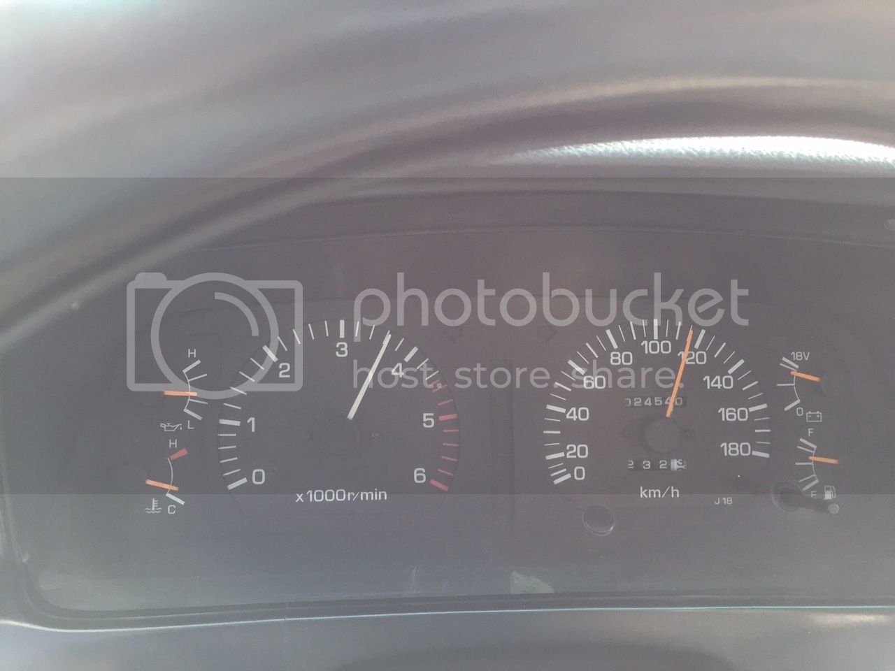

Went on a little 950km road trip yesterday to visit a customer. The 80, now running a turbo, was a pleasure to drive. Averaged 17mpg for the trip, most of it spent on the highway doing 115-120km/h, save for a mountain pass from sea level to +6,000ft. The drive up the pass was like a dream. Pre-turbo install I'd be struggling up in 3rd, EGT's shooting up, so would need to down shift to 2nd. Now, I'm pulling hard in 3rd doing 80 km/h keeping EGT's below 900F.
Highway cruising was at 115-120km/h, 3500rpm, 650EGT's, and running between 3-5psi boost
