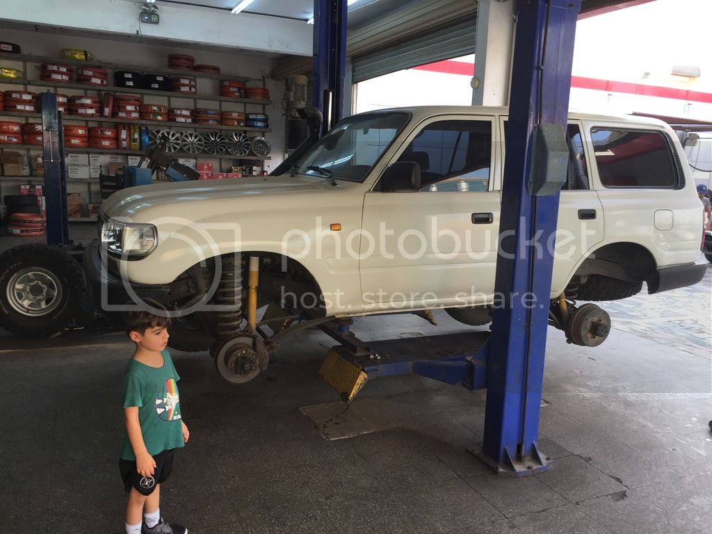

in the photo above, is the rocker panel supported by the wheel, looks like it has put a dent. does not look proper.
Well spotted. The dent was there from before, when I scrapped by a large rock attempting a water crossing. Check out post #50, where my buddy with the chest waders on is hooking up a tow strap. Thats the rock I hit. The wheel in the above pic was resting on the chassis rails. Not proper, but no one was injured and no damage was done to my 80:)

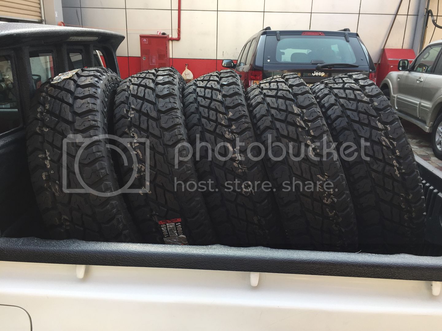

Put on nearly 40,000km on the KM2's, and as early as last Jan/Feb some dry rot started to appear, but I kept putting off getting them replaced. Finally, thought it would be about time to get some fresh rubber.
Decided to go the Cooper Discoverer ST Maxx route, after reading many reviews, and also wanting to try something different.
Got a set of 255/85/16, my favorite size.
Valves stems barely lasted 5000km as I had these new ones put on recently.
First impressions are the tire is already much quieter and smoother than the KM2's. I am very much liking them. They also seem to have a somewhat wider profile than the KM2's, but steering remains just as nimble.
