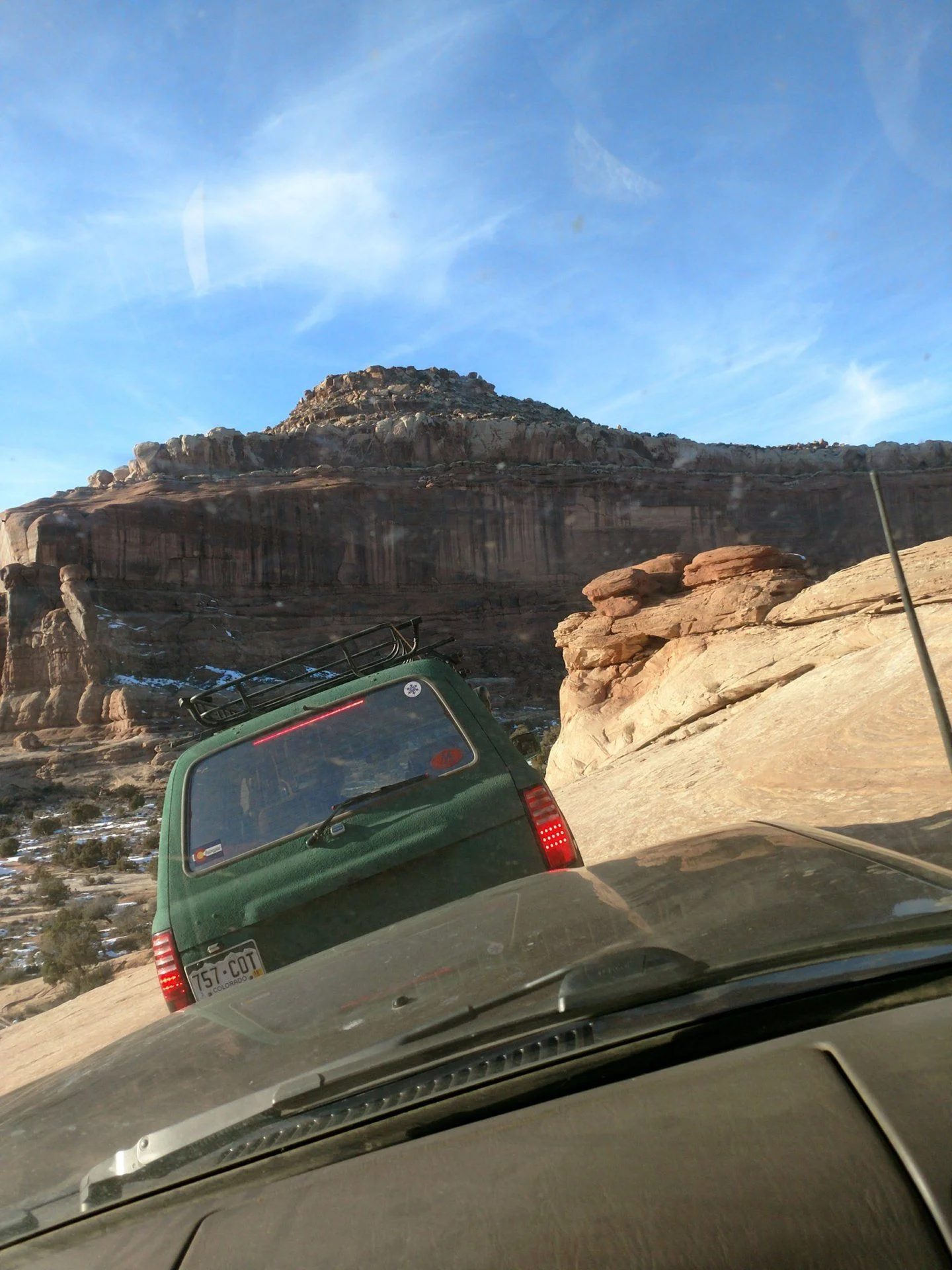

We were sitting here on Seven Mile Rim spotting other rigs through the climb and @Andrew Bluemel was really uncomfortable where I felt fine, and I hate off camber stuff with exposure. We both run Fox shocks that should be similarly valved as they were all set up by Downsouth.
Now that’s the impressions of two different drivers, but the biggest thing I felt coming out of that trip on the Flexi coils was the serious improvement in how my 80 was on sidehills so that’s interesting to hear.

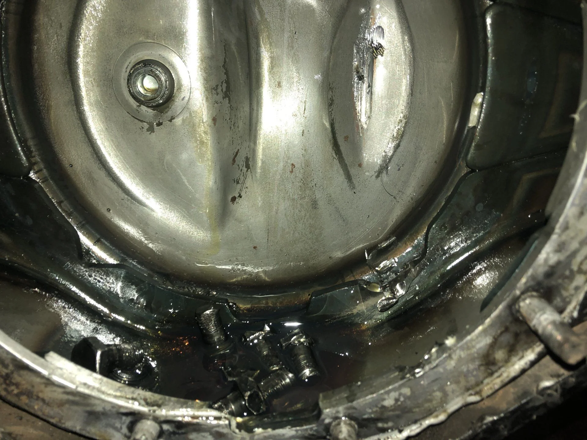

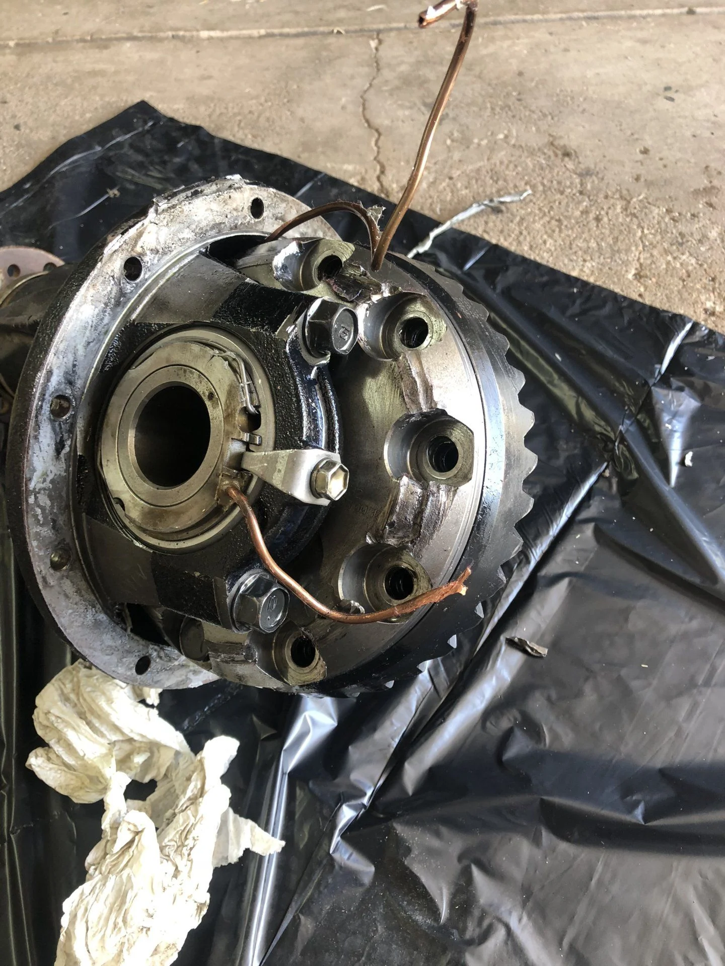

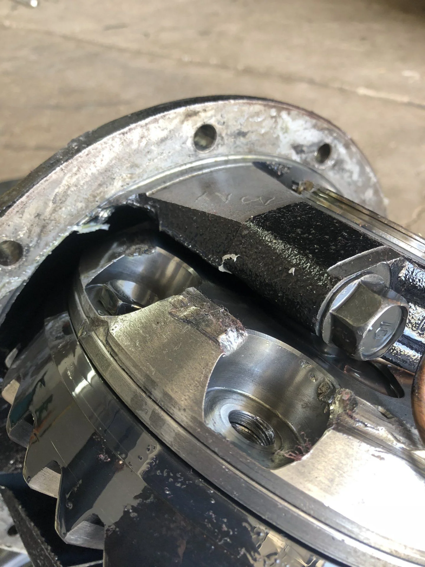

When gear installs go wrong. Somebody either forgot the loctite, or the torque wrench. Or both. Odds are the ring gear is not OK once you look at the threads.
Ring gear bolts backing out... seems like a bad install IMO
