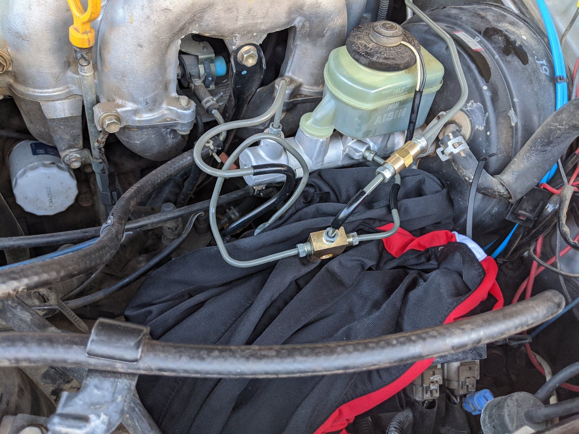

I suck at updating this thread...went to Coyote lake, 5he Dusy Ershim and Johnson Valley. Truck is great, looking a little more like raisin, but that's what happens. Deleted the abs and had a heck of a time with leaky connections but got that sorted out. Building new exhaust going over the frame...I'll finish as soon as I get the new rollers for my welder.

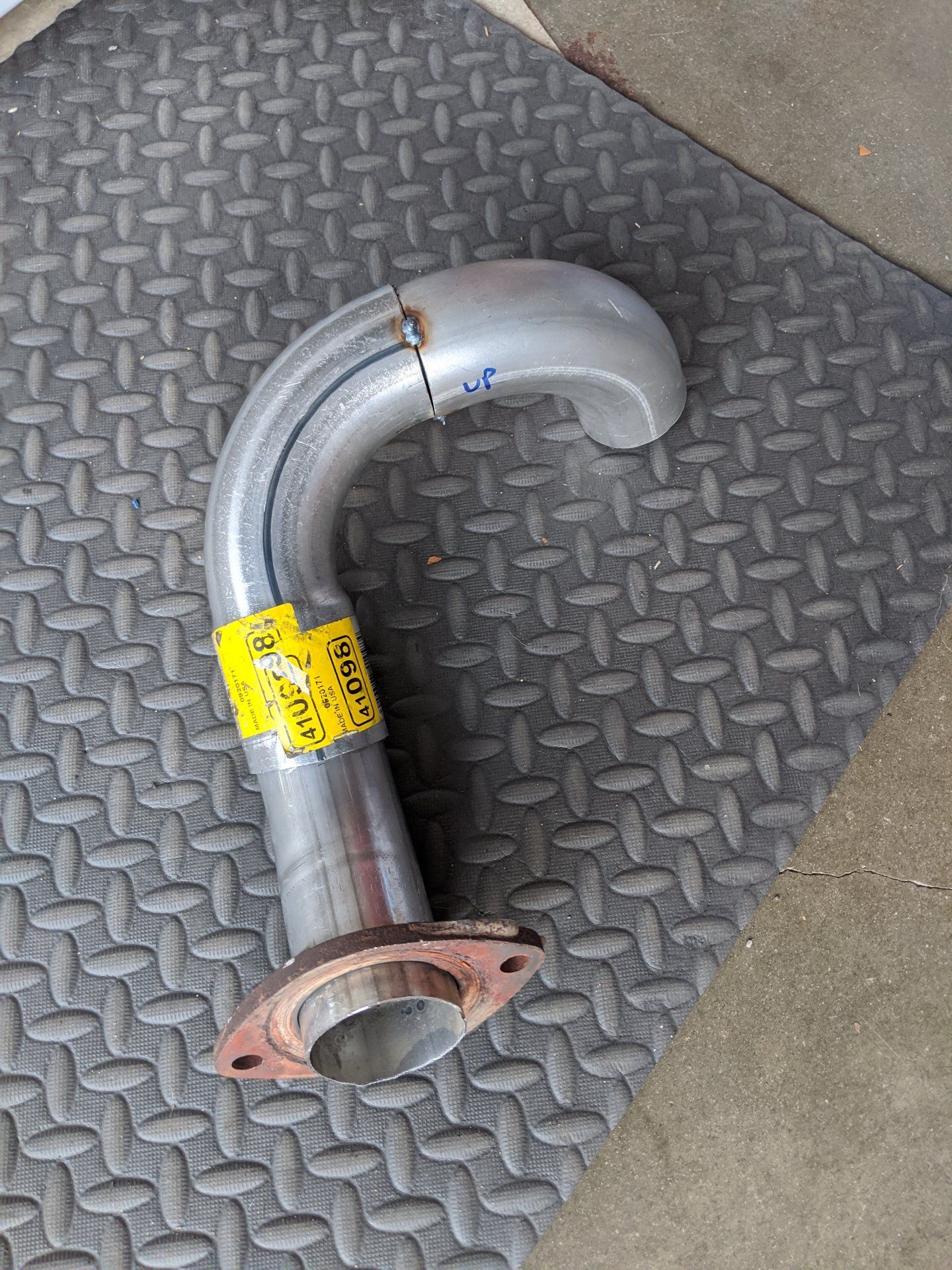

I'm very interested in seeing what your plans are for the exhaust. Looks like you picked up a home build kit. I'm also very interested in your thoughts about gearing as the first time is the right time to do it right for my application. My ABS & VLSV deleat did not yeild a shorter pedal but it definetly increased braking power significantly.
I got a bunch of random 90 and 45 degree pieces from summit and then started cutting, cursing, and welding...mostly cursing:)

Brake line is still leaking where the abs was, gotta sort that out then delete the rear heater hose in case the exhaust melts it in the back.
I suck at updating this thread...got the brake lines sorted out, had to trim, reflare the brake lines, and then all good. Went on a few adventures, got new hood struts, but now need to deal with engine mounts.
