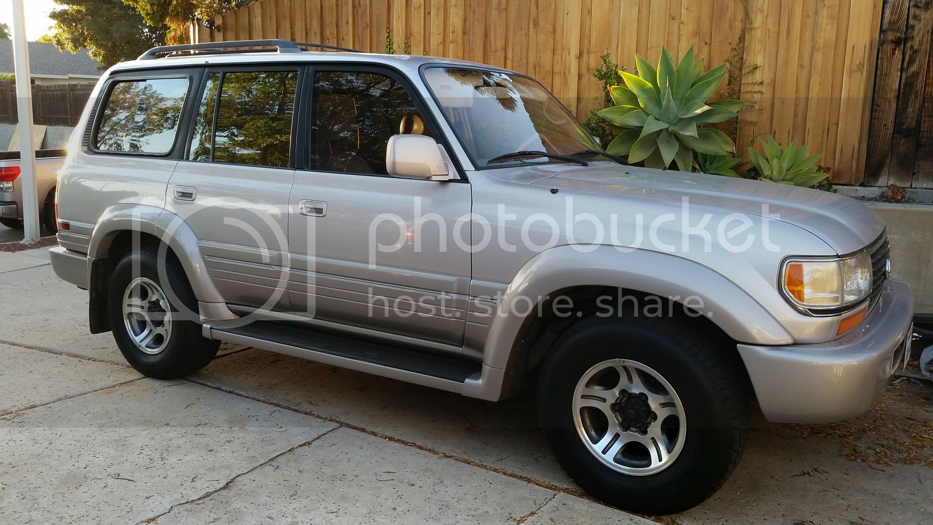

Hey guys,
I am a noob to LC’s, but not to wheeling. I’ve had a bunch of K5’s ranging from relatively stock to monsters sitting on 40’s and one tons that could tackle any trail. I also had a 89 4runner that got linked and driven all over the SW US, from the Rubicon to Pritchett trail. My wife and kids are tired of going in a big loud blazer and we don’t all fit in a 4runner, so now, we have a luxury wheeler project that I can waste my time and money on. I just finished a LQ9 swap into my 1967 Nova, so this thing will get most of my wrenching attention.
I was going to buy a built rig, but to tell the truth, building is half the fun so I found this 97 LX with a184k miles on it that was driven by a woman who worked for the American Cancer Society. The truck had a ton of records, already had the head gasket replaced and is pretty clean, some clear coat peeling, but I don’t care as I got what I believe to be a good deal.
My plan is to use this to go on moderate wheeling trips with the family, camping, and to be able to drive it to and from any destination. With that said my plan is to go thought all the normal maintenance (plugs, cables, distributor, PHH, fluids, etc..), drive it around for a while and then start my build that will look like:

Sounds like fun. With 35"s you may want to go to 5.29 gears....
Congrats on a good looking LX. With a family, I would go with a "HD" spring at least in the rear. Why would you install a part time kit?
Well, I've never had a awd rig and since there's no snow here, I thought 2wd would reduce the wear on the front end and eliminate any shimmy from the front driveline post lift.
Think about how far the front axle can go without attention. Some guys part time to combat refractory front driveline vibes due to tall lifts or to help there chromoly front birfields last longer since they are softer than factory.
It's your rig, your money, your choice but at 2.5 inches of lift, driveline vibes should not be a problem but if it does vibrate, a double cardan drive shaft should take care of it.
Do yourself a favor and get a factory service manual and research the vast library of info archived right here on Mud before tackling problems or doing a modification. This will save you headaches and money.
Again, congrats and welcome abord.
Grats on the Lexi... the best mod I've done is 7W reverse LED lights...
Yah, with all the metal your going to hang on there I would go HD on coils. Dont worry about drive line vibs till it happens... my rig is at 3.5" just lifted from 2" & I feel very very slight vib.
As far as lift I would suggest going with dual rate coils. OME, Icon & Slinky have dual rate springs ranging from 0" to 3" lifts.
