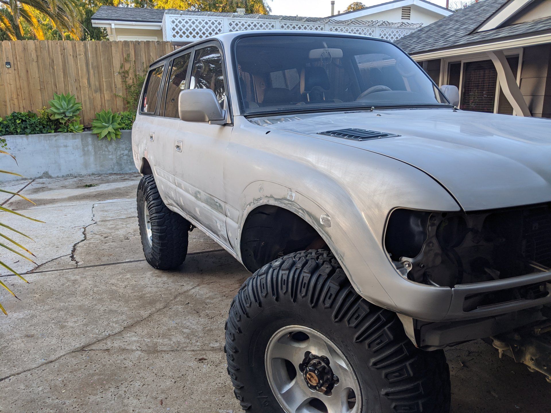

1st test...
Its ready to mall crawl or at the least a good Zombie get away rig.o_O
Looks good, but those hex head screws though... :hmm: dome top button heads would look much better.
Im digging the skirtless look, :cool: silver is my thing, thinking for me if I ever de-clad, I'll just buying some of that color match rattle can paint.

ok, time for an update, got the truck painted and learned a ton. If you’re going to use monstaliner for the first time, ping me and I’ll happily share what I learned. It came out ok, but if I were to do it again, I could do better.
I painted all the trim black with sem, love that stuff.
i think the mirrors came out pretty good...
the texture isn’t perfect, but like I said earlier, now with a little experience under my belt I could produce a better outcome. With that said though, it’s a truck and I dig it!
Ok, all back together sitting on 37’s, no spacers and a slinky 75mm lift. Now, time to go rub all that purdy paint off on rocks.
