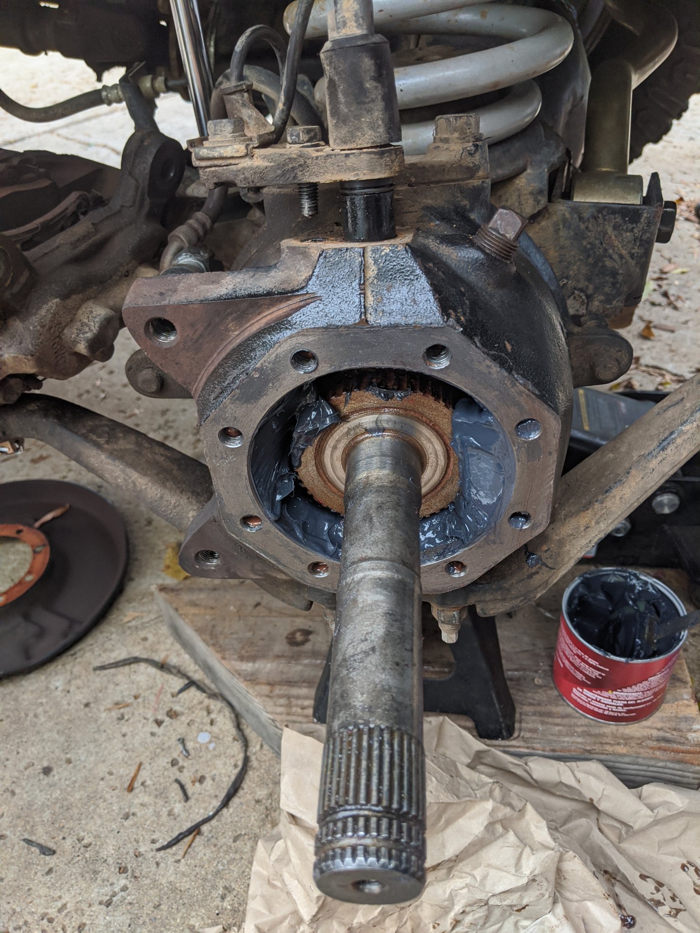

How long has it been since you lubed the head gasket? Haha I had a similar but not so loud noise about a month ago. I tracked it down to one of the heims on my steering assist cylinder. How about your tie rod ends? How long since you took a look at the trunnion bearings?
All the wheel bearings, including trunnion bearing are about 2 years old, maybe 3. TRE are brand new...
Good news bad news I guess.
Good news is if I run out of peanut butter, I can bust open the knuckle for a backup supply.

Well you definitely need to go in there
no way man, that is perfect grease:) Its what happens when the red wheel bearing grease mixes with the brown molybdenum disulfide grease...from now on, no more wheel bearing grease, EP Moly for everything!
I’ve been using moly grease in/on everything that gets greased for at least two decades. Has worked well for me.

I'm not sure there was an issue in the first place as I think it was just red moly grease, but since I can't remember for sure, I pulled the axles, repacked the birfs, inspected the wheel bearings, and put everything back together. Better safe than sorry...
Did you pull the trunnion bearing to inspect and re grease ?
I use Lucas red moly and they always look the same as they go in just a little darker.
You must have got a little bit of water in it and it got blended.
That's also a ton of grease. I use about half a tube to 3/4 max. You don't need that much in there. It's just a pain to clean out next time.
The cavity should be ~3/4 full, which is what it is.
I replaced my trunnion bearings with life savers so I'm good...
Nothing Like doing half of a job, by the way with look of your tone ring I think you had water in the too :p
