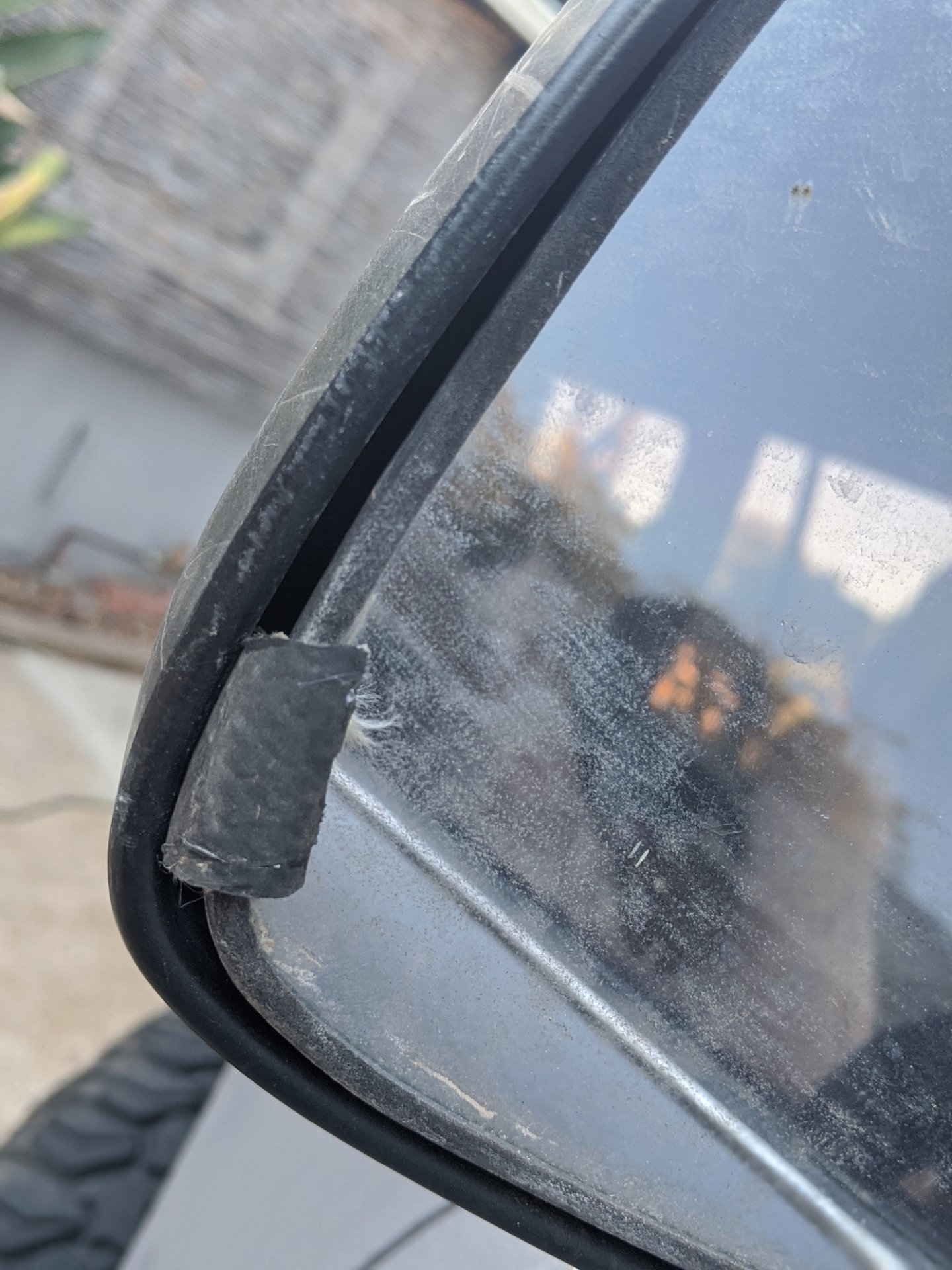

How ghetto am I? Best shaky mirror fix ever!
I suppose that you’ve already checked the screw accessible through the bottom of the mirror housing for tightness? Doing this has helped a couple of my mirrors on the two 80’s I’ve had.

that is ghetto. use this instead!
it works great!
