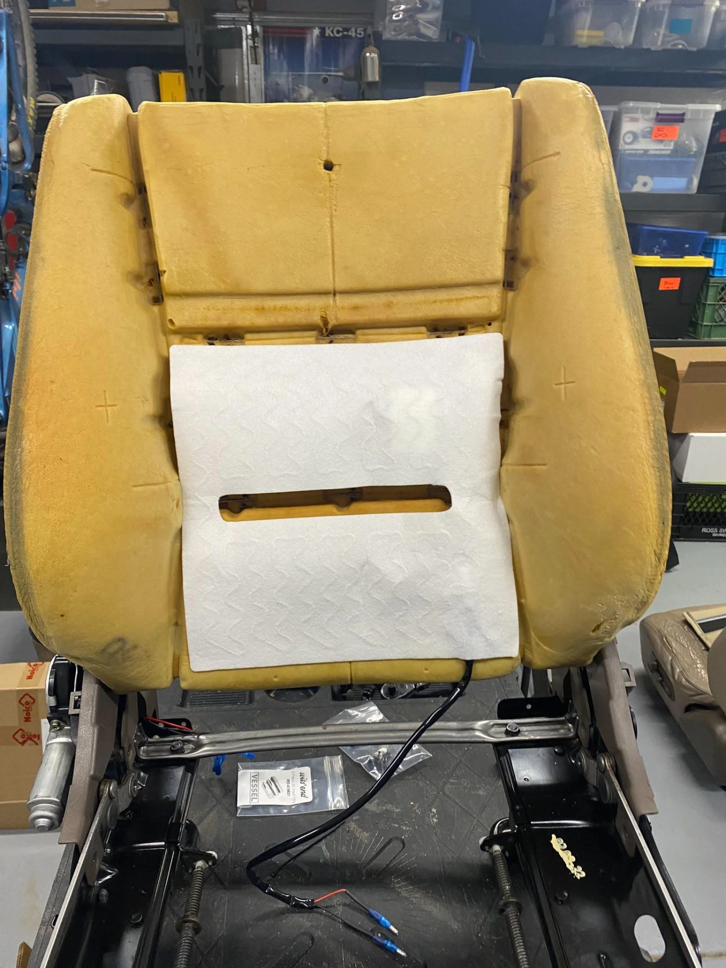

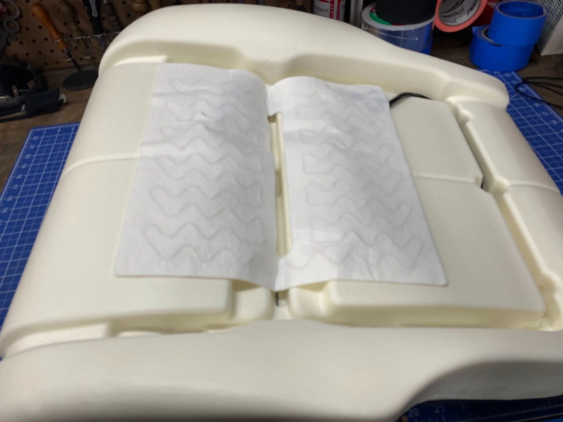

I don't know if this will apply or interest more than 1 or two of you on here. A couple of years ago I swapped out my seat leather with some L seat leather and put in seat heat switches that I got on ebay. My center console had been modified to be a sub box by the previous owner, so I was stuck running vertical switches in my radio bezel. They worked fine, but it was just one of those things that bugged me every time I drove it so I started looking into getting some horizontal switches from a Lexus RX300.
You can find the rx300 seat switches on ebay along with the console for around $20-50. The sellers never included a pigtail, so I decided to use the pins from my existing extended harness that I made when I plugged the JDM switches in under the seat and ran the wires up, under the console and into the radio bezel.

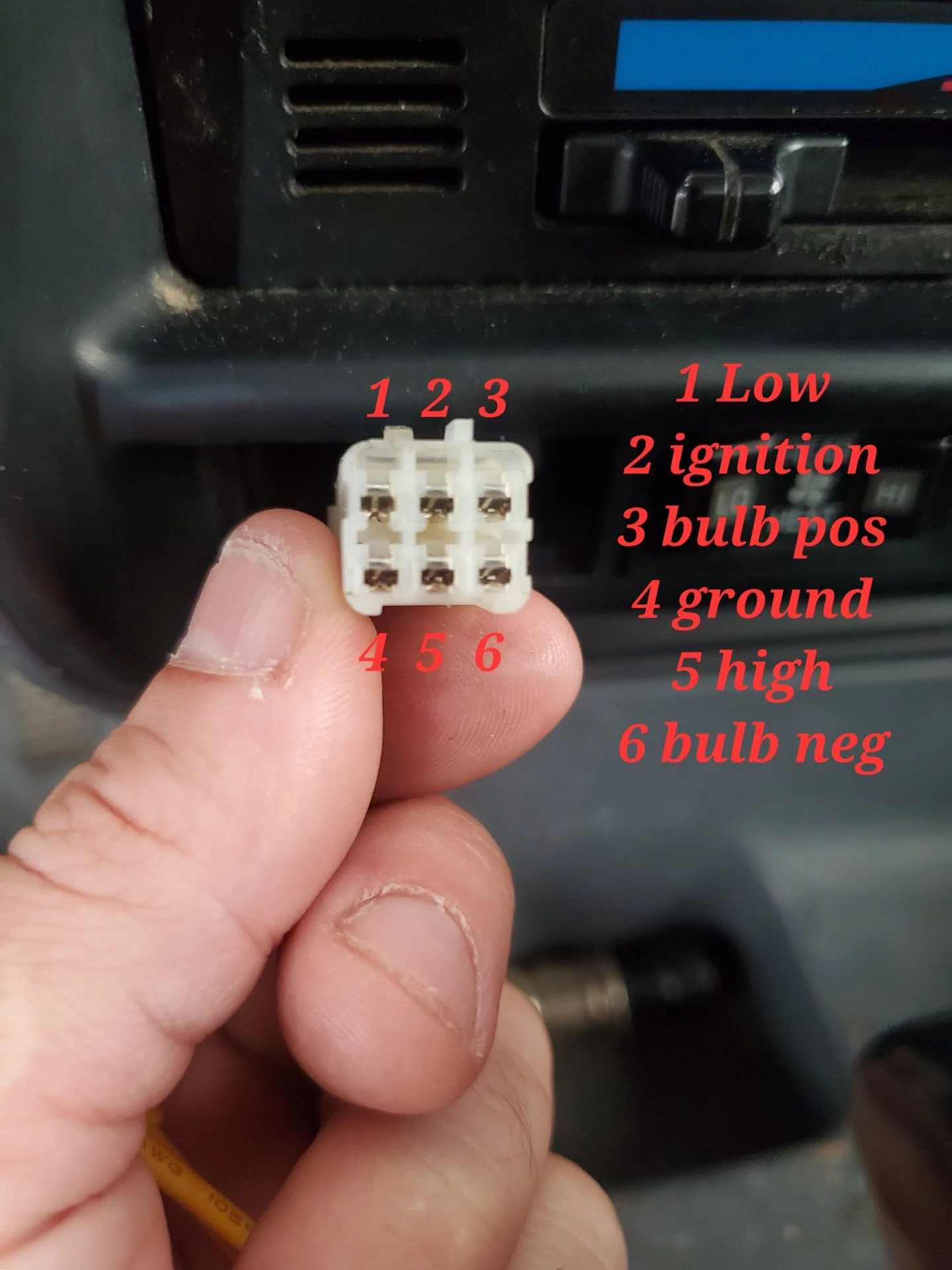

The vertical (jdm) switches come with a pigtail harness with a male side and square female side that plugs into the back of the switch. I had already made my coolguy extened harness and plugged it into the body harness, so I ordered a couple of 6 pin female connectors from corsa technic (6-Way Kit - https://www.corsa-technic.com/item.php?item_id=1360&category_id=129 ) and modified them to fit the RX300 switches. You have to trim a part on the inside of the switch and then also rotary tool / file off a small part of the top of the new corsa connector for everything to jive but the lock tab clicks and its secure. I used some flush cutters and a small file and was done in a few minutes.
You should know that the JDM and RX switches have a different pinout.
The JDM/ Vertical ones are as follows with the square connector
  1. Low heat
  2. ignition
  3. illumination/ bulb positive
  4. ground
  5. High heat
  6. Illumination/ bulb negative

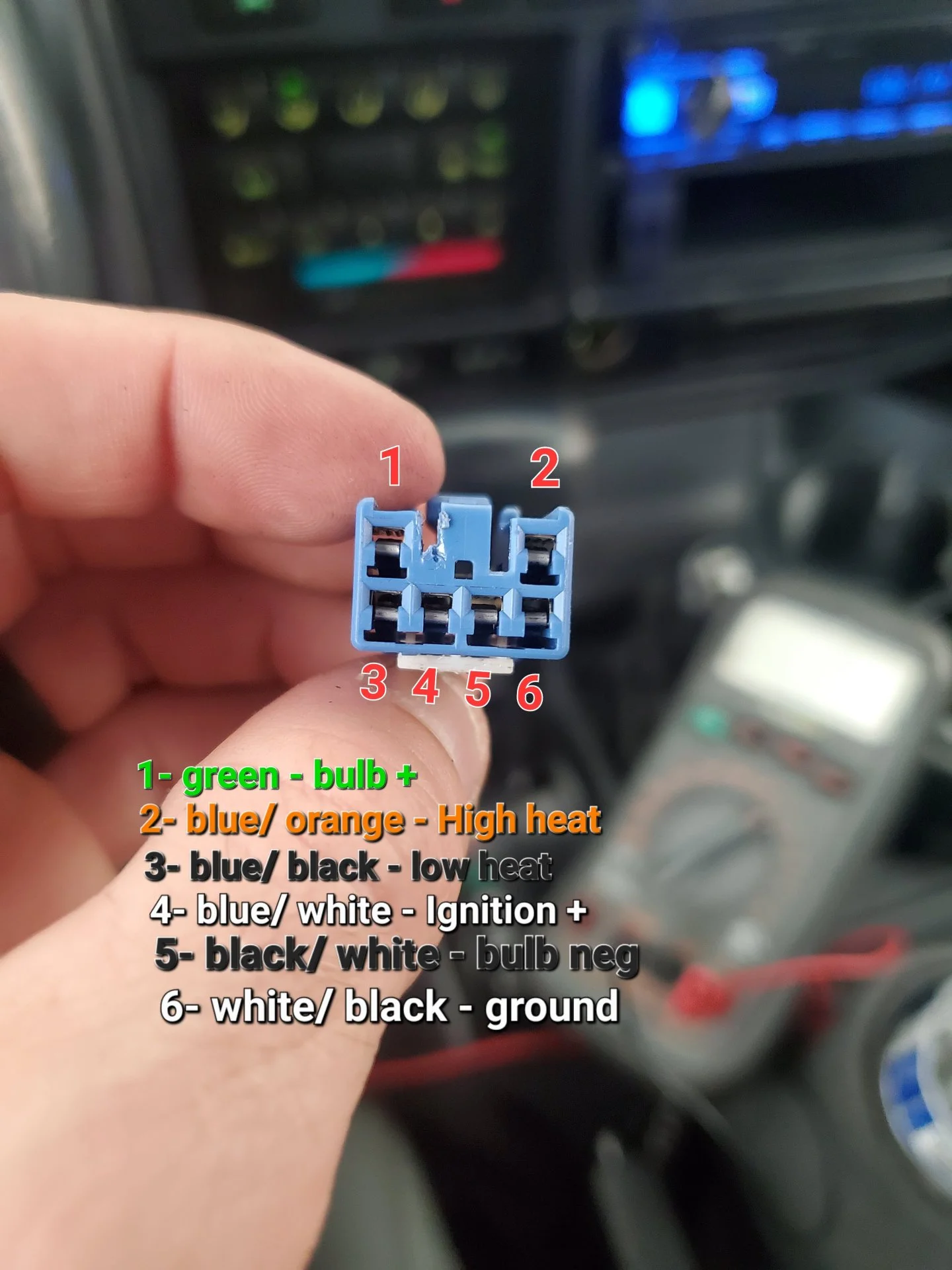

And the RX is pinned like this and with wire colors from the JDM harness
  1. Green- Bulb positive
  2. blue/ orange stripe - high seat heat
  3. blue/ black stripe- low seat heat
  4. blue/ white stripe- ignition +
  5. black/ white stripe - bulb negative
  6. white/ black - ground

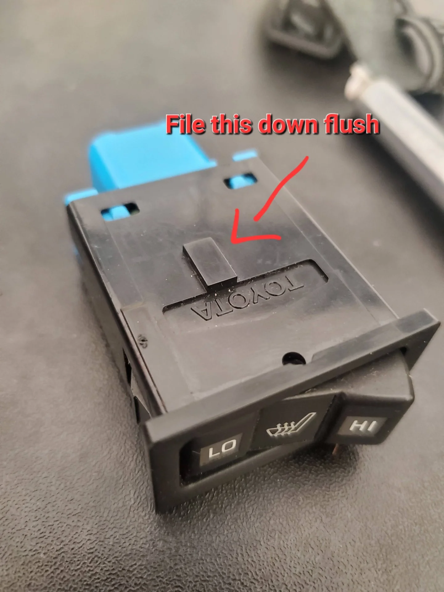

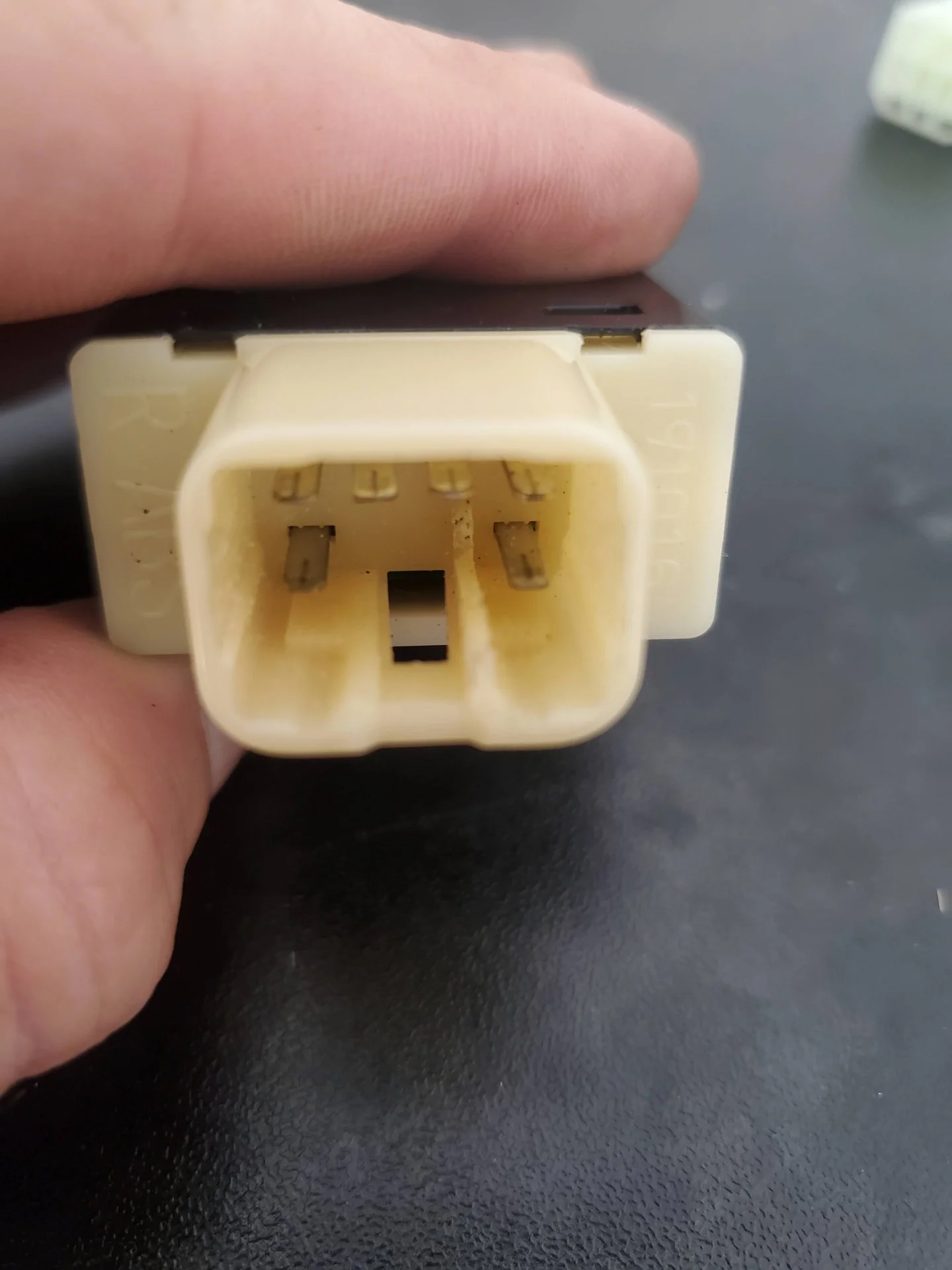

Once you get your wires all swip swapped around, you'll want to file down the locating tab on the top of the connector. Once thats done the switches will set in place and you can find something else to obsess over.
View attachment 3095925View attachment 3095926
  1. Low heat
  2. ignition
  4. ground
  5. High heat

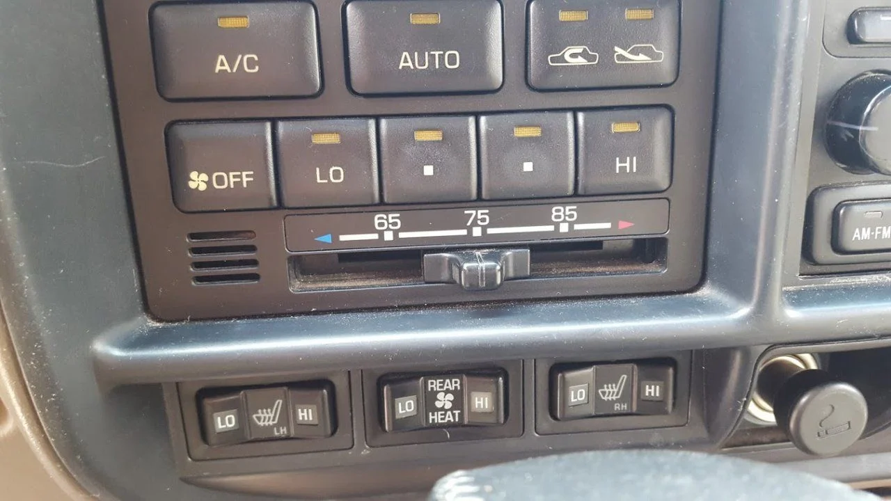

Dude that’s awesome. If I had an 80 series still that is the move. That fits perfectly under the radio in those horizontal brackets. Great write up!
FINISHED PRODUCT

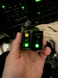

Odd behavior all of a sudden on my driver’s seat heater wiring - I bought the truck with this mod already done and everything worked like it should.
Out of the blue, I started getting some Hi/orange illumination when Lo/green is selected on the LH/Driver’s seat only. Swapped the switches and it doesn’t follow the switch. This leads me to believe there is a small short, likely under my seat and unrelated to the switch, pigtails, or their extension solder joints.
I’ve separated all of the pigtail wiring and I still get this “backfeed” situation you described.
Could you help me understand what you did incorrectly the first time so I can more quickly chase down the wonky wiring?
The other odd thing is sometimes the Lo wouldn’t illuminate at all - unless I cycled on the rear heater. I don’t see any janky splices under the console harness, so not sure how one has any effect on the other.
Current situation. Driver’s side is acting up and passenger side works as expected. I checked under each seat and the wiring looks exactly the same.
I had wired my heated mat before the relay all kinds of stupid. When I did it, both high and low would light up on low and the rear heat fuse would blow in high. I wonder if you have a short in your heated seat mat somewhere.
I’ve checked the wiring, the switch, the added pins. Problem doesn’t follow the switch. I’m definitely going to pull the passenger seat tomorrow and try to swap them around, or at least jumper from the passenger seat plug to the driver’s seat. If the problem follows the seat - there’s my answer. Being that all of this effort is to prep it for sale, and these seat leathers are only several years old, I’m not tearing into them for a nuisance issue.
Like I said above, It’s more of a nuisance than an outright failure - the seat heats in both Lo and Hi, no fuse/overload issues…just the dang Amber Hi light when in Lo mode. I’m just bummed - I wanted to be able to confidently and accurately say “only thing inop/needs attention is the power antenna” - now I have this thing going on.
What’s really confounding is this basically just started as I went to reassemble the interior after a deep cleaning and some light bulb replacement in the center stack. Problem just started.
Thanks for the feedback/help!
I would look for a bent over pin in one of the connectors.
Thank you! I’ll give all the connectors a very thorough look tomorrow. I am 98% sure I did when I cleaned and greased them all, but better to double check while it’s all torn apart. The eyes aren’t exactly 100% anymore.
Any other adjoining circuits I need to inspect?

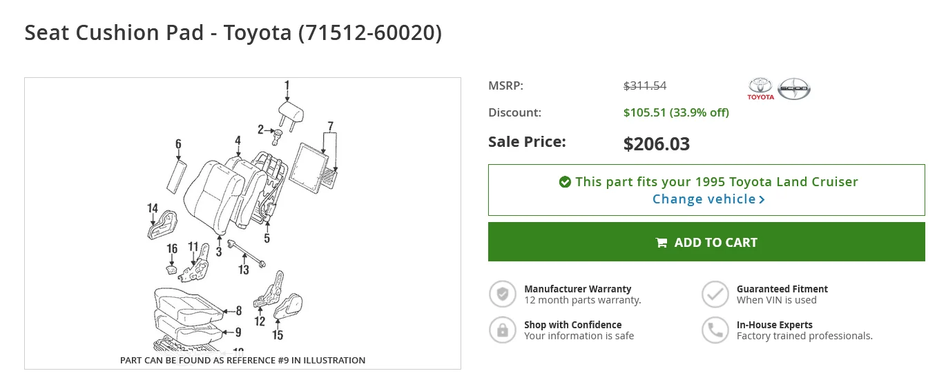

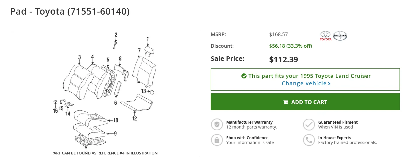

I'm glad this thread resurfaced. I looked for those upper/lower pads years ago, and couldn't find anyone selling them. This made me look again, after seeing what LCH wanted for them, and realizing that if they truly were reselling OEM pads, they must be available again. Sure enough, McGeorge has them listed (both) for less than LCH wants for the pair of lowers (that they won't sell separately). :)
Pad, LF, seat back:
Pad, LF, seat bottom:
Curiously, the RH bottom is still listed as available, but the back isn't. Guess I know which ones wore out.
