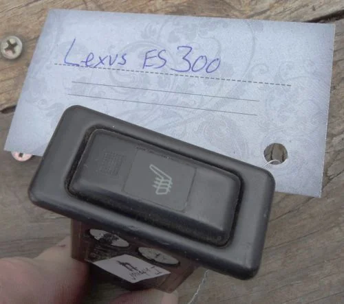

Any idea if this switch will work?

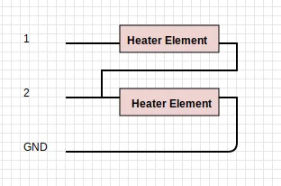

First, according to this (http://forum.ih8mud.com/attachments/seat-heater-electrical-diagram-pdf.460604), the seat heaters are connected in parallel when the switch is HI (each sees the full 12V), and in series when the switch is LO (each sees only 6V). There are two extra connections to be made to the under-seat connector, in addition to the ground. When switched to HI, the pins are connected to:
1 GND
2 +12V
When switched to LO, the pins are are:
1 +12V
2 Open Circuit
So you can wire the aftermarket heaters to be in parallel/series like:
In HI, the voltage at pin 2 reaches both heaters and they are both independently grounded. In LO, the voltage travels through the top heater, then the bottom, then to GND.

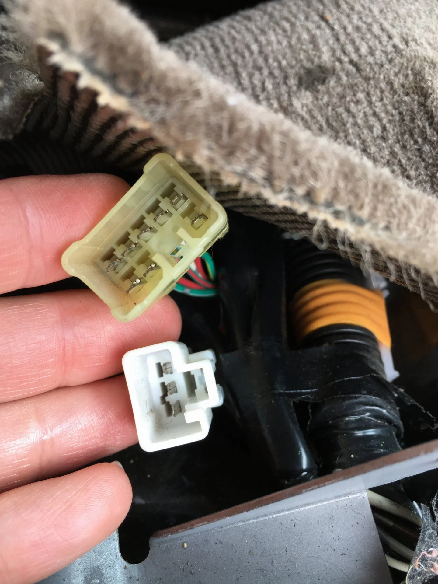

Like others I've torn into my console looking for the wiring loom shown in post #1. No luck. I found these and got excited for a minute but I don't think either are what I want. Anyone know what these two are for? Is the smaller one for the console fridge?
It's nice when telling the wife about this thread and SHE gets excited!
