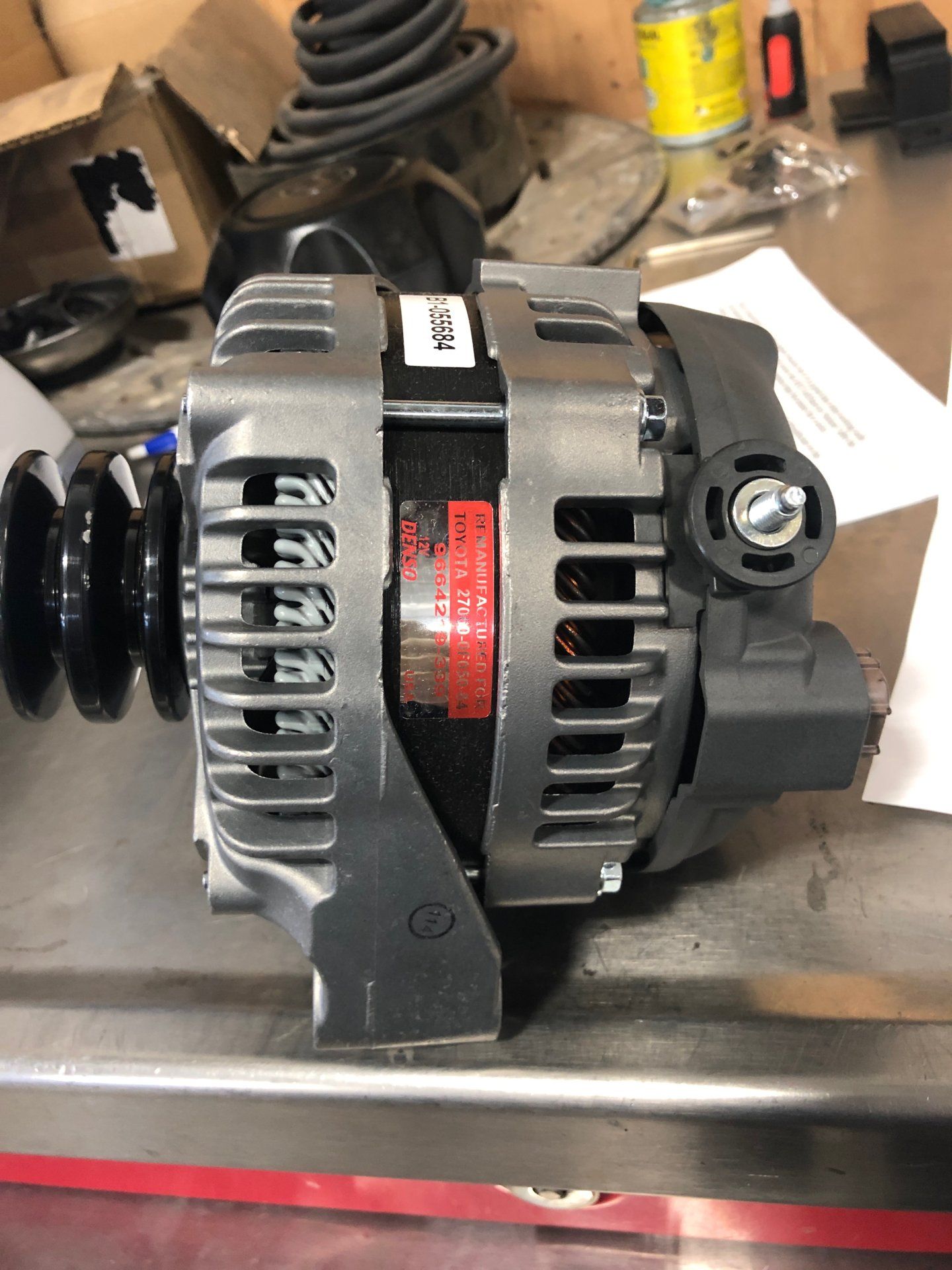

Getting close to getting that wits end turbo! Managed a few upgrades while waiting!

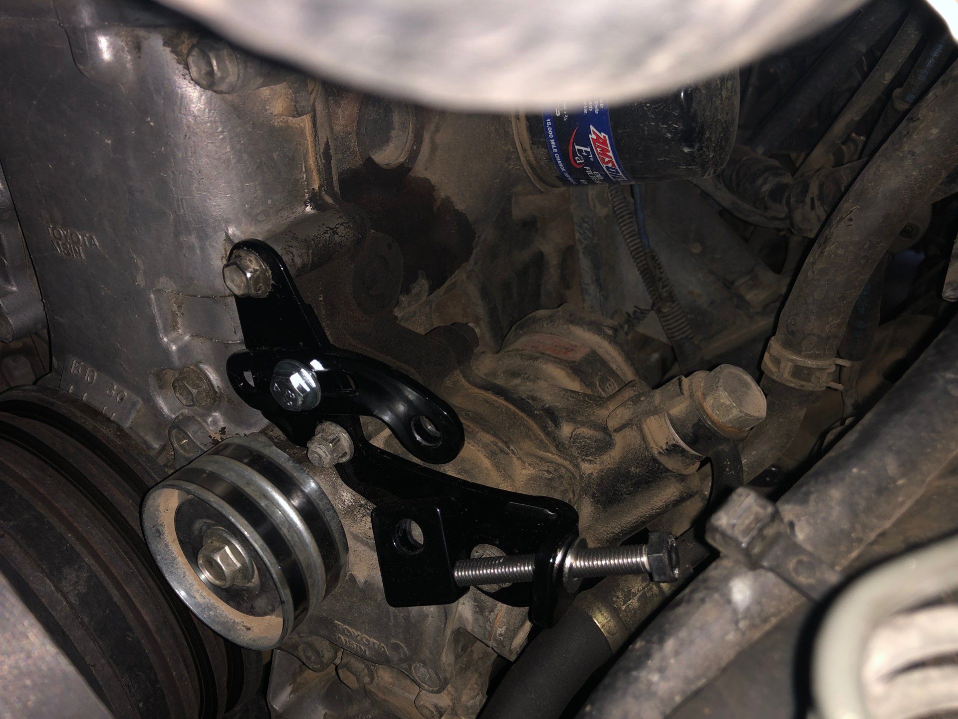

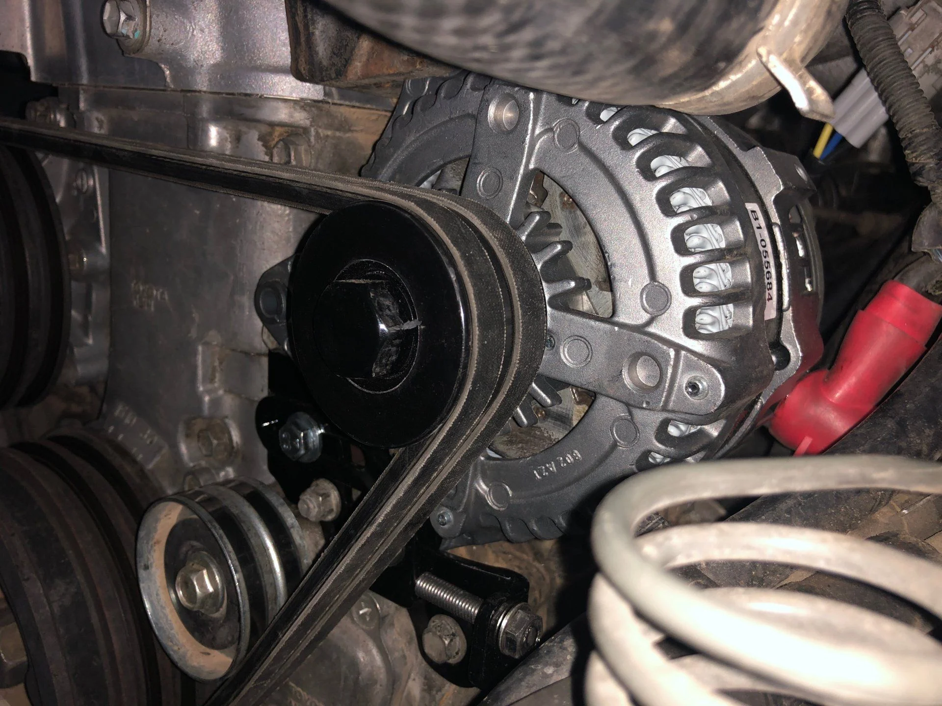

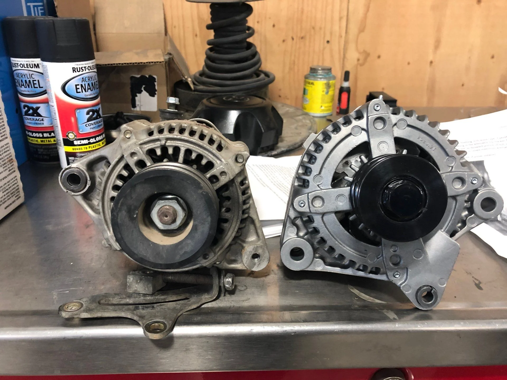

07 OEM sequoia 150 amp alternator with photomans bracket! Awesome setup and great guy to buy from!

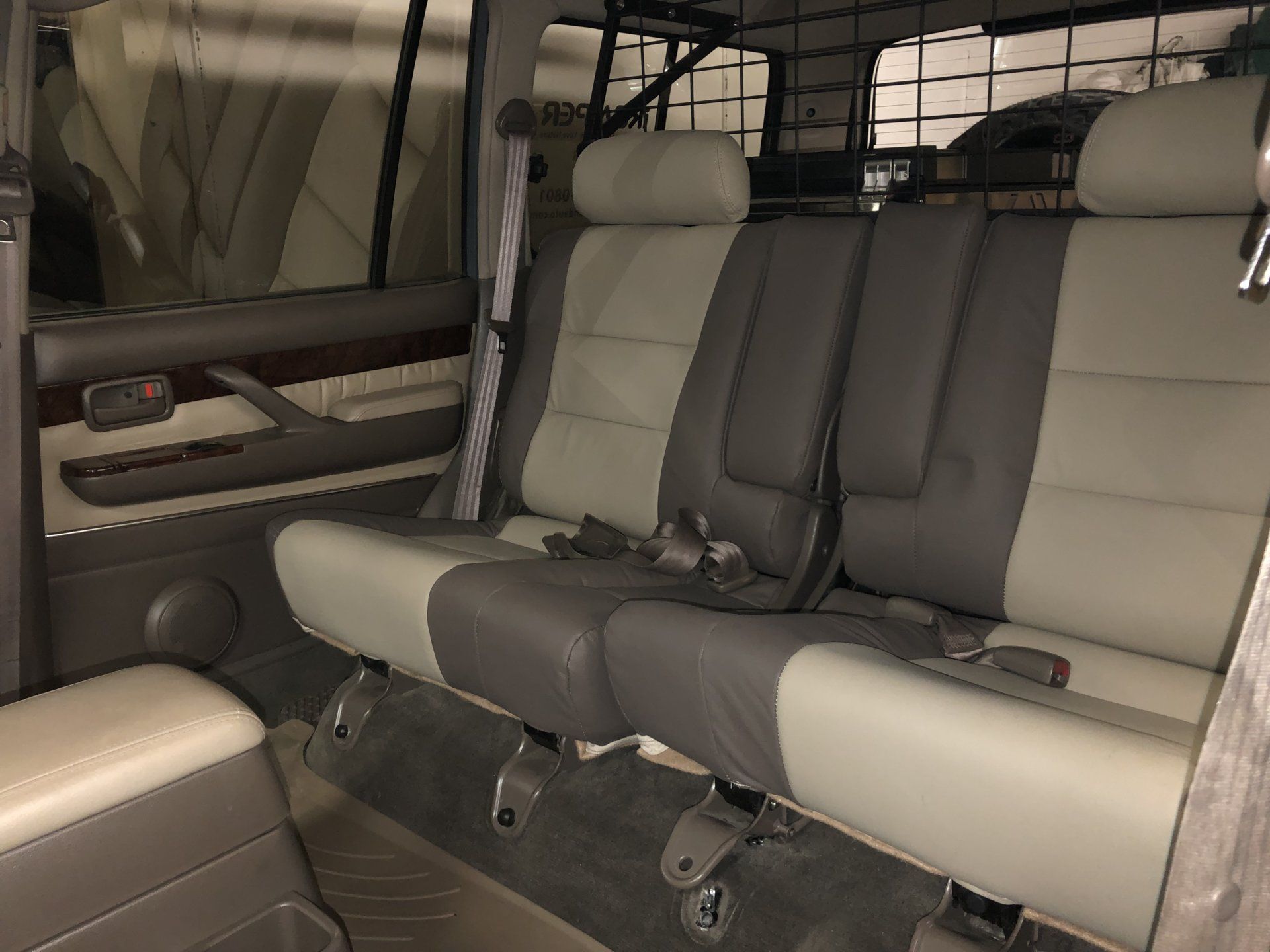

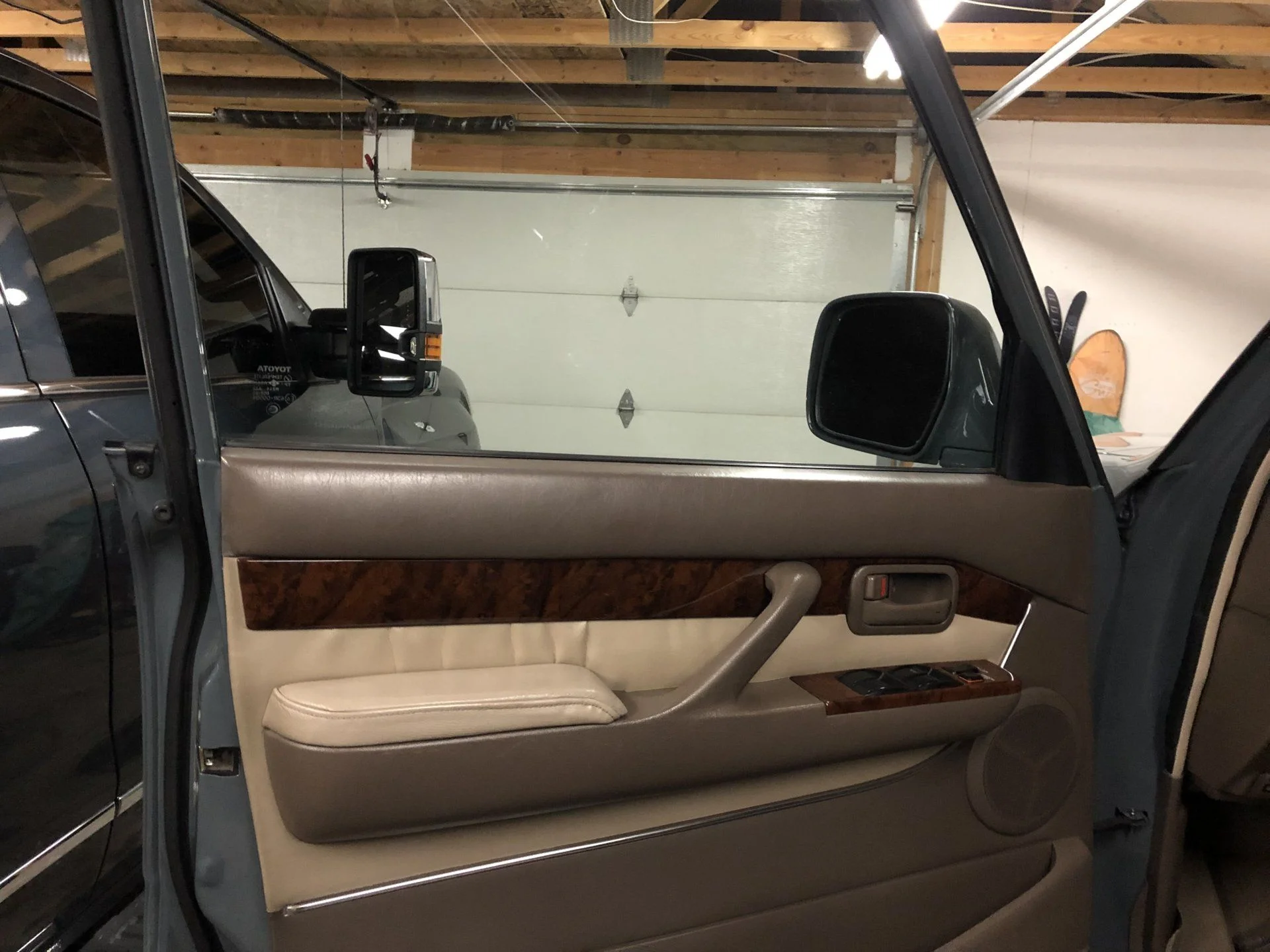

Lexus seats installed with brand new cushions heated seat elements and anniversary two tone leather
Mild shift kit with anticipation of turbo in the near future!
sweet! do the lexus seats fit without modifications? i have a 97 LC, i’ve driven the same year lexus though and i felt a difference in the comfort of the seats. would love to swap some in with heating.
I agree, the Lexus seats feel way more comfortable! And yes they bolt and plug right in!
What leather kit did you go with?
Landcruiser heaven, quality is great! Frank is a bit frustrating to deal with..... this was my first upholstery job a have a couple panels I’m not happy with due to my mistakes, I have been waiting months for replacement, with the same two weeks out answer every time I call..
