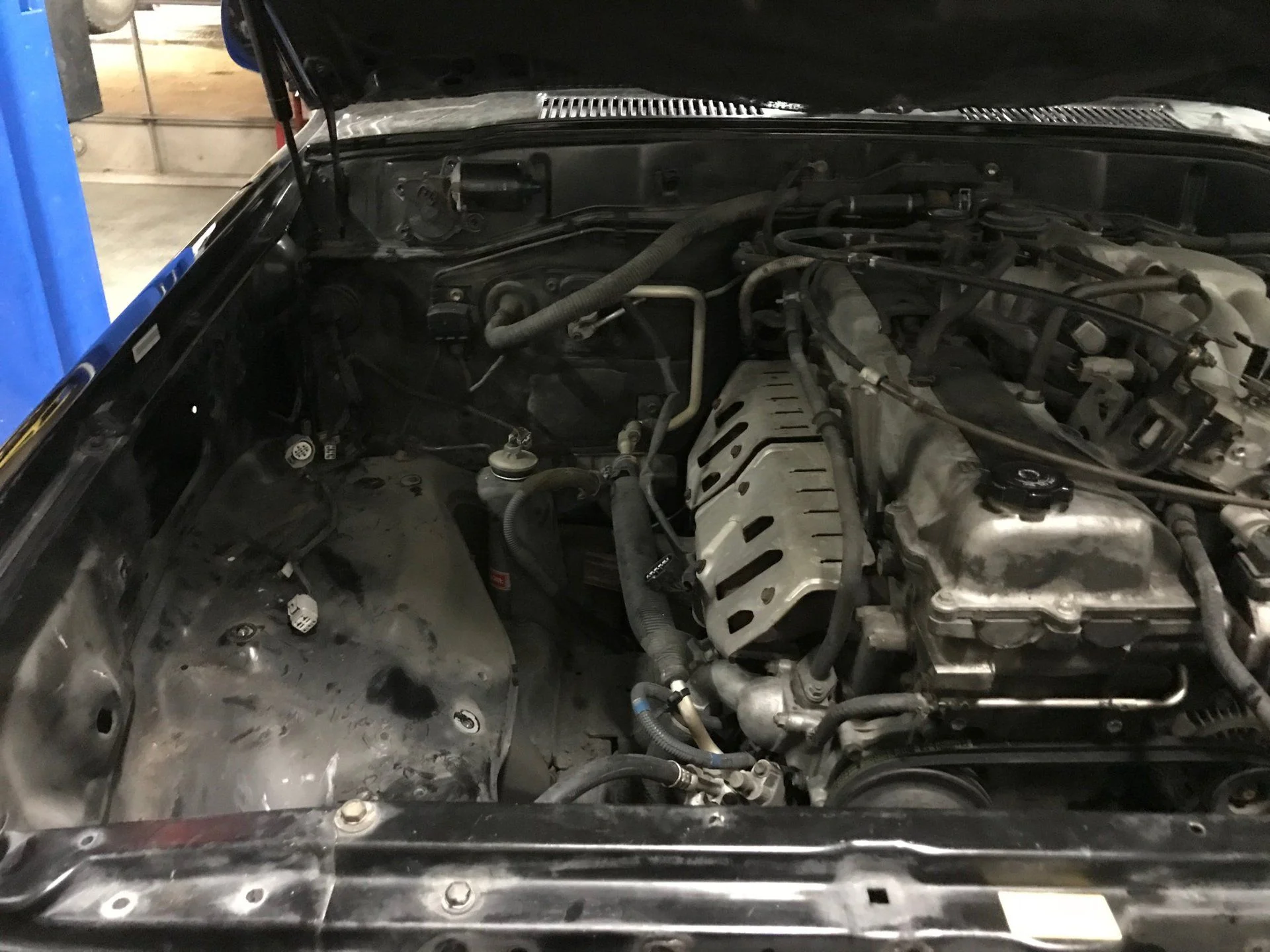

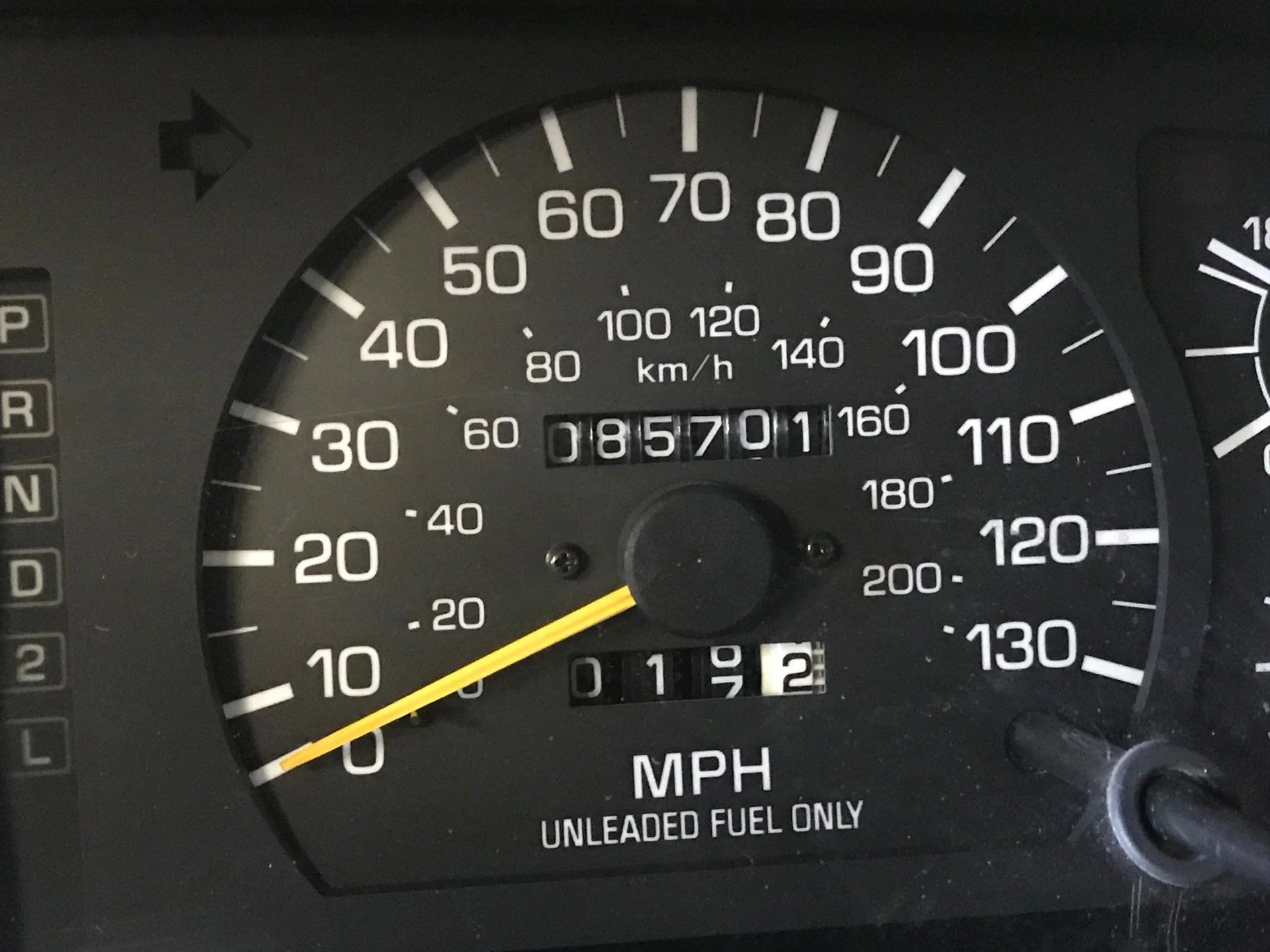

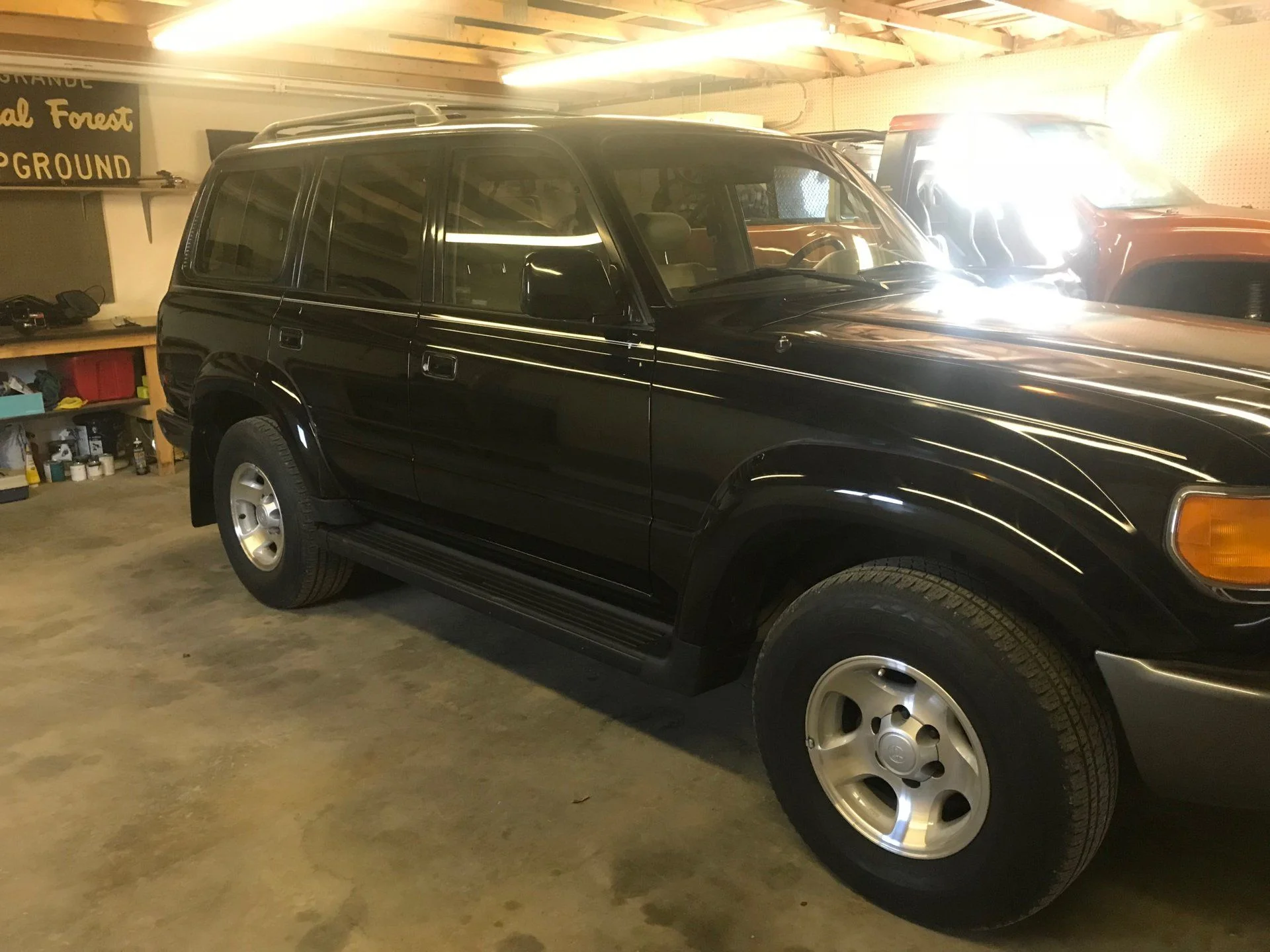

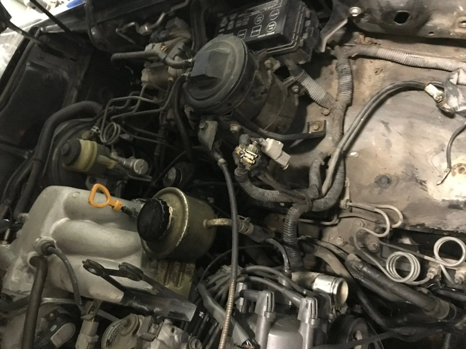

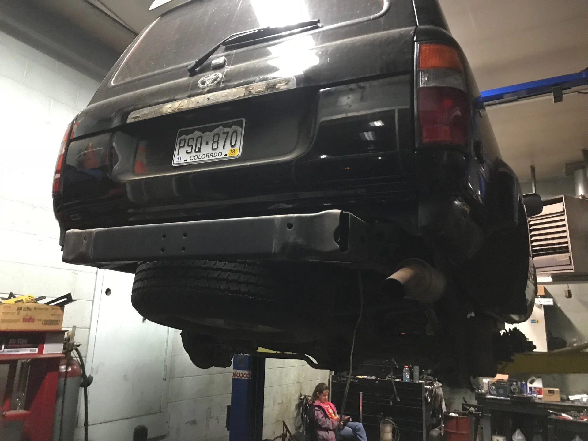

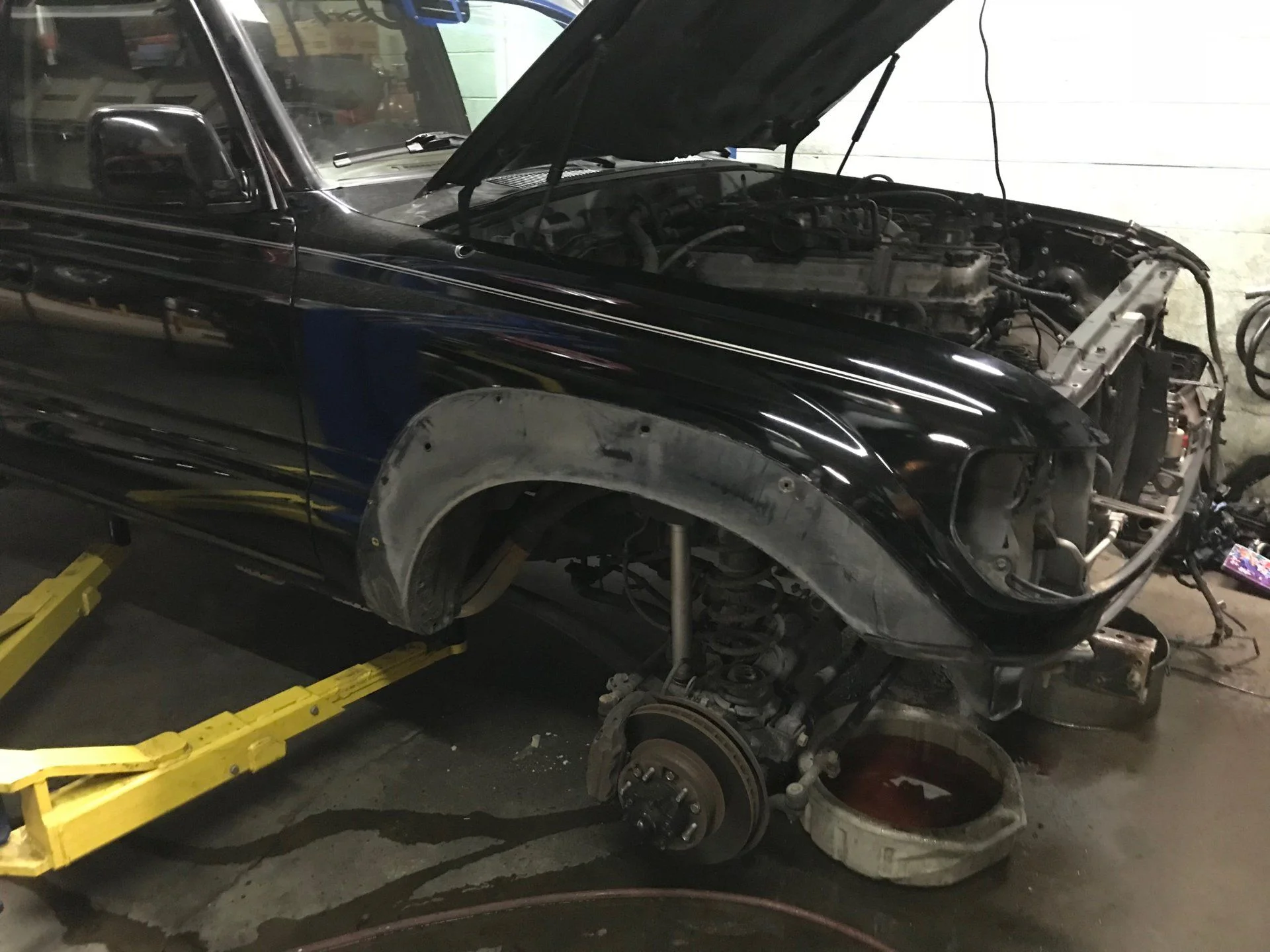

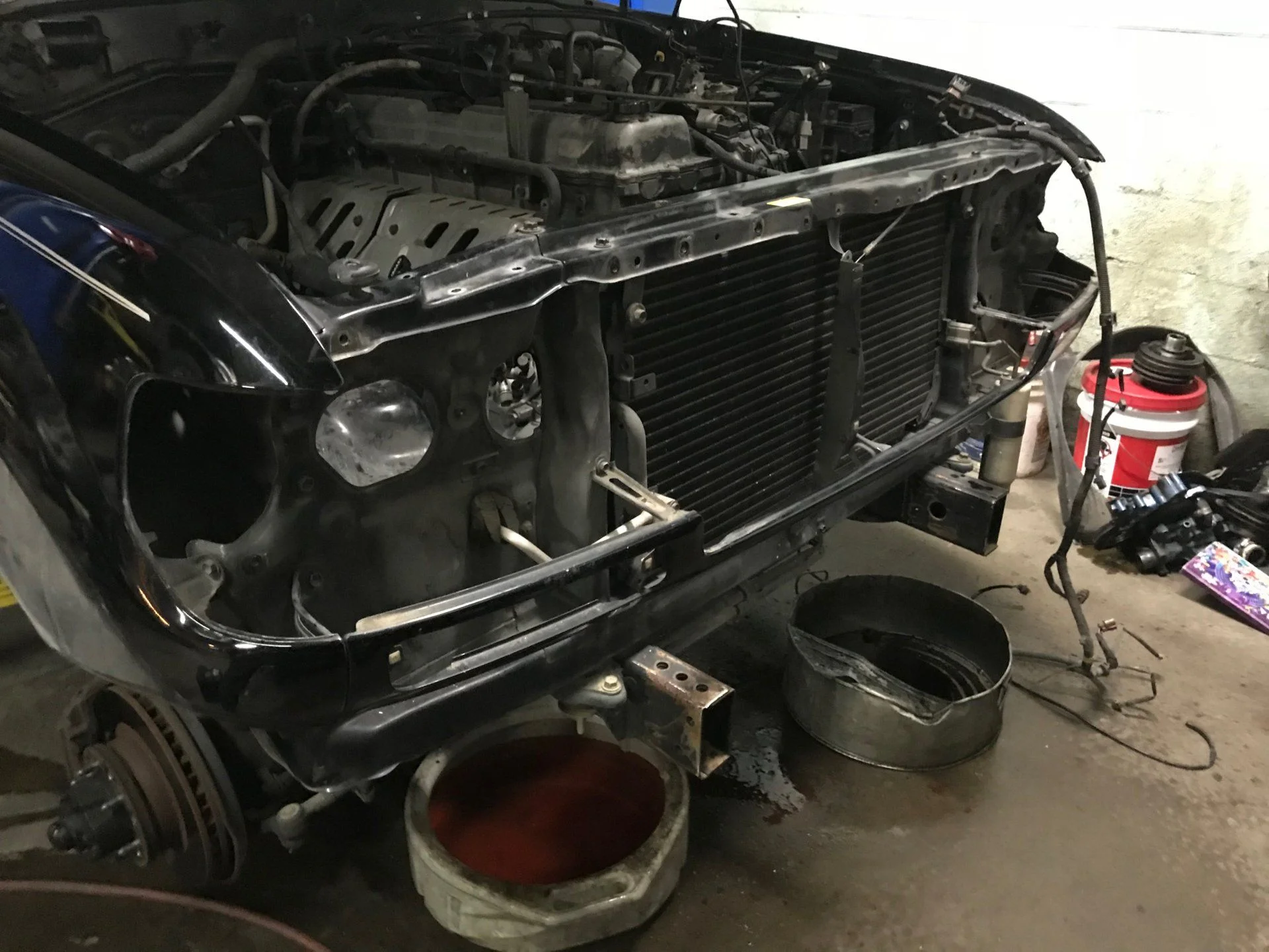

So after missing my anniversary 80 series I built years ago, I finally purchased a 97 factory locked 85k mile cruiser out of Texas! I have had it for about a month now, debating what i'd like to do with it... So far I have changed all fluids over to Amsoil synthetic, installed a pioneer touch screen head unit, put about 500 miles on it, and brought my first child Lucas Beau Oliver home from the hospital! It's very clean but do to me being extremely picky and someone doing a shabby touch up on the paint due to paint fade, "looks great from 5 ft away", I have decided to go all out on this build, It will be our family expedition truck, and in 16 years Lucas will have it for a first vehicle! To start out it will receive a top of the line paint job, I just picked up every exterior rubber gasket, trim moulding, and emblem from the dealer, The goal is to strip this thing down to a shell, including engine bay, and repaint inside and outside of the entire body, afterwards I will start the expedition build, here are a few pics of what I am starting with!

and so it begins..... I am on the hunt for a passenger front fender flare with no broken tabs, "whoever did previous touchup attempted the removal of this flare without unbolting..." also front door panels vinyl is a bit messed up on bottom, any leads on these would be great, or a possible place that may repair the door panels!

That would be awesome, color doesn't even matter, I am in the process of stripping for a paint job! So a lot of people make the mistake of thinking it bolts on from the bolts in the fender well, and then break the tabs on the flare, there are actually nuts inside the fender that you have to get to from the engine bay, its a bit of a project, you have to remove a lot of the stuff on the fender in the engine bay to gain access. I would def be willing to pay for it if you can take your time and not damage it! I havn't removed my other flares yet, I'm hoping this is the only one they broke, it appears they attempted to remove this one flare for touch up paint, then chose to tape it off instead.

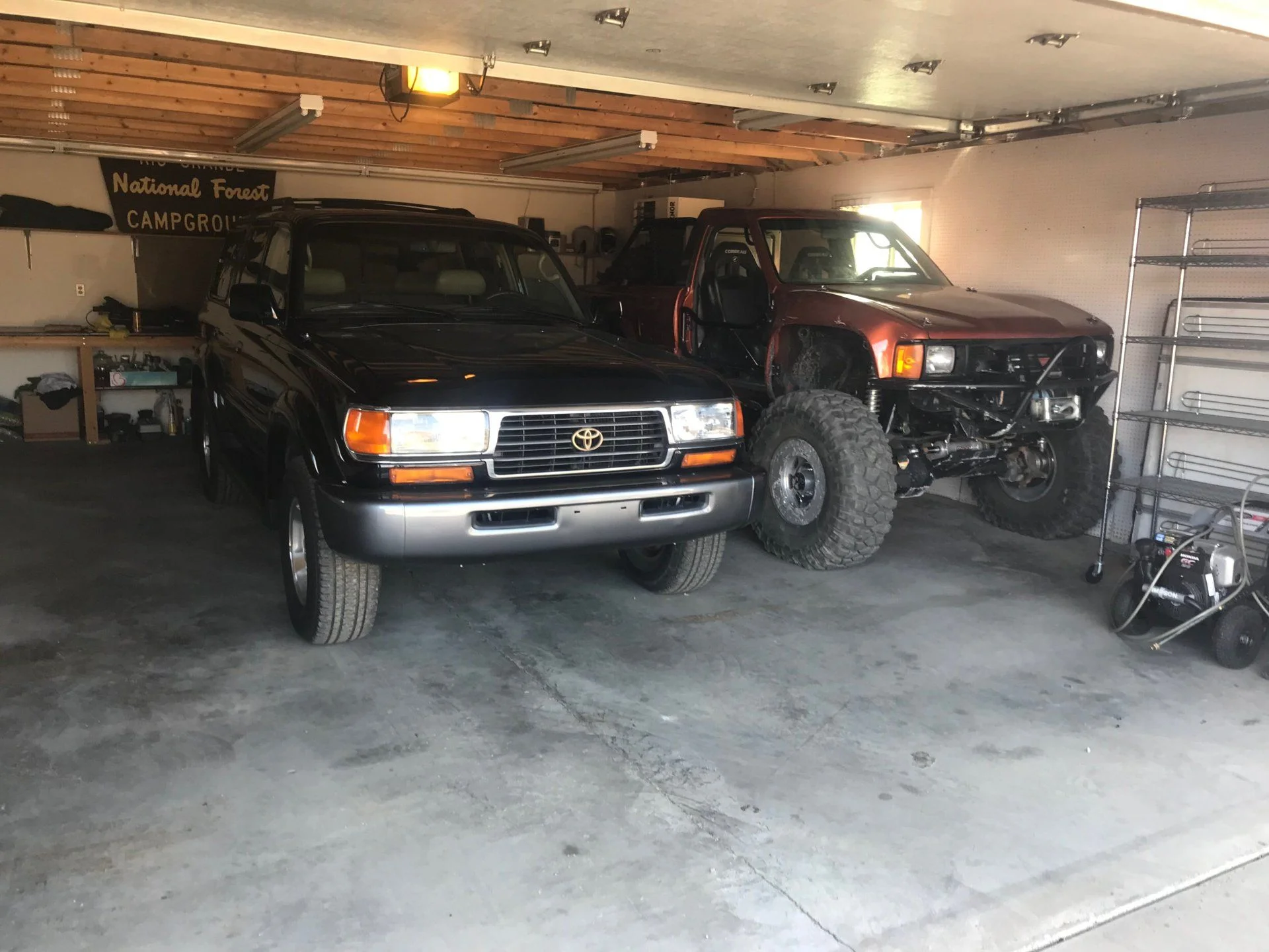

How about a little info on the other toyota that shows up in one of your photos. It looks like it may have a couple of custom features. ;)
Sweet. Mine had 94.5k when I bought it and I'm now at about 101k. The unicorns do exist.
My local toyota parts manager gives me 10% off and when he isn’t looking one of his employees will give me 15% off but when I make a larger order the 30-34% discount at McGeorge Toyota,on the east coast, offsets the shipping costs. So, I buy only small stuff at the local dealer where shipping costs would be as much or more than the online savings.

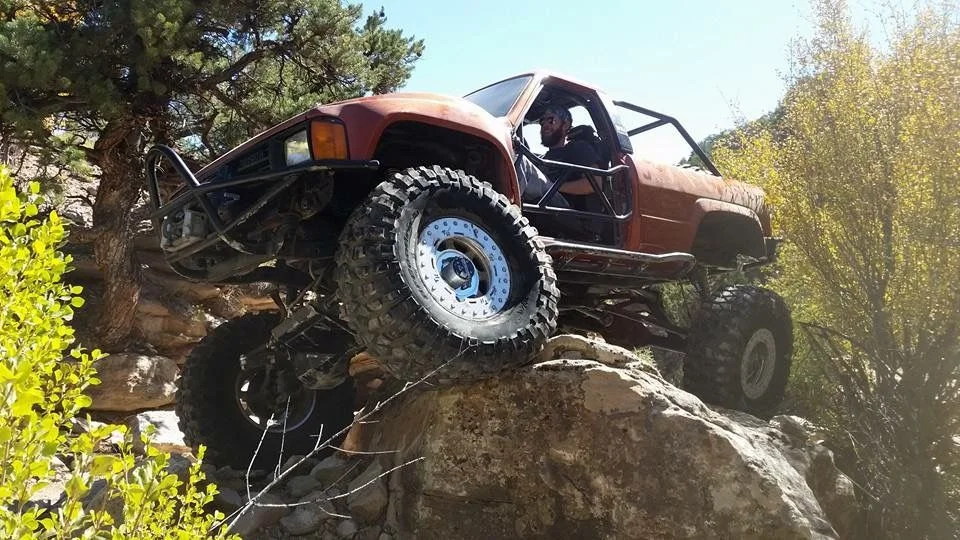

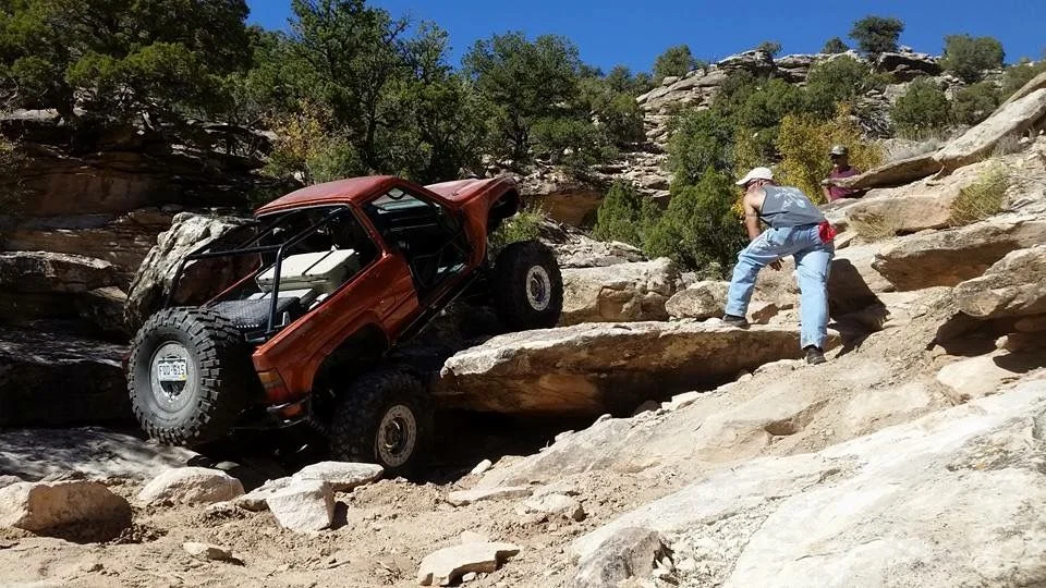

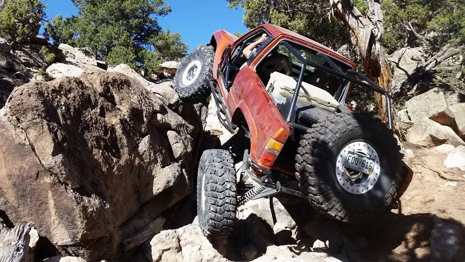

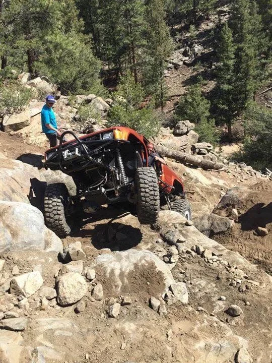

Yeah thats a first gen 4runner I picked up for a shop beater about 10 year back, now its a trailer queen, just did a second rebuild on that last winter! 3.4 v6, 5 spd trans, dual cases, 14 inches bobbed out of the rear, opened up rear fenders to easily accept 39 stickies, fiberglass front end, custom diamond axles, dana 60 outers, high 9 centers, arbs, 35 spline chromoly axles, 3 link front, 4 link rear, with 14 inch coilovers! I'm probably missing a bunch of other info but it was my answer to all my buddy's who thought I needed a tube chassis to keep up! heres a few action shots
Way more intense than I want to do with my 80!
