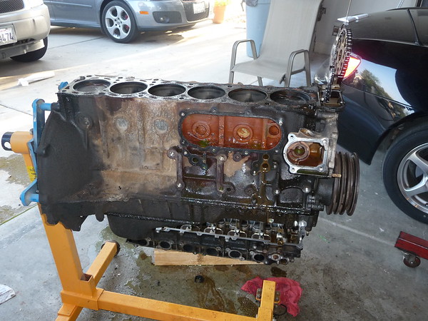

The engine is torn down and at the machine shop. really glad I went 'all in' and pulled the whole engine. Some scoring on the surface of the block, so it would have had to come out anyways.
Time to start ordering parts. Am waiting for word from the machine shop on condition, hoping that the head isn't too warped. Injectors going in for service tomorrow.
You're ahead of me. Keep us posted of how it turns out.

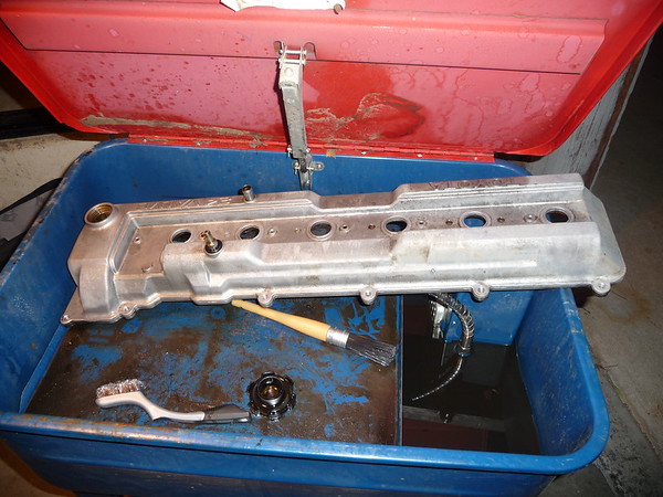

Sometimes the machine shop will let you use their "dishwasher." Makes cleaning easier and faster.

Worked on cleaning up and prepping various parts for re-assembly. I polished the raised letters on the valve cover, and then masked and primed it. All ready for some paint now, but I'll paint everything on the same day, after I have the block ready to paint.

By the way, I understand the trans has a metal screen that can be reused and a Toyota FIPG sealer on the pan. Evidently there is an aftermarket gasket available, but I don't know the part #. Looks nice! How did you polish the letters?
The letters were polished using sand paper. Started with regular 80 grit to smooth the rough sand cast down, and then moved up through the grits. At 320 switched to wet/dry and added water. Went to 1200. After paint, I'll re-do the 1200 and go up to 3200 for a mirror like finish.
The valve cover will be gloss back and the contrast should look pretty good. I also de-badged the plastic covers and they will get a shot of body matched paint.

Talked to the machine shop today. The #6 bore is damaged and the #6 piston also damaged. Looks like the #6 cylinder was scraping it's skirt on the bore. Should find out tomorrow if the block can be bored or not, depends on how badly it was damaged.
