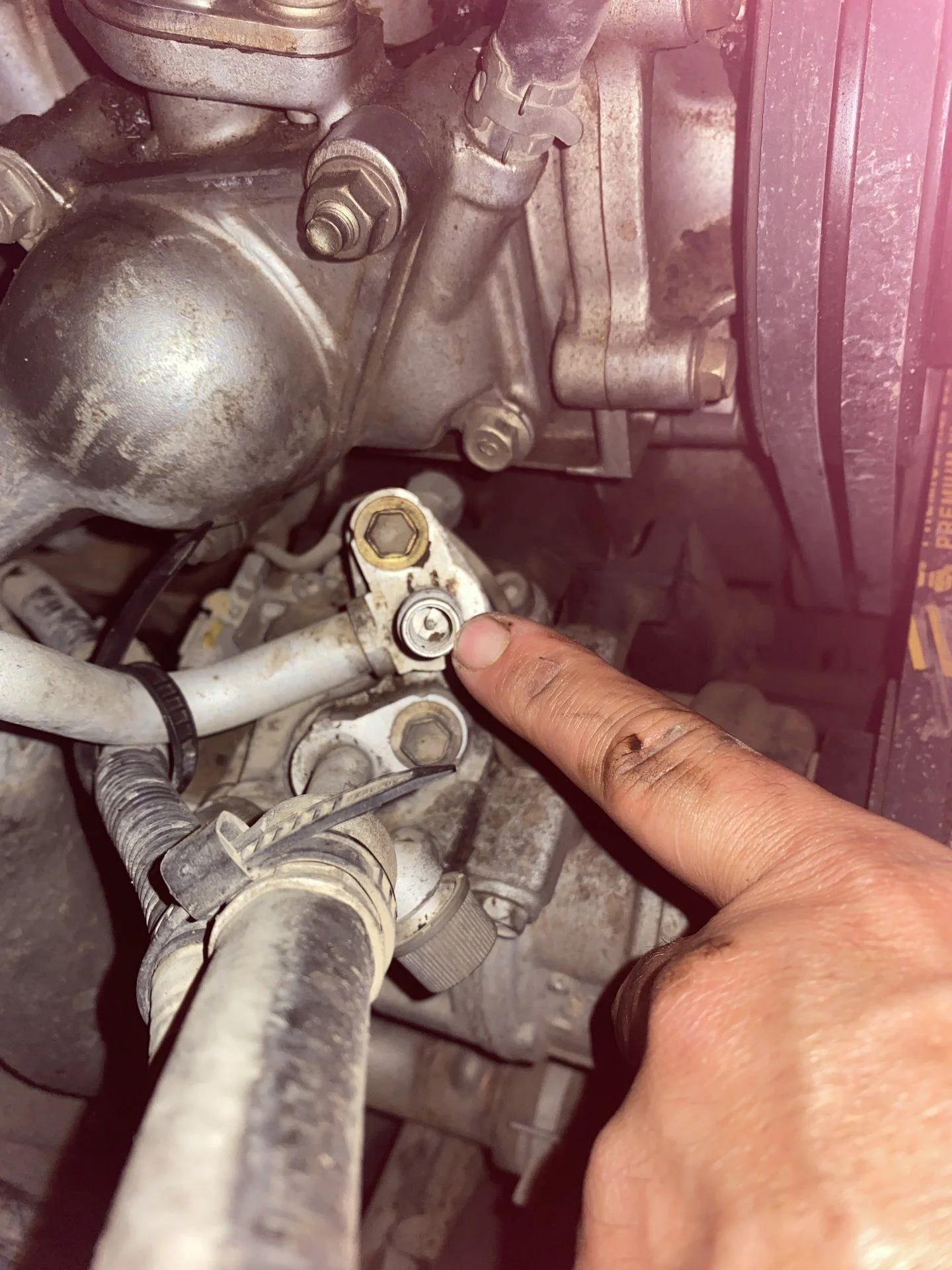

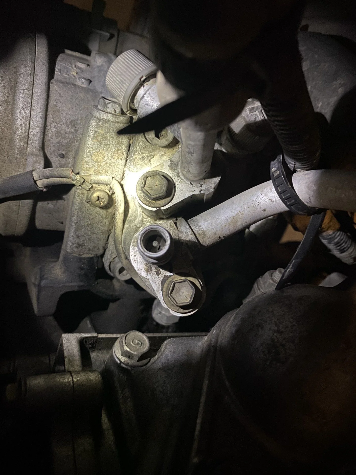

Hey guys, I went through and searched but came up empty as to what this may be. Looks like it’s supposed to have a plug in it but I’m not sure. I can see the threads internally and a nipple in the middle. It’s on the US PS near what I think are AC lines?
this one from a different angle.

Those are your air conditioner charge/check ports. See the port to the left of your finger with a grey plastic cap? There should be a grey plastic cap on there just like it except a different size.
That’s what I was thinking. I’ll find another cap. Thank you and what the hell would I do without you? 🤣 but seriously, thank you
