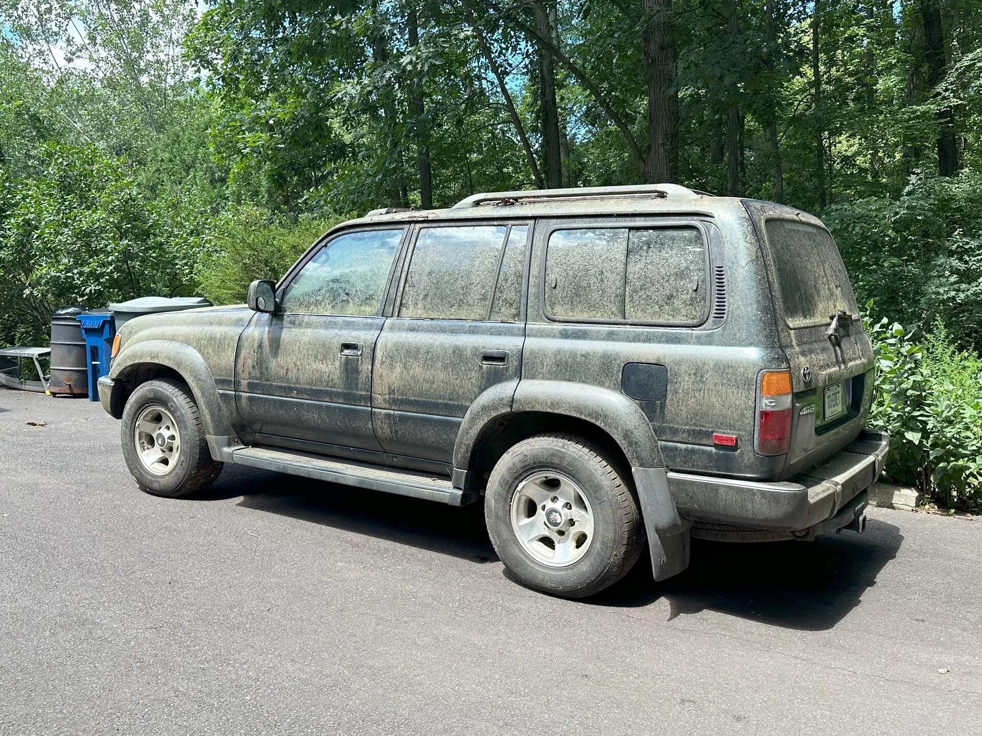

What started out as a donor vehicle purchase for my 97 LX has now turned into a resurrection project. I originally picked Swamp Thing out of the woods where it sat for 4 years as it was one of the infamous "ran when parked" vehicles. At the time, I was looking for some donor parts, rocker, panels, and a frame portion (thanks New England roads) so I really didn't care what the driveline was like.

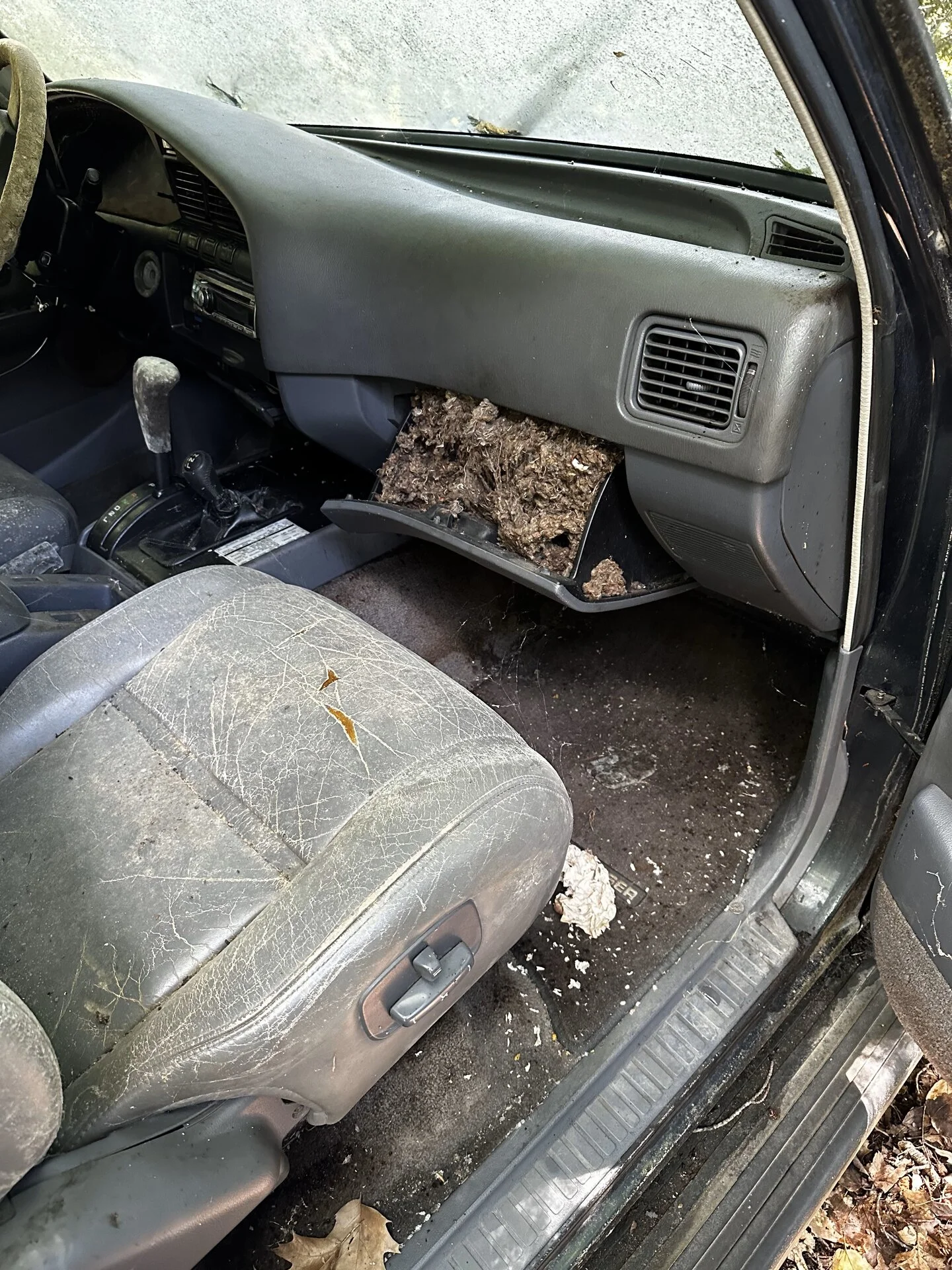

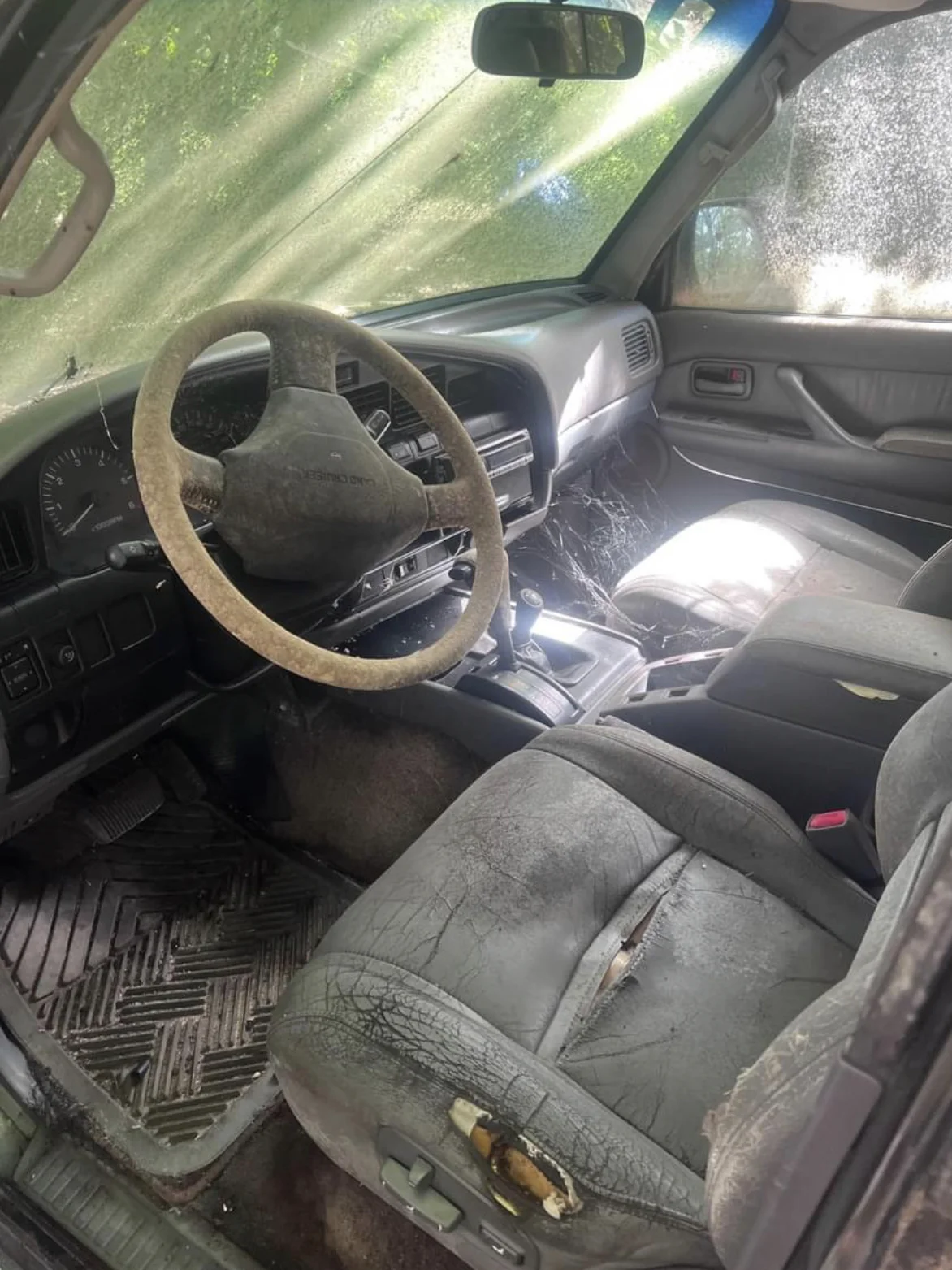

I went and looked and it was very solid, straight, only had minimal surface rust underneath and originally hailed from Georgia, but it had a few issues. The window was left down for a few years letting the funk of 4 seasons wreak havok on the gray leather interior and essentially turning it into a moldy mouse brothel. The owner originally parked it due to an electrical issue that kept draining the battery and the transmission would only shift manually. All that didn't matter, I needed the skeleton.

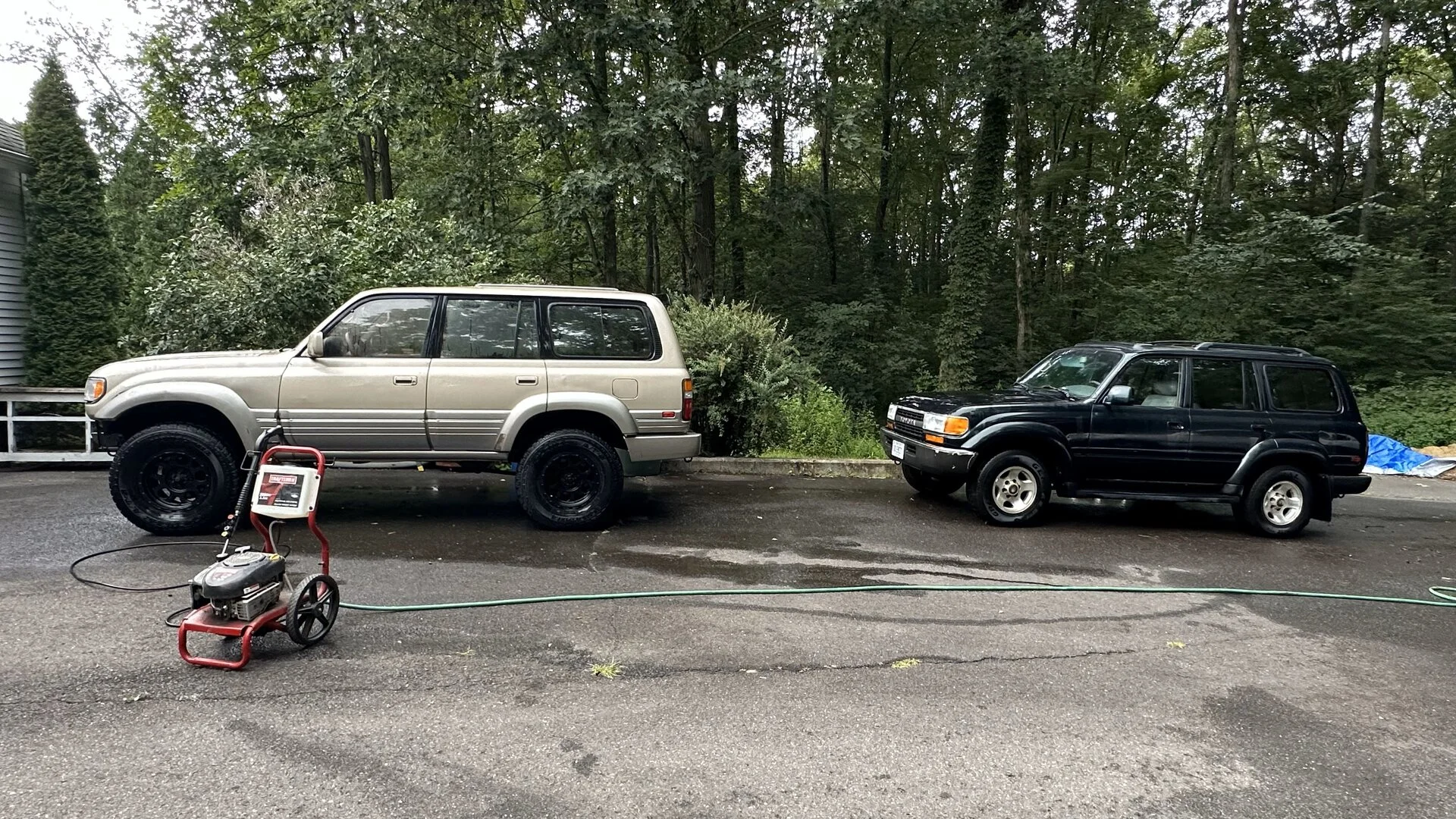

Fast forward a week and I get it home where my wife immediately questions my sanity. I tell her, it's just parts, I'll strip it and it'll be gone. So I power washed the dark emerald exterior and it seemed to have a little life left to it. I hogged out the interior in a hazmat suit then roll it into the garage to put it on jacks. Underneath was surprisingly clean for a vehicle that even sniffed New England and I started to feel a little guilt creep in about cutting it up. I figured, maybe I should see if it will run.
I put a battery in and tried to fire it up. Turned over good, had great compression, but no spark, no fuel. I did remove the mouse condo from the air filter prior to trying. Bad fusible link. Replaced that and a shot of starting fluid and it started right up coughing out years of nests, skeletons, and acorns that were stuffed way up in the tail pipe. A little fresh gas and it sounded beautiful with only 200k on the clock. Smoother than my 97 with 257k. Now I REALLY felt bad if I was going to cut this up.

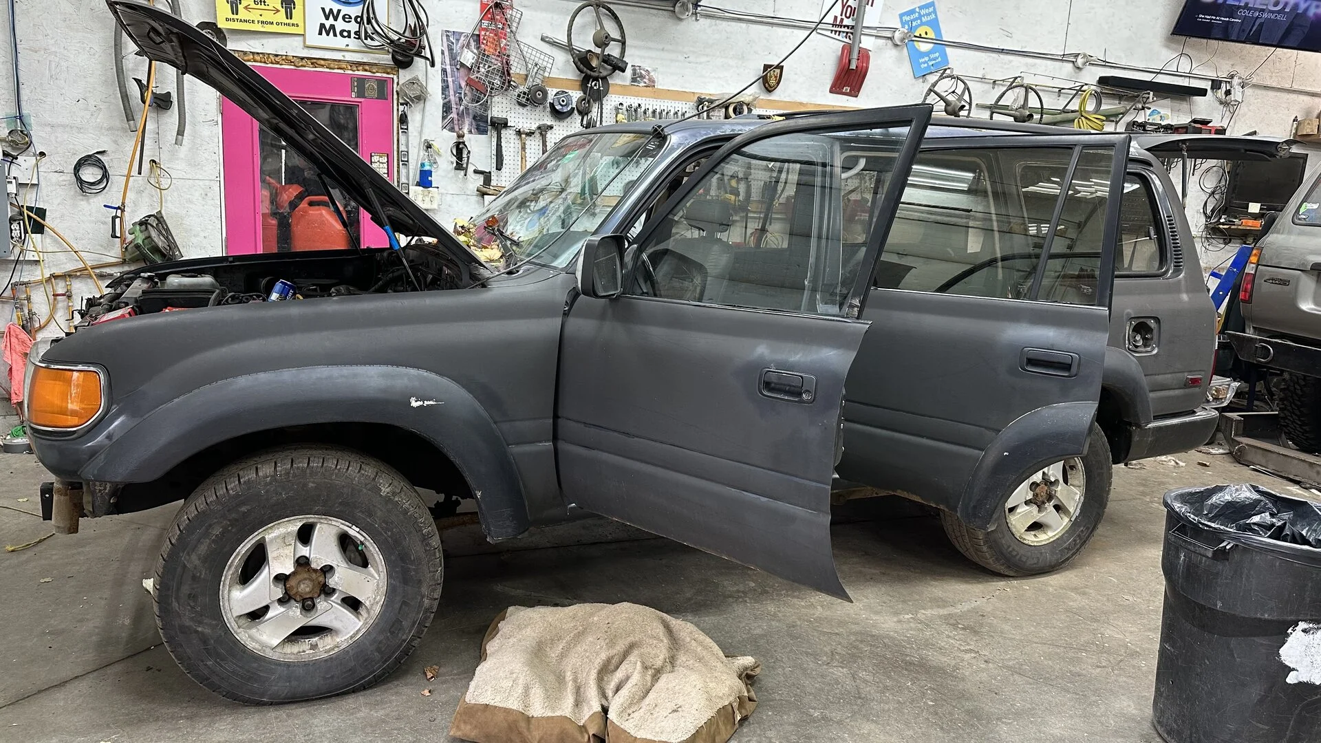

Originally I was going to work on the interior and a few gremlins then run it. Working with my friend, who is also a Land Cruiser guy, the plan that had started to come together was now a little bigger than I planned. What's on deck now? Full rust remediation and paint underneath and inside. The floors have surface rust in a few areas from the years of weather inside so everything is getting stripped, sanded, treated, and painted. We also picked up a donor 3x locked 94 with a blown motor that will supply me new front and rear axles along with everything needed to add the lockers. 2" Ironman lift, new 285/75/16 sneakers (TBD), new front seats...something comfy enough for road trips and trails. Fingers are crossed to this on the road for spring! Join me in my nightmare!!! :)

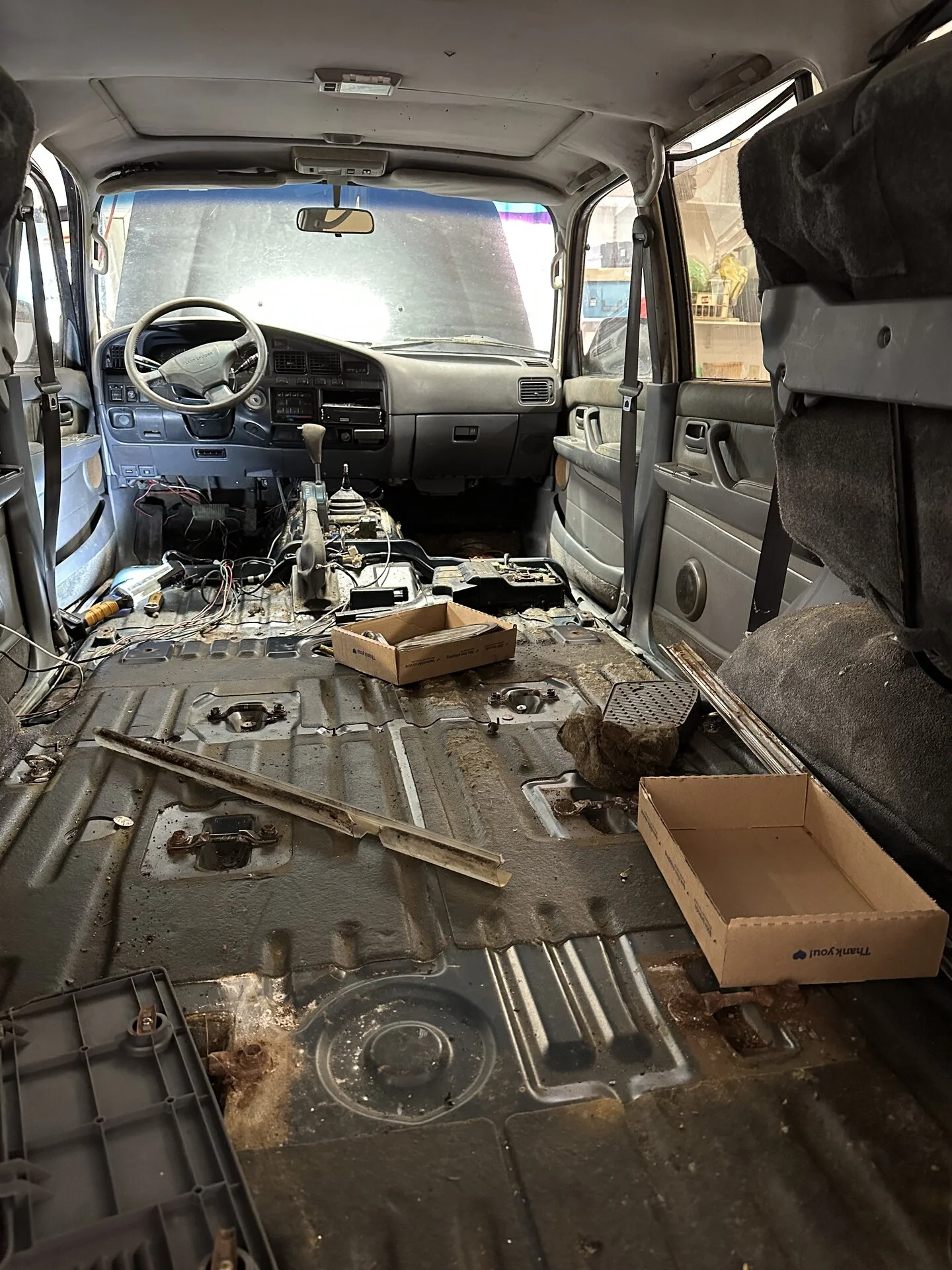

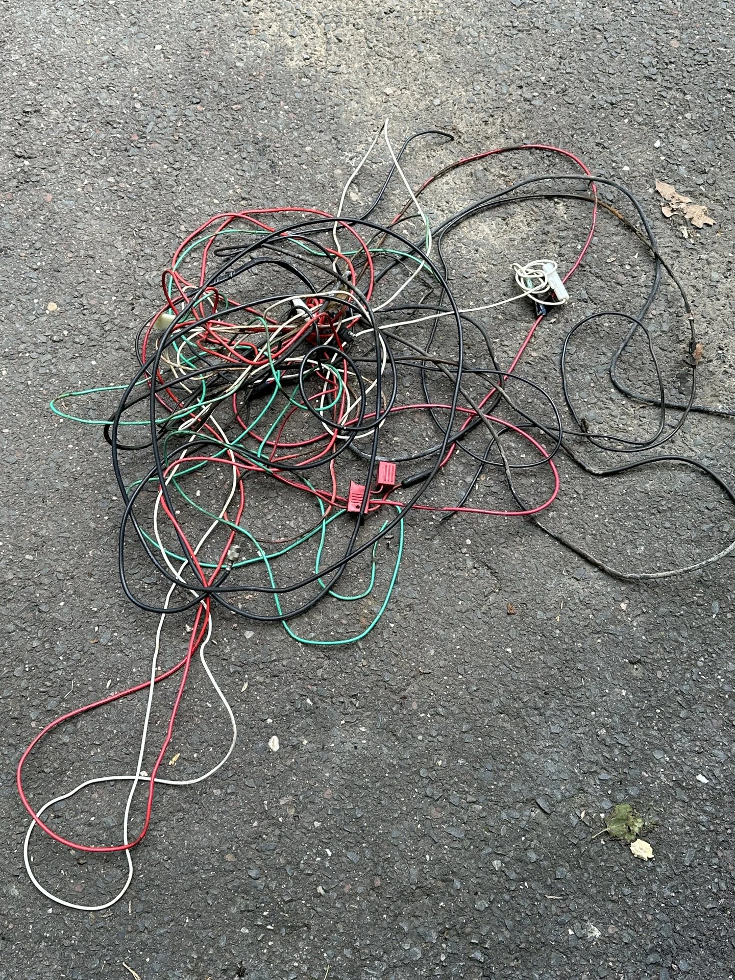

Interior is mostly hogged out now with some samples of mouse damage 🙄. Still need to pull the headliner which I’m dreading. I can feel nests up there. Debating on fixing the wiring harness or throwing a new one in. Also some of the extra wires I found that were laying live in miscellaneous areas.
fun fun, put some heat shield / sound deadening material on the inside of your firewall.
In the plan.

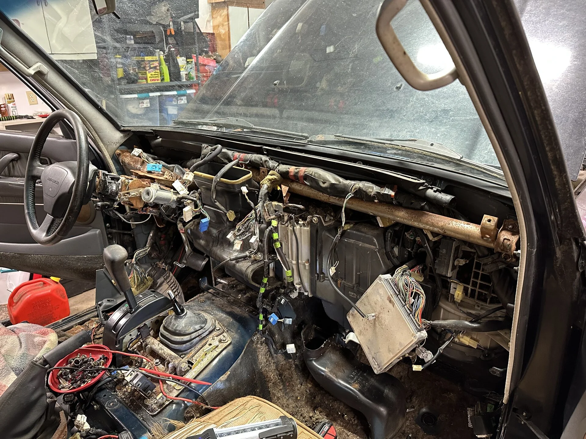

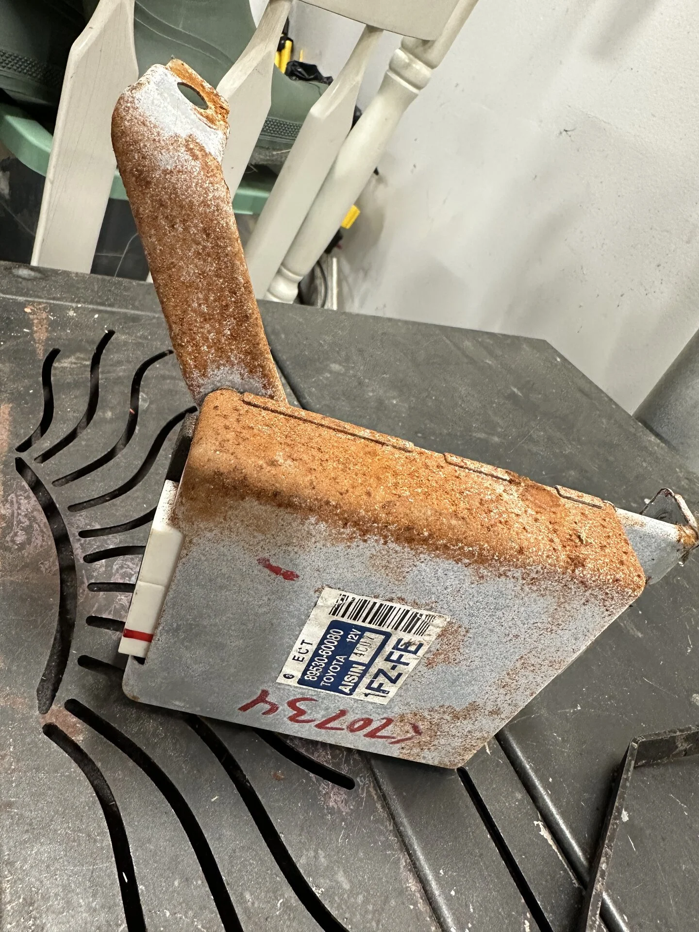

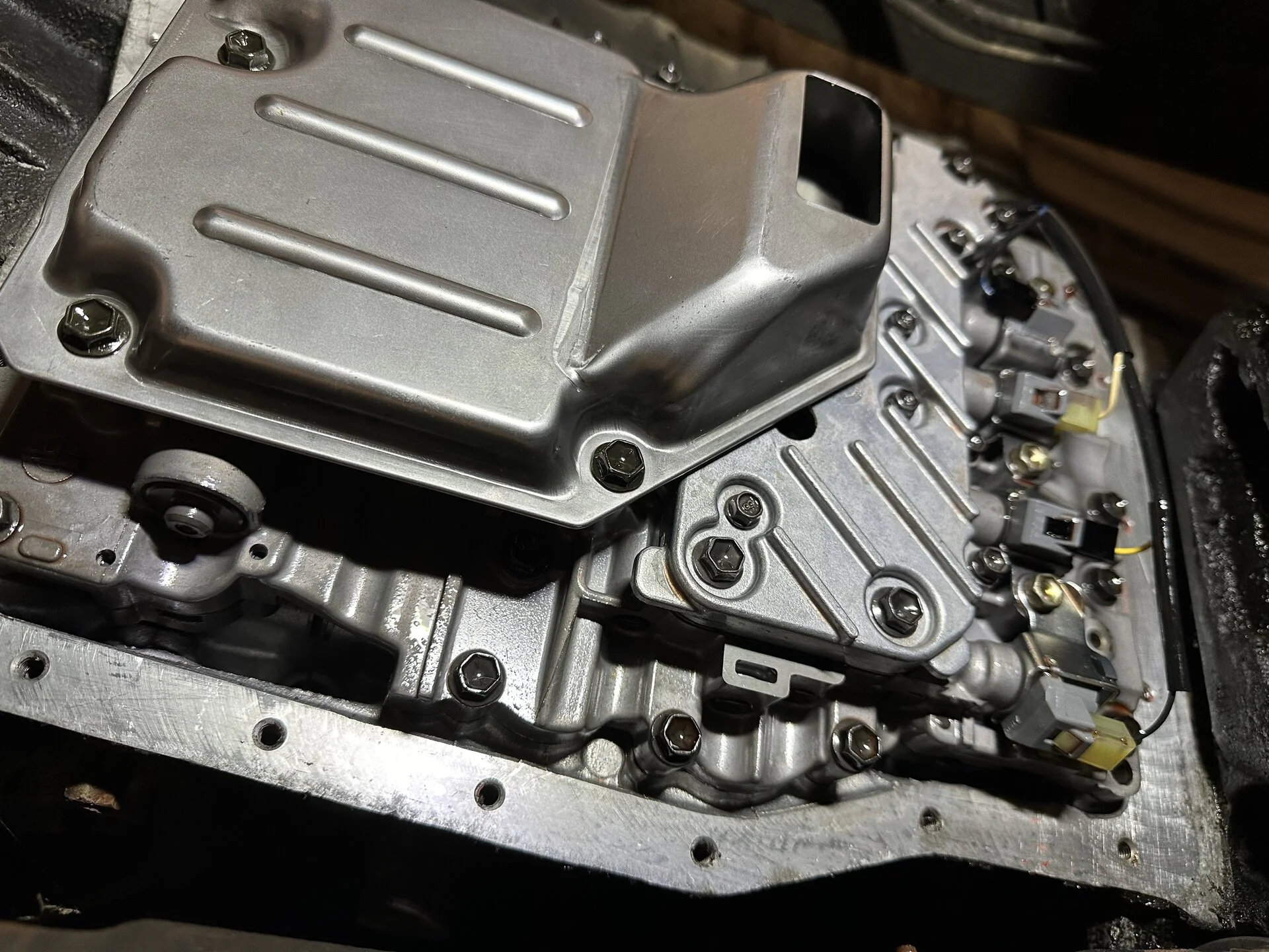

I’ve got the new tranny solenoids in and same issue with it not shifting.
So I’m thinking it’s gotta be electrical. Connections seem good, then I pulled the TCM 😬
I’m thinking this could be part of the problem. Getting all the stuff from my donor vehicle this weekend so 🤞

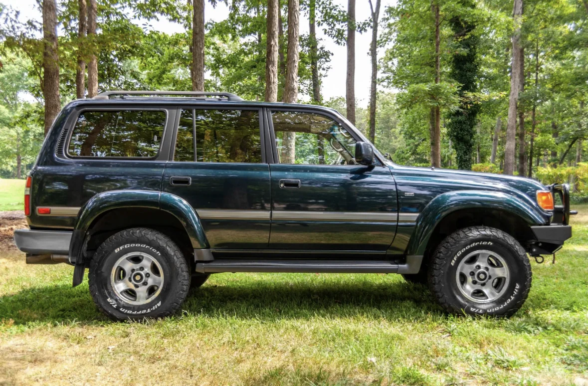

This is ultimately where I want to be with it when I’m done:

It’s the best year and best color
And no plastic cladding 😉
What’s more to say !!
I do like the color and year and the right amount of cladding lol. I’ve always loved the fender flares on these.

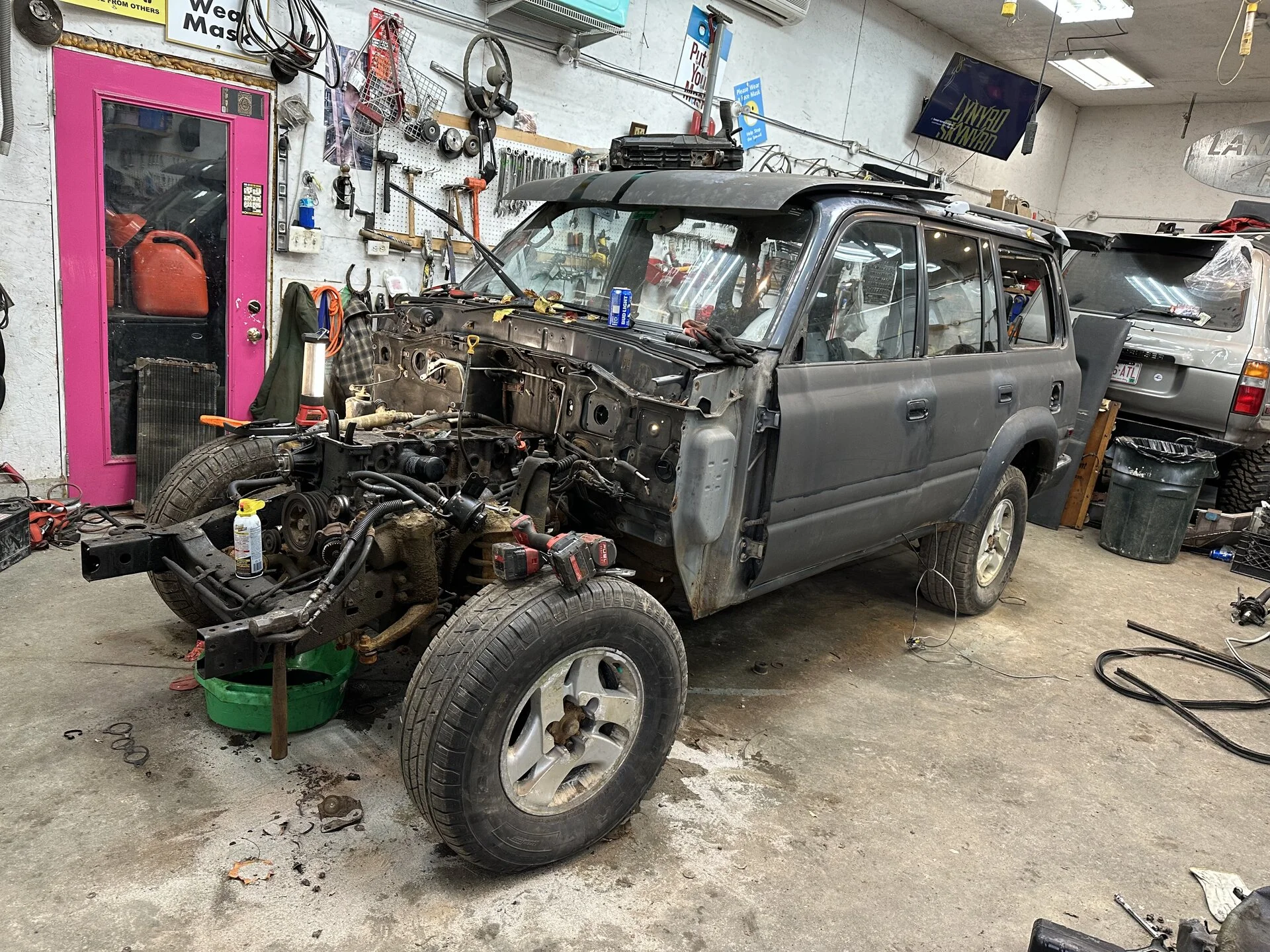

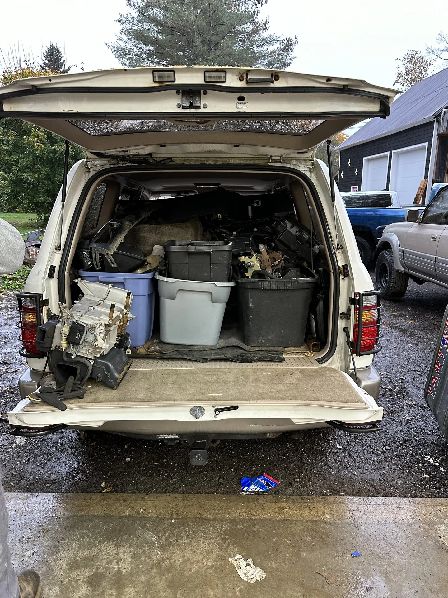

Got the new donor cruiser stripped and if anyone was, an 80 will nearly entirely fit into the back of a 100
