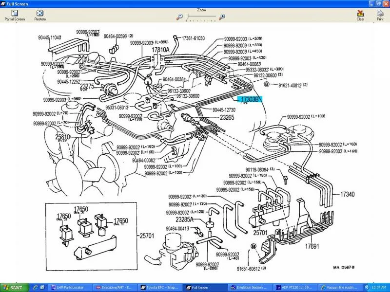

Random guess on my part but could be a simple vacuum line might have slipped off. Here is a vacuum line diagram for the 3FE pulled off of a thread on here

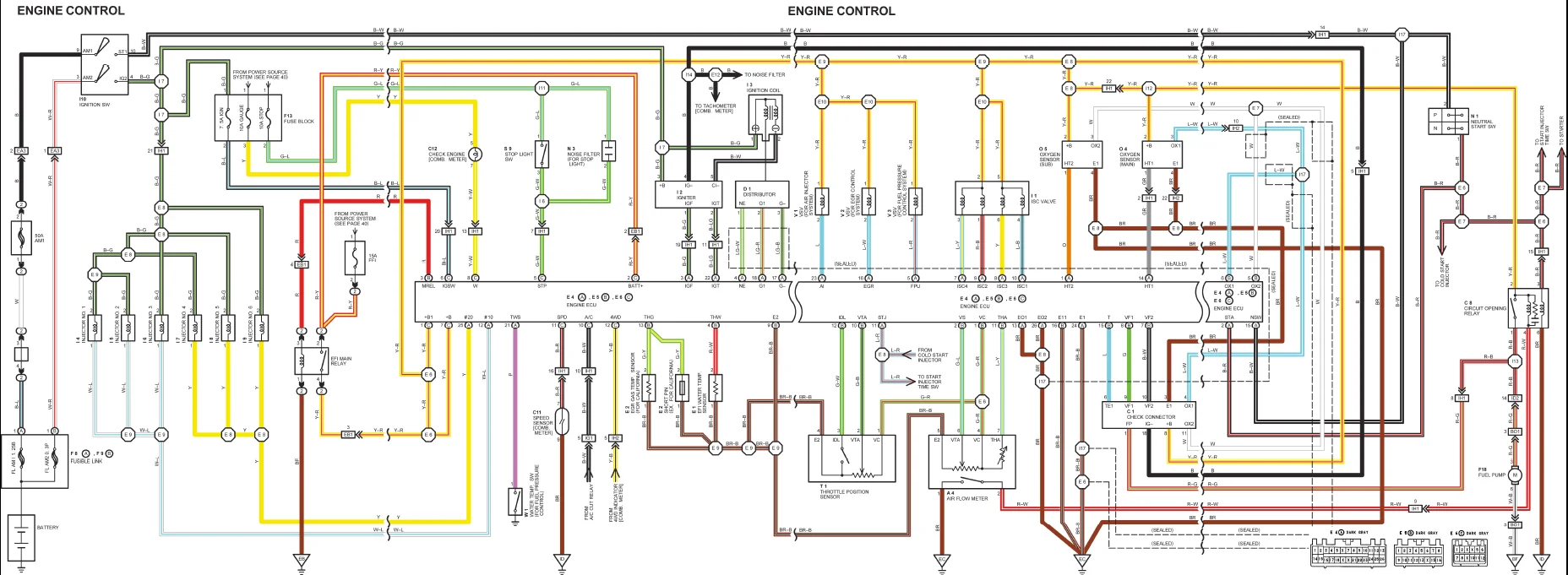

I've got to say that this diagnosis is highly unlikely to be the ECU. The ECU grounds the 2 sets of injectors individually. If it's able to fire 1 set of 3, there is no reason to think that it won't be able to fire the second set unless there is a failure in the wiring from the ecu to the injectors.
I'm not saying that it's impossible to be the ECU, but ECU failures on a 3FE are exceedingly rare. In the last 20 years I think I've heard about 5.
I would be checking continuity between ECU connector E4 pins 10 and 20 to the 2 groups of injectors. Pin 10 is injector 1-3. Pin 20 is injector 4-6.
Also be certain that all injectors are getting +12 with the ignition switch ON to pin 2 of each injector (black/green stripe).
If all that checks out, then you can assume the ECU is at fault.
