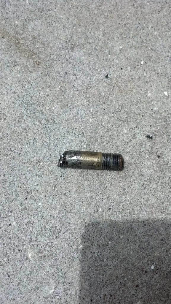

im surprised that stud is still there.. i had a rock break one off .. worst case just cut it off and replace the stud

Thinking of removing the 3 lower studs and replacing with some allen head bolts because I don't see these lasting much longer.

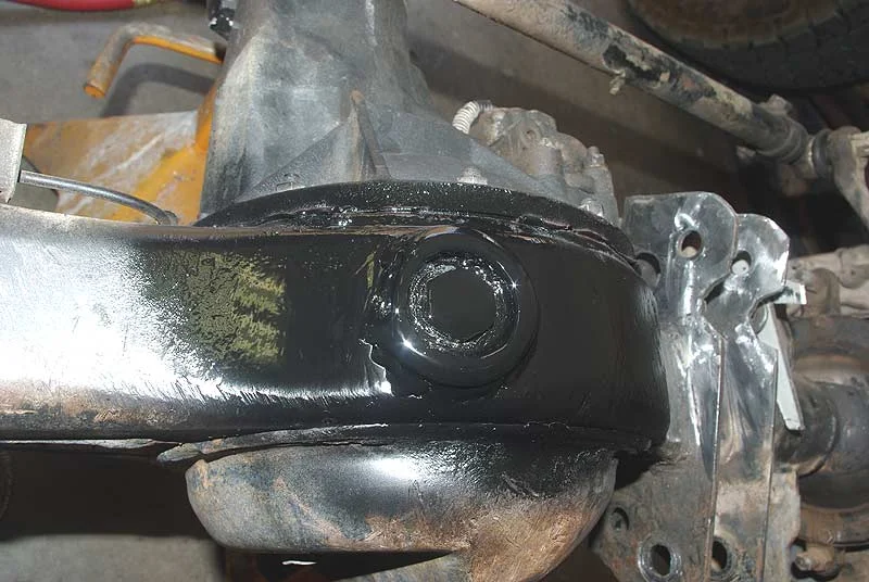

Have done a lot of things over the years. Including welding up the drain hole and removing fasteners to drain, found that to be a pain, slow. Don't see that kit being thick enough to help? Now we mostly just apply sacrificial metal from the mig gun to the rings, part of the maintenance of a wheeler.

Adding 1/2" metal, takes a lot of rubbing on rock to wear it away. This is not a done pic, put more metal in the ring area.

Adding another ring around the old one, works well, have done this on the truck many times. Again not done, the inner area was built up and "ramps" added front and rear.
This one is done, hard to see how tall it is in a pic.

Nice work! I did notice the skid is too thin to completely cover the drain plug so I was planning an adding a bit more material around it. That way the drain plug will be fully recessed.
Be careful welding that much on the housing, they are easy to warp. Weld a bit allow to cool, go again, have seen many of them turned into bananas from jobs like that. If you're planning to do it with the axle apart, best to bolt/properly torque a diff housing in, prevents/reduces the likelihood of the flange warping. Have seen a few of these, if the diff doesn't sit flat, it leaks, but more importantly, doesn't stay tight.
