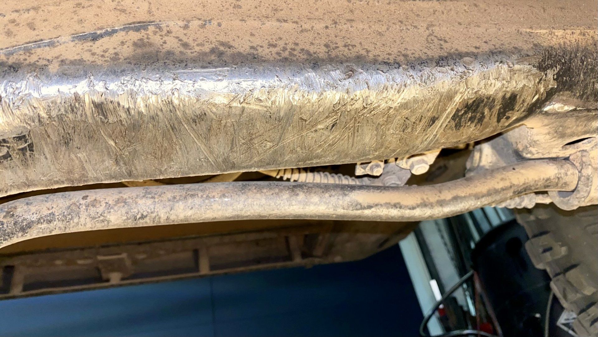

the ballistic fab rear 80series 9.5 guard i received fit like crap. every bend in the wrong place or angle. Had to literally cut it into pieces then reweld to fit.

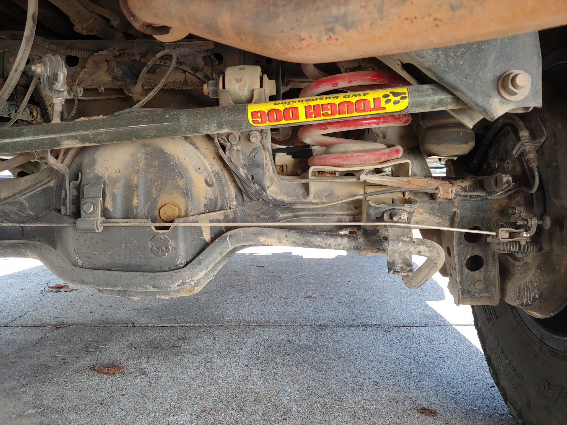

Here’s the Moto Farkle lower plate burned in. The 1/4” steel isn’t thick enough to cover the drain very well, even with a bead built up around it. Planning to add some scrap to both sides of the drain plug.
you should have bought the ballastic fab lower plate. It goes way over the factory ring. See the pics in crawler build thread.
I bought the Moto Farkle awhile back not knowing about the Ballistic. I bought one from Ballistic for the front though. Wish I had know about the Ballistic front plate like @jcardona1 has on his rig before mounting the Trail Gear plate too. Strike 2
