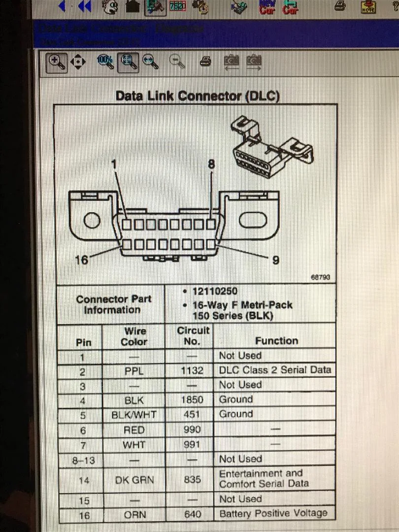

Shot in the dark but for those of you that have reworked your wiring harness:
I can’t connect to my ECM via HP tuners or even with a normal scanner. I double checked and ohmed out Blue 58 serial data to OBDII port and have continuity. I have my 3 grounds going to the negative terminal and have wired up the positive side through a relay but. The OBDII port has power. It lights up my HP tuners device but I still can’t actually connect. I emailed Brandon from LT1Swap but haven't heard back from him.
according to alldata green wire is for for body so you need PURPLE wire for engine diagnostic signal here is picture off data plug pinout so at pin #2 you must have purple wire
It was purple because it came from a splice where the BCM serial data connected to the ECM serial data. I'm just using the green wire straight from the ECU to OBDII, cutting out the BCM serial data.
have you bench tested the ECM?? i purposely built a test harness for the PCM/ECM so i could flash it on the bench not factoring in the wirign from the vehicle, I ended up having a couple minor issues with my harness one being I had to keep the key int he crank position hahahahaa
