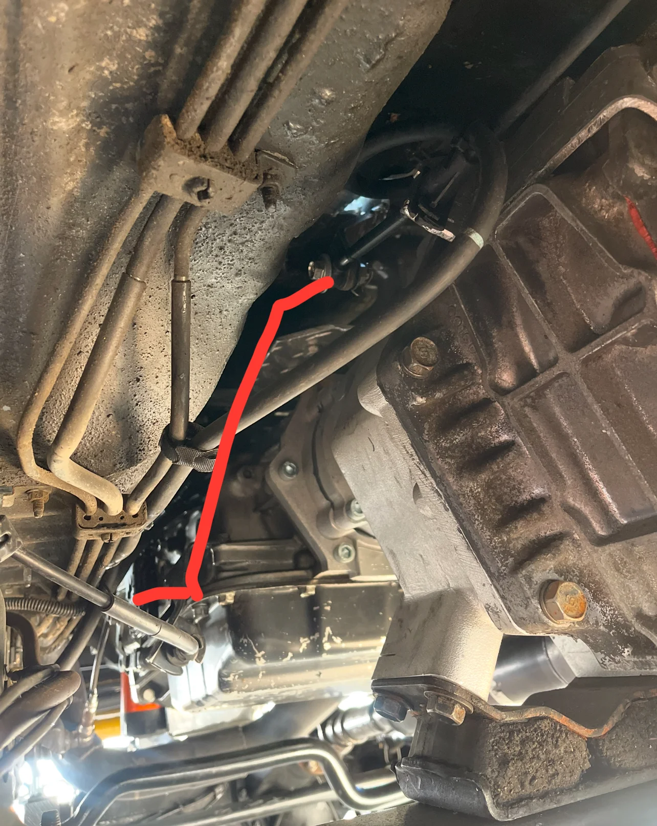

This looks interesting but $$$. Gives me some ideas on when I redo my setup using the trailblazer cable. May have to build a bracket like the bracket in the lokar setup. The design and functionality of the lokar is similar to the trailblazer. I had to look up the shifting position when I fabricated my shifter. Haven't work on the safety neutral wiring yet, engine starts in all gear. So knowing the shifting position makes it safe when you start your engine. Photo below helps to see how it works, gear position. On the other hand, this video may give us some inspiration using the rod setup. I feel like we can make it work by bending the rod.

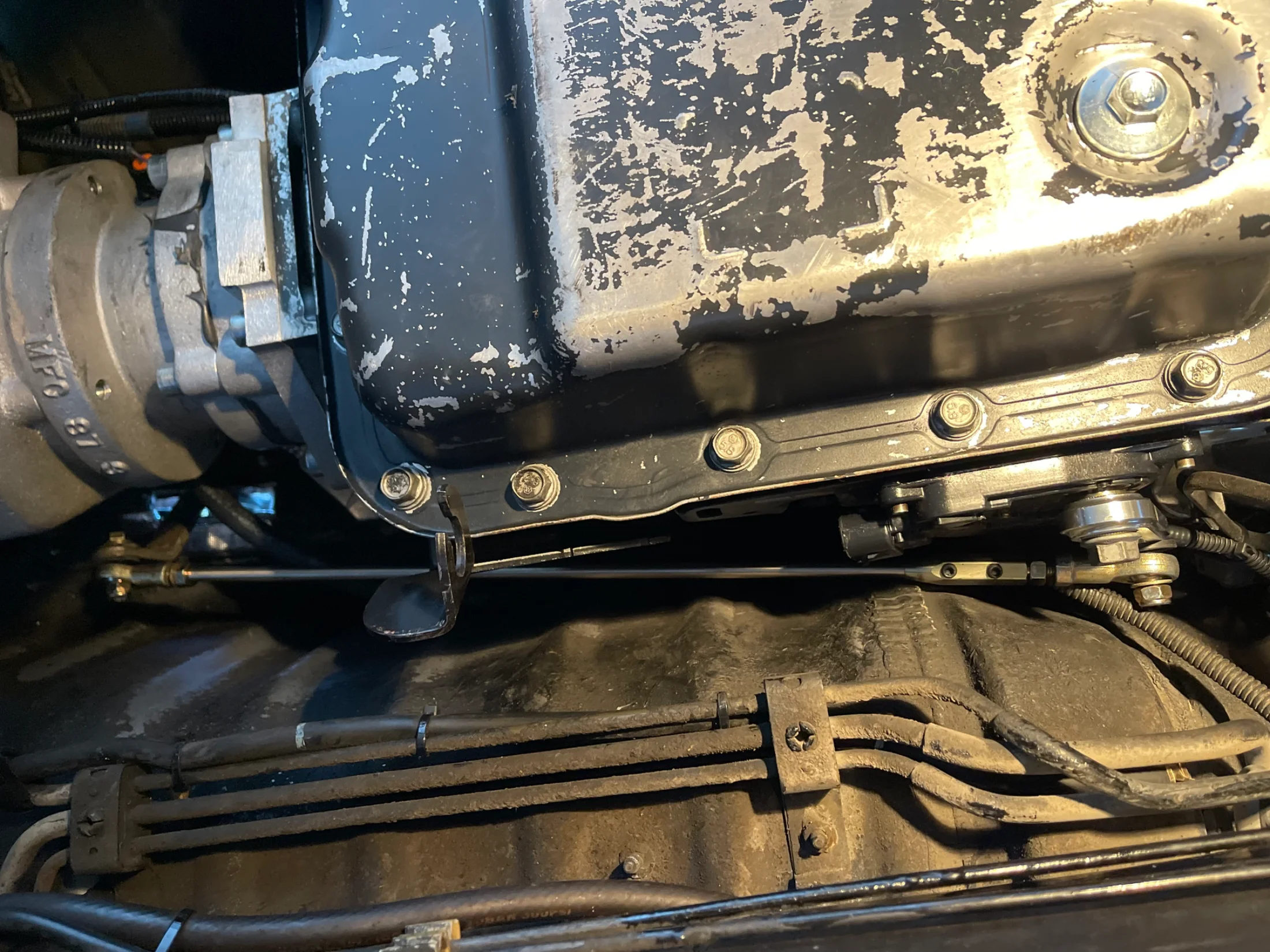

I've used a lokar shifter and rod setup on a 84 fj60 lq9 to 4l80e it worked just barely due to the transmission to shifter location . I say this because the distance from the transmission shifter lever to the lokar shifter arm was almost to close the angle was pretty steep from one to the other if the engine and transmission were further back it wouldn't have worked and if the shifter was further forward it wouldn't have worked if that makes any sense.
The 96 fzj80 I finished up last month was a redo from someone who thought they knew what they were doing that said the transmission tunnel was cut for the shifter arm to go on the driver side and had the trail blazer cable and a wonky bracket to hold the mounting part of the cable nothing was correct so I changed it back over to the passenger side like factory 80 shifter.
I also at that time looked at possibly using a shifter rod that didn't look promising at all.

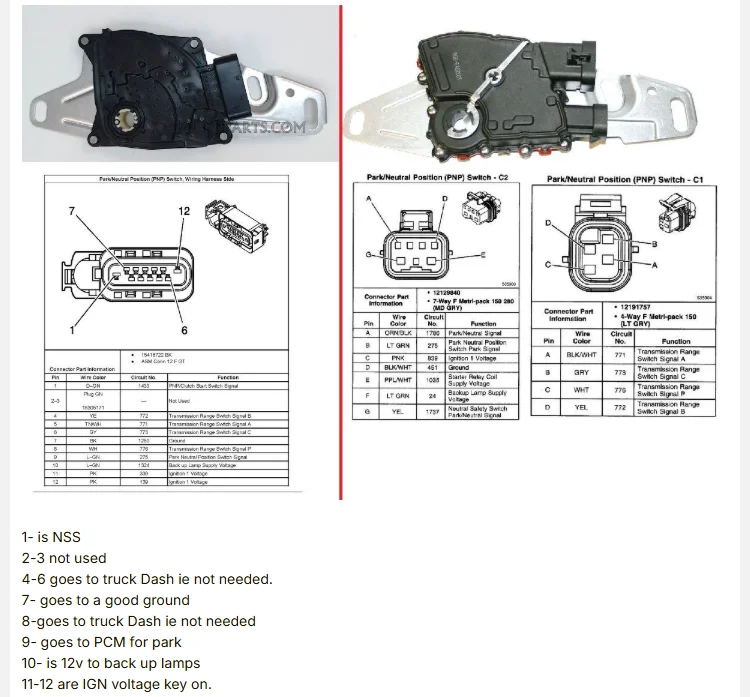

I used this to hook up my neutral safety and reverse lights on my 4L80e. On my 96 I retained the yellow wire for power for reverse and the red with black stripe wire off the old neutral safety switch for reverse lights.
This will work but if you want your shifter indicator to work you will need the Dakota digital box it can make the indicator lighs work reverse lights work and neutral safety switch if not one can use this or just wire it up yourself withe multi function switch on the 4l80e.

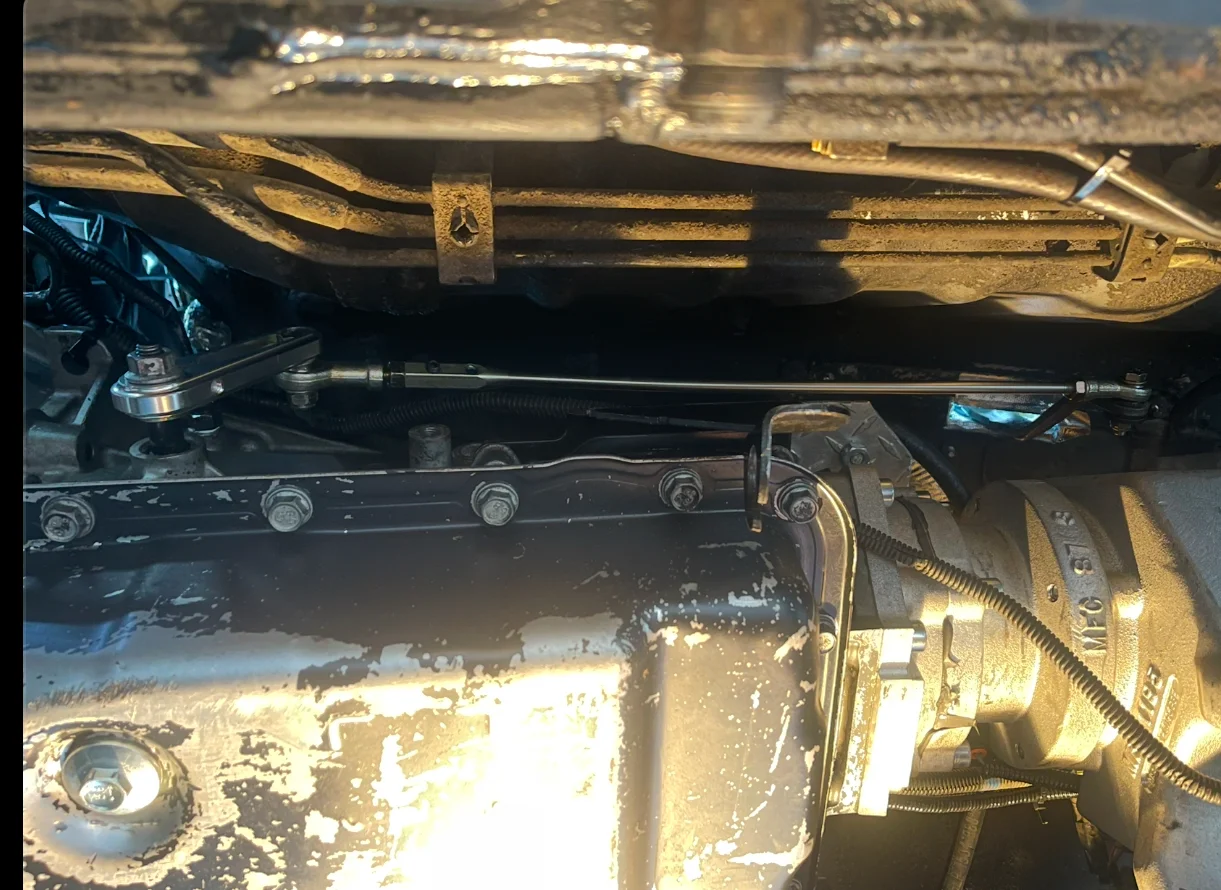

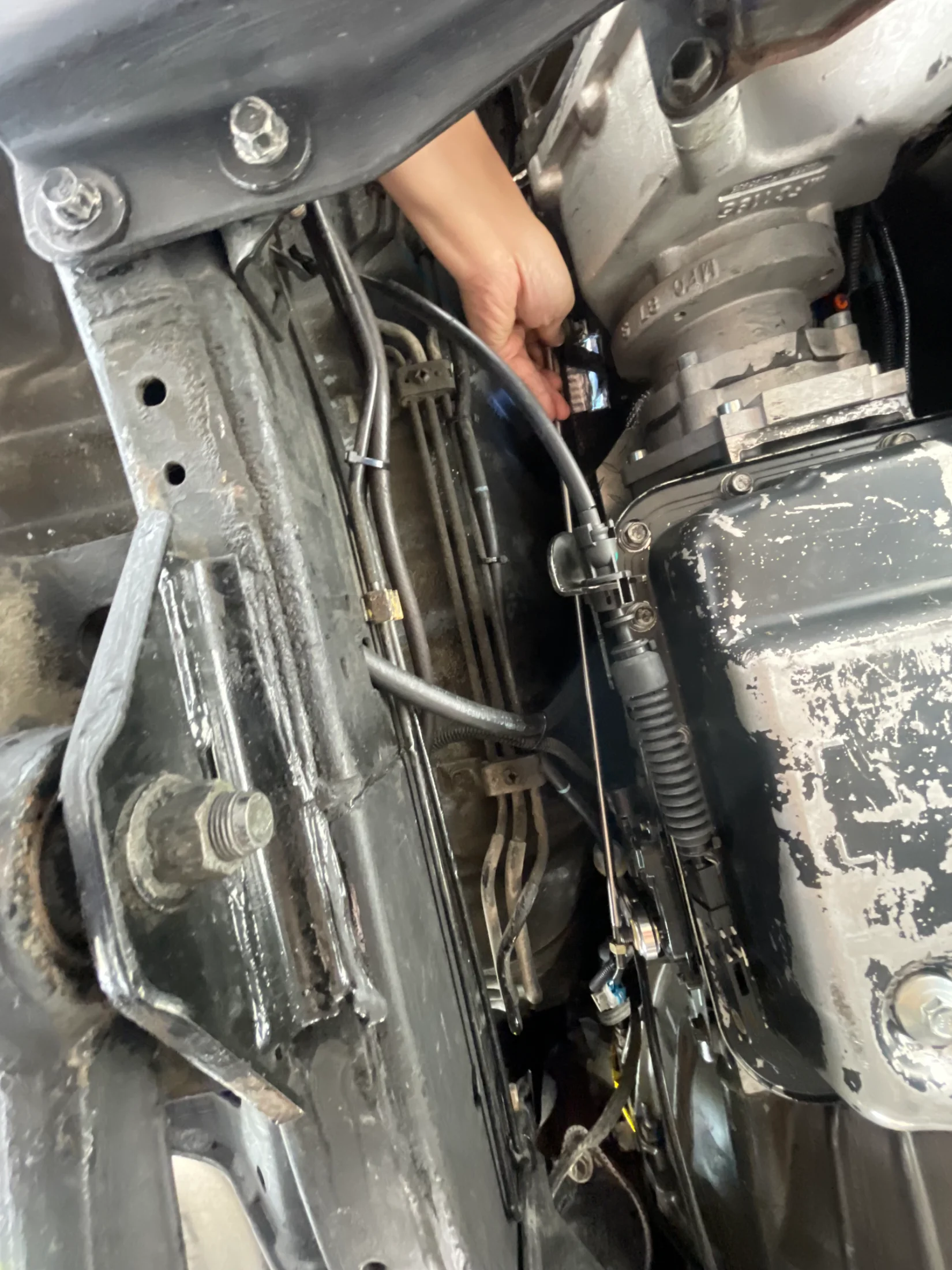

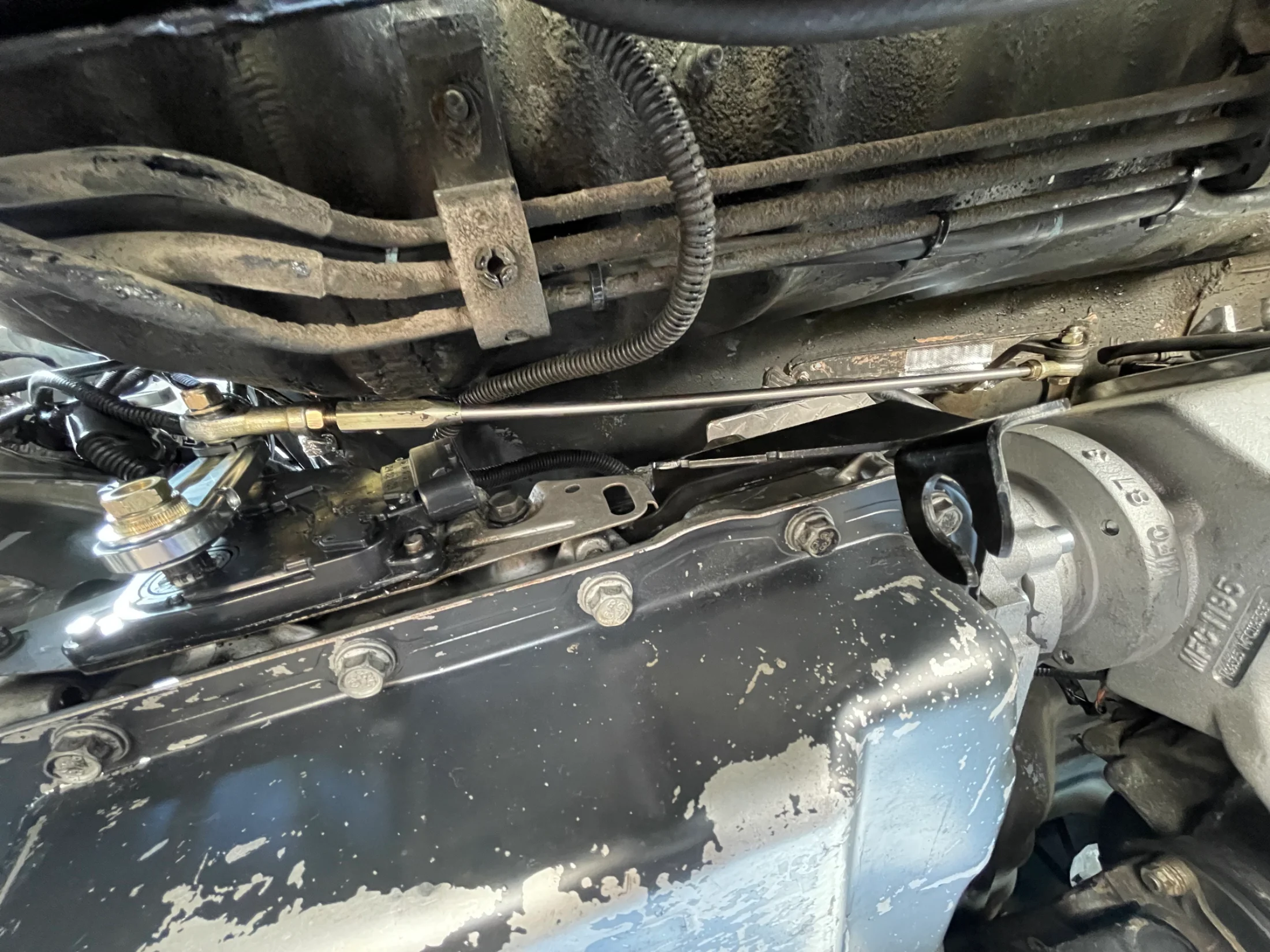

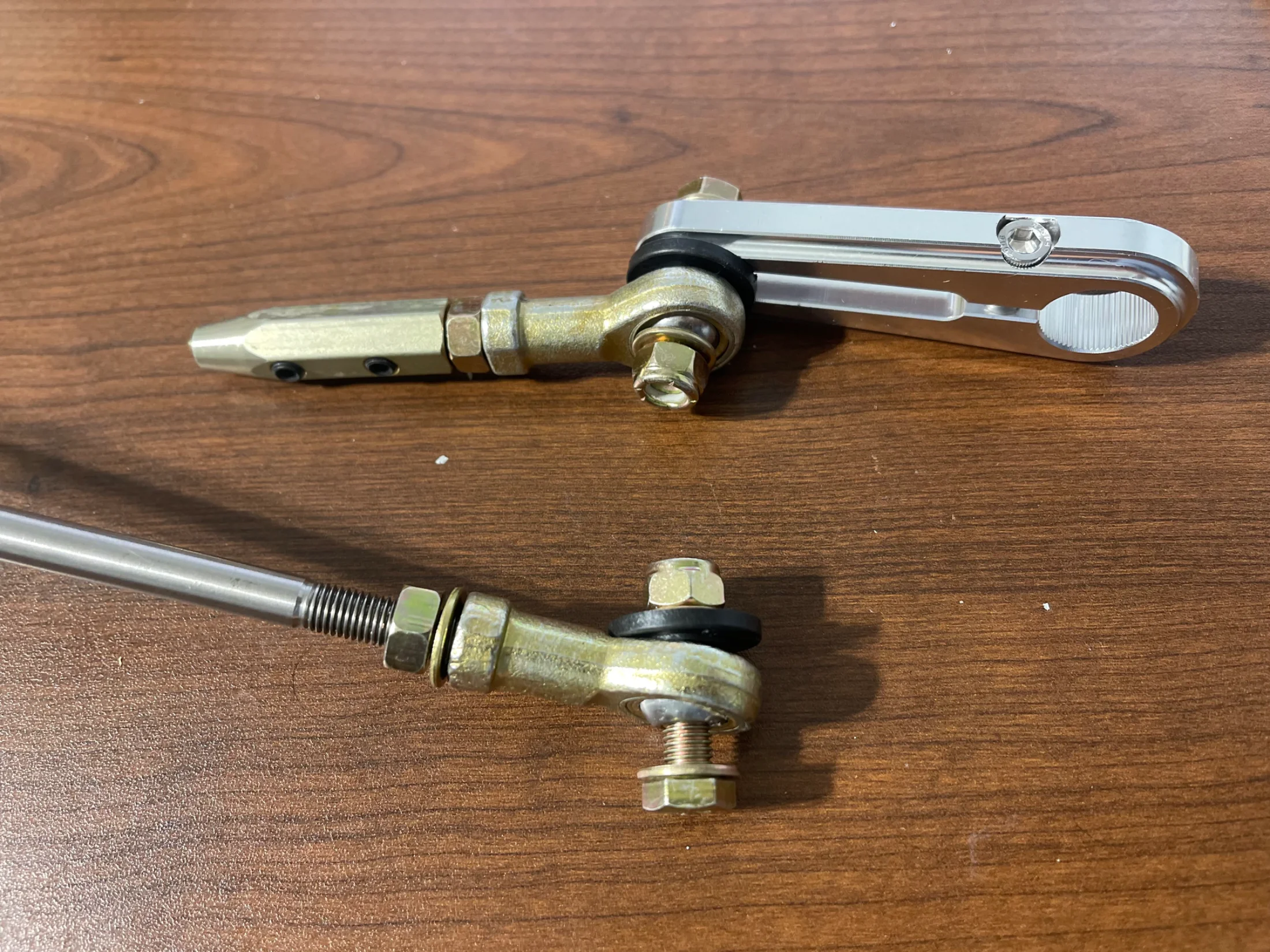

Absolutely agree you. I wanted to use the lokar but got frustrated and no time so I used the cable method. As you can see. Yeah not much space since we have to flip the shifter plate upside down. The lokar arm is adjustable, wonder if that will make the shifting more accurate.

$150, lots of good beers. Neutral safety switch link.

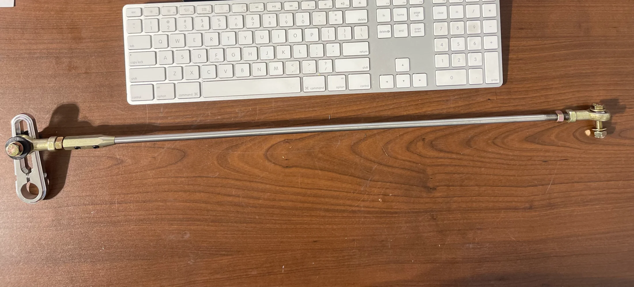

I hear yea. I started this shifter convo, again, because I wasn’t quite sure what modifications people were making or any at all to which end of the shifting mechanism and wasn’t sure where to start with the measurements. But I got it figured it out now. I ordered parts. We will see what works best and go from there. And return what doesn’t haha. I appreciate you guys.
Unravel my curiosities. I’m going to revisit this with my old man. Maybe some bend here and there.
I think this is exactly what I am looking for, I was struggling with using the trailblazer cable.
Do you have a part number for the parts you have assembled?
EDIT: I think I found what you you used.
ADJUSTABLE COLUMN SHIFT LINKAGE FOR TH-350/TH-400/700-R4 TRUCK 26" LENGTH - https://lokar.com/aca-1811.html

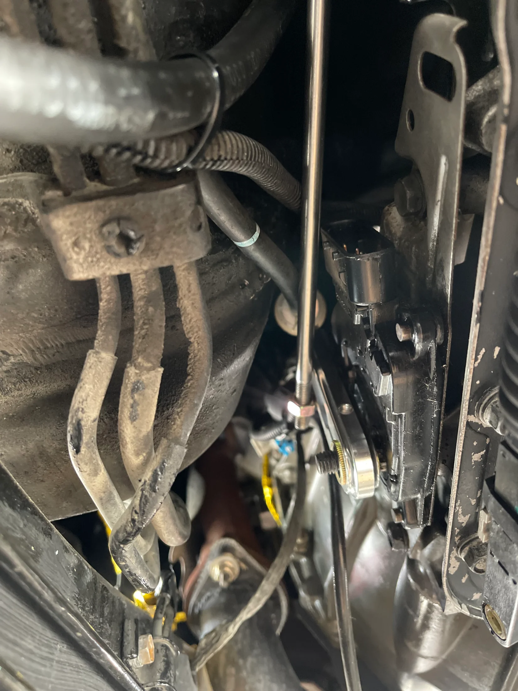

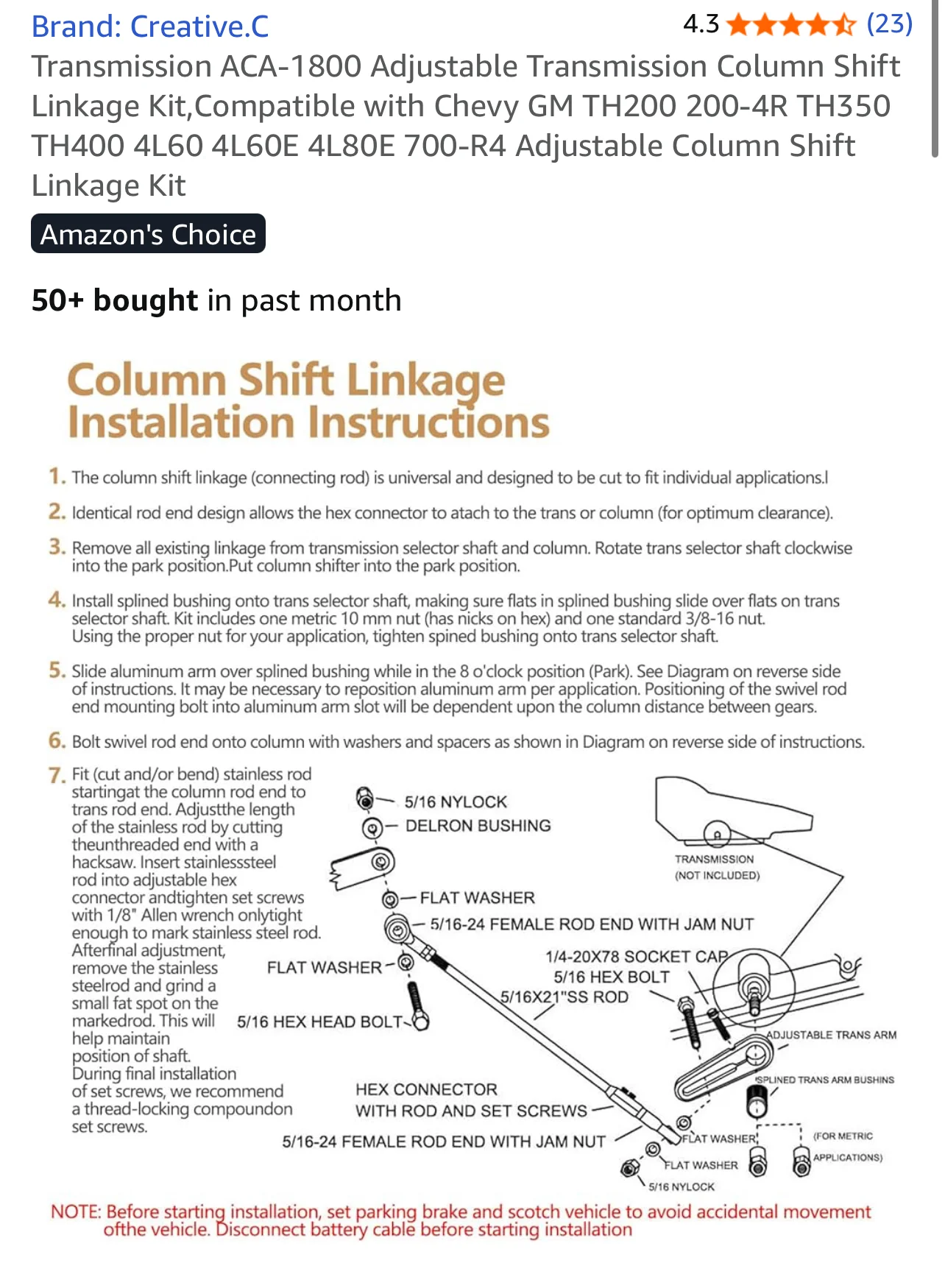

I bought a generic one off eBay they no longer have it but similar to one on Amazon.

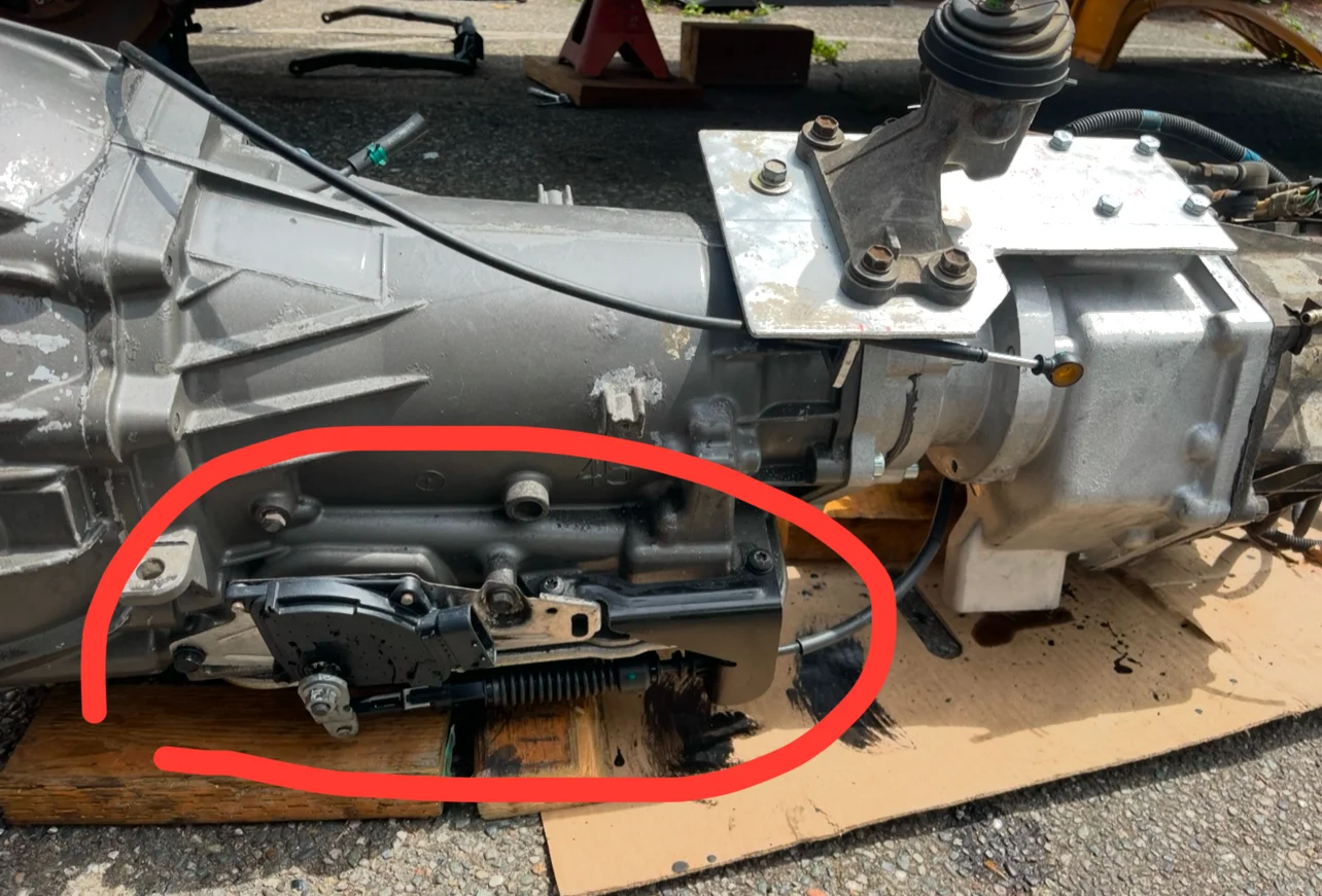

this one. In the future I will probably switch the arm to the lokar or the whole kit. The arm I got isn’t as snug to the lever (image 3). I didn't know that it would work so i bought a inexpensive one to test. Hope this helps. This works for the 4l60e not sure on the 4l80e. However, dont see why it won't, the adjustable tran arm is somewhat identical to the 4l60e. With the cable, the feel of the shifting was wobbling and sometimes I have to move the shifter up and down to go into gear, was annoying. This video gives you an idea on how to install.
With and without safety neutral switch. Believe will work if you bend the rod at a certain angles. So much more clearance without the safety switch.

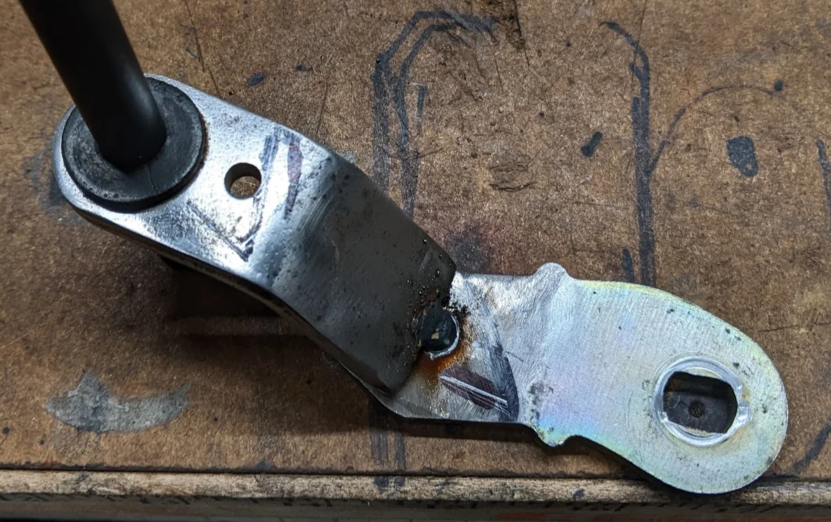

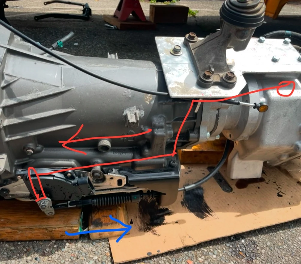

idk, I am kind of thinking I should have made measurements of the shift arm modification I did and transferred them to CAD, and sent the design to sendcutsend for others. I have a number of posts on the modification in my build thread (1, 2, 3).
All you would then need to do then is to 3D print the cable bracket mount, and now you have a perfectly working shifter.
I don't think I will be pulling that shift arm out just to take measurements though...
