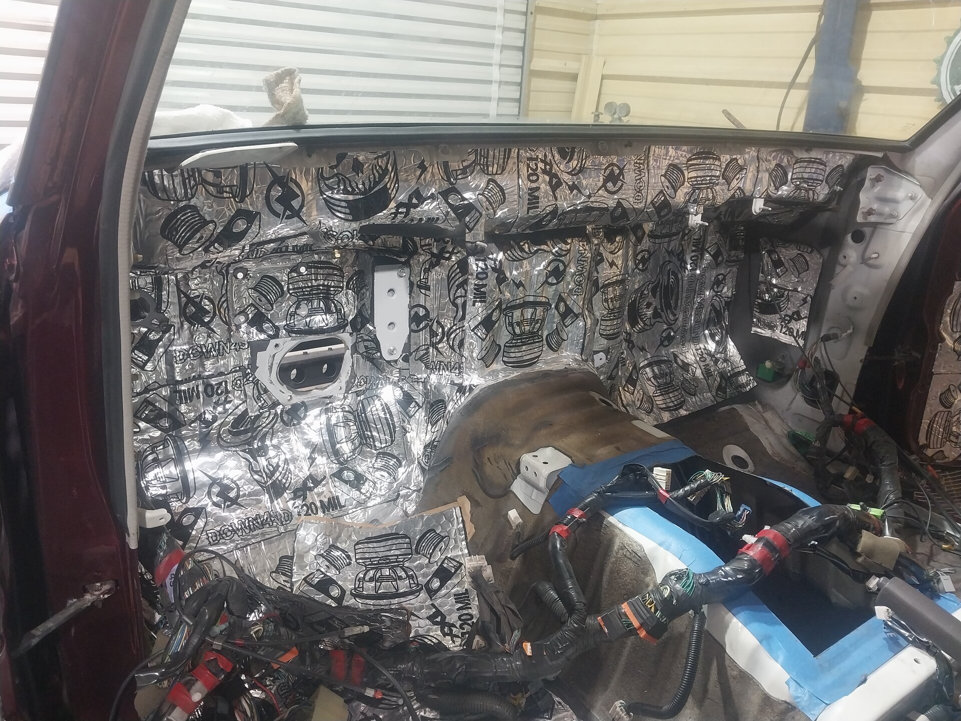

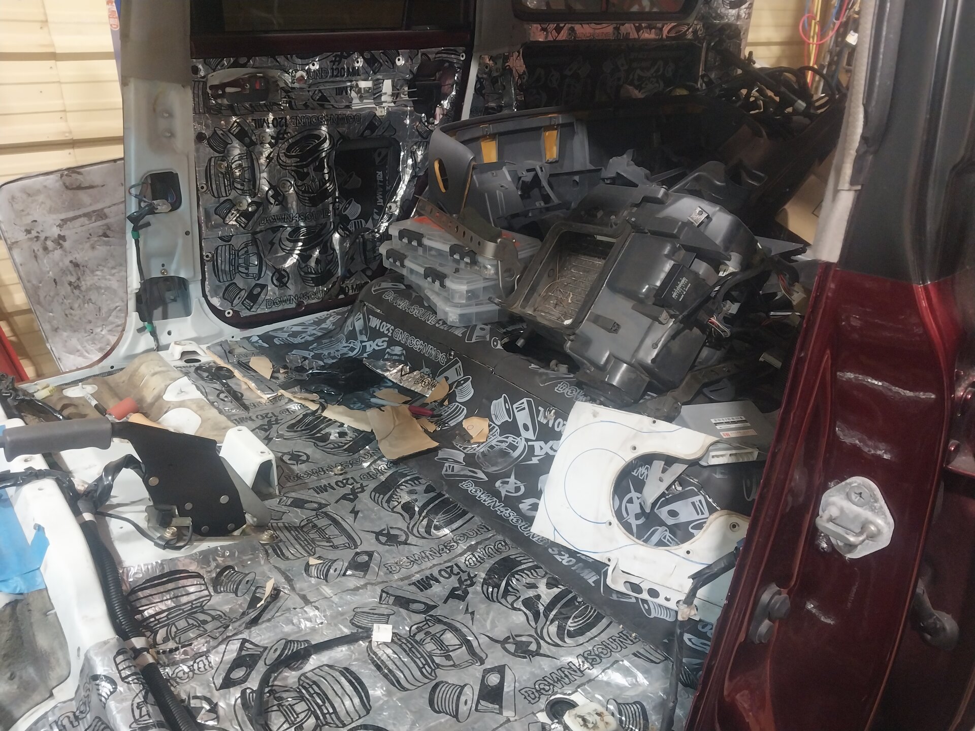

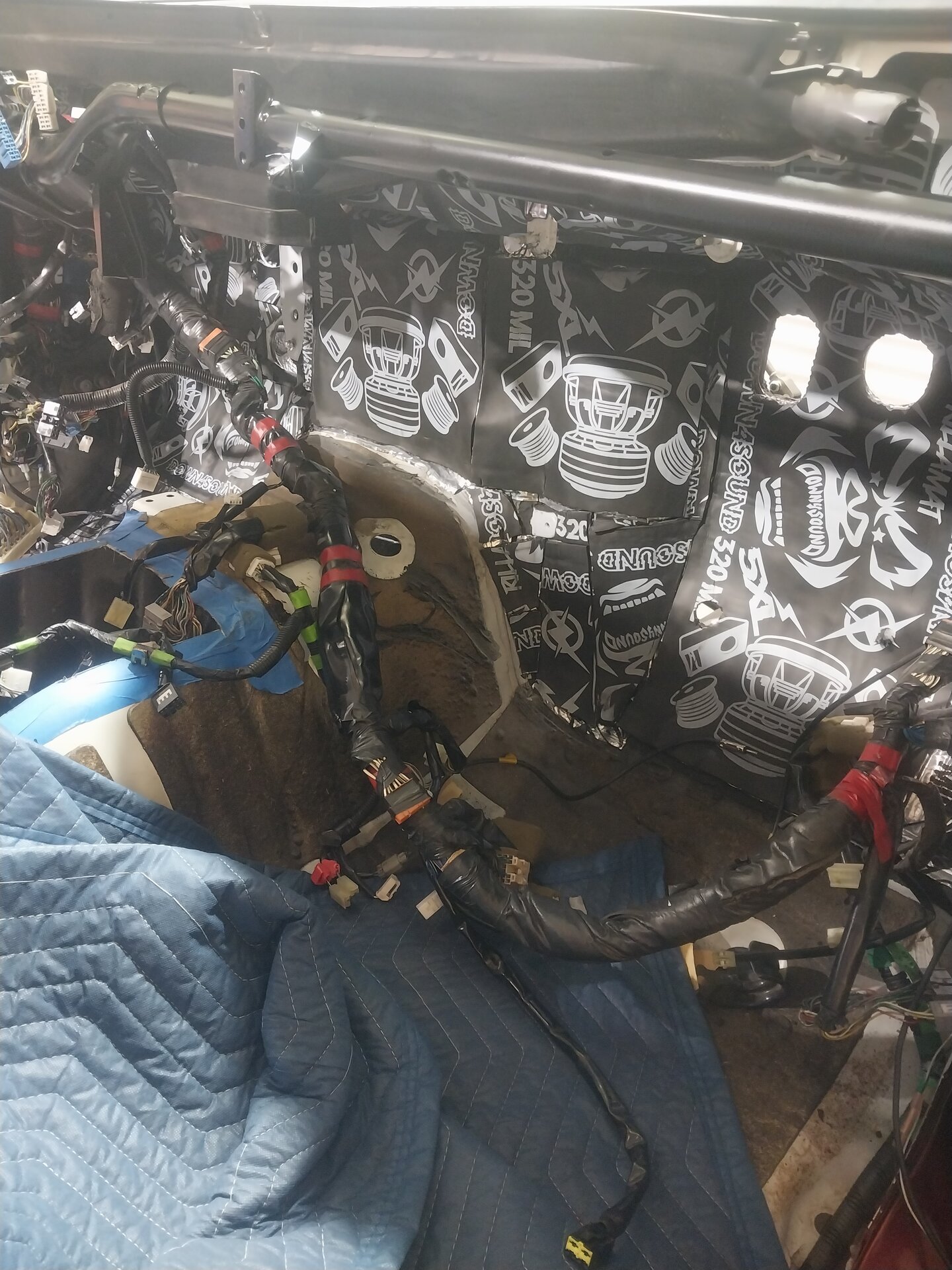

Any suggestions on what type of material to use?

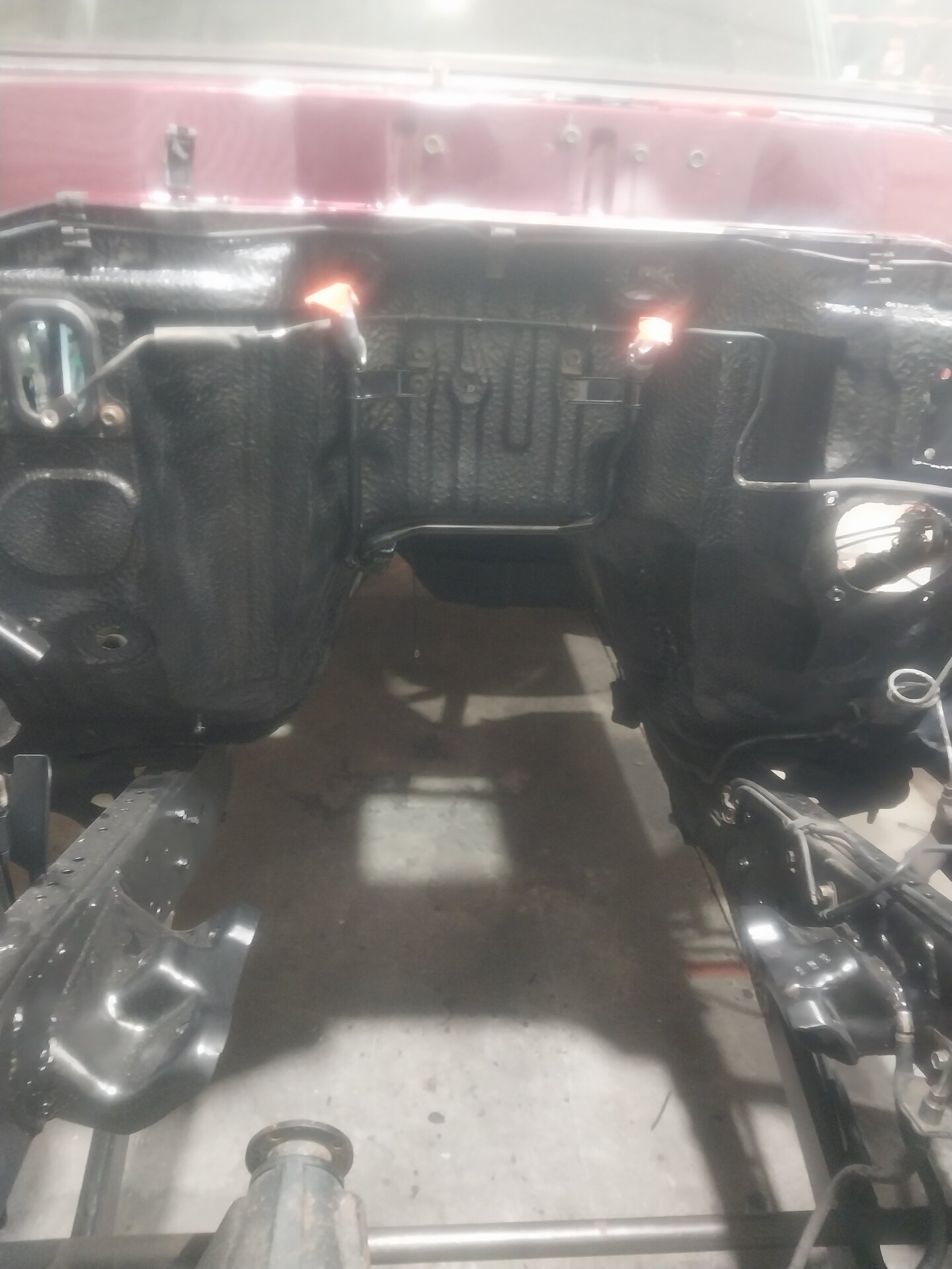

I'll elaborate... lizard skin ceramic coating inside and out on fire wall and entire engine bay. Inside pretty much the whole interior first layer 120 mil sound deadner from down4sound shoo. Com no affiliation second layer 320 mil sound deadner witch is actually 2 layers in itself another 120mil and 200mil closed cell foam all in all 440mil sound deadner plus the lizard skin ceramic coating on fire wall . Still need to do the transmission tunnel but have to fabricate the trans tunnel for manual transmission shifter and tcase shifter.
