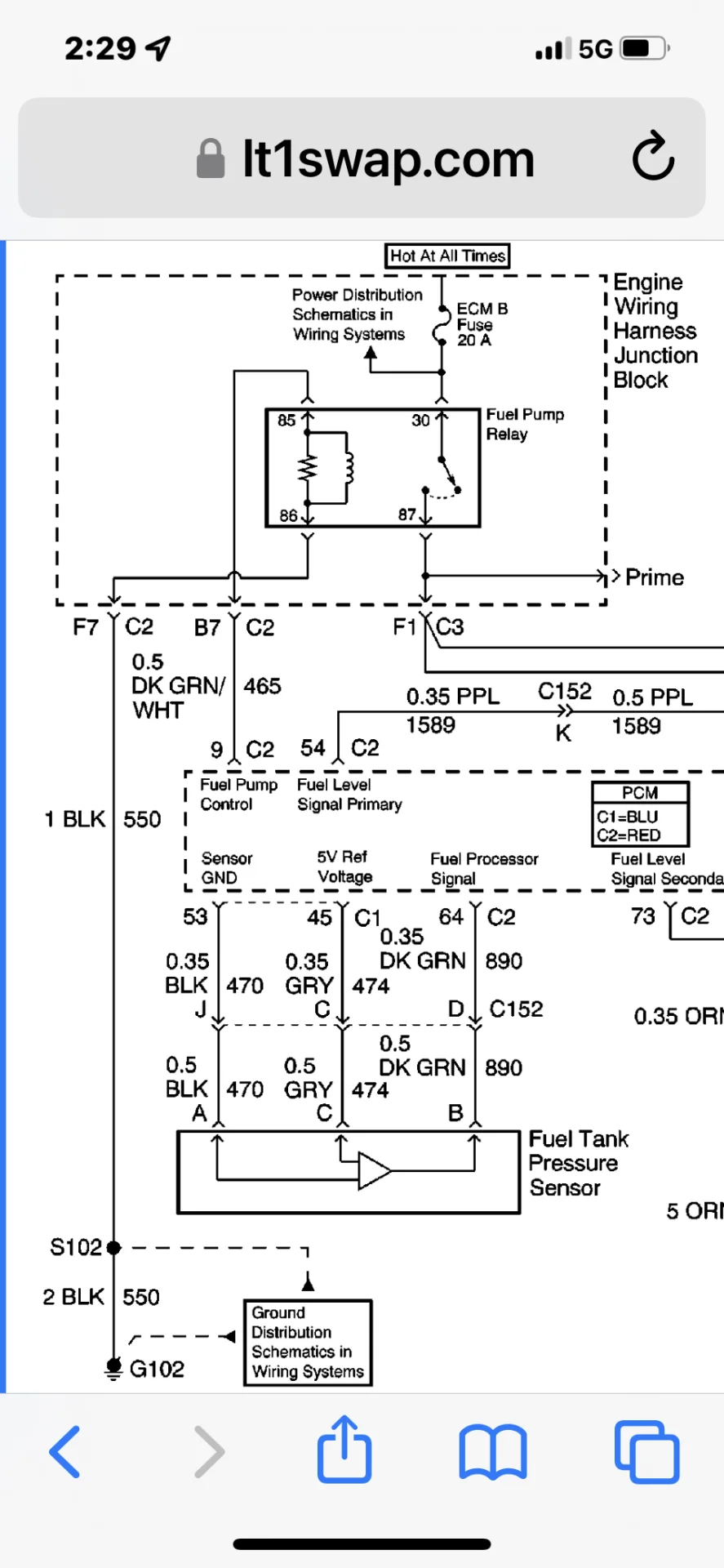

Last issue keeping me from firing up.
[Red]Pin 9 fuel signal wire gives me 11v with key on constantly (when not attached to relay)(read its supposed to be 2 seconds)
When I attach the wire to the relay I get zero V.(tried 2 new relays)
2002 lq4 pcm.
Fuel pump runs when 12v applied directly
2002 lq4 pcm.
Did you get the VATs turned off in the programming?
Are you using the battery as reference for the negative or the negative for the relay?
Tested both ways. 11v only when relay is disconnected. It fires up for a sec with starting fluid. Going to run and get a fuel pressure tester and tuner will stop by to verify vats delete soon.
You could always try running a battery + to the relay and see if it works and starts. Then you will know if it’s the PCM
Vats isn’t your problem. If it’s Vats it will fire for a sec.
Any other ideas why injectors wouldn't fire?
You have something wired wrong or your ECU is bricked. Try another ECU for a quick test. It doesn’t need to be flashed or VATs deleted.
You probably have something wired wrong though.
