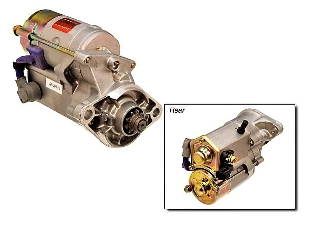

when your original or aftermarket FJ62 Starter starts to click , that's its way of saying im starting to DIE fast .....

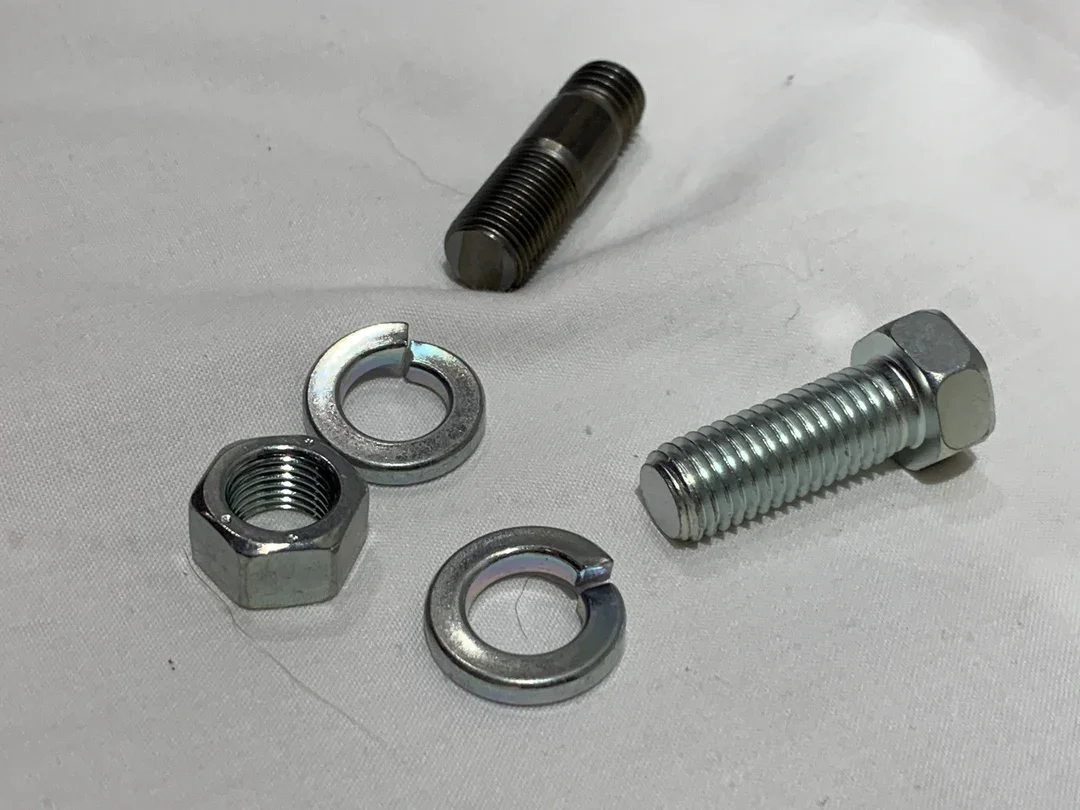

i offer Genuine NipponDenso JAPAN Spec. Replacements ,

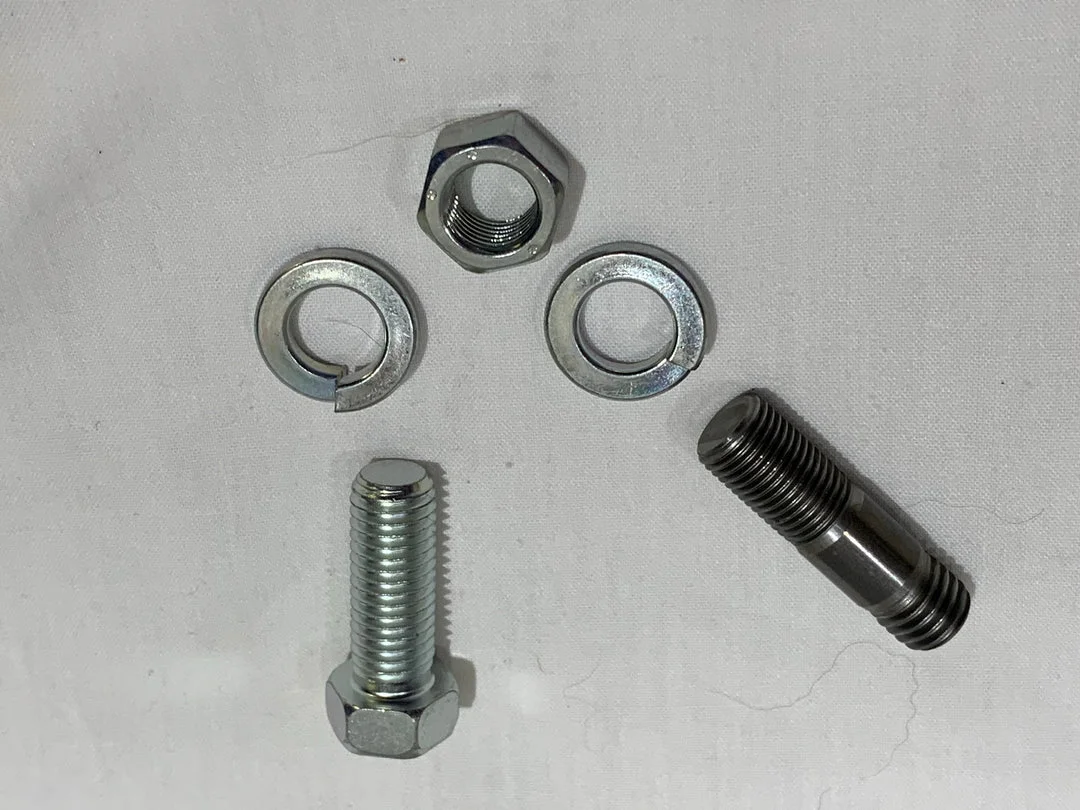

complete plug and play kits including ALL OEM Mounting Hardware bolts studs and spring washers and hex nuts

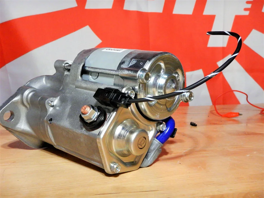

also , to set you up for success , a brand spanking new Heavy Duty 10ga SOLONOID input wire with a YAZAKI SPECIAL Positive Grip Termional ,
this is light years ahead of your current one that activates your solenoid
also , NO CORE topic involved .........

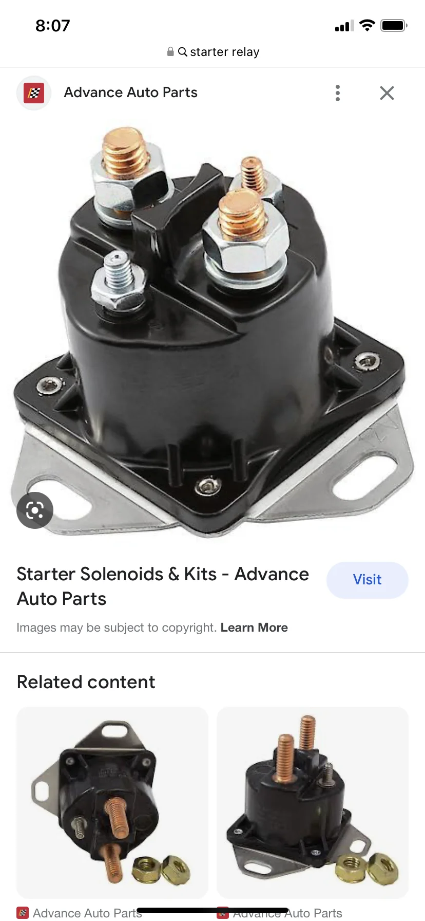

i had a problem like this but can’t remember if it would click or not. it ended up being that the old wiring in the truck wouldn’t allow enough current to activate the solenoid. it was however enough power to open a relay so i added one of these. fixed my problem.

there is a way you can jump the solenoid right from the battery. i’d suggest doing this before buying a new starter simply because you may spend $300 on a starter and still have the same problem. this relay is $20. while i don’t disagree with replacing parts that are 20 years old i would rather fix the problem than guess and be wrong with expensive parts. jumping the solenoid at a time that it won’t run will tell you a lot. my 2cents.
