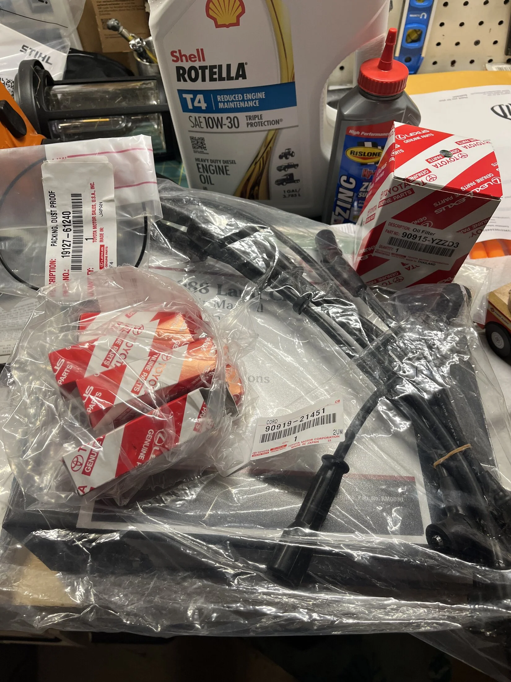

Is this (9091921410-->9091921451) the correct part number for the wire set?
Should I get a new dist cap as well (1910161240)?
Amazing tool - THANK YOU
Both part #'s I found are correct.
Do you all suggest changing cap also or no need?
Give everything a good clean. If the connections are sound, I don't think that changing it out is necessary. Of course, if you have the extra cash... go for it. Check the o-ring and dust gasket too (just did that on my wife's 80... new rubber never hurts).

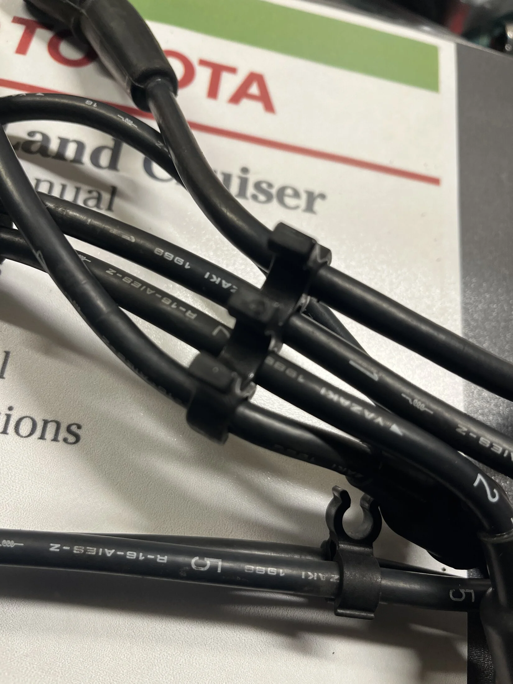

Ok so finally had a little time and weather was warm!
Plugs and wires are in. The original wires look like they are in great shape, so I at least have a spare original set. I’m sure I could have left them but 35 years old whynot give them a refresh. Dist cap was solid no cracks or any signs of wear I could tell. Rubber cover was in good shape and all buttoned back up.

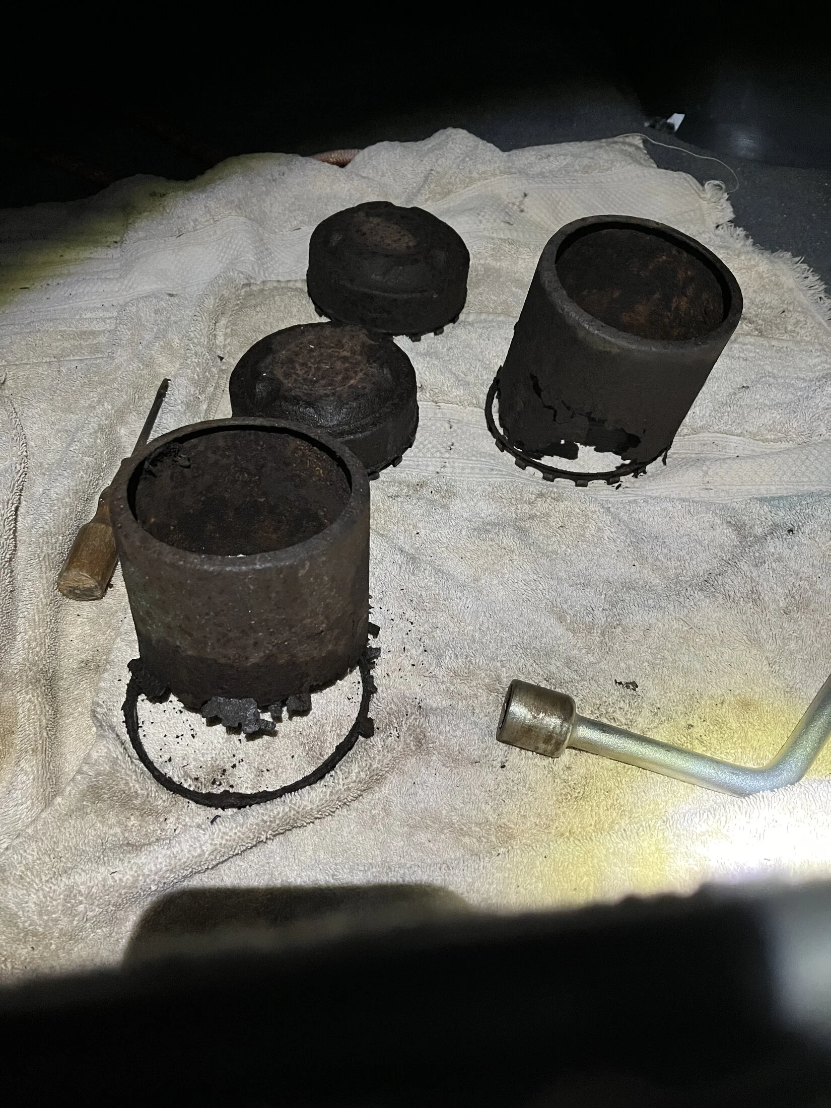

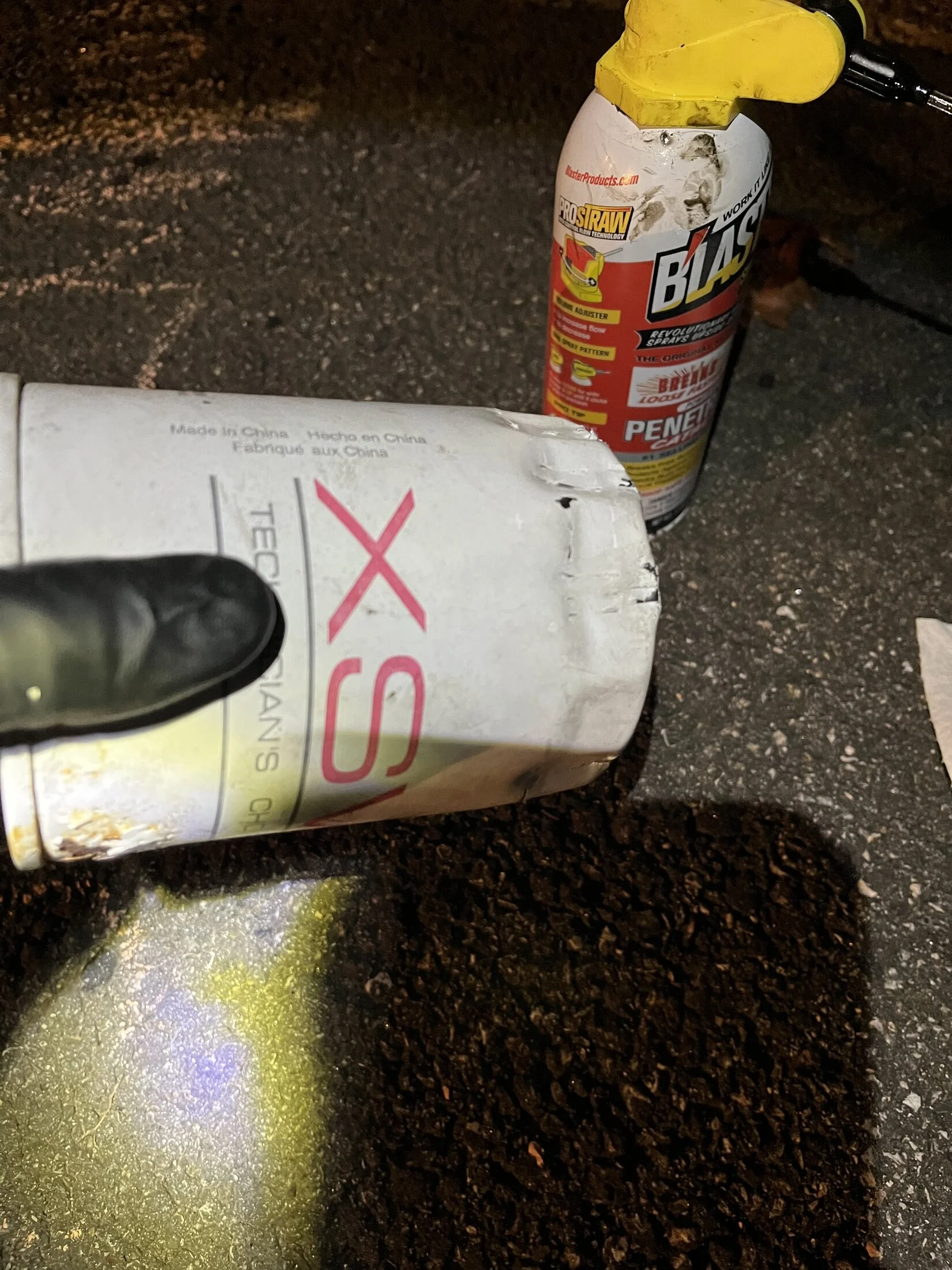

Tonight I did the oil and after I finally got the drain plug out the mighty oversized filter felt like it needed to stay on another 15 years. Well not on my watch I know these are trivial jobs for most but every successful completed job for me is a win and adding to my mental toolbox.
Now I need to figure out next steps, I think I should get some tires on her to help with ground clearance for future fluid jobs. Just need to define the list of fluid jobs. In my heart if I put a battery tomorrow she would turn over. I’m not looking to drive anywhere but I am optimistic she would come to life, I digress.
Look at this filter after our little soirée — lOl

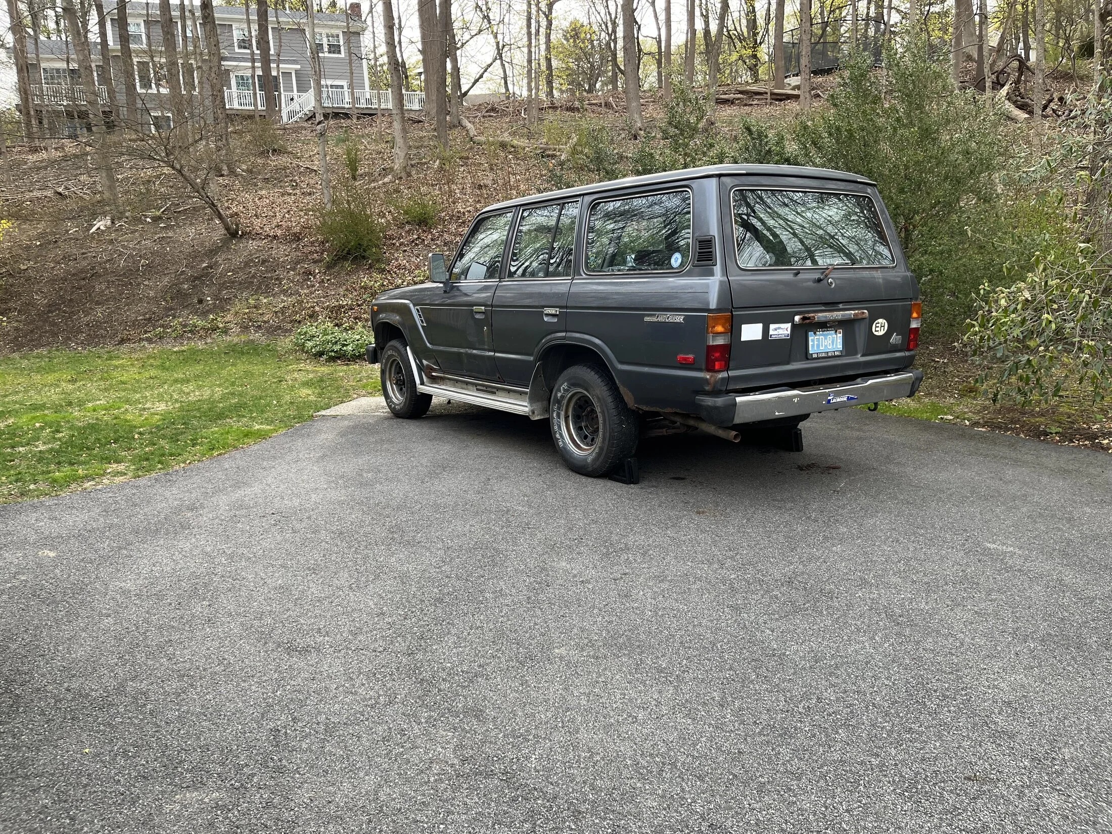

So the fridgid winter seems to be throwing in the towel. We have been getting some sporadic 60+ days and I can finally get back to the old girl.
Thanks to @01LX470George who helped me source some wheels/tires on fb marketplace I gave her some dignity back! I didn’t want to leave the truck on jack stands to take the wheels to get used tires with the kids running around so this worked perfect. I finally got her off her knees after 15-20 years =)
The two front hub covers didn’t make there extraction. Are these needed? Are they purely aesthetic? The rears I’m going to clean up and I can put back once clean as they held up much better.

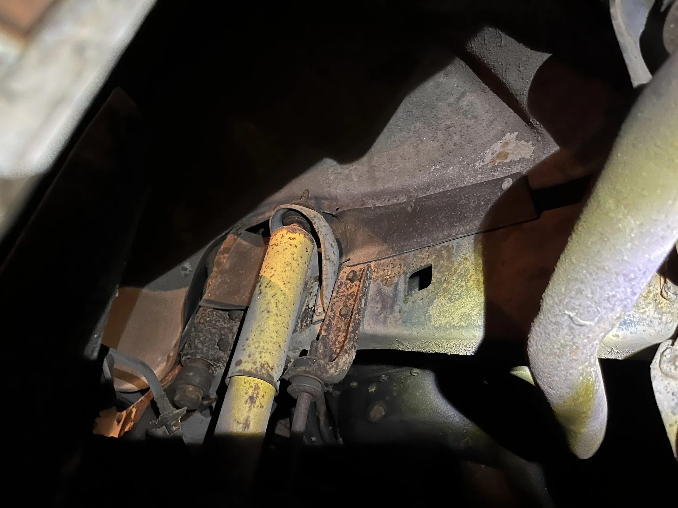

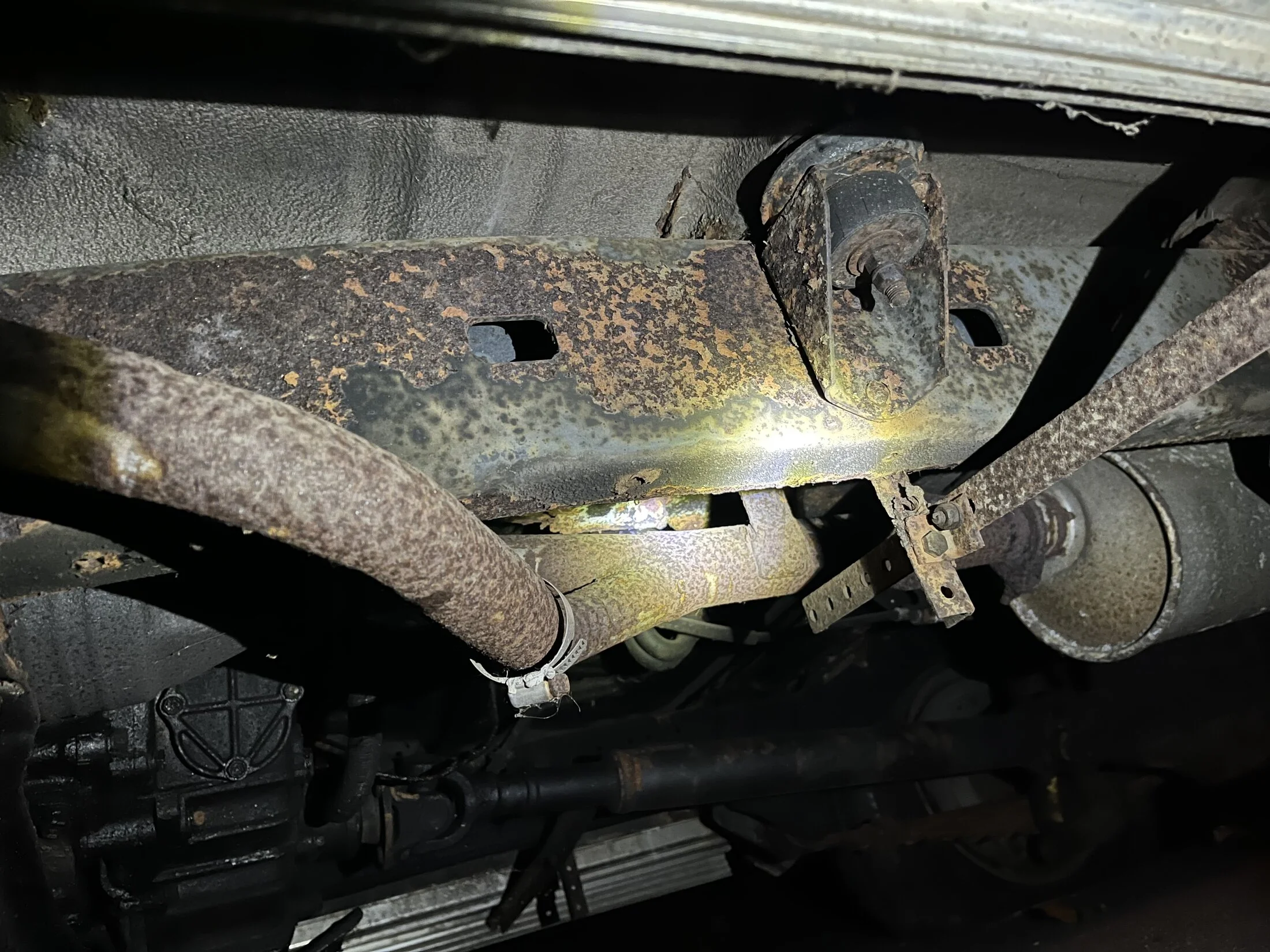

In terms of the tank, you can drain it by pulling the drain plug, but unfortunately that won’t give you much of an idea of what’s happening inside the tank. It’s likely that there’s a lot of crud in there, and/or the “sock” on the bottom of the pump is clogged and degraded. This is probably not the news you wanted to hear, but your best bet is to drop the tank, which is a pain in the a$$ job that will pay dividends in the long run. With the tank out, you can pull the pump and look inside to see what’s going on. If it doesn’t look terrible, you can dump a gallon of diesel in there and swish it around. I’ve also thrown in a short length of chain to loosen up the grime.
If it looks pretty nasty, take the tank to a rad shop and have it hot tanked. It will come back in shiny bare metal, but perfectly clean. You’ll need to paint it, of course, but there will be no worries about rust clogging your fuel system.
To remove the tank, you need to remove the sway bar hangers. Try not to break the bolts as they are welded to the hangers and are difficult to replace - ask me how I know.
