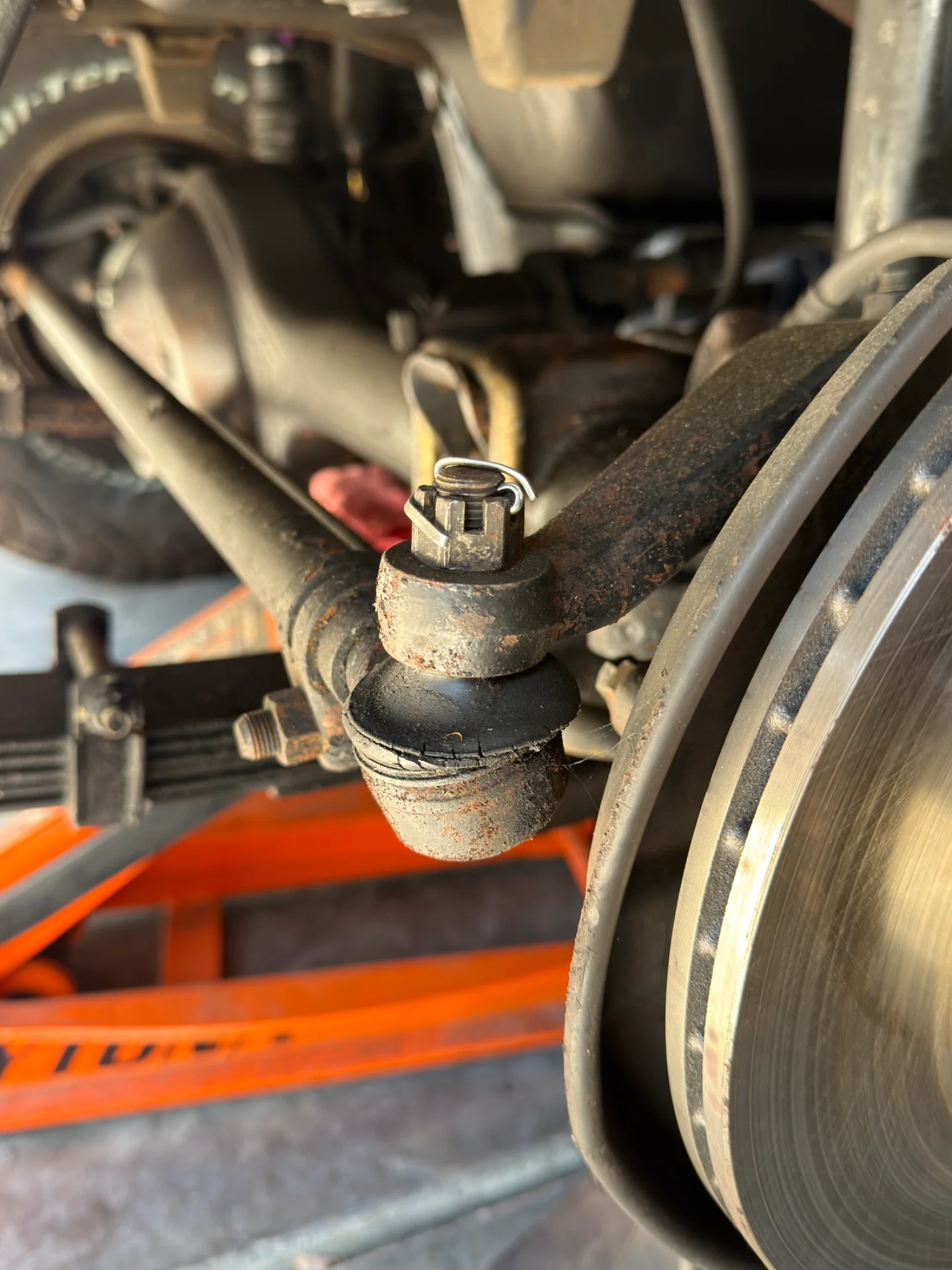

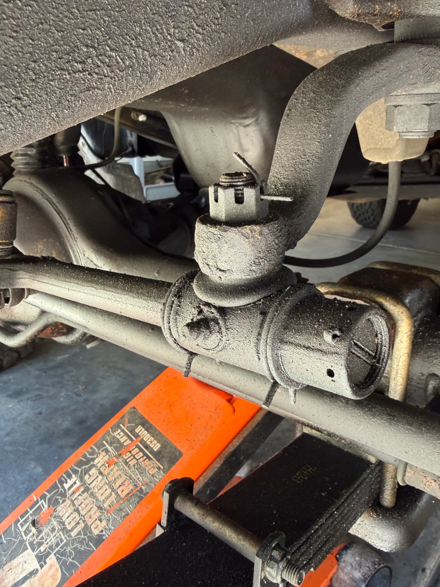

Slipped out of work early to install the new tie rod end kit I grabbed from @cruisermatt.
Finally checked that little task off the list.
