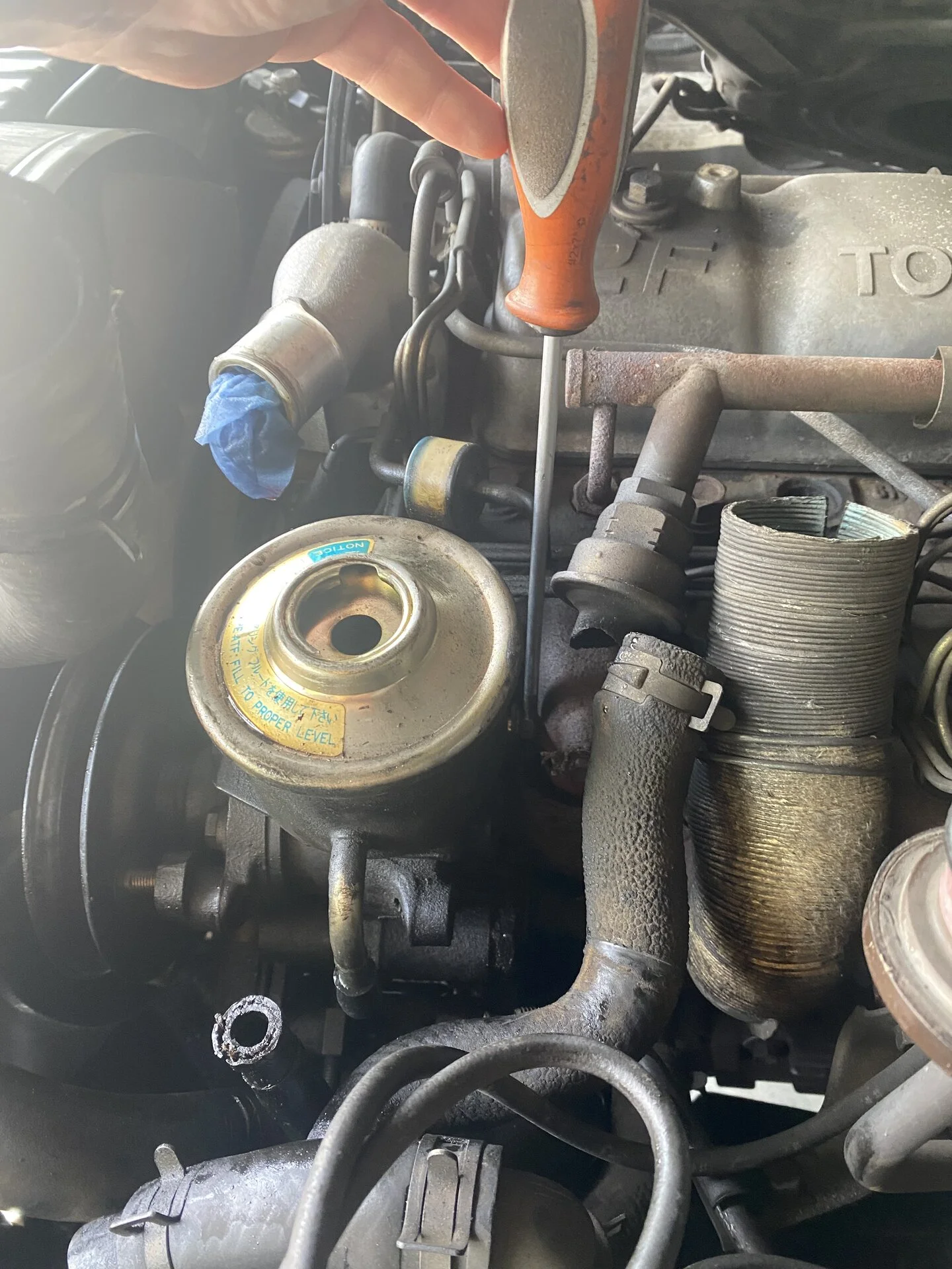

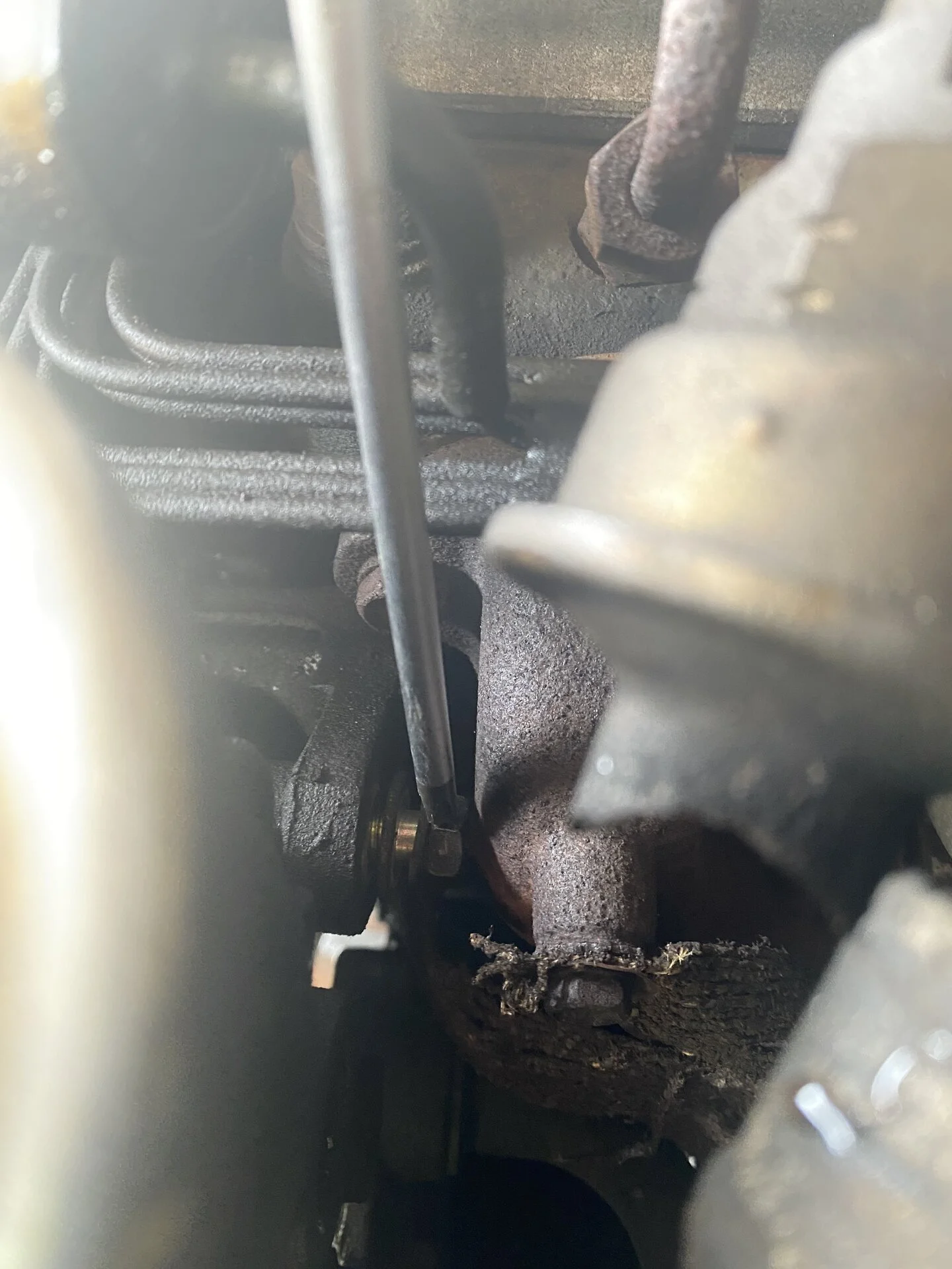

Hoping someone can chime in and help me out here: the rear bolt that mounts the pump to the bracket seems to hit a dead stop at the header. Is header removal required or is there a trick?
🤣 WOW. I can’t believe this little power steering pump is this difficult for me to remove. De-smog has been on my list but now it has become inevitable as the smog pump and all its glorious hoses are in the way of every single thing I’m trying to do. Not to mention the clamps are all orientated in a manner that’s nearly impossible to get a pair of pliers or channel locks on to remove. Still have one more bracket bolt to remove but I’m defeated and done for the day. Not a chance im putting myself through all that to install the rebuilt pump. My goodness.

I ground about half the head off the rear mounting bolt that hits the exhaust manifold. Now, if I need to remove the pump again for service or to access the smog pump, I can remove it without having to loosen/remove the entire bracket.

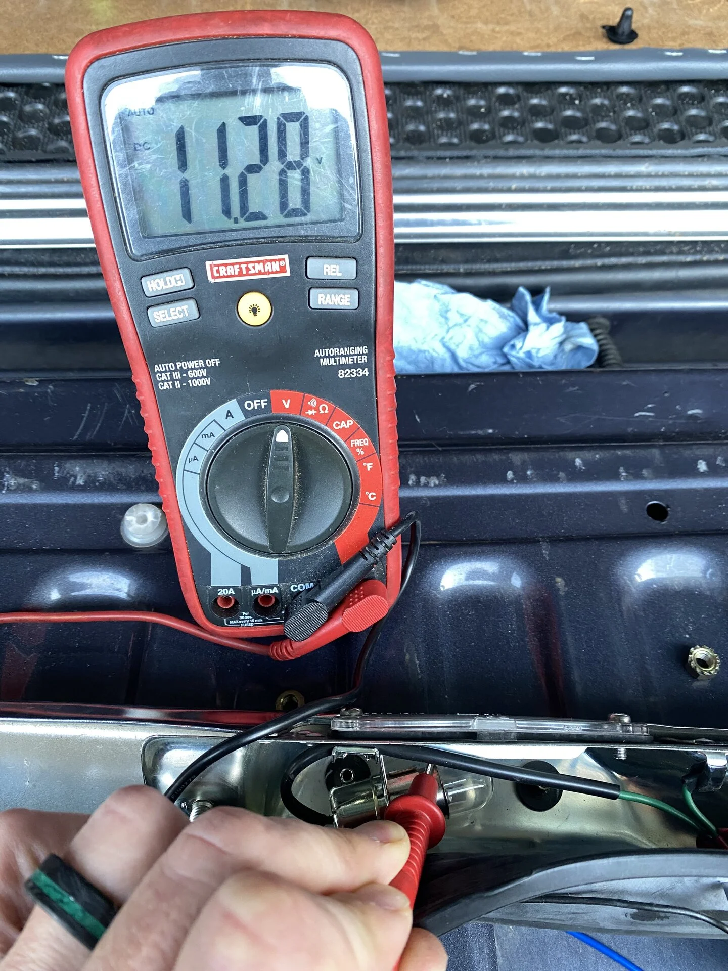

Noticed the wire from the body to the tailgate was broken that feeds the license plate lights. Made the repair and still didn’t have lights. I’m kind of stumped here: I’ve checked voltage through the entire circuit up to the light bulb sockets and have ~11.3V there. Bulbs tested good. Not sure what I’m missing.
Noticed the wire from the body to the tailgate was broken that feeds the license plate lights. Made the repair and still didn’t have lights. I’m kind of stumped here: I’ve checked voltage through the entire circuit up to the light bulb sockets and have ~11.3V there. Bulbs tested good. Not sure what I’m missing. View attachment 3499655View attachment 3499656
It's the ground. I have yet to fix mine.
it is grounded thru the hinges, a "new" wire would need to be run
Hmmm..I don't understand my readings then. 11.3 volts at the light socket(s) but there is still a grounding issue?
just for laughs, run a jumper wire for a ground and see what happens
single hot wire feeds the light
the ground is thru the tailgate hinges to the body
hinges get rusty and lose contact
