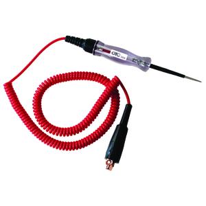

Generally a simple test light is better for this sort of thing. Clip the alligator on ground somewhere, then start at the beginning of the circuit and follow voltage until the light won't come on anymore, and there you have the fault.
The CB is the first thing in the feed to the circuit, so if you get any voltage downstream say at pin 5 of the Door Control relay box, then the CB is working.
