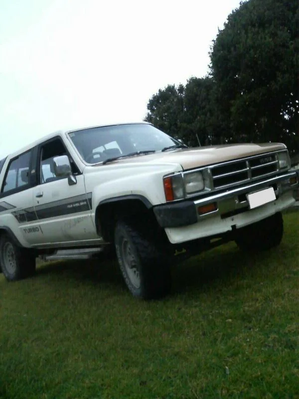

Hah! Knew it was the glow plugs. Now pictures are demanded. It's the law.

heres a pic or it , if th pic workd... its a boring one lol but yeah
