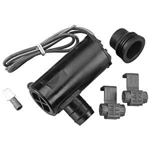

bit of an amazon geek - found these:
Trico 11-604
ACI 177111

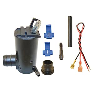

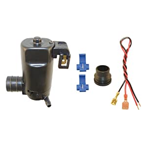

And not needed but in case anyone finds this searching - one for the rear:
ACI 172872
So any suggestions on which might be best of the first two for my windshield washer pump? or part # for OEM replacement to compare? I'd prefer Toyota, but if the cost is 4-5x the two above i'll probably go cheap and expect to replace it again in a year or three.

thx spook! twice the cost but should be an easy swap - didn't like seeing the splice connectors on the ones i found @ Amazon.
