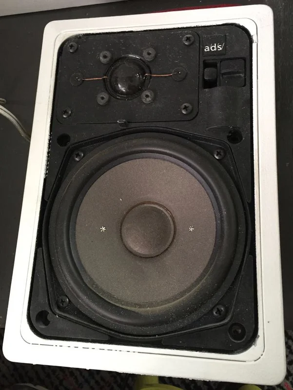

Back in the day (1990) I installed ADS plate speakers in the doors. Back then I would consider myself an audiophile. I was super critical about how music sounded. My home hi-fi was outrageous. Super extreme.
So how music sounded to me was important.
I had a good head unit in the dash (Alpine) and a separate amplifier on the floor.
The sound from those two plate speakers was excellent. No complaints at all.
I’d explore what’s available in plate speakers nowadays. You won’t need those tweeters in the dash. It’s best to keep the sound coherent with speakers together - except for a subwoofer.

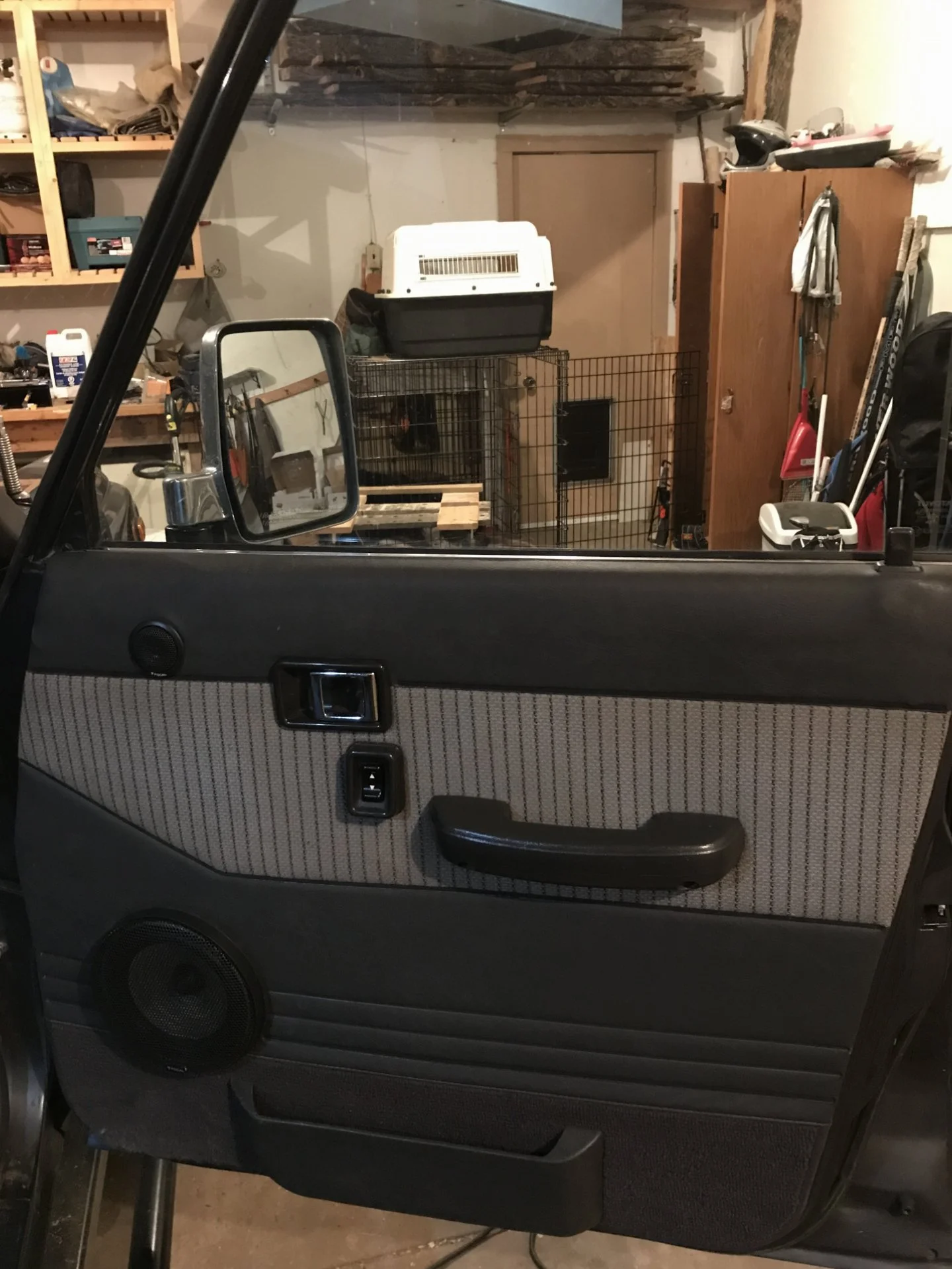

this is what i did. it’s not for everyone but i love the sound.
i put a set of component speakers in my front doors with small tweeter up top and 6 inch down below. i was ok with non OEM grill. i uses a small spacer and the paint matched the grills and spacers to match the door card. it looks pretty good, clears the window has way better sound than any speaker you can fit behind the stock grill and sounds awesome. they are high quality speakers too.
speakers are focal with individual amps hidden under the drivers seat. i have a 10 inch sub in the trunk and two more 6 inch with built in tweeters in the trunk. the front door speakers are where the real magic in these trucks happens though.
maybe not what you’re looking for but just an idea

View attachment 3587888View attachment 3587889this is what i did. it’s not for everyone but i live the sound.

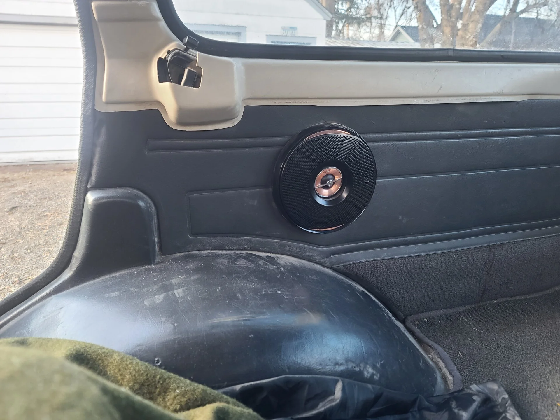

I mounted 6.5" rounds in the rear panel of my 60. There is plenty of room behind the panel. They sound better when the rear seats are down as in the picture. I rarely have the rear seat up so that is not an issue.
