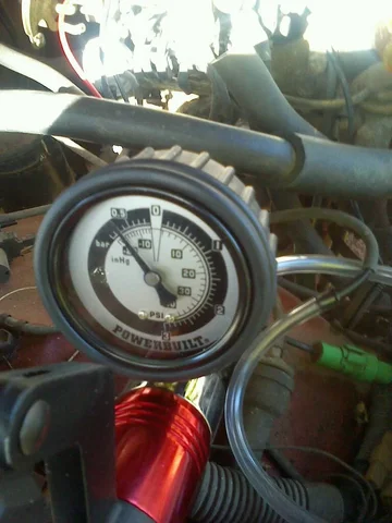

How do you check a egr valve?
Found a video on YouTube that said to use a vacuum pump to test if valve will hold vacuum.....

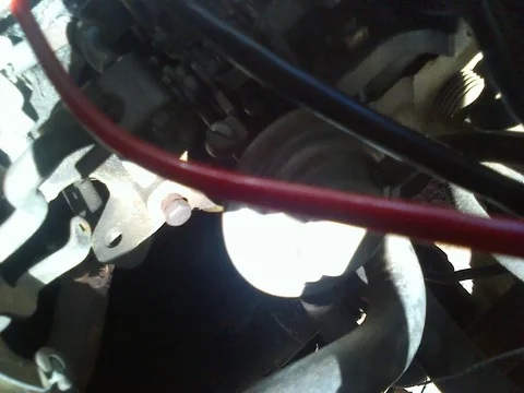

If so checked ok. Might be a moot point though.
