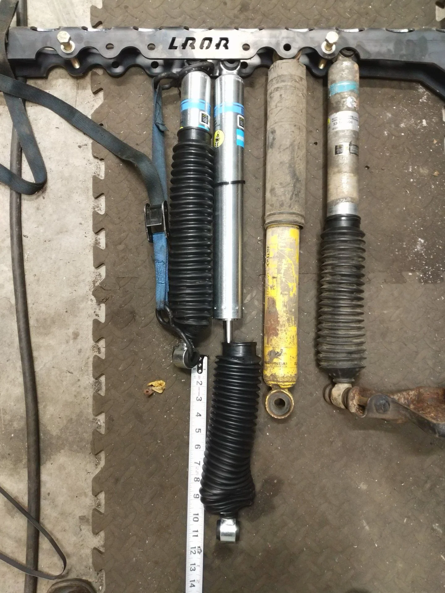

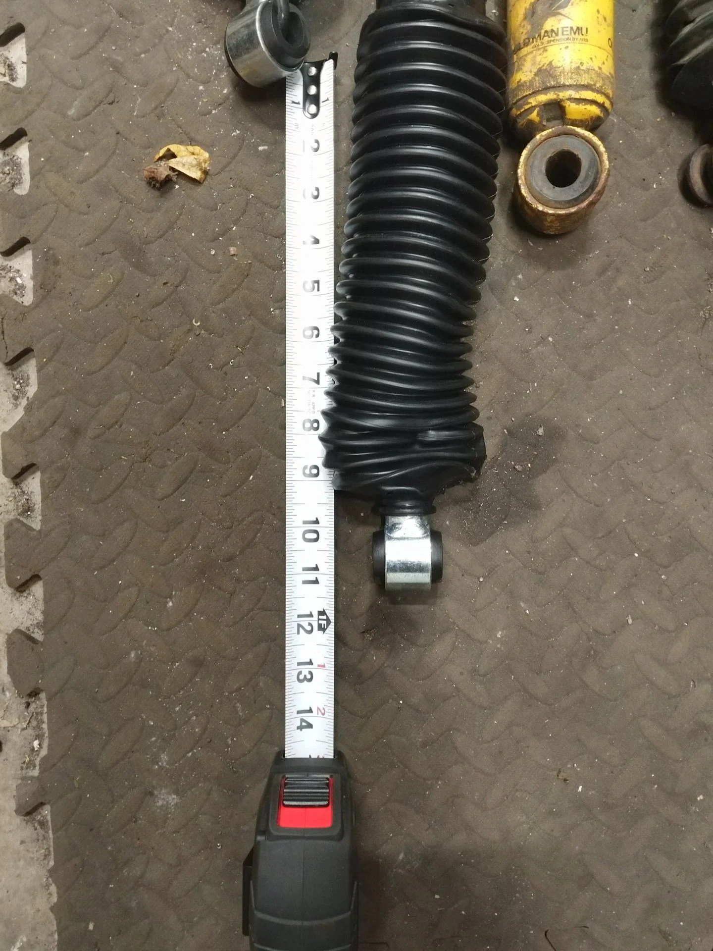

Playing with shocks now.
All caught up.

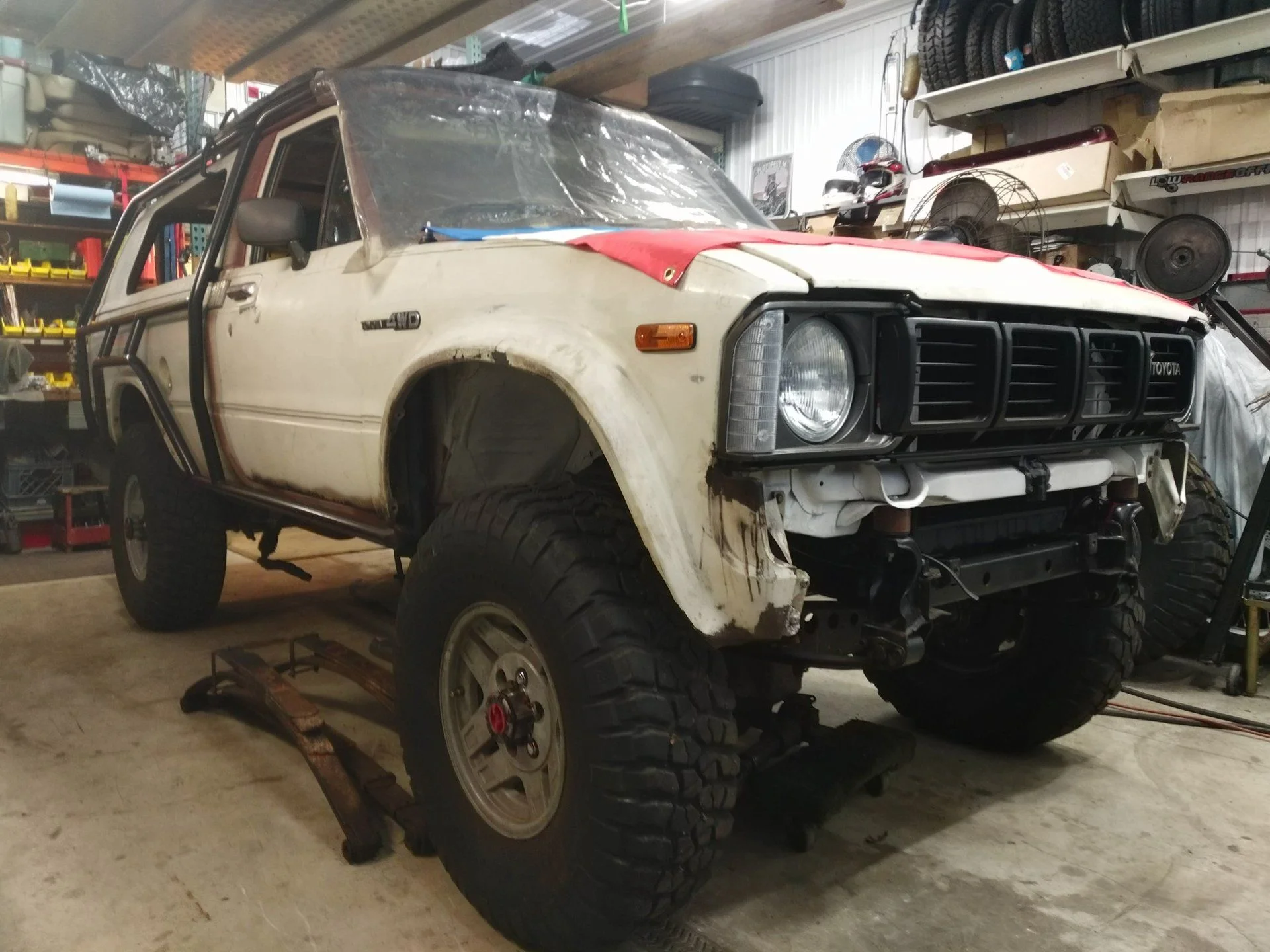

Sits pretty nice and low, it's got quite a bit of weight in it, but not all of it.

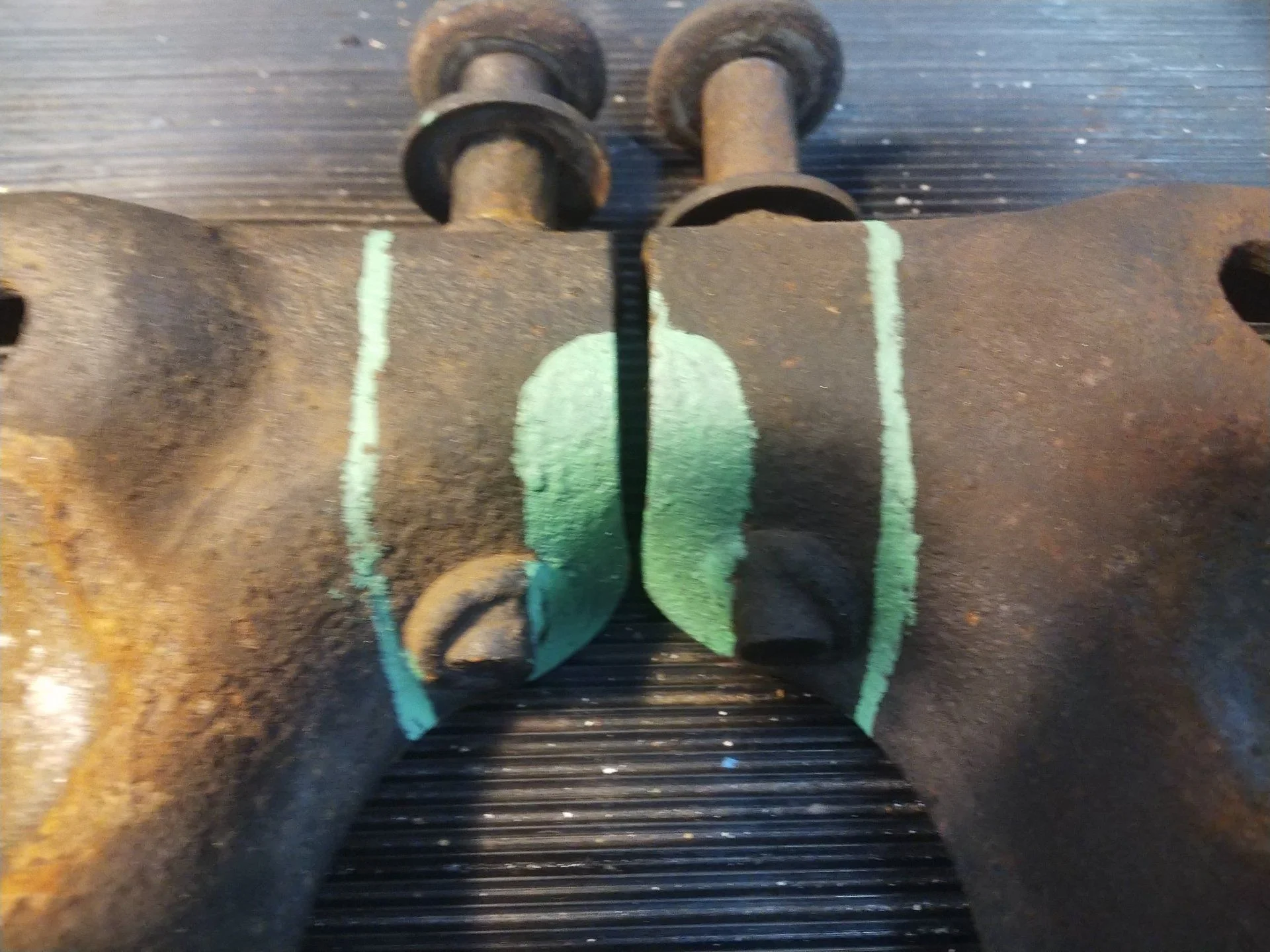

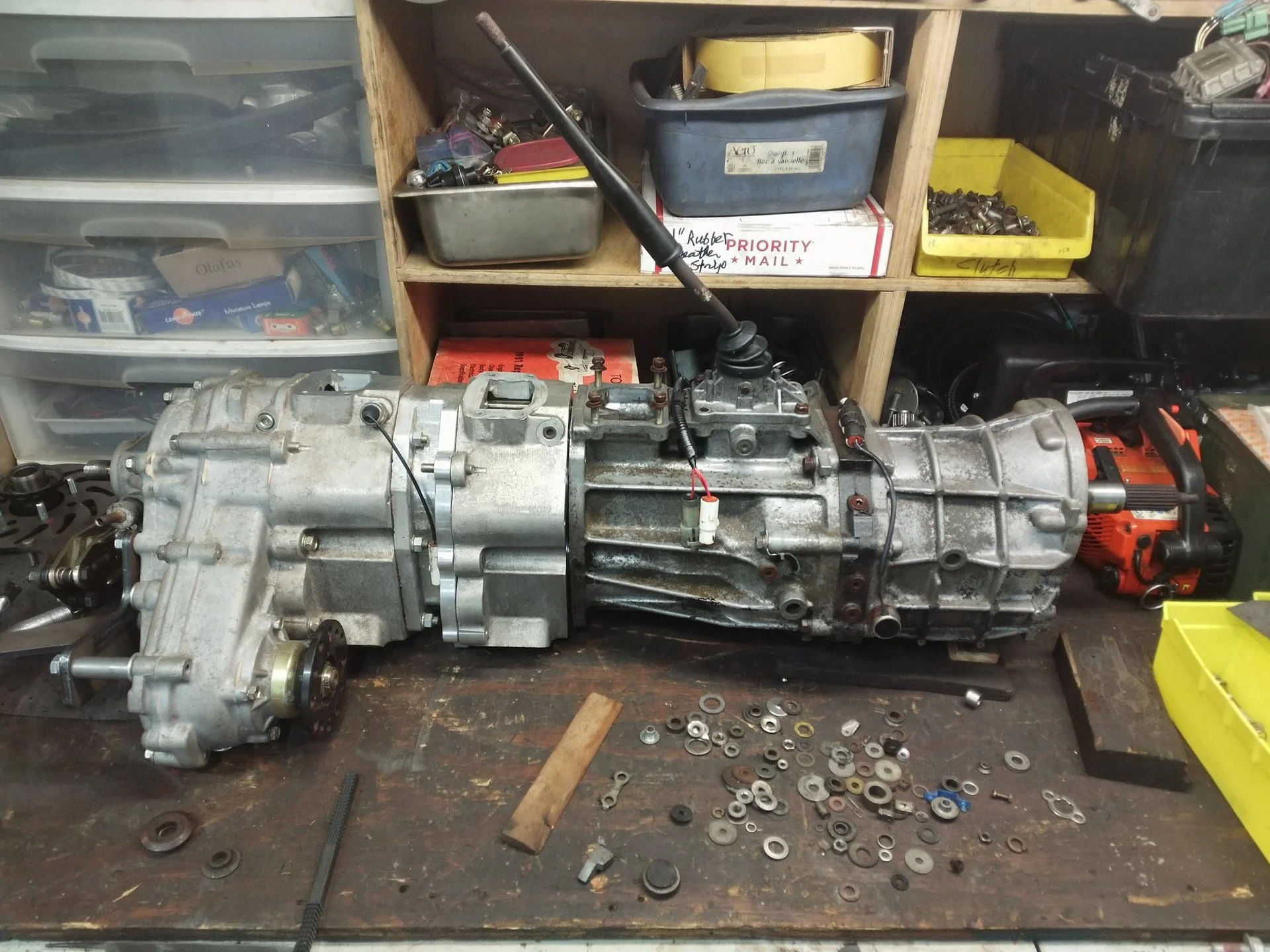

Trying to clean things up, I certainly can't keep up with @caz, how the heck did you get the housing so clean on yours?
I split the housing at the steel plate in the middle. Actually pretty easy!
Then, Steel wool and Never Dull - and some elbow grease.....
Then ran them through the dishwasher.

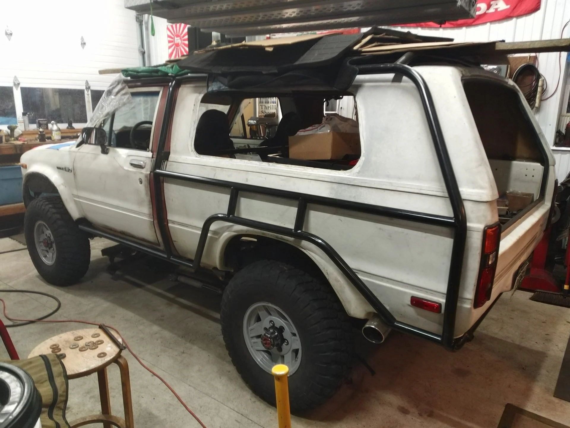

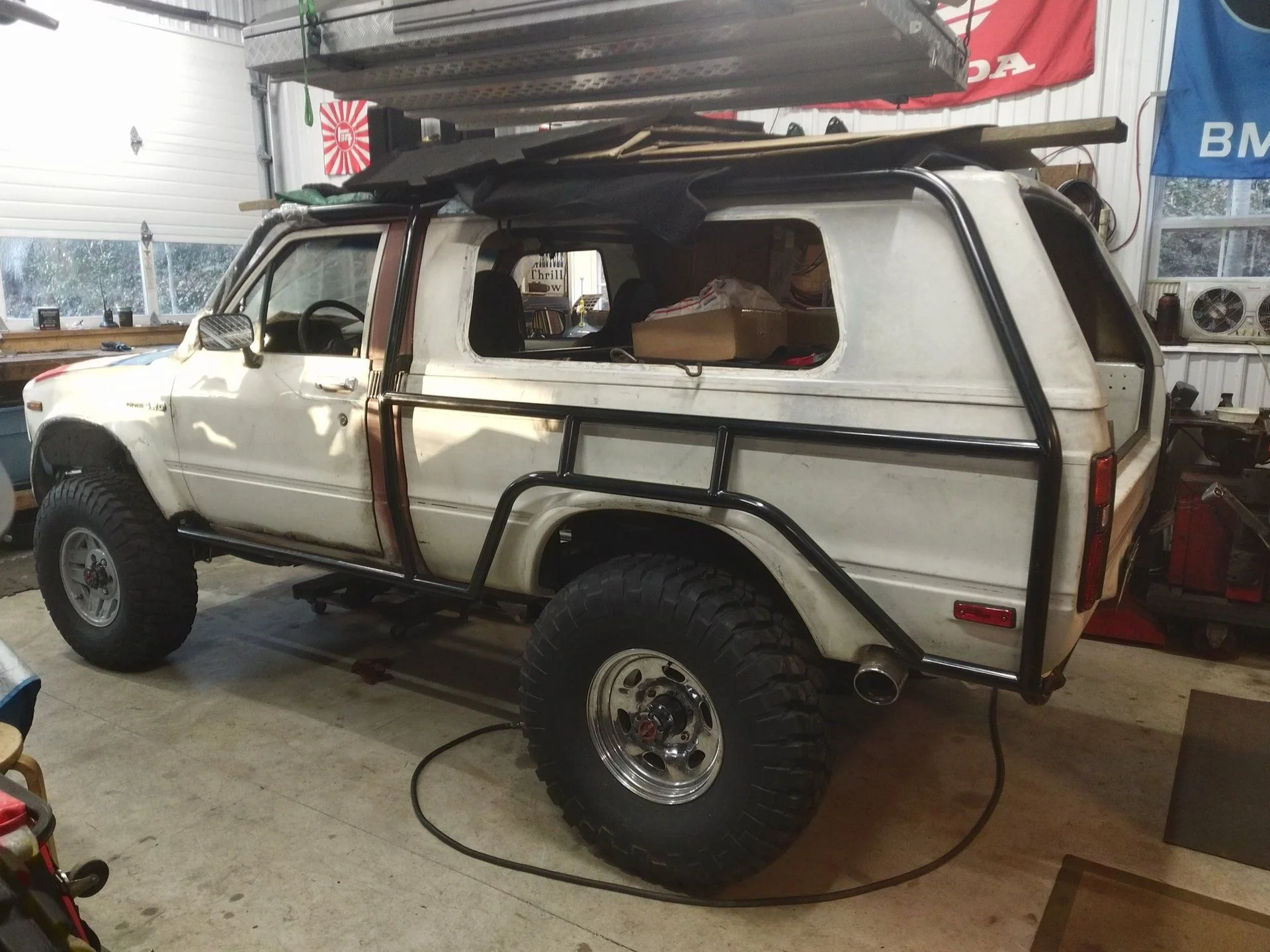

Your hub dials bother me. Thoughts on different wheels to recess them for protection?
Agreed.
These wheels with 33s are going back on the 62 and the Turbo Fans with 35s are going back on here.
The front has ifs hubs and the lockout dial is well protected.
The rear is an ifs width axle, but you are right, the hubs stick out just past the tire. When I put 1.5" spacers on back there it looks funny.
I will try it with the one inch spacers from the 62 if needed.
Here is a pic with a 35" on a stock fj62 wheel. Hub is well-protected and the wheel clears the caliper. I have a set of these wheels too.
