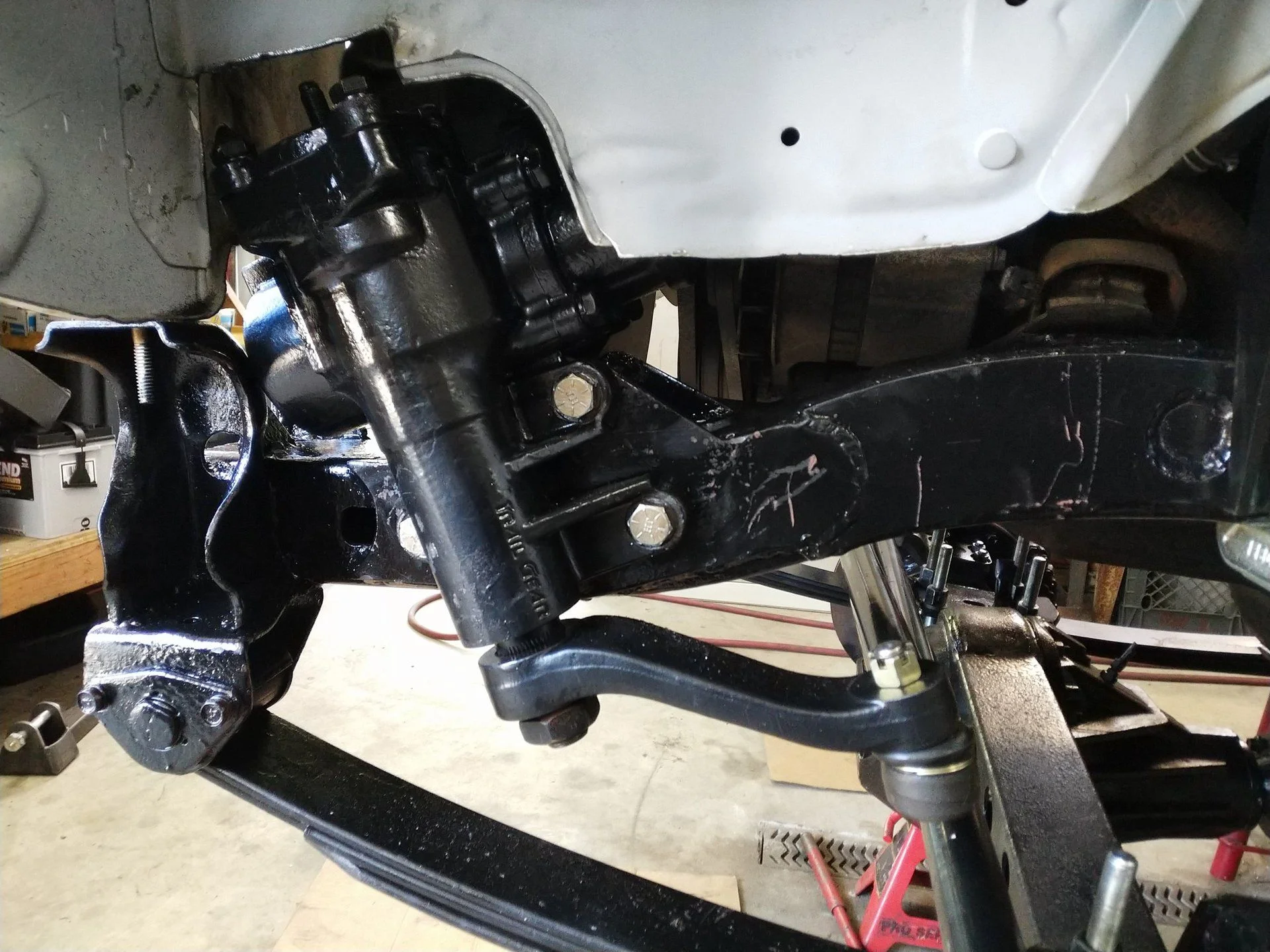

Got the steering box in for the final time.
Reconnected the tierods and diled in the steering stops.

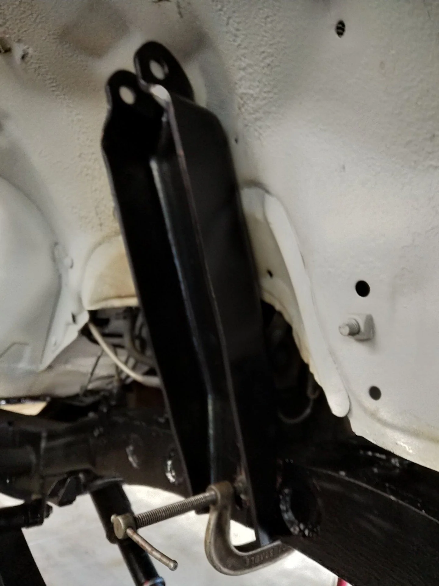

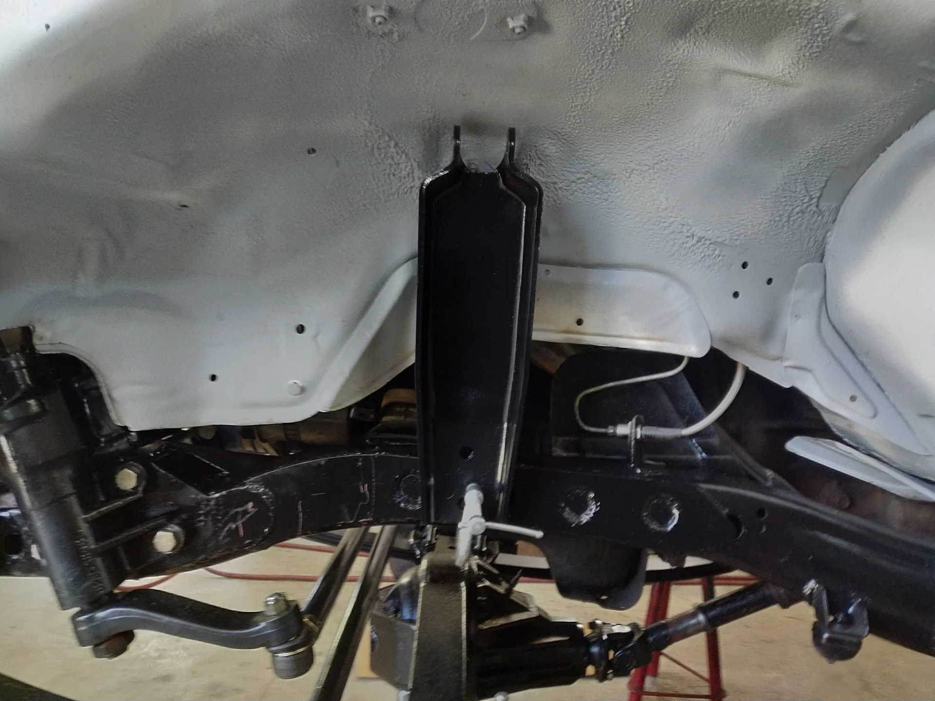

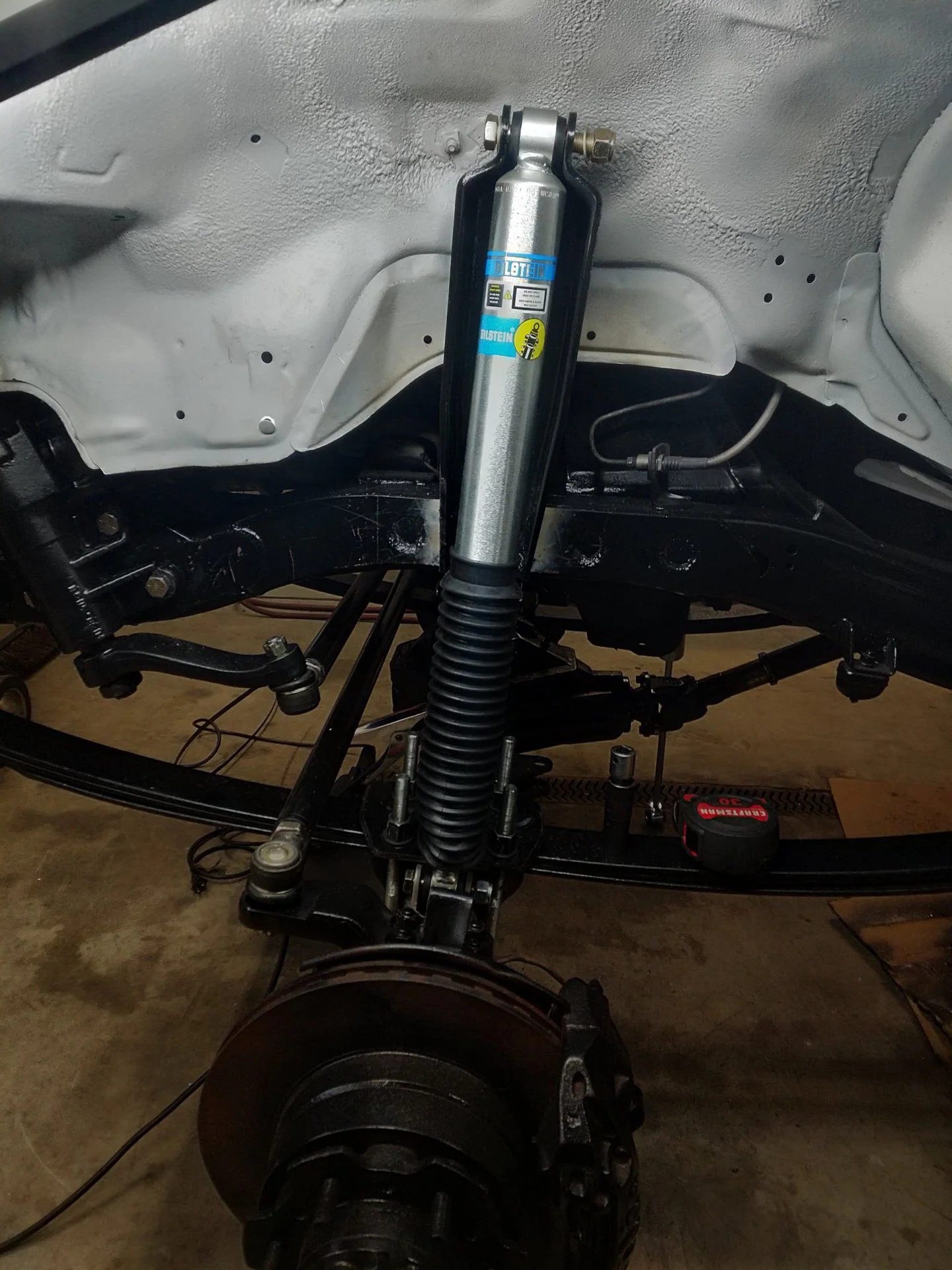

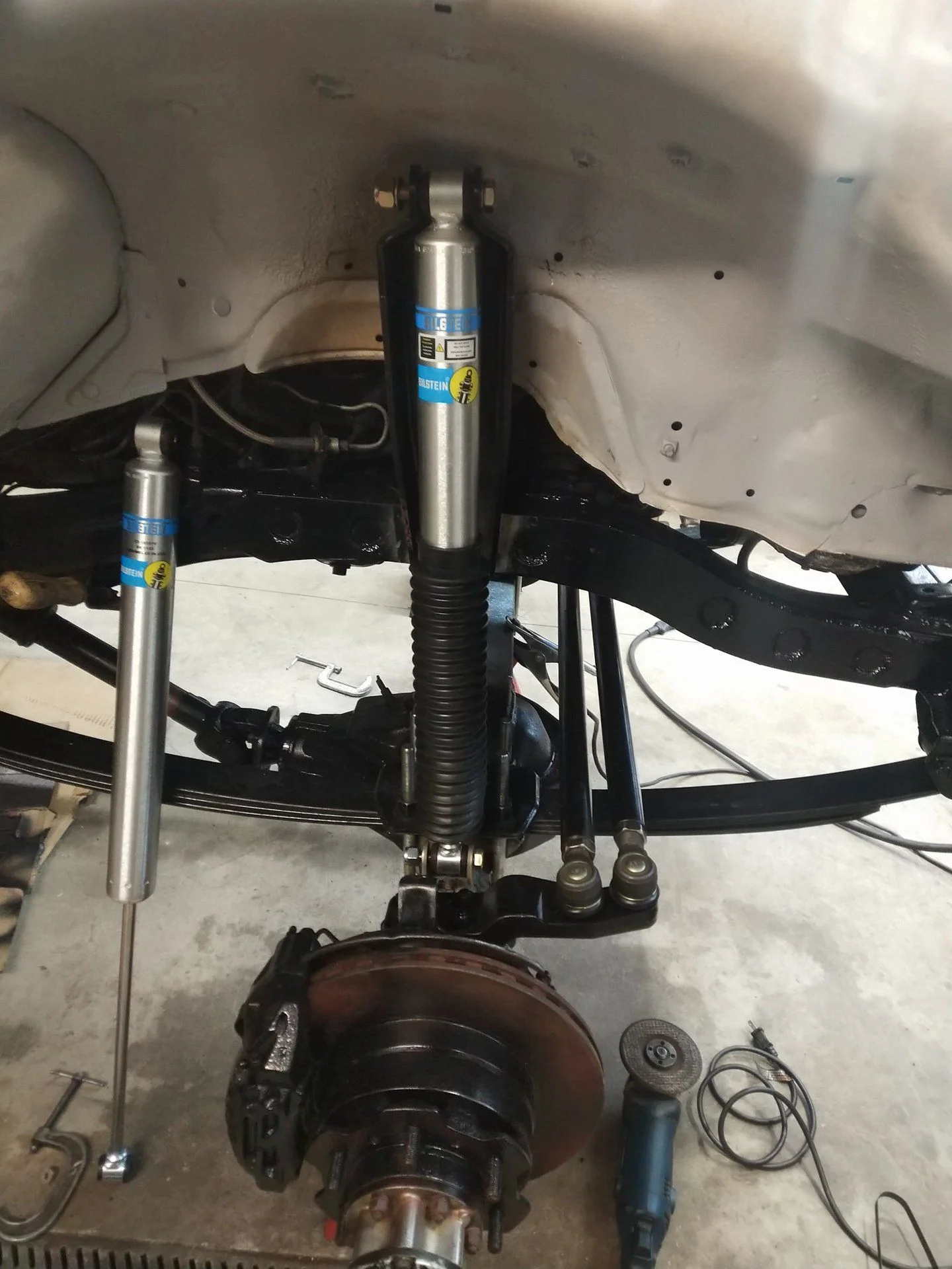

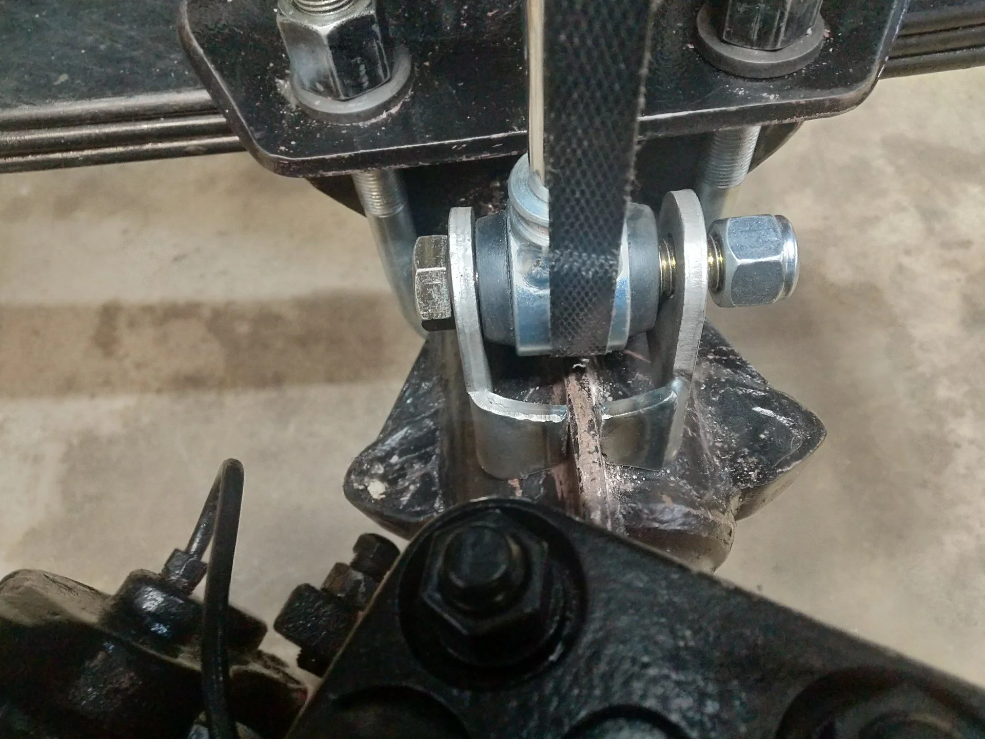

Started mocking up the Ford shock towers.
I am really impressed how beautifully these fit for this situation.
I am worried the tires may get into the shocks on full stuff, but remains to be seen.

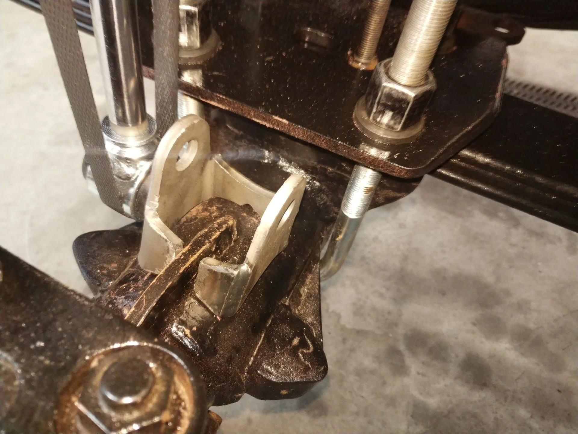

Shock mounts are heavy tacked for now, will burn them in after I flex it a bit and make sure there are no glaring issues.
12" travel for the front and 14" in the rear.

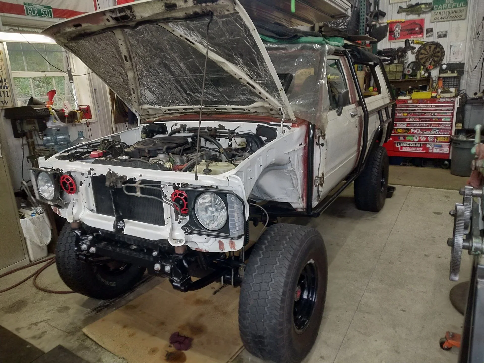

I've been working on the rear leaf packs and getting ready to final install the rear axle next.

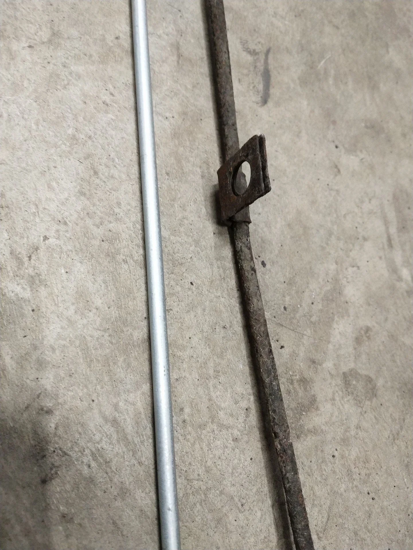

Yesterday I tossed together a parts store, 2½" exhaust system.
Some flex pipe and tube I had around, clamped to the header JAMarquardt22 gave me. I ran that to a Summit Racing FloMaster clone, out the back.

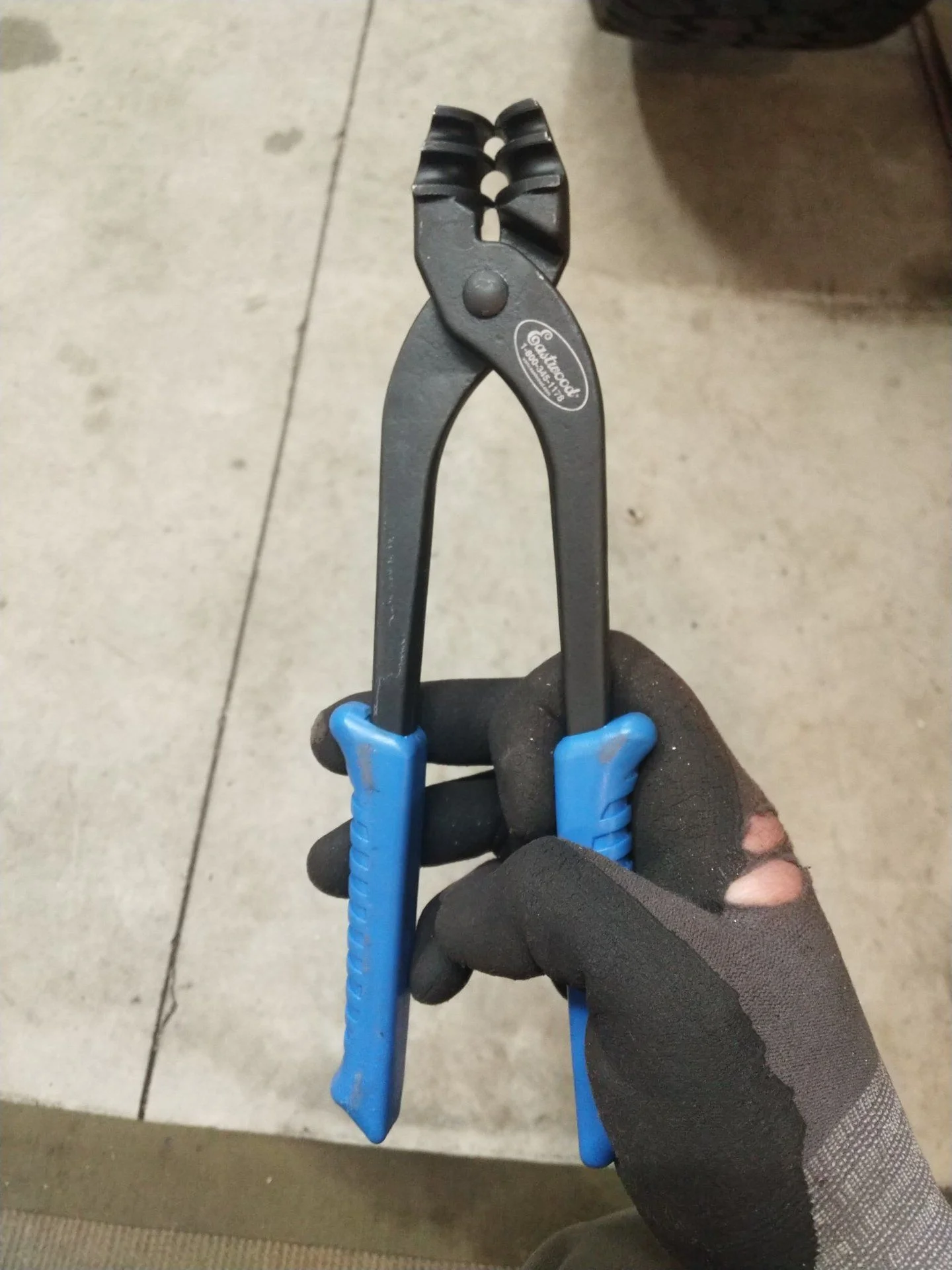

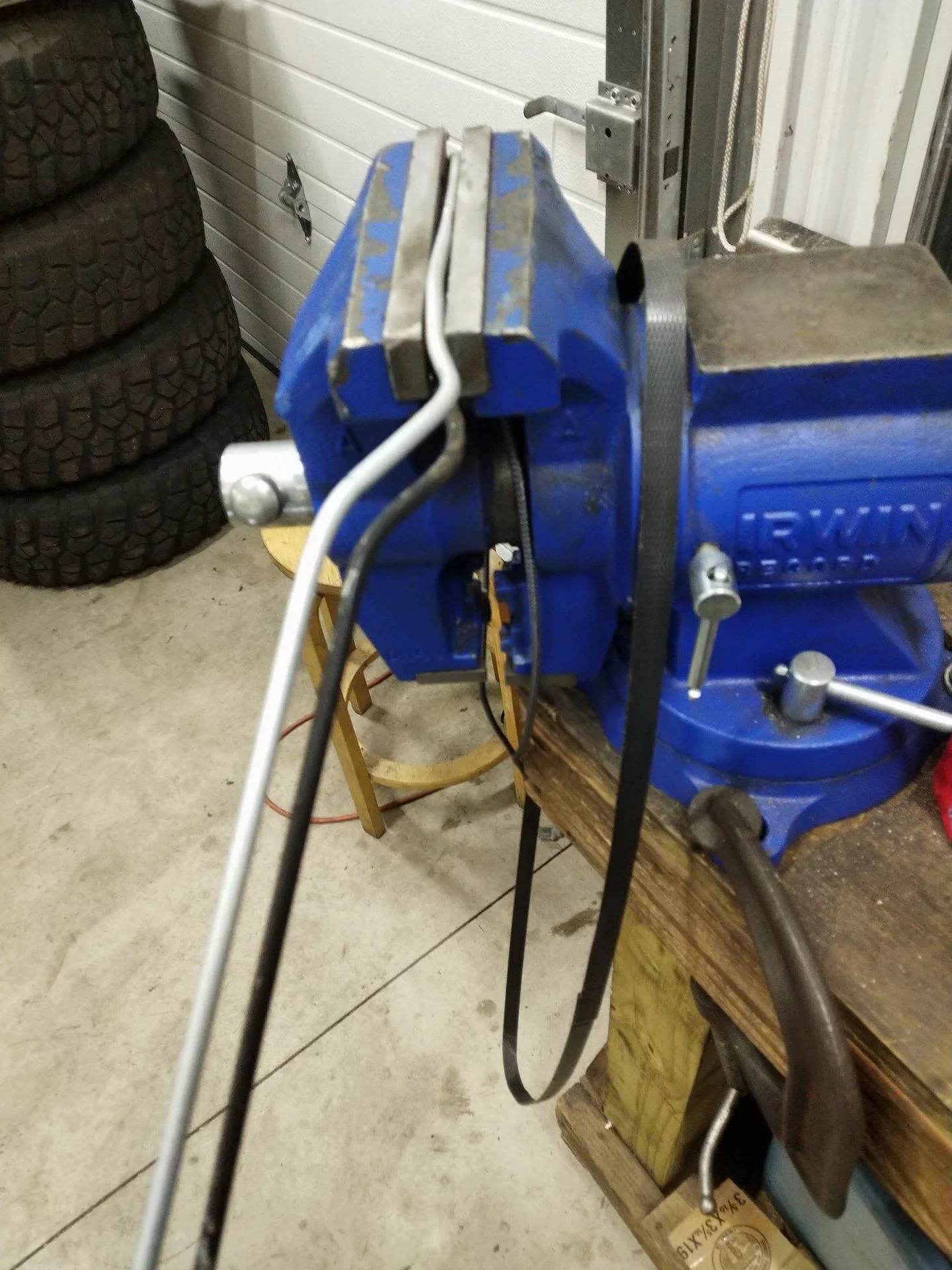

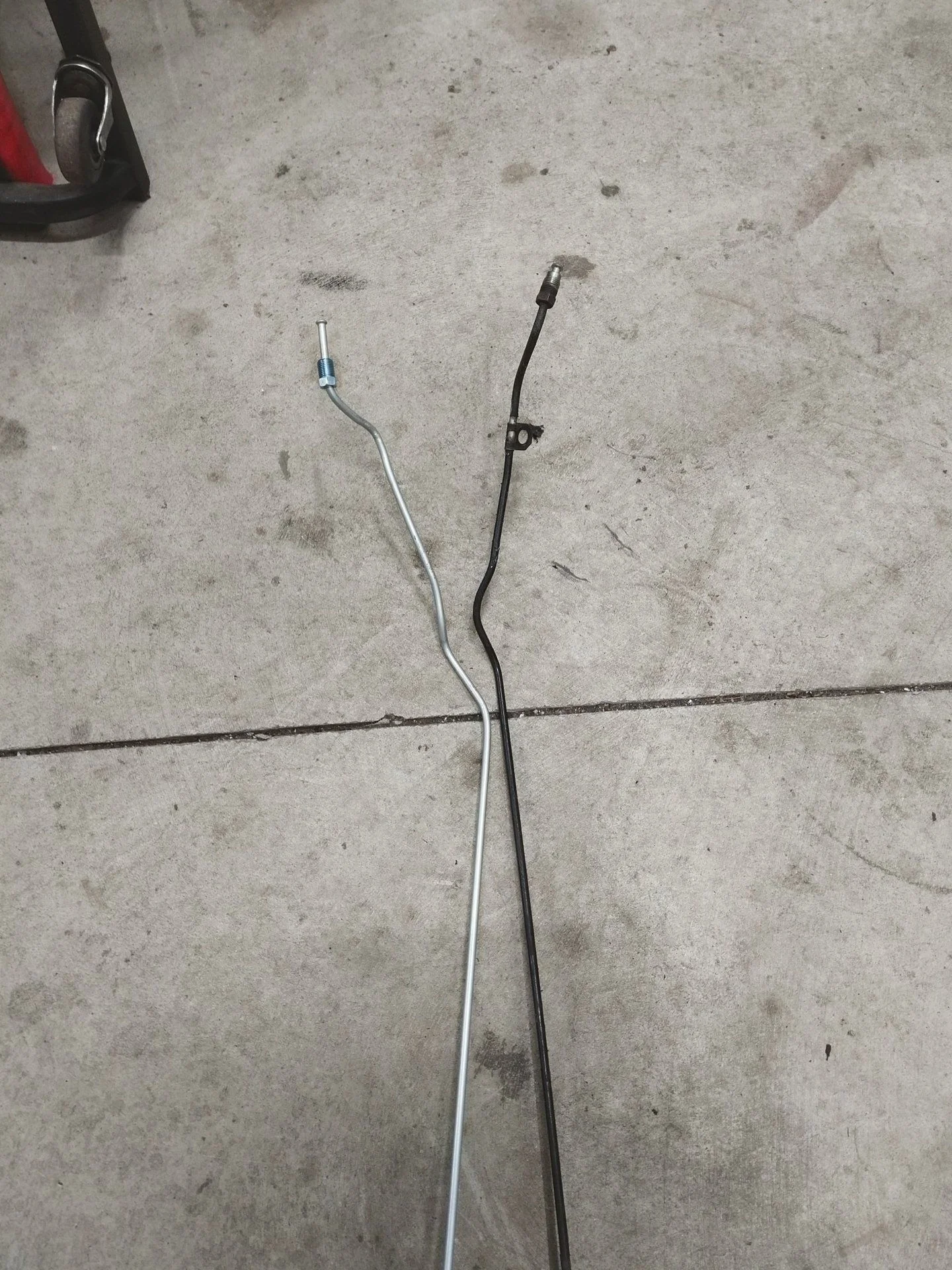

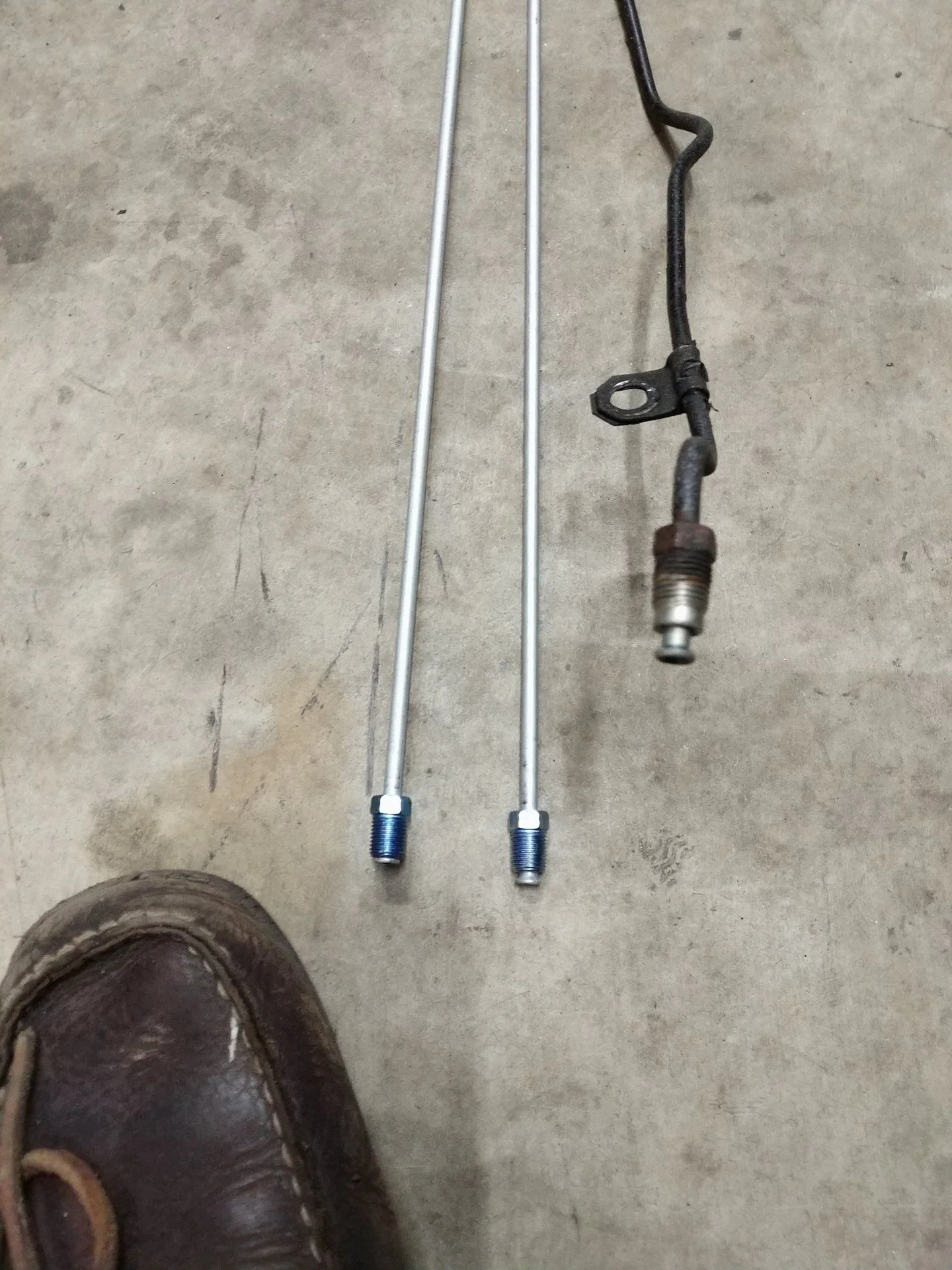

Brake lines tomorrow. Reinstall gas tank....

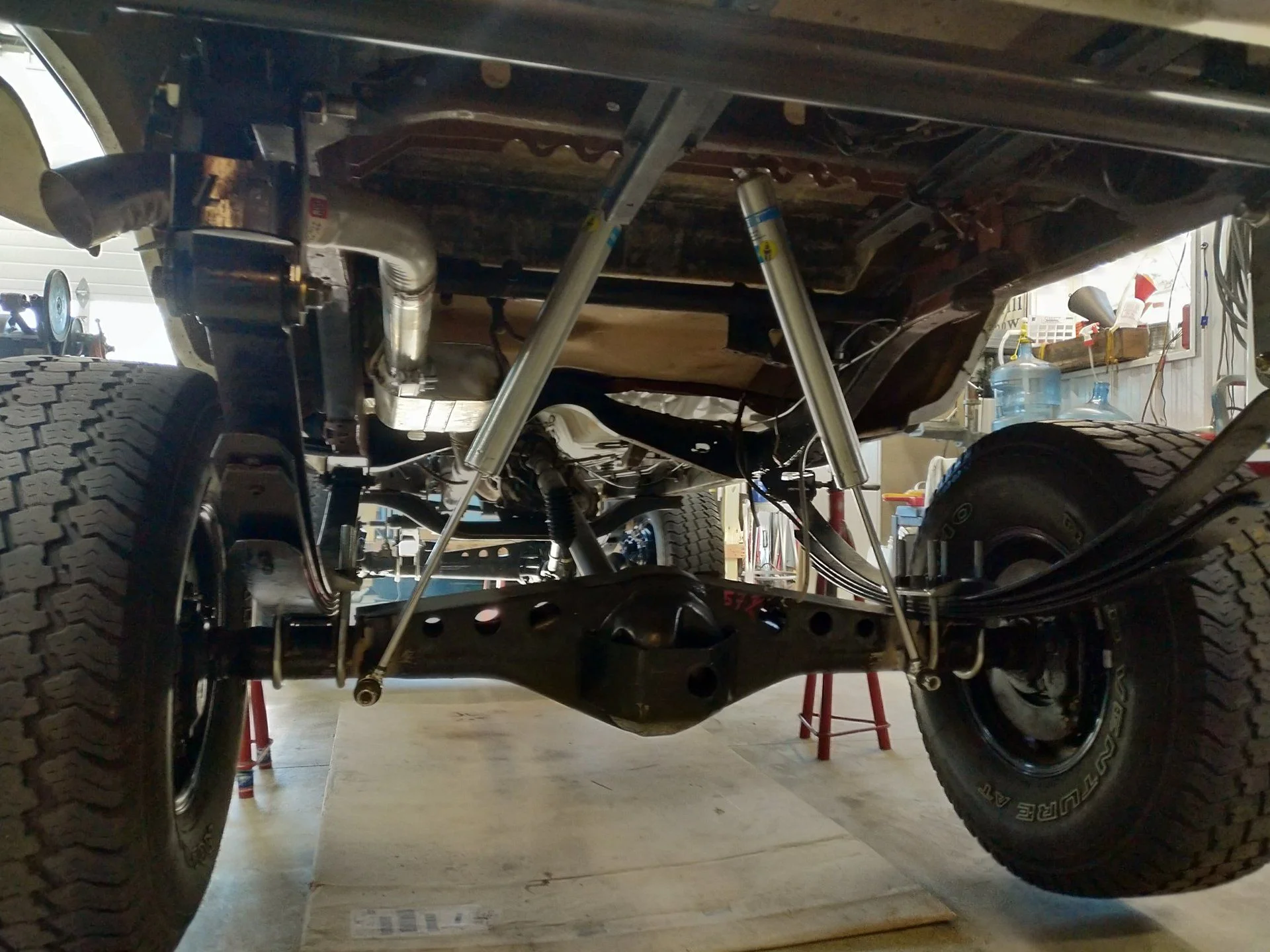

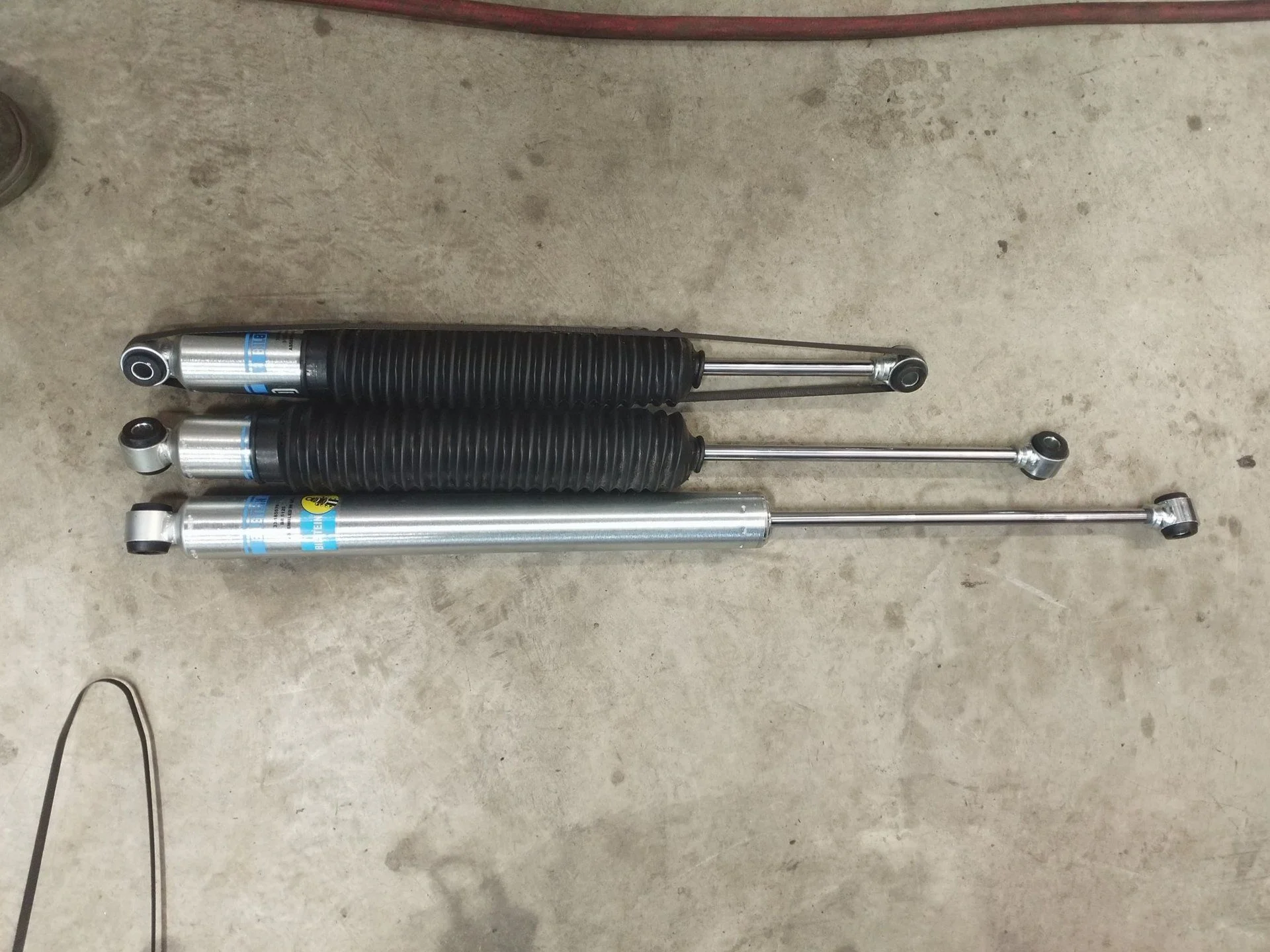

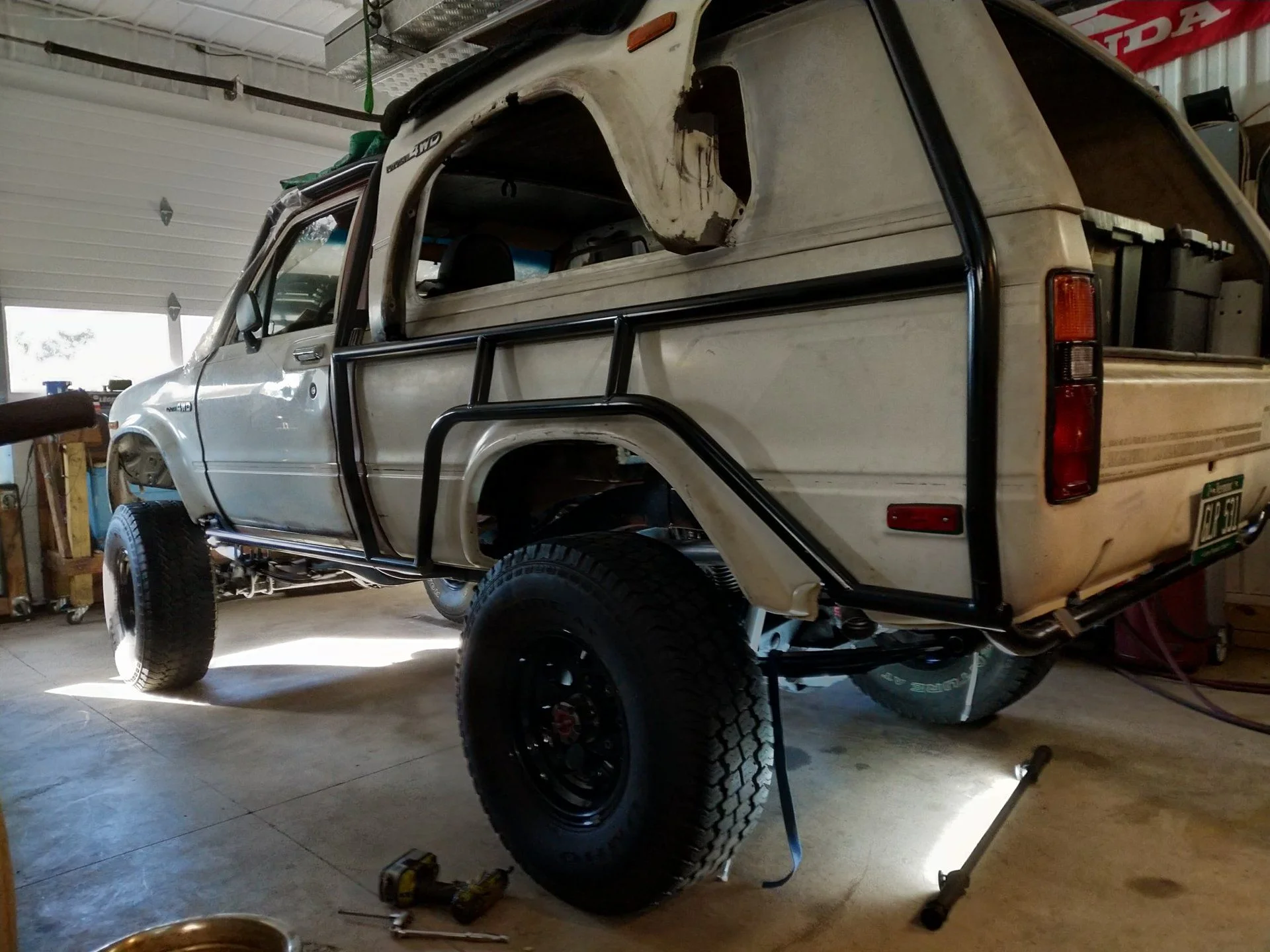

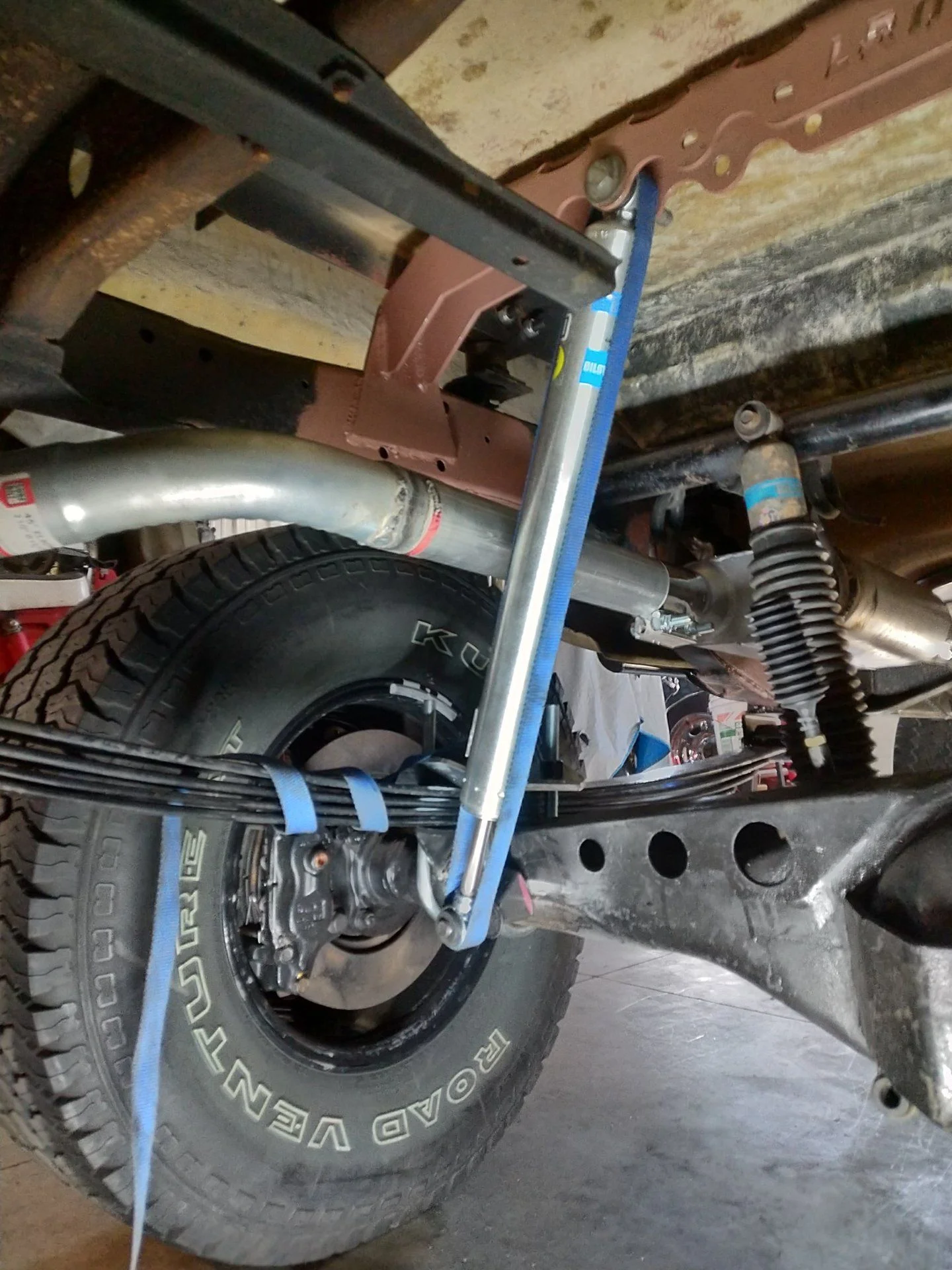

Played with rear shock mount location for a day or so.....
Very nice to have options up top.

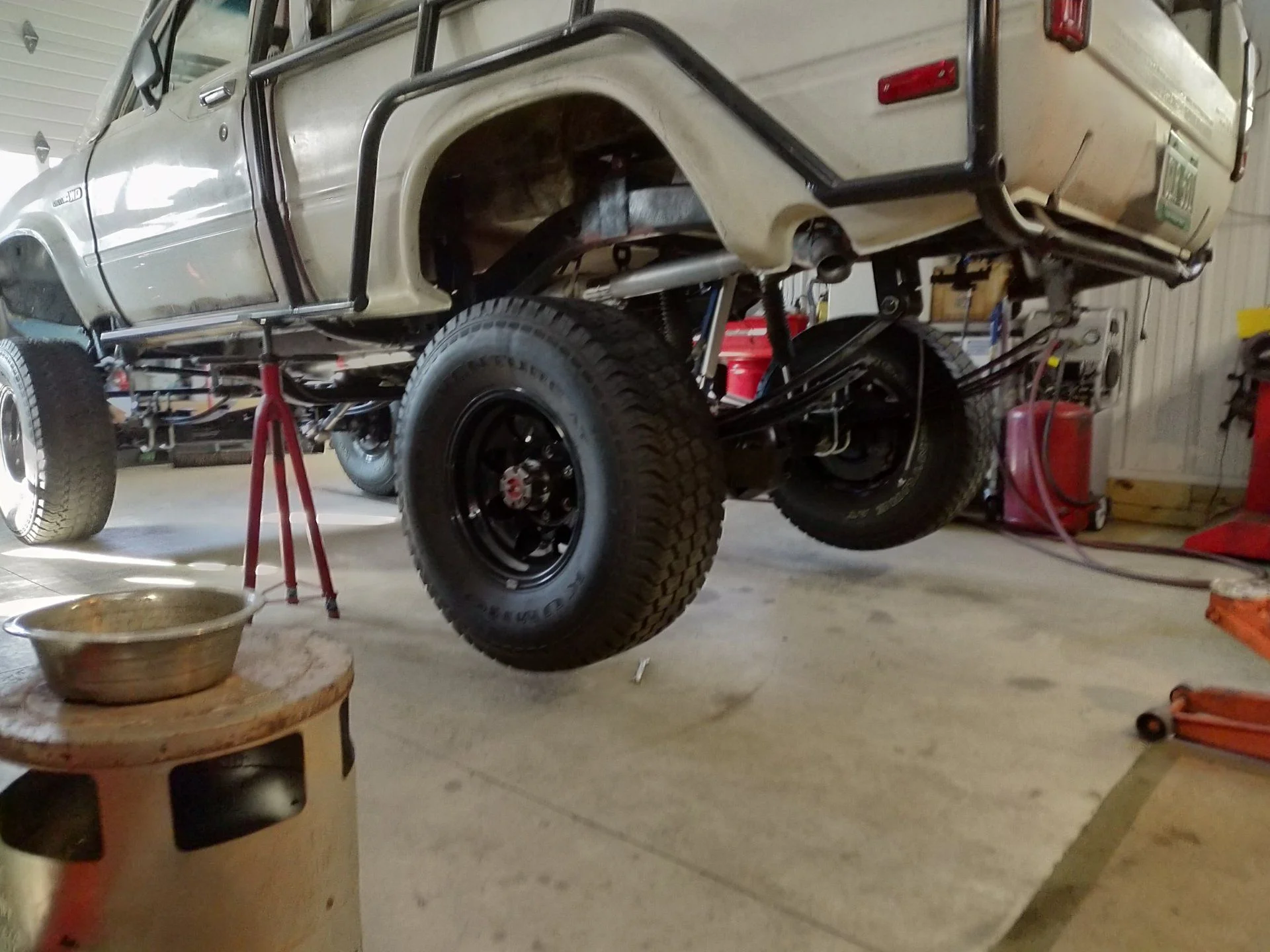

Managed to stuff the 14"s in there. They have plenty of up and down travel when leaning in, mounted to the inner holes.
Mock-up only.
Ride hight
Full droop.
Stuffed this back in it's home.

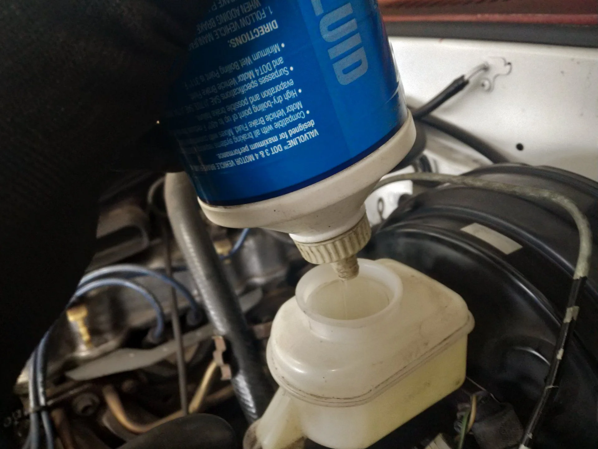

Blead the brakes.

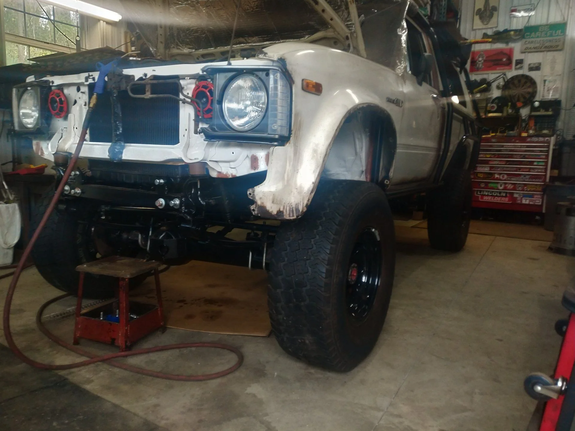

Ride hight on 32s.
Taking my time and cleaning up loose ends before another shake down run.
Can't wheel it yet, but close to a test-drive.

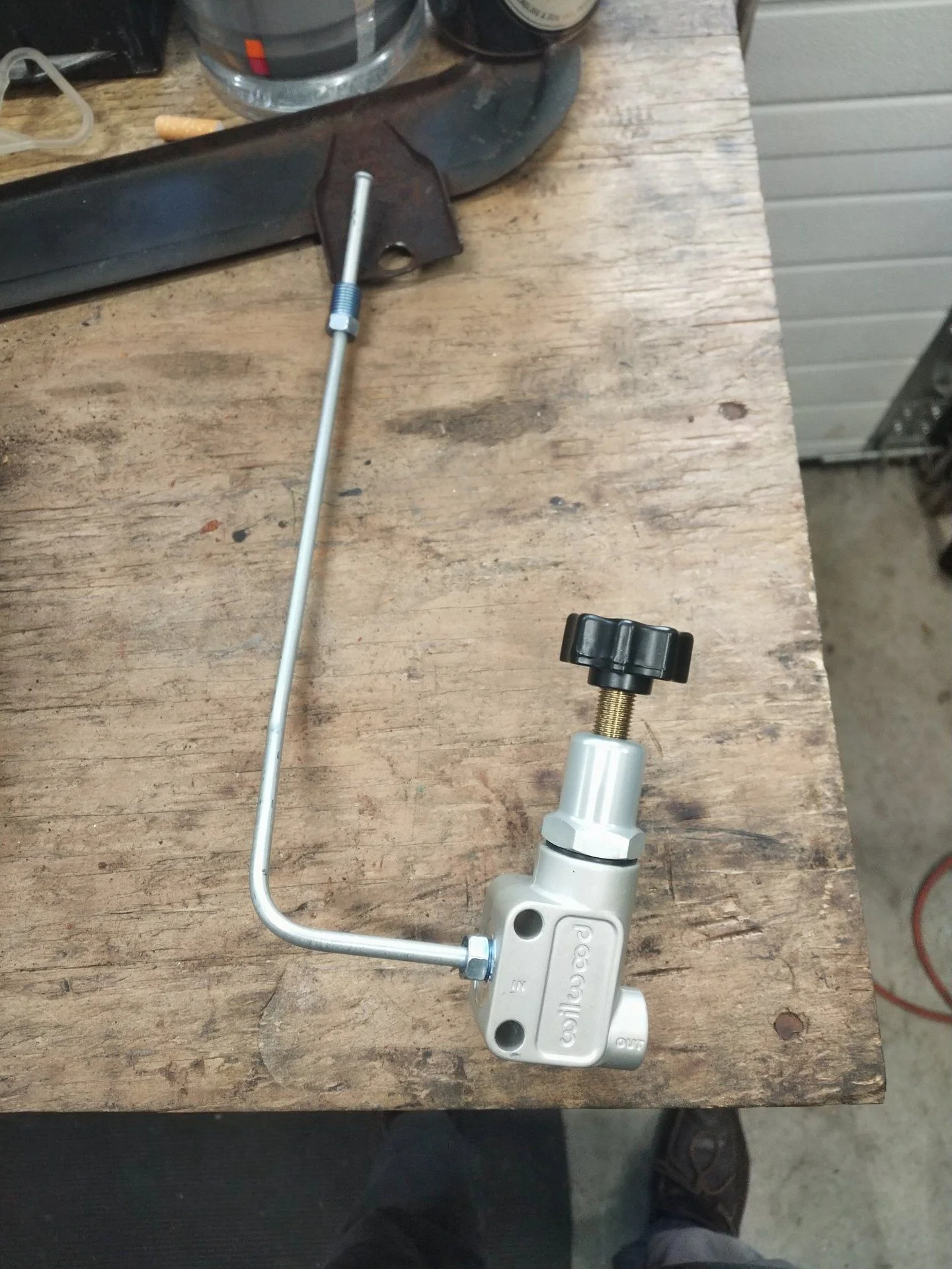

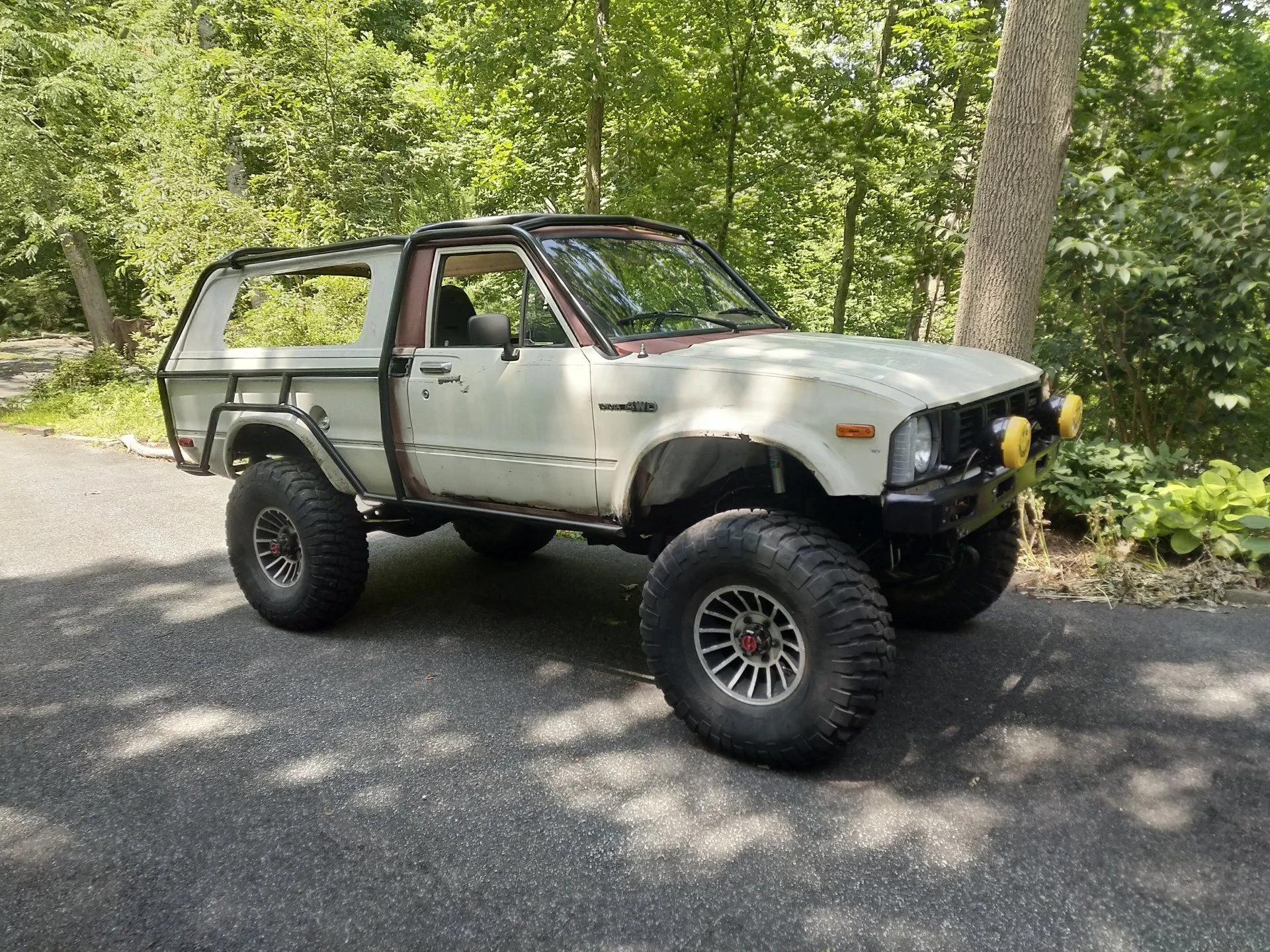

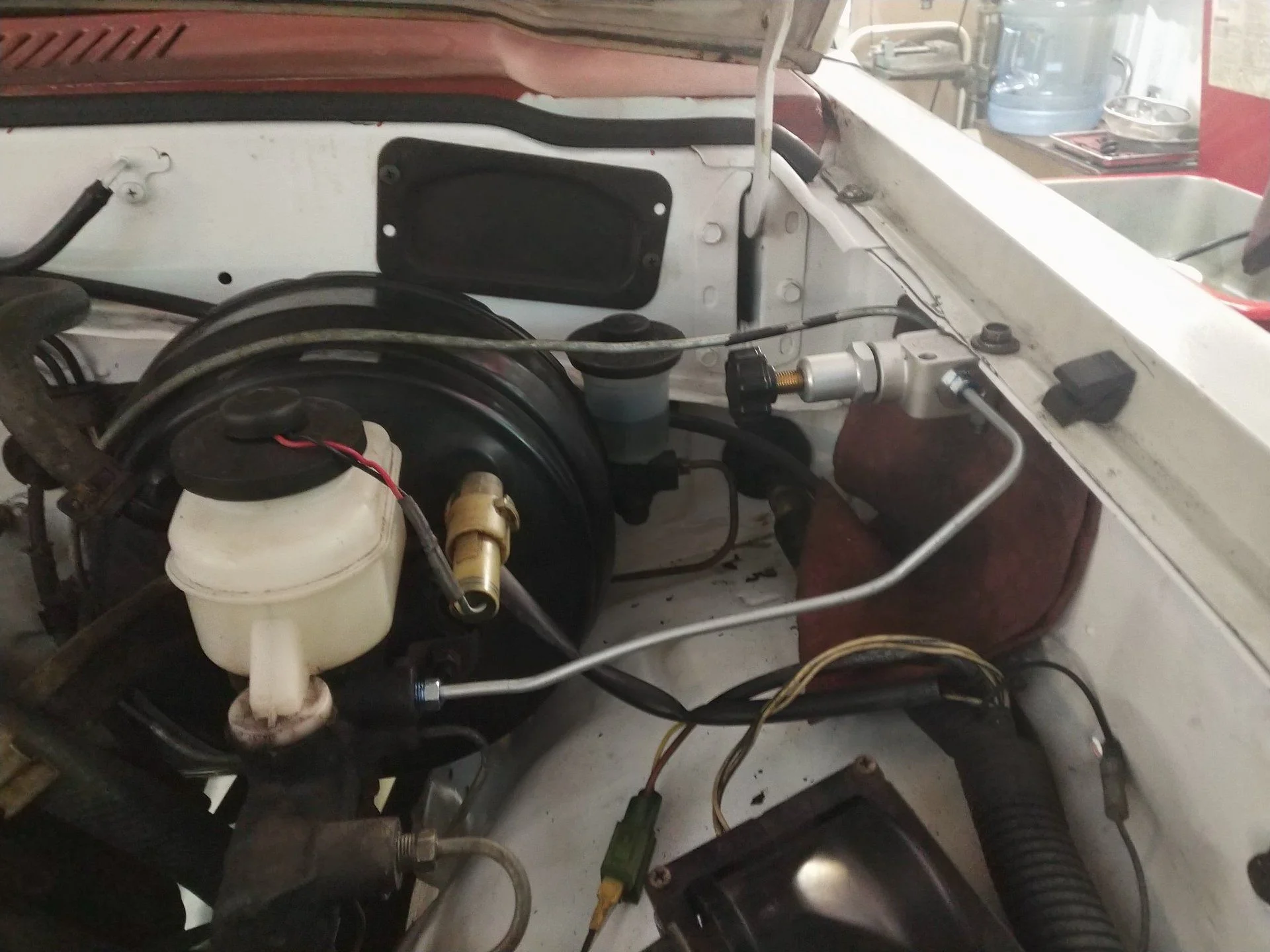

Test-drive with proportioning valve was a success. I have it cranked all the way to minimum rear and it can still lock the rear wheels, but I have no load back there yet. The brakes are excellent 👌
The wheels this Trekker came with have been on my 62 with 1" spacers and 35" tires. When I first took them off the stock axles, there were washers behind them to clear the front tie rods.
I am happy to report, the wheels clear all the big brakes and hi steer components WITHOUT spacers (or washers) on the new axles :bounce2::bounce:
And they are wide enough to protect the rear lockouts better than previous wheel/tire combos this truck has tried on.
Those wheels are sweet- are they an aftermarket wheel from the 80s?
