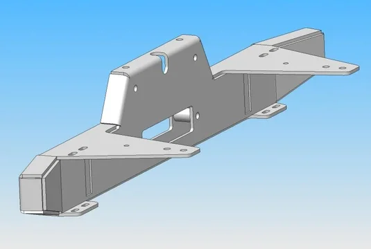

With the heavy OME springs I put in I need more weight in the front so I will have to mount one of my 8274's. Which means I need a bumper. So I have been sketching and designing a simple bumper that will bolt up with no modifications to the frame. Here is what I have so far.

Nice Design. What program are you using there? How thick will the steel be?

Yeah, I saw your thread about your little mishap. I am using Solidworks 2013, which is about the most prolific design software going right now but it is generally used by professionals rather than the public. It's quite expensive. I don't have it at home, just at work.
I have drawn it all in 1/4" HR plate and made the pieces to suit our tooling at the shop. The recovery points are 1" plate. I will have it all lasered out and then bend it up and take it home to weld.
My major design constraint was to make it bolt-on and not alter the rig because it is all original and I want to keep it that way. On my 45 the angled frame extensions were removed so I put a plate down the outside of the frame rail for more bolts but I'm not cutting the horns off this rig. This causes this bumper to sit 2" further forward than the 45. The winch will also sit 2" forward but I don't mind. It will give more air to the rad then.
I like the bends in the bumper.

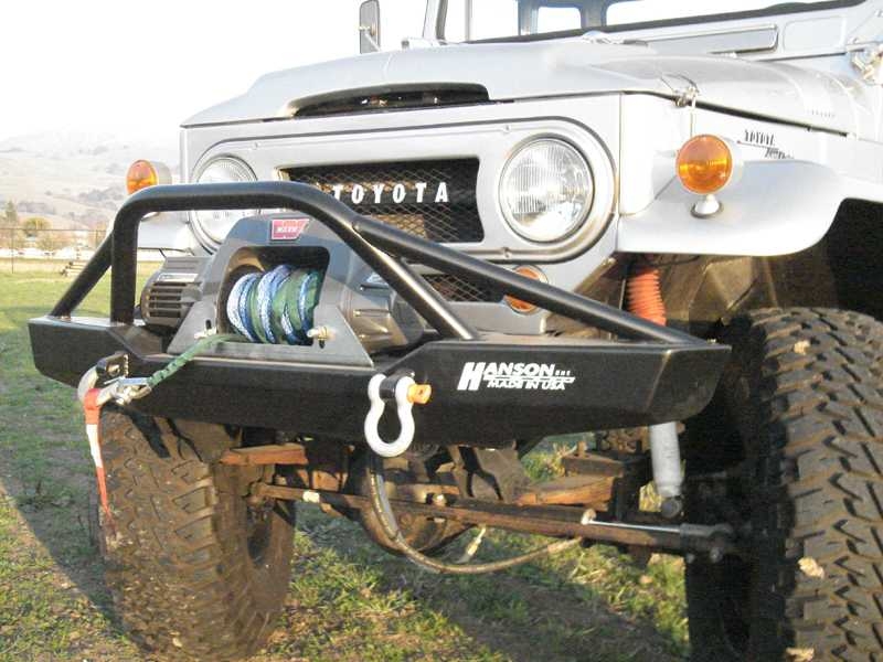

Beautiful. I love the simplicity. I made mine simple (though not as schmick) as yours. I am not a fan of the Baja-look of that Hanson.

We can bend 3/8 depending on the profile.
I've got dozens of things I want to draw up. Just not enough hours in the day.

That bumper design is fantastic. I think 1/4" is probably 50% too heavy though. 3/16" with a couple gussets would still kick butt.
Oh, wait! Are you making it out of aluminium?
3/16" would be a fair bit easier to bend tooling wise. You really think 1/4" is too much? Steel.
I made my last one from 24" of 3x5x1/4 wall tube with 3/16 wings on the ends similar to this one.

i wish i could do mock-ups like that, the old pencil and paper and grey matter is all i can work with. if you have any links to free programs to play with ... well ... that would be nice.
You can draw it with sketch up for sure. But I don't know what else you can do. That pic above is actually an assembly. Each piece is drawn individually and then they are pulled into an assembly drawing and put together. Also, the pieces are drawn as sheet metal that is bent, not solid representations. So solidworks will flatten them, account for material stretch, and give me the exact flat for each piece.
Bending sheet metal 101:
If you want an angle bracket 1"x1" by 2" long you do not start with a 2" square and bend it down the centerline. If the material is, say, 1/8" thick you will end up with a piece of angle that is 1-1/8" x 1-1/8" by 2" long. The material stretches by approx the material thickness on each side of the bend. At the shop we work with 0.005" tolerance at times so when I say "approx" I mean not quite. When you bend metal it stretches on the outside of the bend and shrinks on the inside. The percentage of shrink vs stretch is different for each material type (steel/ alum/ ss), material thickness, and size of V-die being used. 16ga cold rolled steel, for instance, will have bend allowance of 0.115" when bent 90* on a 0.551 v-die. So to get an angle 1"x1" by 2" you start with a piece 2"-0.115" 2".... IOW. 1.885" x 2". Notice, 16 ga is 0.059 thick so it shrinks by 0.003" (2x0.059-0.115=0.003). Not much, hardly worth the bother to calculate. But the bend allowance for 1/4" is 0.445" so you shrink 0.055" or about 1/16" per bend and if you have three bends on a part yer out 3/16".
Anyway, Solidworks calculates this all for you and gives you a flat that you can then make 1000 pieces from and bend 12 times within a 0.005" tolerance and make your customer smile. And the boss too.
