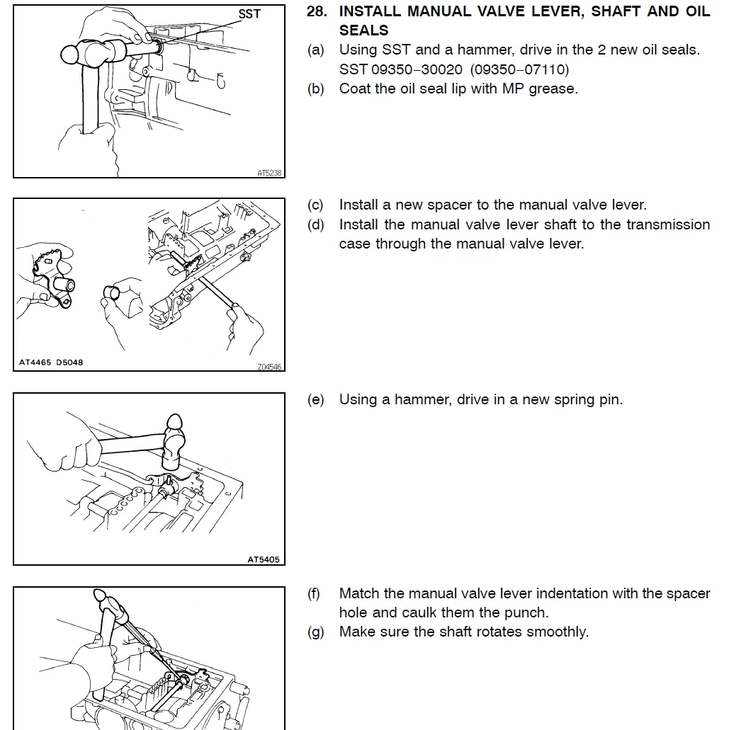

Be aware that this kit is for the floor mounted shifter linkage and not the transmission linkage, which could also be at fault. To get at that, you have to remove the pan and valve body. This also requires that you replace a crimped sleeve on the shift rod and replace two seals, one on each side of the transmission. I have one on my bench at the moment, and honestly I wouldn't want to do this from under the truck, even if I had a lift. Transmission shops do it this way, and they mangle the shift rod doing it. I have a mangled example to prove it.
This is the installation procedure:
What Toyota calls a "spacer" is a sleeve on the shift rod between the rod OD and the case ID. It gets crimped on with a punch (no lie). Getting it off without damaging the rod is the trick. The seals are included in the overhaul kit, but the spacer isn't. Transmission shops reuse them.

I honestly don't know what else to say. The post has all the information needed to replace the seal, except that a 14–mm socket will do for the SST and step (f) means "peen the pin".
