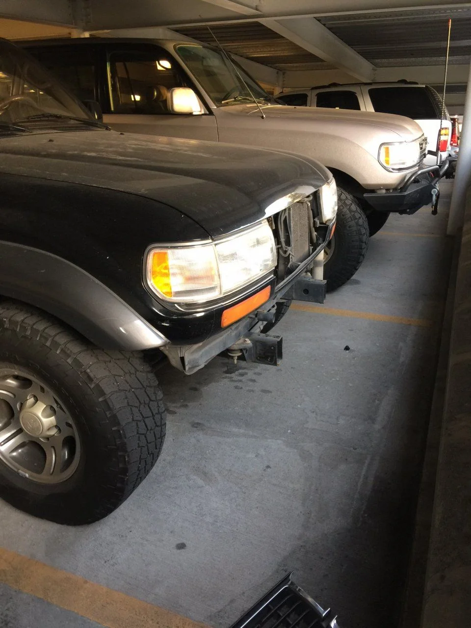

Had about an hour and a half to goof off on the truck today.
- Pulled the 2nd and 3rd row seats
- Pulled the roof rack off
- Pulled the wind deflector
- Tried to pull the door mirrors but learned the plug is inside the door panel
- Attempted to pull the receiver but without penetrating fluid or power tools that was a no go
- Pulled the front bumper and grill
Truck is great no rust (except strangely on the receiver hitch which is pretty scaly)
Also re-evaluating my idea on the front grill, I am going to need to look at it very carefully my first idea would not have given as finished a look as I wanted so not quite sure what I am going to do there.
