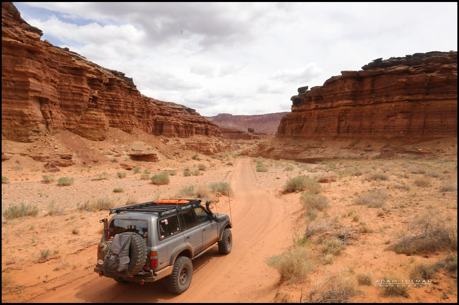

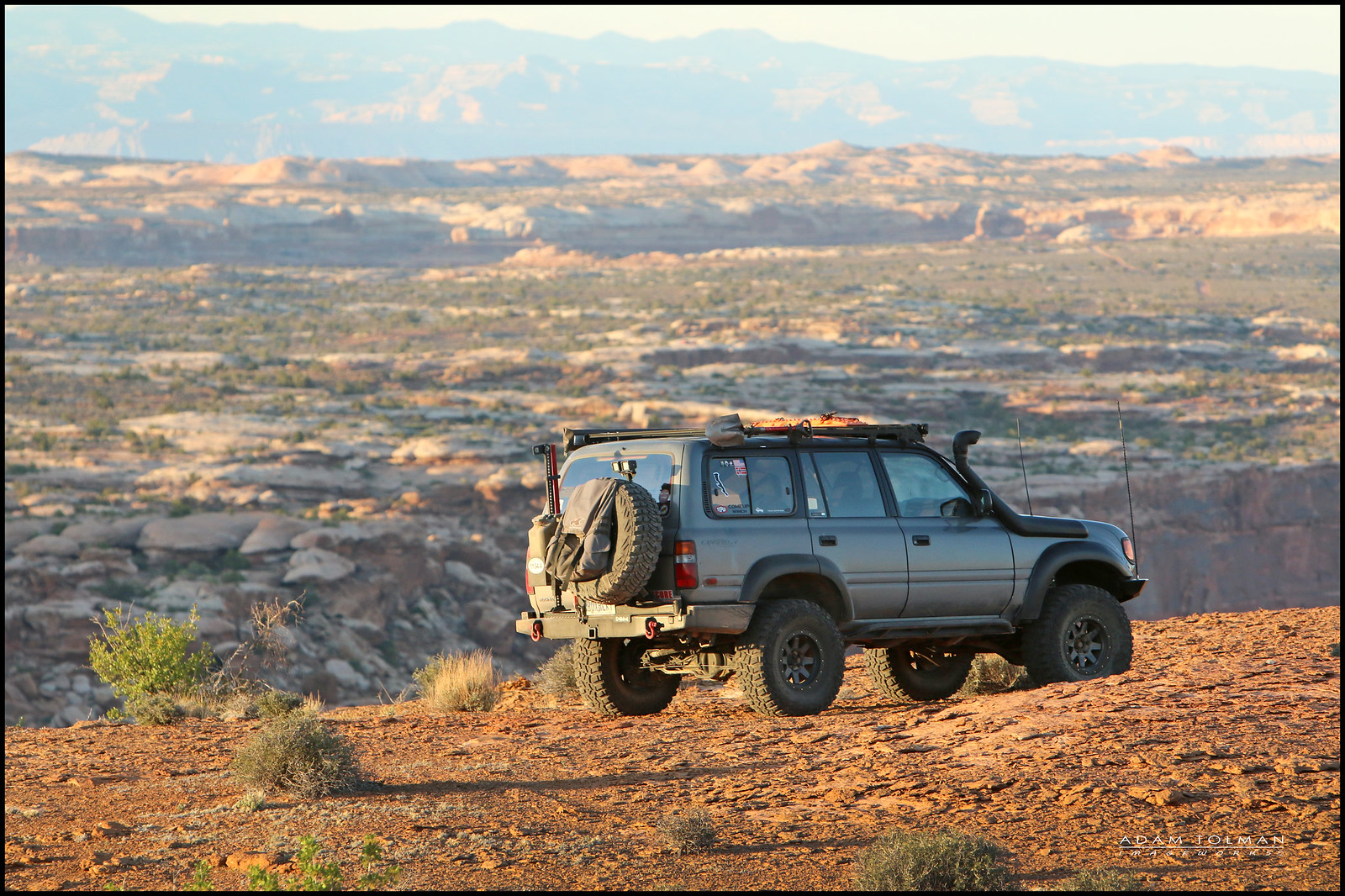

In this picture of Woodys 80 with front Patrol coils if you zoom in, I count way over 10.5 more like 13 plus...
IMG_0630 by Adam Tolman, on Flickr
IMG_0634 by Adam Tolman, on Flickr
IMG_0644 by Adam Tolman, on Flickr
IMG_0325 by Adam Tolman, on Flickr[/QUOTE]
I am wondering if you could have taken these lines with the RTT? Or would the extra weight up top make the cruiser too tippy? Reason i ask is I have a Tepui Autauna Ruggedized RTT and 2x now i have had to be winched from a friend to keep from rolling, both times slid on loose dirt into off camber situations. I am trying to figure out what needs to change, hoping it is not ditch the tent.
