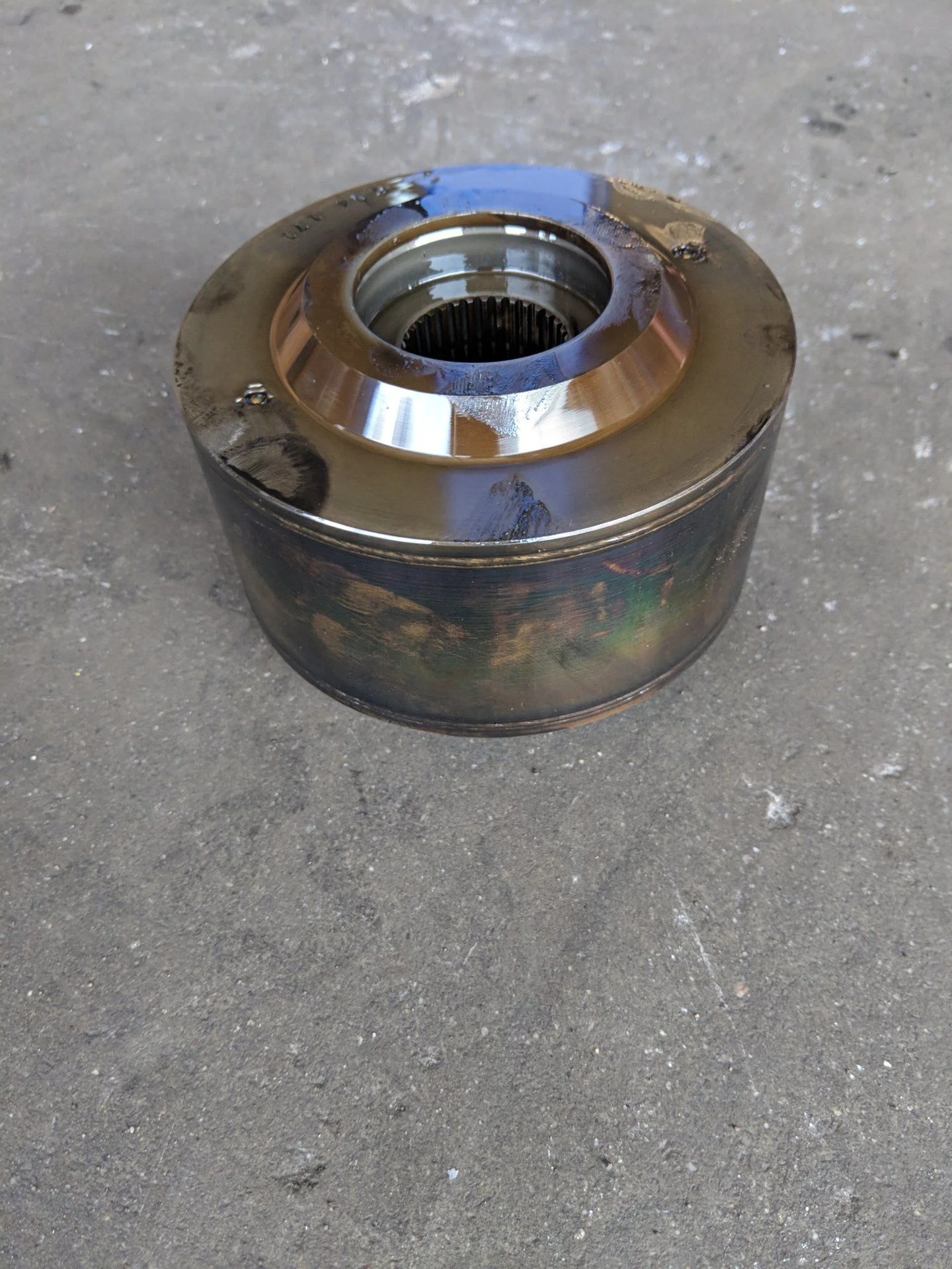

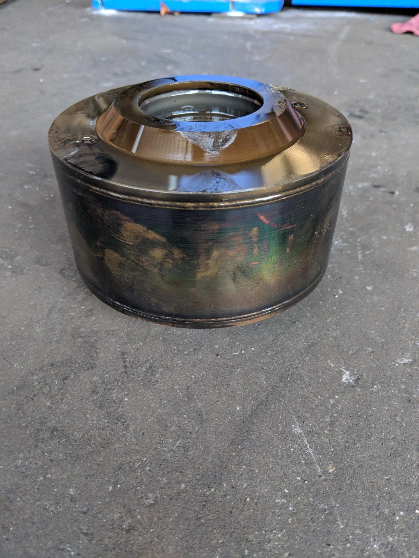

Ok! Happy to report I removed VC today, thanks for your input. It was easy from the time I started until I washed my hands was just shy of 3 hrs. It's now turning just fine, no binding or scrubbing.
Huge thanks to the peeps that are on here!
Attached are pics of the VC..
