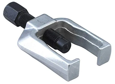

What puller are you using for the tie rod ends? Do NOT use the pickle fork.
Use this style:
You install it by hand, tighten with a wrench or impact.
Hit the nut end of the stud with a hammer (like you mean it!) inline with the stud.
Then tighten it again
Lather, Rinse, Repeat.
You can rent these from O'Reilly or your local FLAPS (Friendly Local Auto Parts Store)
Use this style:
I used the style that is a tripod shape with adjustable legs..I'll have to pick one of these up when I tackle those next! Thanks!
