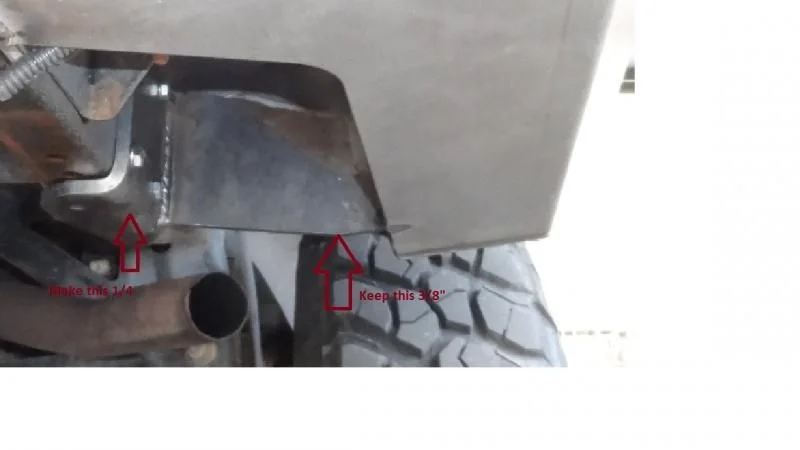

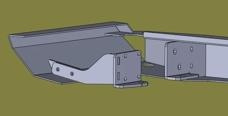

A pic from the inside would be the best view of how everything comes together.
It looks like this bumper would require removal or relocation of the exhaust resonator. If so I would probably fabricate a custom bracket to go over exhaust pipe and leave the OEM exhaust in place.
What gauge steel are you using for the shell?
3/16 for the bumper
3/8 for brackets
3/4 for tow points
if you read though the thread it will answer all your questions.
I do not have the resonator on my truck, post 118 shows my attempt at a bracket to clear it.
