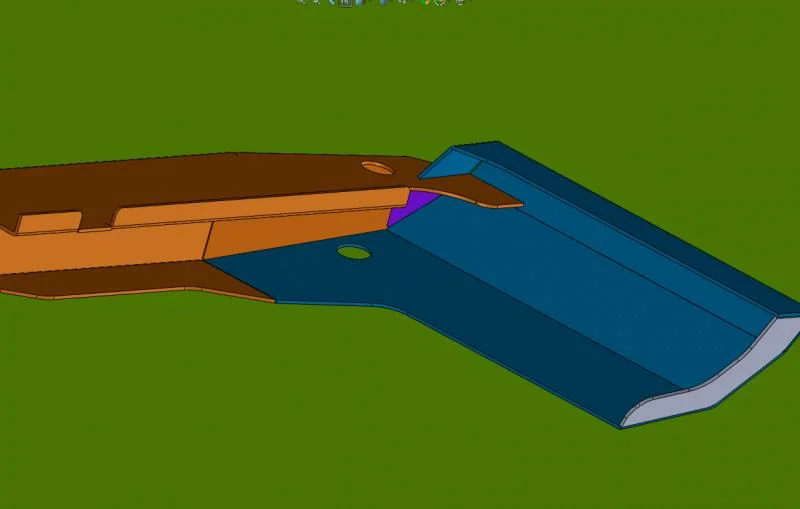

so here are a few pictures of what would be going out, this is Rev 2 there were a few things that i wanted to change.
each joint allows for a full pen weld from one side, I still went though on mine and back welded 100%, just how i roll..
Pictures:
1. shows the different pieces that require welding to create the bumper shell.
2. Shows the brackets (bumper wing removed for clarity) and where they bolt/weld
3. Shows a outside corner view of the weld joints, notice the notch in the blue part, this is to help with layout. the main bumper key fits into the wing and then a quick weld joins the two.
