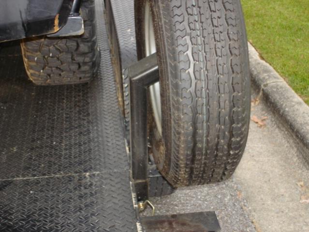

Trialer I
Here are some pics of my trailer loaded...headed up to the cove (TN) for a ride with some of the TN guys tomorrow. 10.4K trailer
Trailer 2
more pictures showing the trialer, straps, toolbox. etc
Trailer 3
more perspective....
