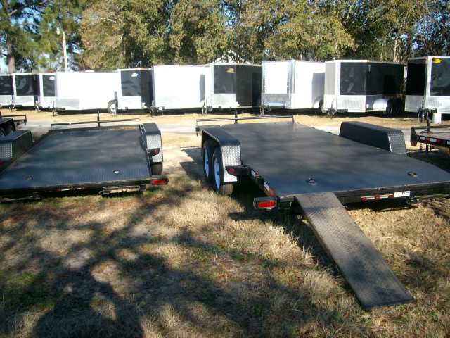

Yeah the trailer I'm looking at is a 10k trailer (2 5/16 10k coupler, etc) and they sell it with either 2 3500# axles or 2 5200# axles. The brand is called "Down 2 Earth". The place I'm looking at is an authorized retailer. I've looked a few other places and these seem to be the best (at least best looking) construction. They have built in D-rings, solid ramps, etc. A lot of the other ones I looked at had no tie downs, angle iron ramps, and just didn't look as sturdy. That being said this one is a good bit more expensive. I'd rather not discuss the price bc then everyone is going to jump in and say "you can buy that same trailer here for 1000 less" etc etc. I'm willing to pay good money (probably a little too much TBH) for a good trailer though. I don't want to ever have to buy another one.
Here's a couple pics from their web site:
Pictures are of the 7k.
take a look at the wiring, is it run inside a conduite or just hung off the inside of the trailer?
is the e/brake back up battery a water tight unit.
i did some research and ended up buying one from High River Alberta (not practical for you) and it was about $1000 more than other trailers of the same size. I like the no BS sales, i liked the quality of the trailer, the attention to detail (water tight conduit from front to back, good quality plug, aluminum rock guard, etc). never regretted it.
i have found you pay a bit more upfront and have piece of mind in the future.
do your research, ask the company for a couple people that have bought from them and then contact them for a review. me, i did a tour of the facility and chatted with the employees. they were happy and usually a happy employee shows a shop that cares. if the shop cares about the employee then it makes sense it will care about the customer.
sorry for the rambling.
oh, and slide in rear ramps are REALLY nice.
i ended up making 8' long ramps since i load some pretty low slung vehicles at times and i disliked the Vbar ramps so i made the grip ramps.
i also towed (weighed at a weigh station) 18K across Canada and the US a few years back. the heavier braking worked very nice as well as the axles and suspension worked great. i did have to upgrade the tires from 8K tire rating to 12K Samson units for the tow. i was impressed.
but i don't recommend that kind of nonsense to others.

I believe it does have the conduit wired that way. I'd have to go look again to be sure though. That's one of the things I like about this manufacturer. They are a local Georgia company (factory is in Baxley, GA about 2 hours from where I live) and employ my fellow Georgians. I like the idea of going to see where they are made. It actually has an open invitation on their web site to come visit the factory.
well worth the drive if it gives you piece of mind with the investment. trailers are not a cheap investment and a cheap trailer could lead to an unsafe load situation.
99.999% of 7 or 10K trailers produced will work just fine for your application. Personally I would do the 10K just to have the extra load rating. It'll potentially get you better options for tires as well. Go to the plant 2 hrs from your house and see how they are built. If you like it, take one home with all of the options you want.
I hate trailer tires. Almost all now a days are garbage.
BTW, I might see if they would do a flip up jack as an option. I hate hard mounted jacks. They drag a lot.
BTW, I'm not a fan of this design for a car hauler. Too light duty. Be good for a rhino or RZR and quads tho.

I did check the website about the wiring it is a "* completely sealed wiring harness" according to them.
Mace: What don't you like about the trailer design? I've hauled a number of other trailers that were similar design and I like them for my use. I didn't much care for the equipment style trailers with skids and open in between. What other type should I look at?
