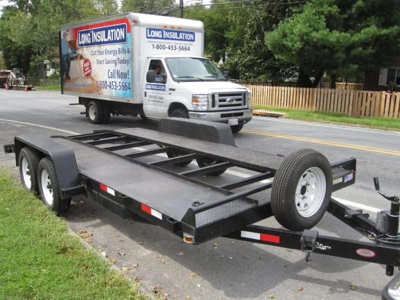

Look at how the tongue is designed in the first pic you posted and how it is set up in the pic I posted. Welding the tongue directly to the deck is not nearly as strong as another sub-frame under the deck.

100% agreement with Mace about the frame design. I would pass on the "no sub frame approach".

Just to be clear, this is how all trailer tongues should be built, regardless of the size of the trailer. Notice that it is UNDER the frame of the trailer. Doing it this way avoids building a hinge at the front of the deck (see Mace's example of how not to build them) and adds some strength where it's most needed.

Yeah I like the idea of the swing up jack. I believe they have a 7k swing up option so I'll check into that. So back to the construction thing. The pics I posted are the way it is supposed to be, correct? The A-frame goes under the trailer and attaches to the other part of the frame there.

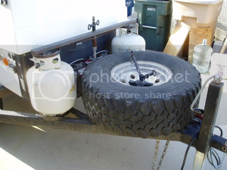

My non flip up jack turns easily, and drags all over the place. It's not an off road thing, it drags going in and out of parking lots, gas stations, etc. By the time you run the hitch about 4' from the rear tires (F350 long bed) if you drive through a ditch, it's really easy to get close to the ground.

And yes, the pics you posted (lowe) are the correct design. The one I posted is not.

maybe your leg sits down lower than mine, is it similar to the one in the pic 3 on my other post?
One thing I do like about my dovetail is that any rig with tires 35 or larger I can just back off without messing with ramps. Most of our trail rigs have 38s and up and these I can just drive onto the trailer without ramps as well.
I don't take this trailer off road. But it does pull into unimproved trailheads, driveways, back yards and occasionally roadside ditches. Towed with an '80 (either a stock one or one with 2 inch lift), or towed with my Suburban... or really anything that puts the trailer level when hooked up... the leg would drag all the time if it was not swing away. If the trailer (and attachment point for the leg) sat higher, that would not be as big an issue.

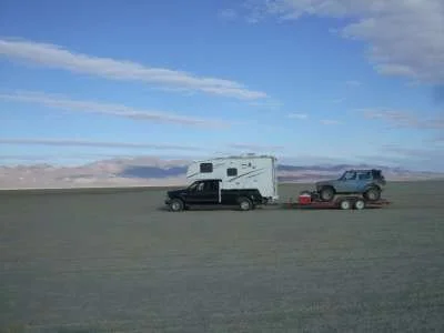

I tend to take the trailer on lots of dirt roads. None of them are that rough, but it does see dirt usage. Here is a pic from the Middle of the Blackrock Desert. Course, they do land speed records there as well so ;)
