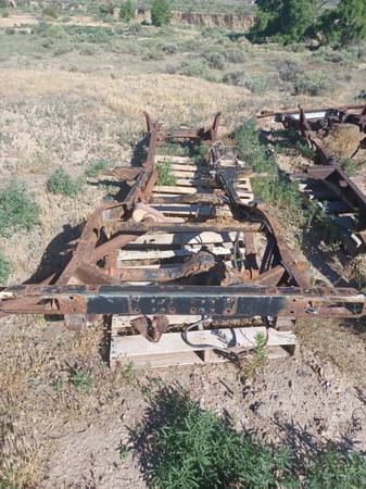

There is a guy in Gallup, NM who has has a couple frames for sale on Craigslist for awhile. I realize it’s no where near you but I’m in NM for the summer and may be talked into a road trip to inspect. They look decent from the photos.
These have been listed for awhile and we’re previously listed for much less FYI so I’m guessing the OBO part is very real.
1979+ frames are different from prior years and won’t work for OP. Otherwise that would be a good deal especially coming with a title if you need it.
