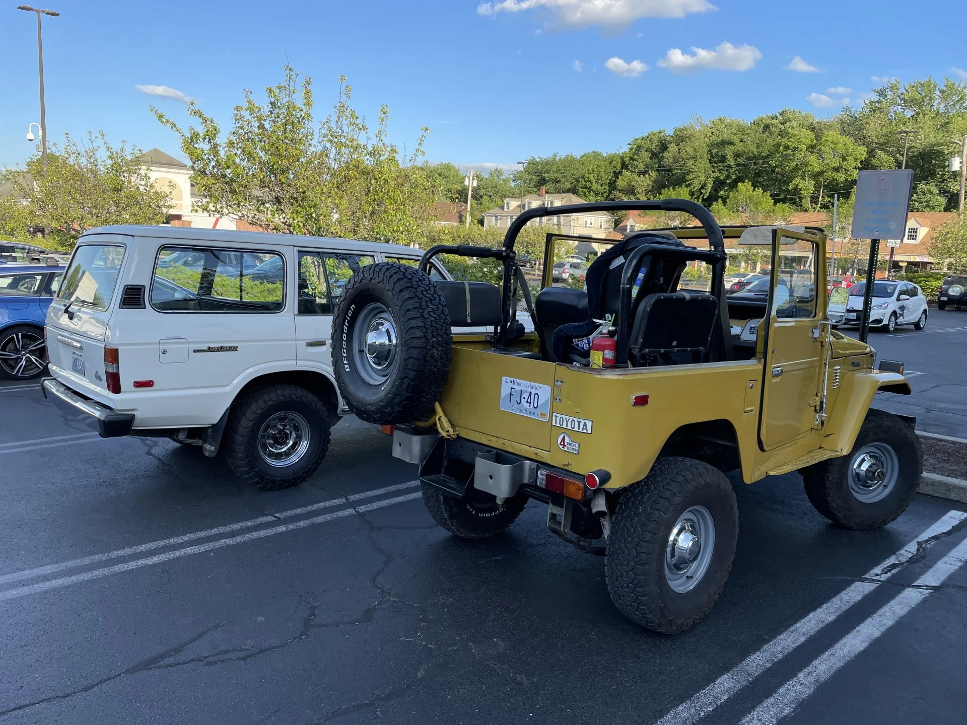

Look what recently moved into the neighborhood! Still stalking the owner, haven’t met him yet…
I have a local group which is now about 10 strong. Mostly guys who I met at the gas pump, etc.
We have five 40s, one 60, one 80, two 100s, two 200s, and a 55 that just relocated to Austin.
Keep stalking my friend

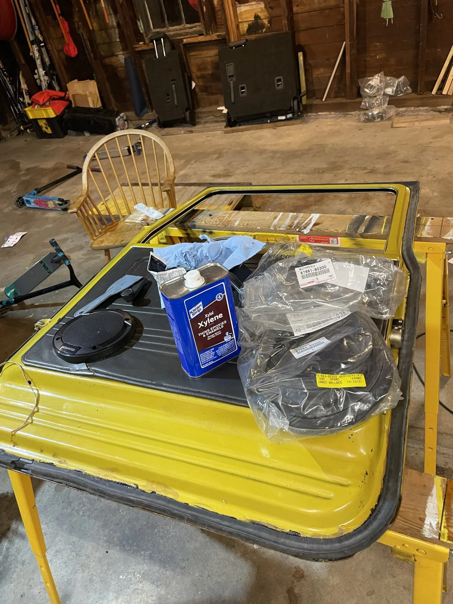

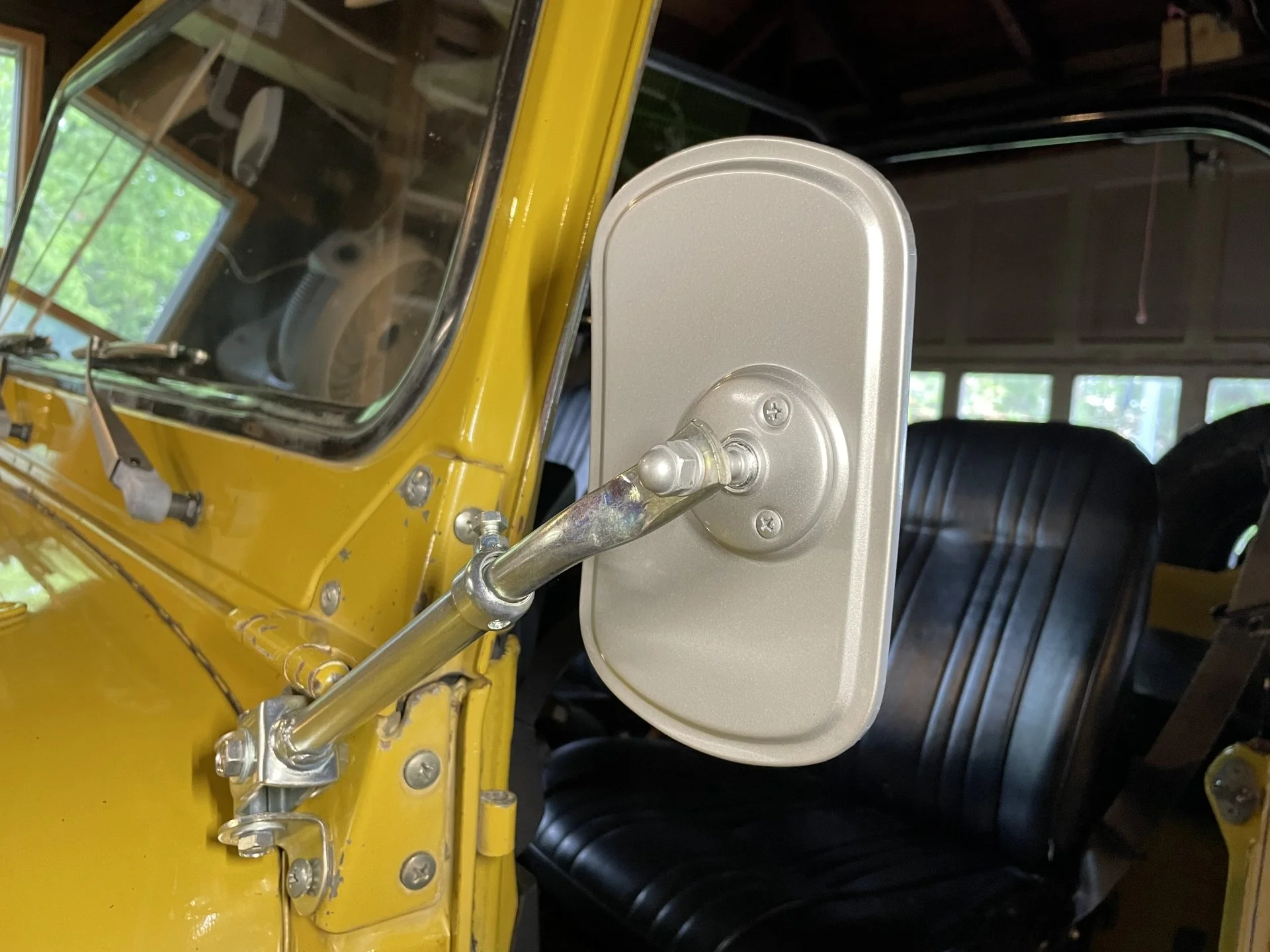

Removed the doors this week. That meant that the mirrors and speakers also disappeared though. So I picked up some of these from SOR and then some of these mirrors and arms after reviewing this helpful thread from @Onur . The mirrors are the convex type. In hindsight I might have gone with the 87901-60011 as the convex are rather small, and have a lot of distortion to achieve a really wide view (objects in mirror are much closer than they appear)
The kick vent panels fit ok, but were maybe 1/8" too big on the top and bottom I'd say. I wasn't crazy about drilling new holes into the tub so I used 3M Scotch Mount tape since I had some (could probably use VHB too). It seems to work well so far. If I didn't have the OEM floor mat, it would have been a good bit easier. The mat takes up more room than you'd think and eliminates some of the surface area for mounting, but I'm not about to cut it! I did trim the passenger side speaker panel a bit on the bottom with an angle grinder. I can still operate the kick vents, but just barely. For paint, I did a few coats of primer on the speaker panels, then several of the mustard which I got from Automotive Touch Up Paint, and some clear. It seems very close to the OEM color in person, close enough no one would notice.
I used cheap Kicker speakers from amazon that fit great and sound decent. They're plenty loud even with doors and top off, though the sound quality isn't great, but I wasn't expecting it would be.

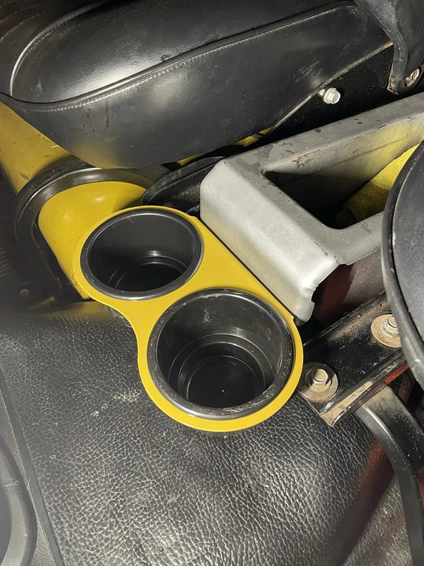

Cup holders from @corleykj came in a few months ago now, painted them to match with rattle can from Automotive Touch Up Paint, and they came out pretty well.

Loving the color perfect cupholders

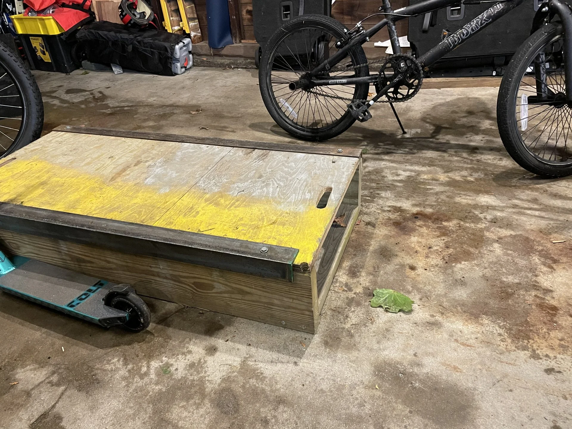

Rainy day here and managed to be able to spend most of the day in the garage since kids soccer games were rained out. Built a grind box to keep them out of the house.

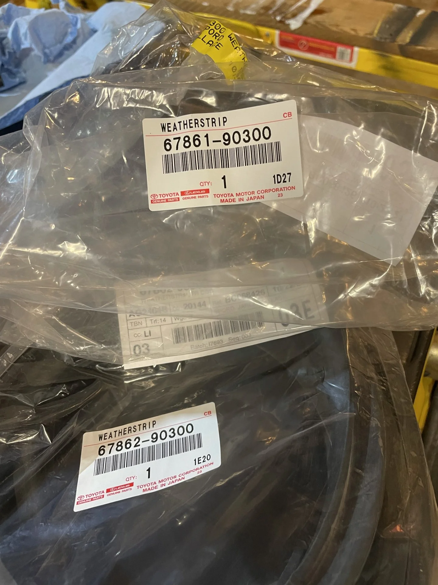

Pulled off the aftermarket door weatherstrip and replaced with OEM Toyota. Big improvement.

😂 a grind box, of course! Did you grind the cruiser?

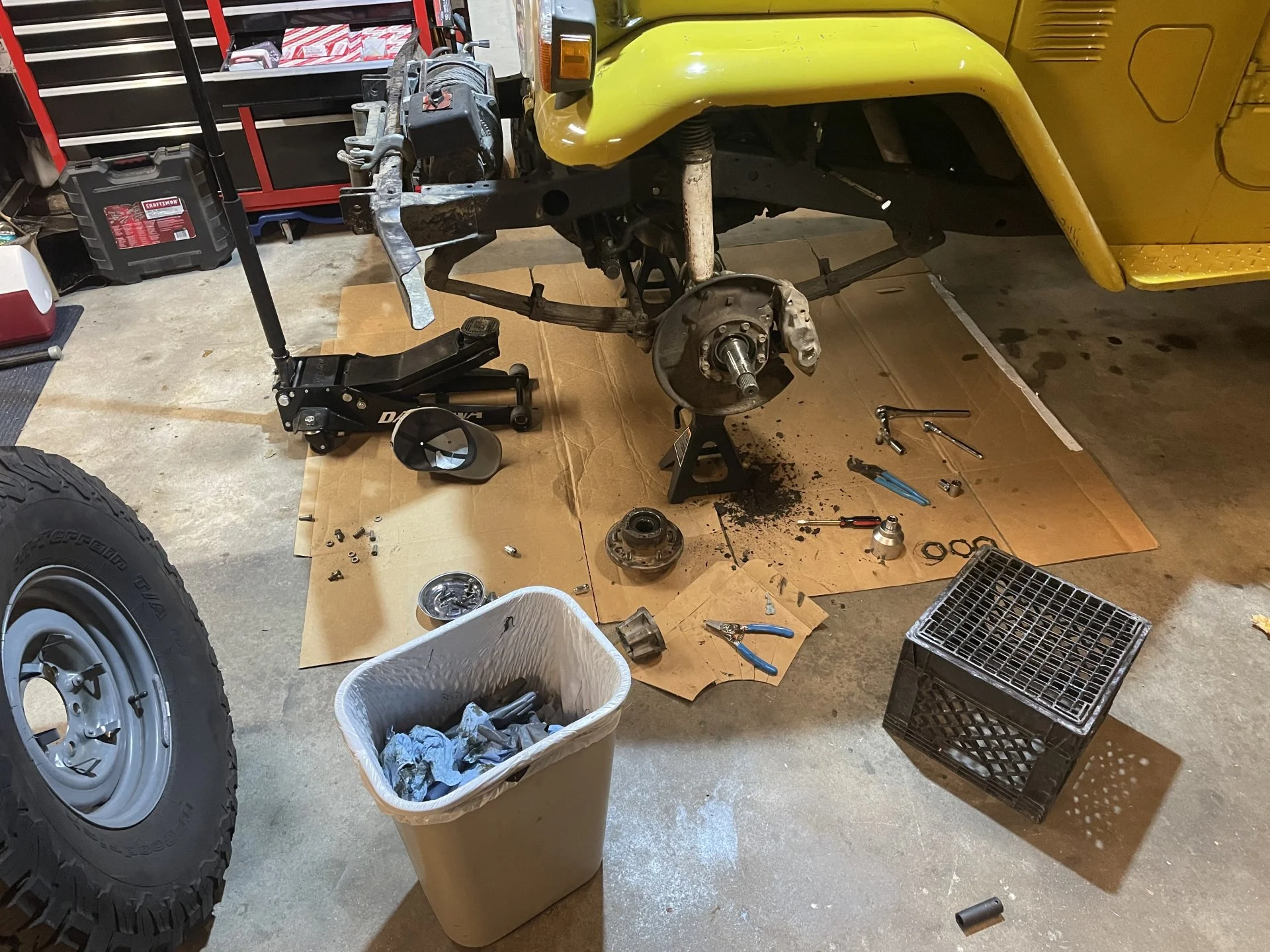

I noticed a little play in the front wheels, didn't seem to be loose lug nuts, so decided to check the hubs. But 2 of the 6 allen screws on the Warn hub don't want to come off! I tried: Leverage, PBLaster, Heat, Reverse Drill Bits, Extractor set. And I'm left with one that's just stripped and stuck, while the other has part of a drill bit inside it now.
Any ideas?
Well, I got the allen bolts out by drilling the tops. Messed it up a little in the process, but found replacement hubs at half off on Amazon warehouse, so figured I'd replace both sides and keep one as a spare. PBlaster or other penetrating oil and patience are definitely the way to go next time. Getting the snap ring off was the hardest part. Used the fish scale method per FSM to adjust the pre-load on the wheel bearing, a first for me. Went ok, except that passenger side was up to 40+ lbs of resistance if I snugged both hub nuts on. If I backed it down to 12lbs, the wheel was a little lose. For now, it's a little loose and I'm guessing all the goo has something to do with it.
Oh, and a knuckle job is in my future. Like immediate future.
Plan is to replace TREs, shocks, knuckle job, and maybe steering damper this off season. Hopefully that will improve the steering and ride. If anyone has any great tricks for getting the wheel bearing preload just right, would love to hear.
