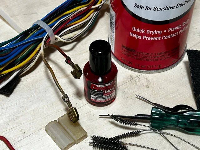

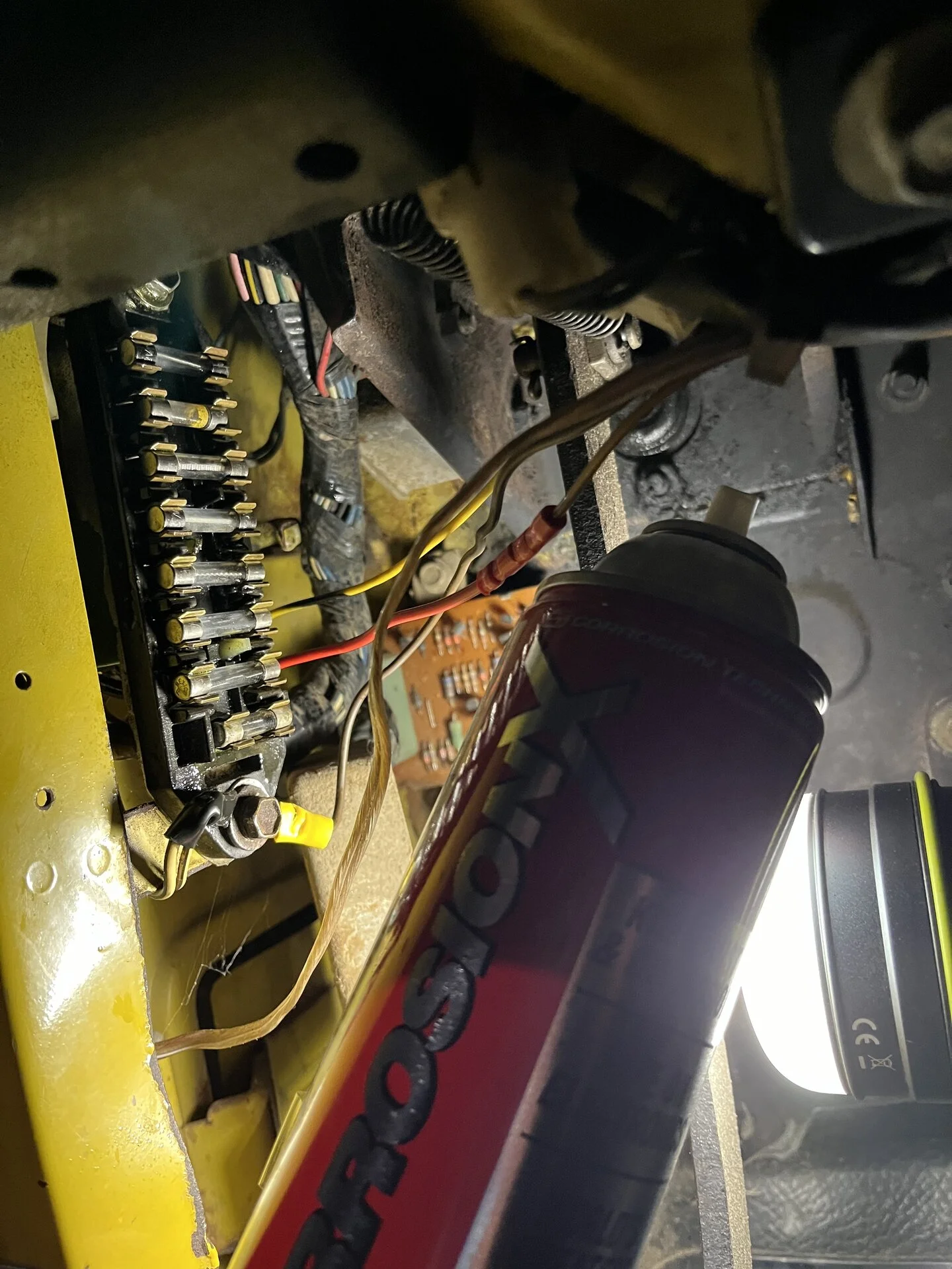

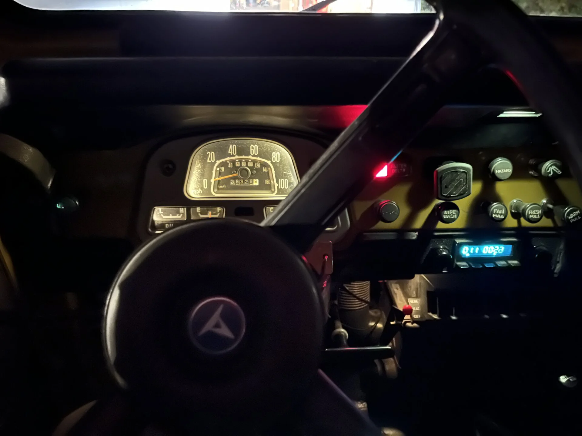

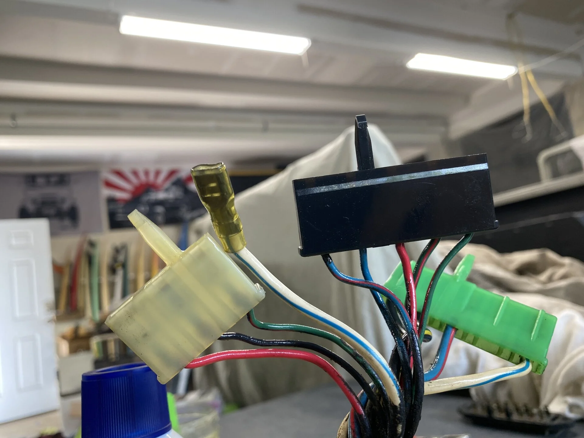

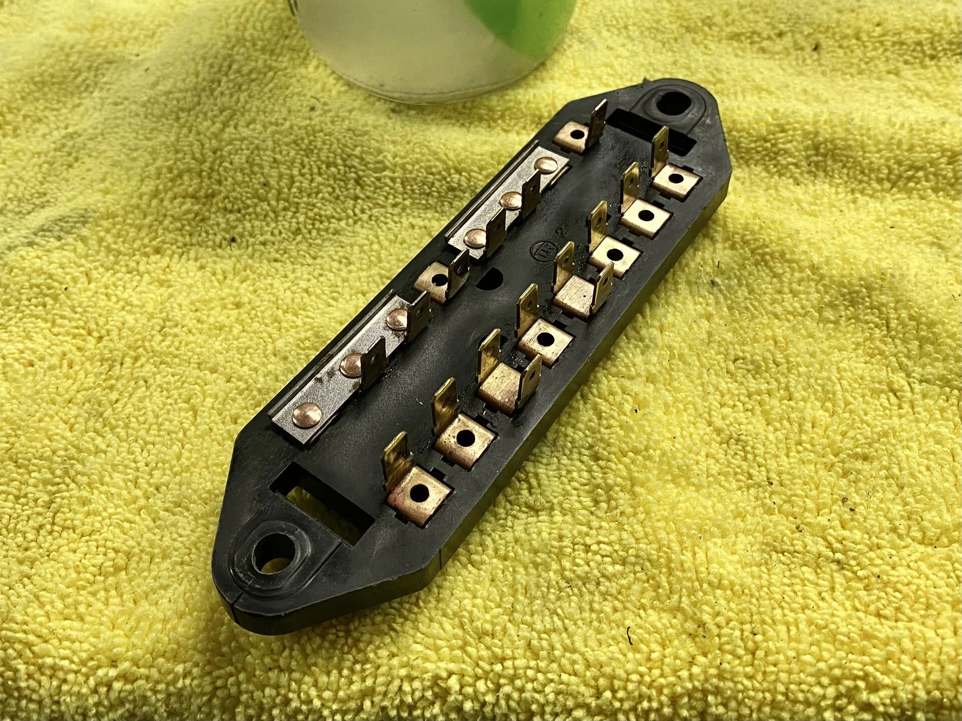

Starting the winter projects. The interior lights weren't working very often, and this time of year I'm actually using my lights. I removed all the fuses, used fine grit sandpaper on the fuse box, reinstalled and hit every electrical connection I could find with CorrosionX. @Aloha Jen recommended it and after doing some research, I pulled the trigger. It's not cheap, but seems to work very well.
I now have consistent illumination!

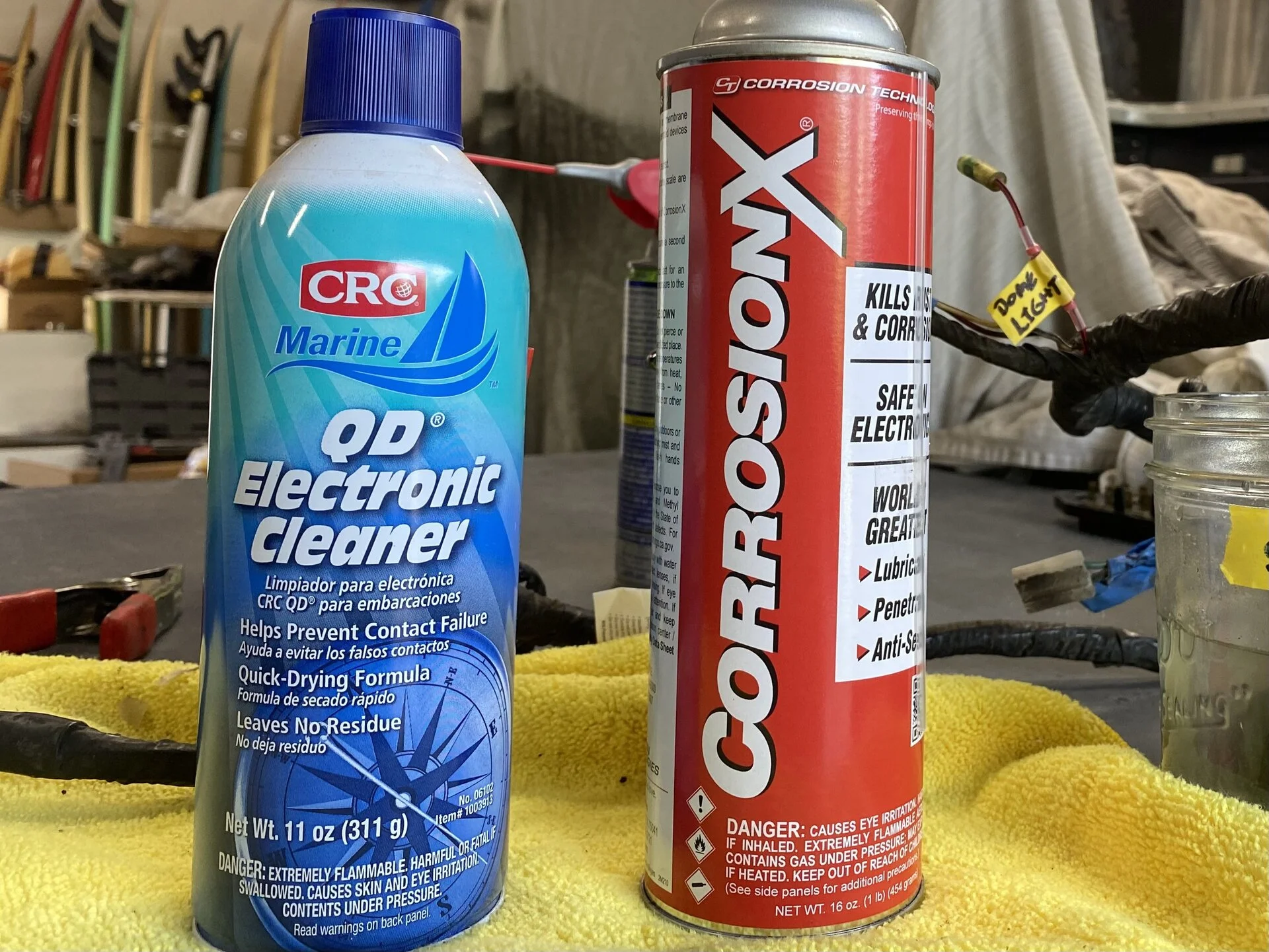

CorrosionX seems to be a very good product. I live across the street from the ocean and a right in front of a boat harbor. A lot of the boat guys there swear by this stuff on their electrical connections that need to work in a marine environment. I used it on every single electrical connection on my 40. It seems to also work its way up into the wire under the vinyl sheath to get at the hidden corrosion. Well worth the expensive price tag in my opinion! Your 40 is s looking great!!
Thanks, I'm across from Narragansett Bay on the other side of the globe, but similar concerns on rust from the salt water. Do you use the QD Electronic Cleaner first, or can you just spray on the CorossionX?
I use the electrical cleaner first to try and remove any dust or dirt. Then you have a clean surface for the CorrosionX to coat and protect the metal terminals and exposed wire ends. I would say it’s definitely better to use some kind of electrical connector cleaner first.

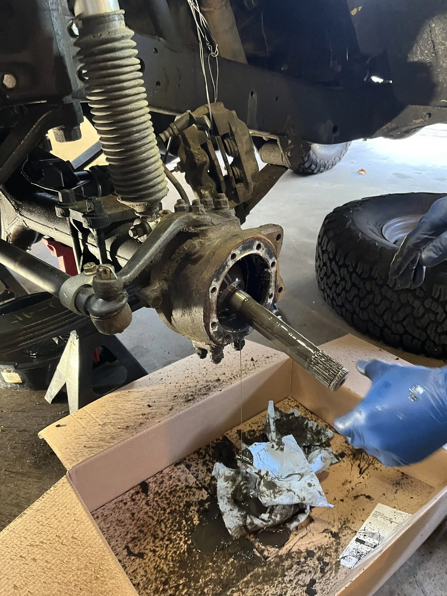

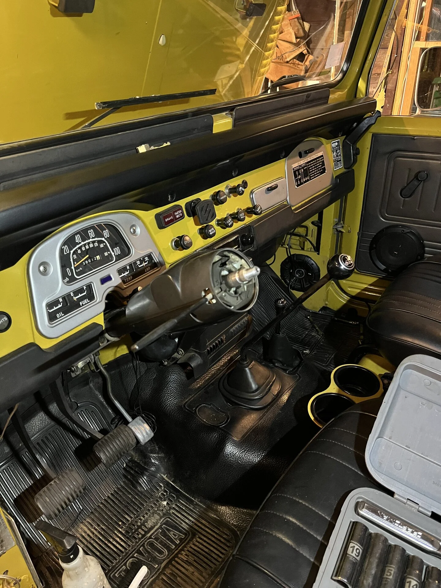

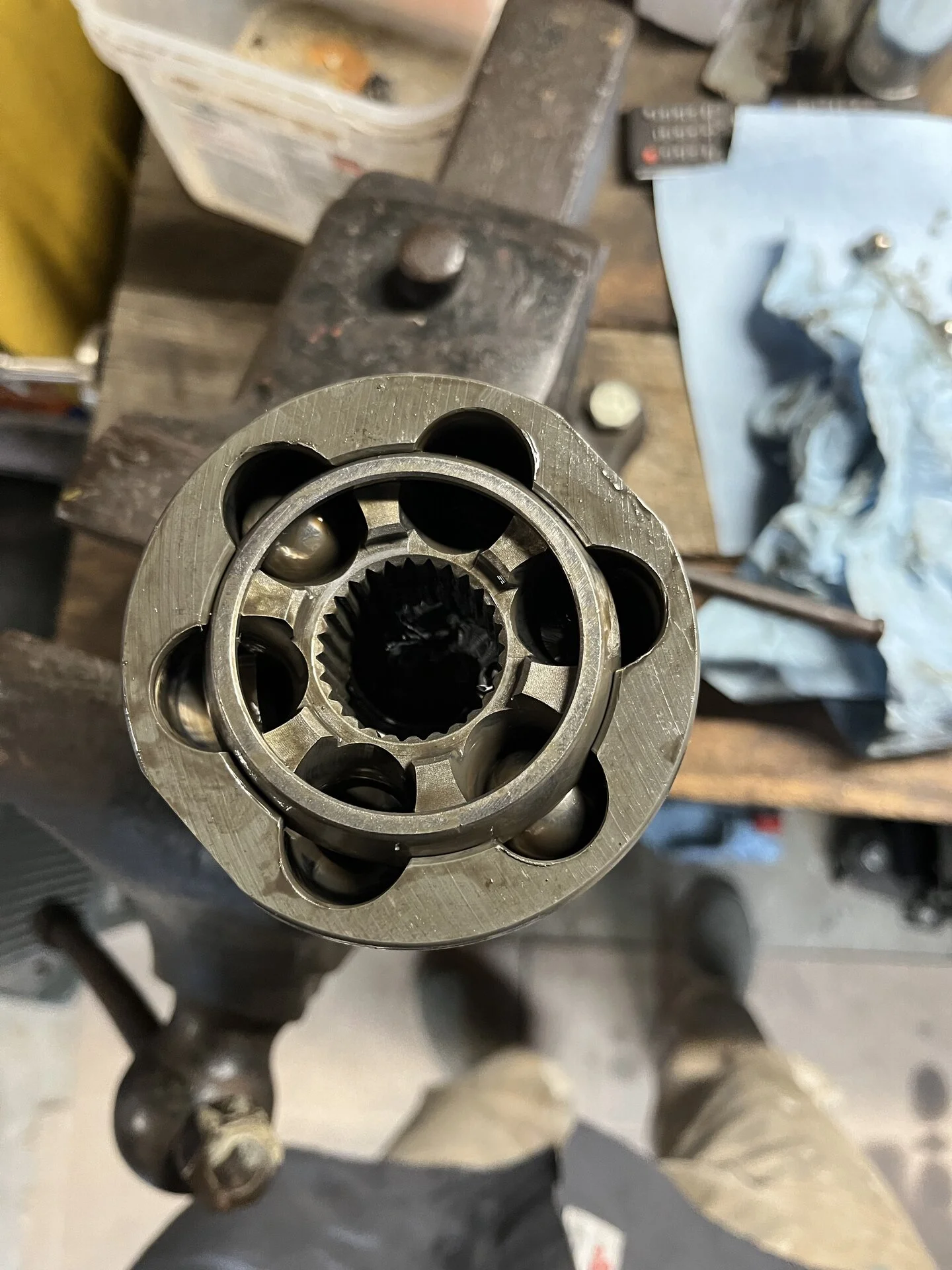

I decided that black Frida was a good day to spend in the garage and enlisted @vfrer and @cruiserguy80 to help do a knuckle job. Two weeks later, all finished. Was about as messy as everyone says, but the attention to detail including torque specs was somewhat new. Came out well though.

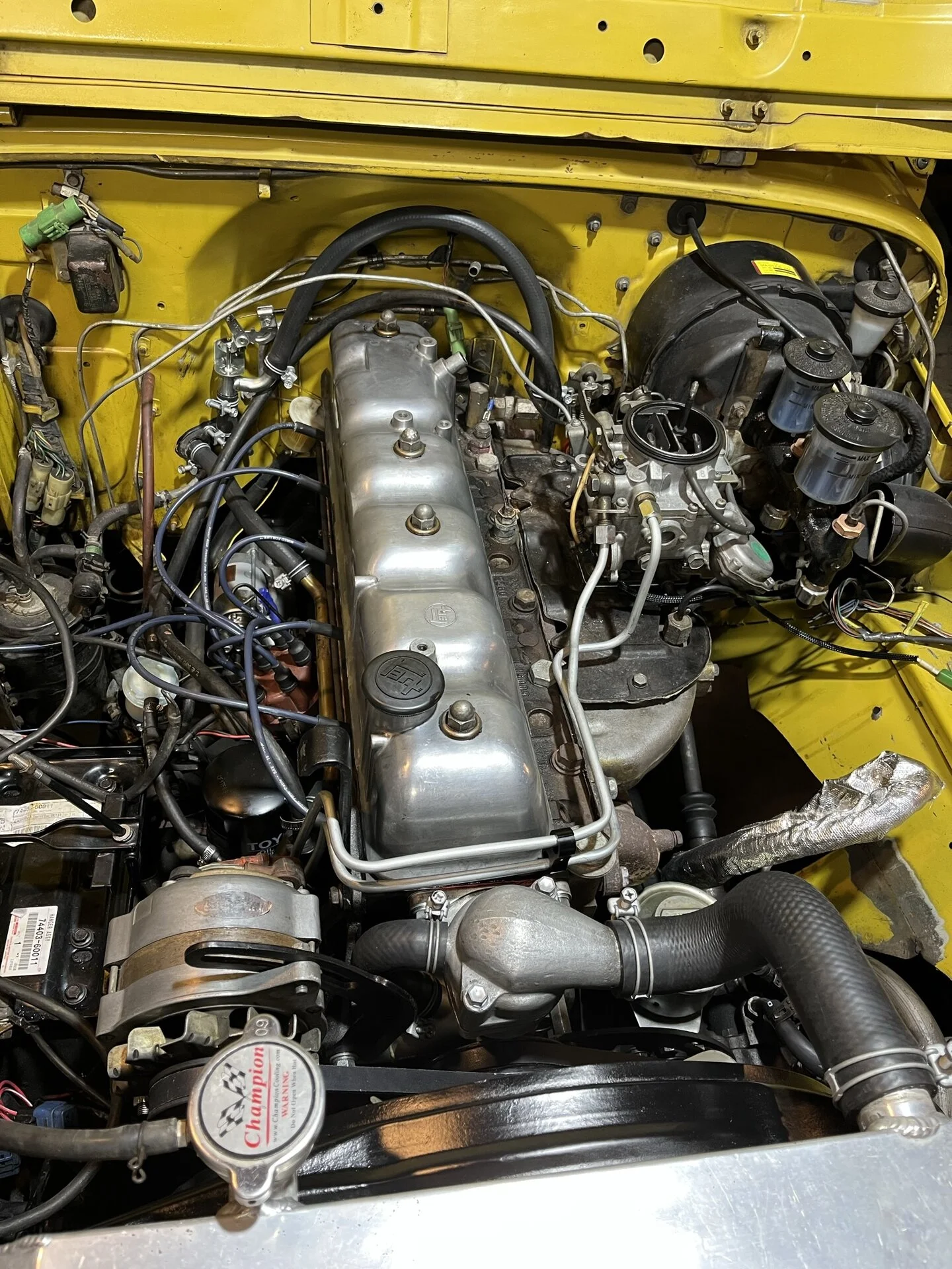

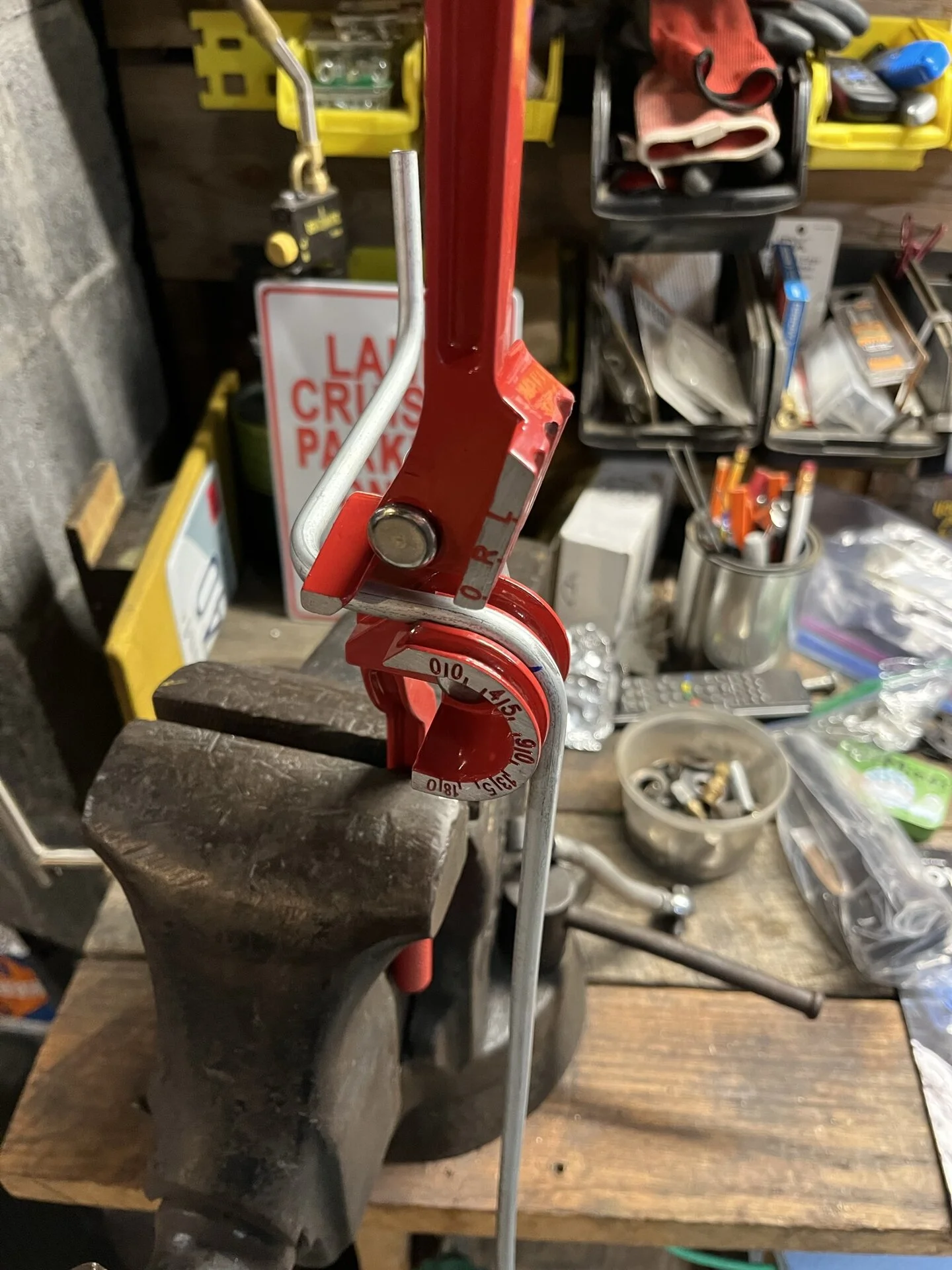

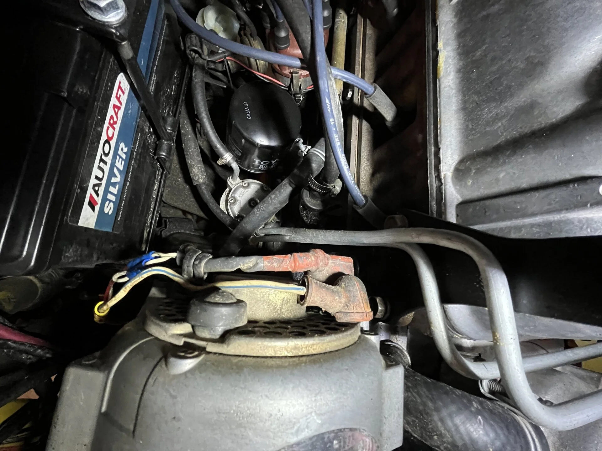

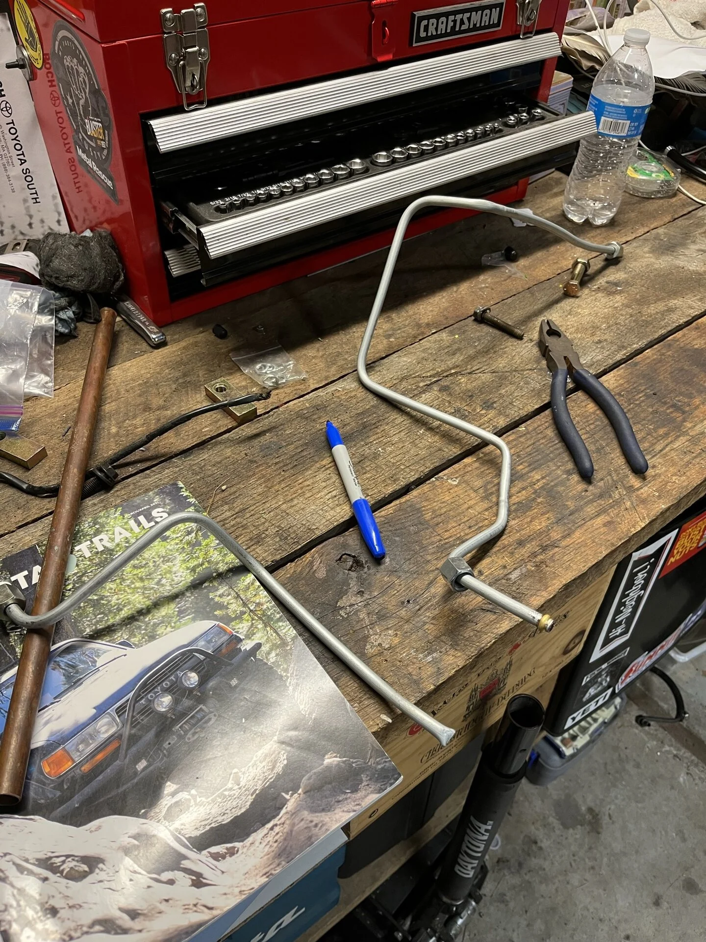

I went to put the air cleaner on last night and realized I needed to re-bend the new hard fuel line. Long story short, I ended up bending three and learning a few things along the way.
Using a vice to hold the bender made it much easier. Perhaps due in part to the fact I sustained a "game-keepers thumb" injury skiing and am down to 9 digits. I had ordered this tubing which is pretty hard to bend. Might have done a different metal if I did it over again. Used a regular plumbing tube cutter to slice it and then sanded the ends a bit to make sure no metal bits get in the fuel system. Used Toyota olives and nut unions for the ends. They don't require a ton of pressure to cinch down (learned the hard way). Using a sharpie to mark where to bend helped. Came out ok in the end and used the original fuel line I bent to become the return. Right now the return doesn't go anywhere, I'll see if I can figure out where it's supposed to go. Previously it was just capped and seemed to work fine.

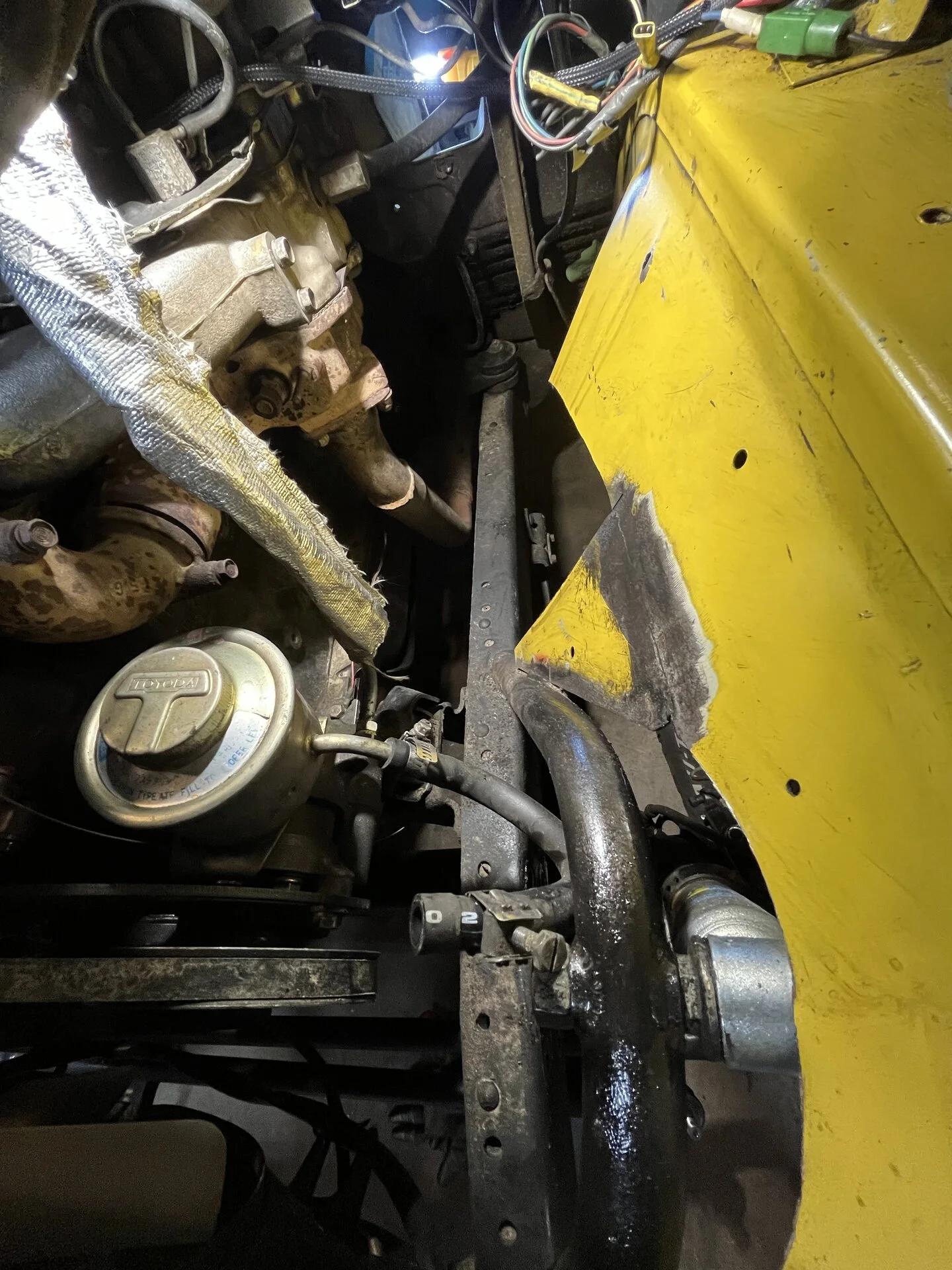

Hi @Goldbug! Where does this new line connect? I have that same line capped off like yours was
I'll take a look when I get home tonight. Fuel line goes from fuel pump to carb, but I'm assuming you're talking about the other line that goes from the carb. I think mine may actually go to an orphan fuel filter, which always seemed odd to me and certainly wouldn't be OEM, but I'll confirm tonight.

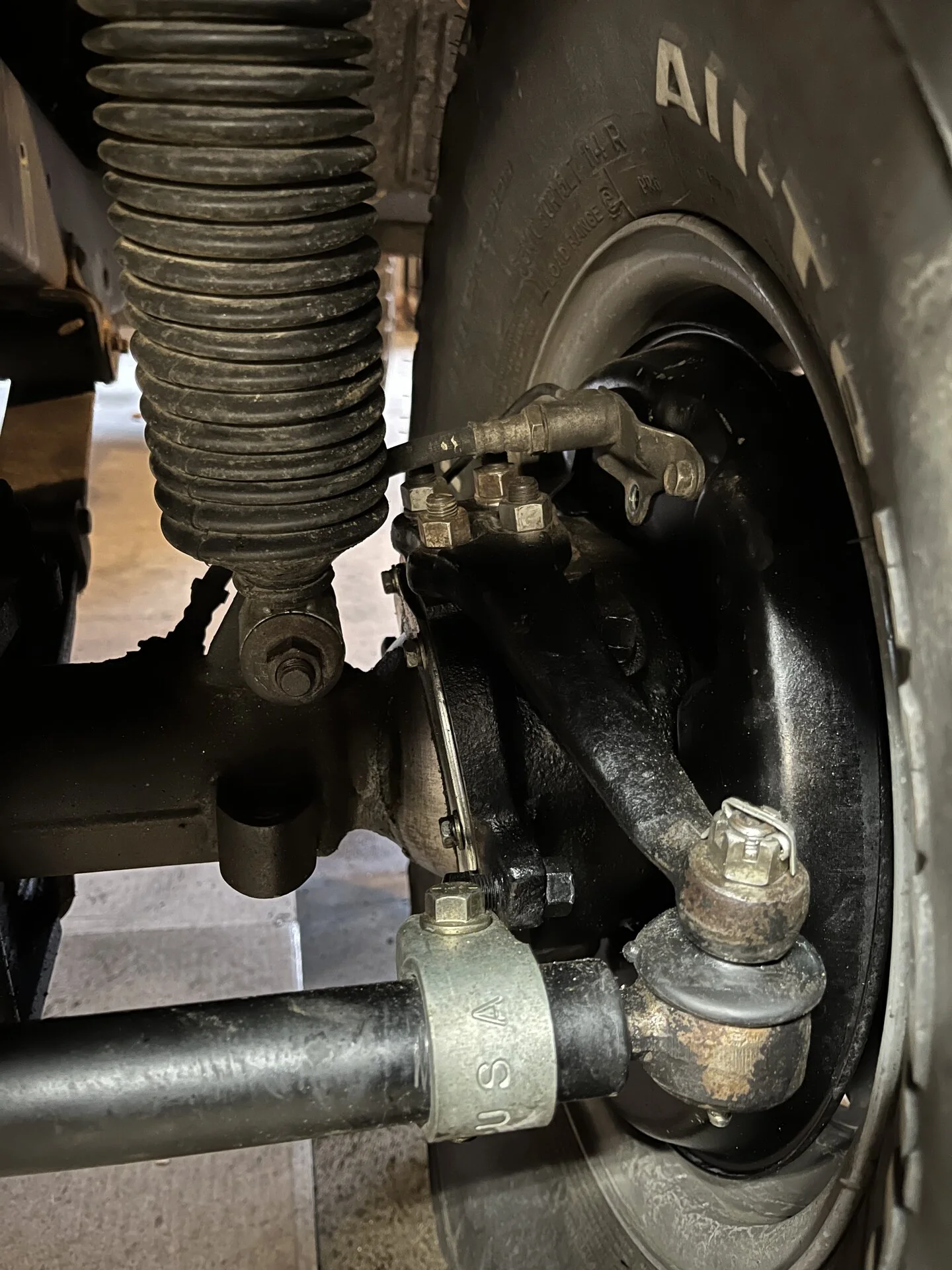

Hey @greenEFSI sorry it took me a bit to get these. My excuse it’s it’s freezing out so not as much incentive to go out to the garage. But I re-ran this pipe when I did all the engine work last winter. It goes by the fuel pump then connects to the hard line on the frame rail below the fuel filter. Here are some pics, though it’s hard to see.
Thank you! I'll save these and get some hardline to bend up 👍

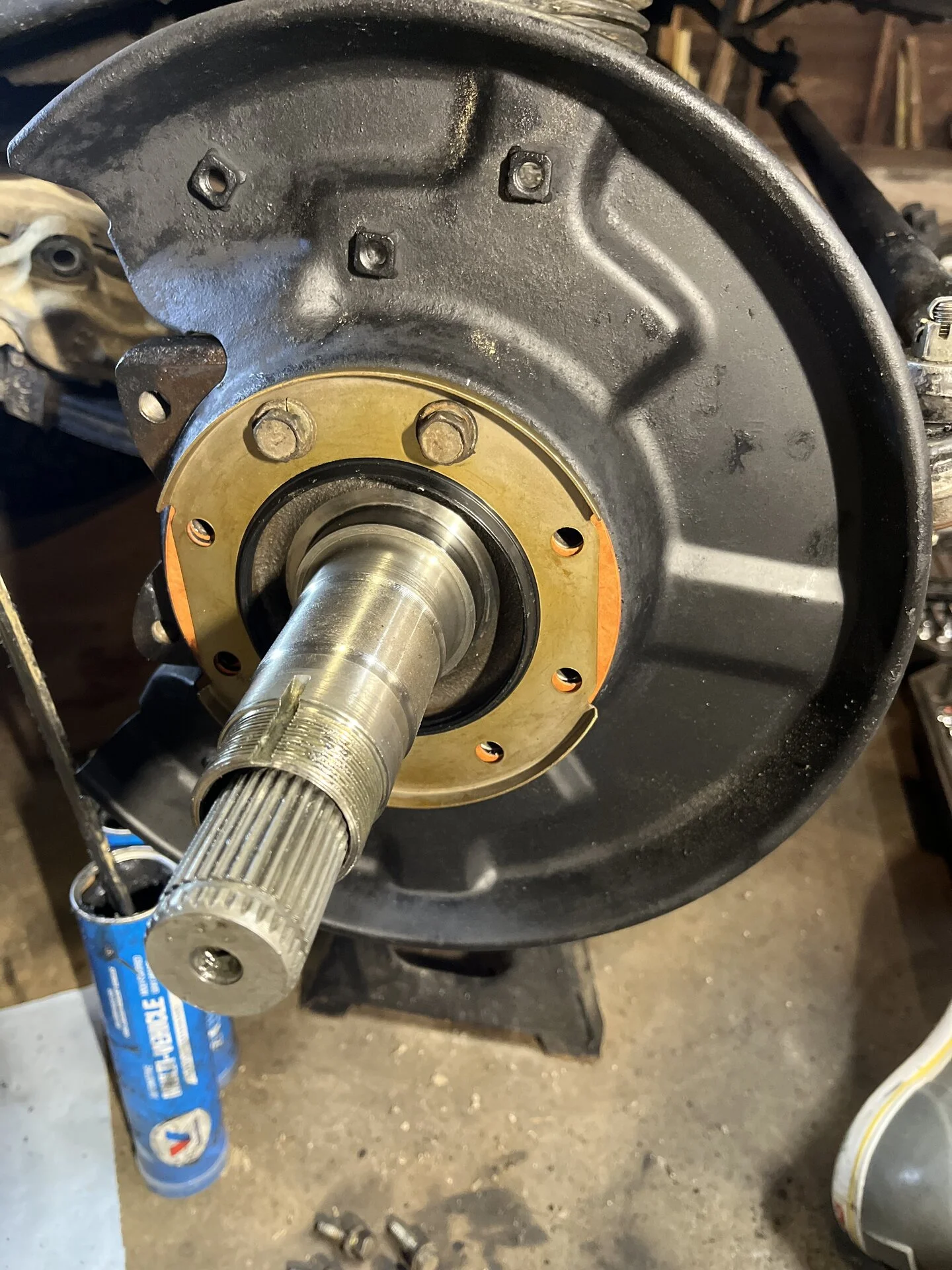

Now that the roads are thoroughly coated in salt, Goldbug will be inside until probably end of March, so I dug in on my next projects:
  1. Get Carb Cooling Fan Working
  2. Get Oil Pressure to Read
  3. Reduce Play in Steering (including rebuilding the FJ60 Steering box)
  4. Get Windshield Washer Working (even though I almost never drive it in the rain)
  5. Get Seatbelts Re-Webbed

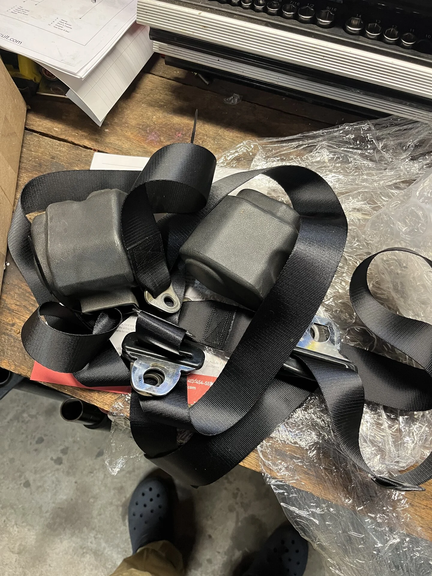

So far I've done a great job taking things apart, and did get the belts back from Safety Restore. They look excellent. Thanks to @pb4ugo on real time support while I disassembled the steering column and got nervous.
