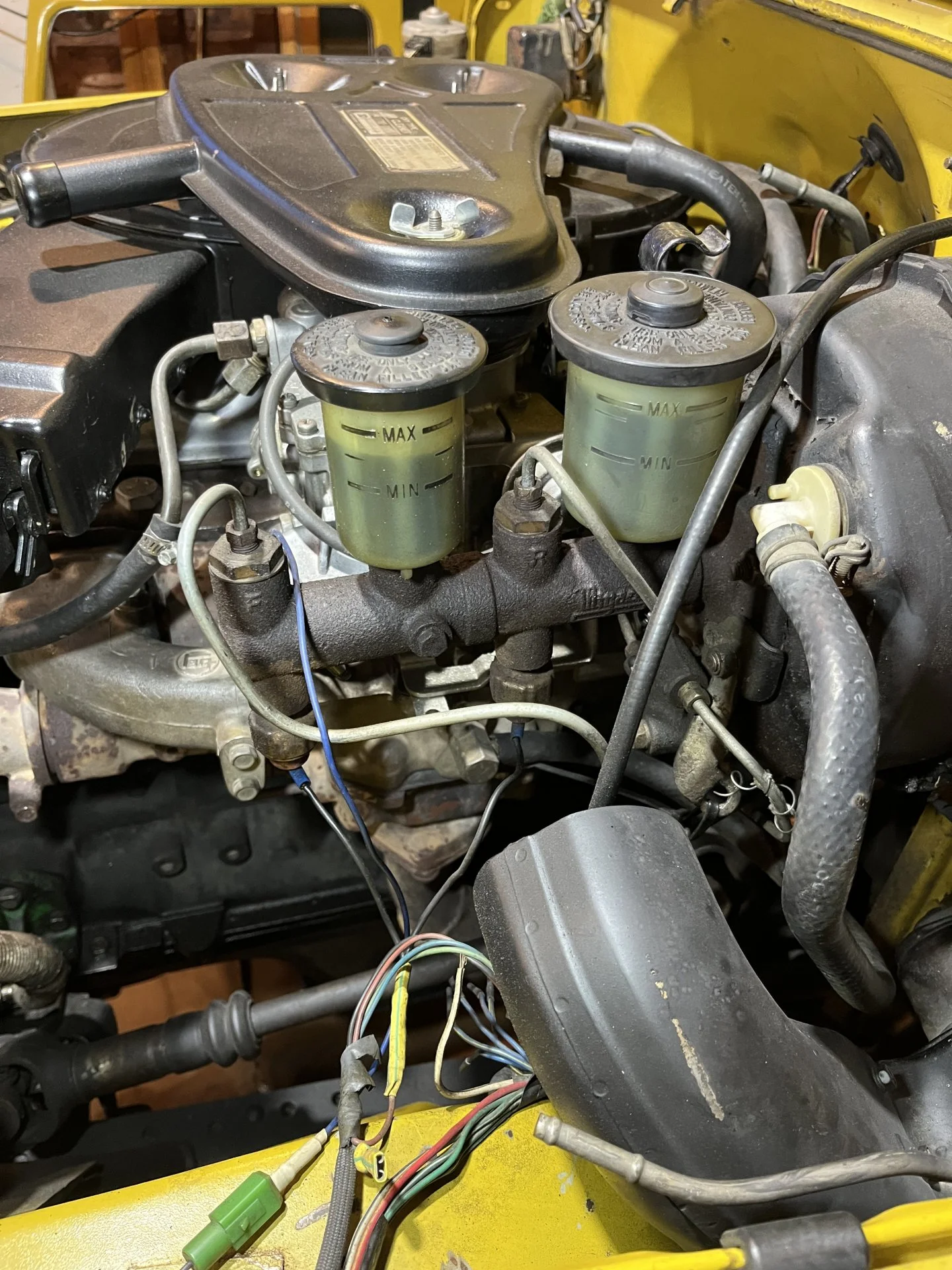

The brakes on Goldbug have never been right. I struggled with the rear drums and the wheel cylinders, first trying to hone and rebuild, then replaced. But Ive always had a ton of travel in the brake pedal and sufficient but not super strong braking. Plus I started to lose a lot of fluid from the master cylinder.
I put in an order to @cruiseroutfit for a new master cylinder, shipped out same day.
It was a late night, but with help from friends and some adjusting the pushrod because I couldn’t get a hold of the special tool, the new master is in and the pedal is MUCH firmer with less travel. And so far, no leaks!

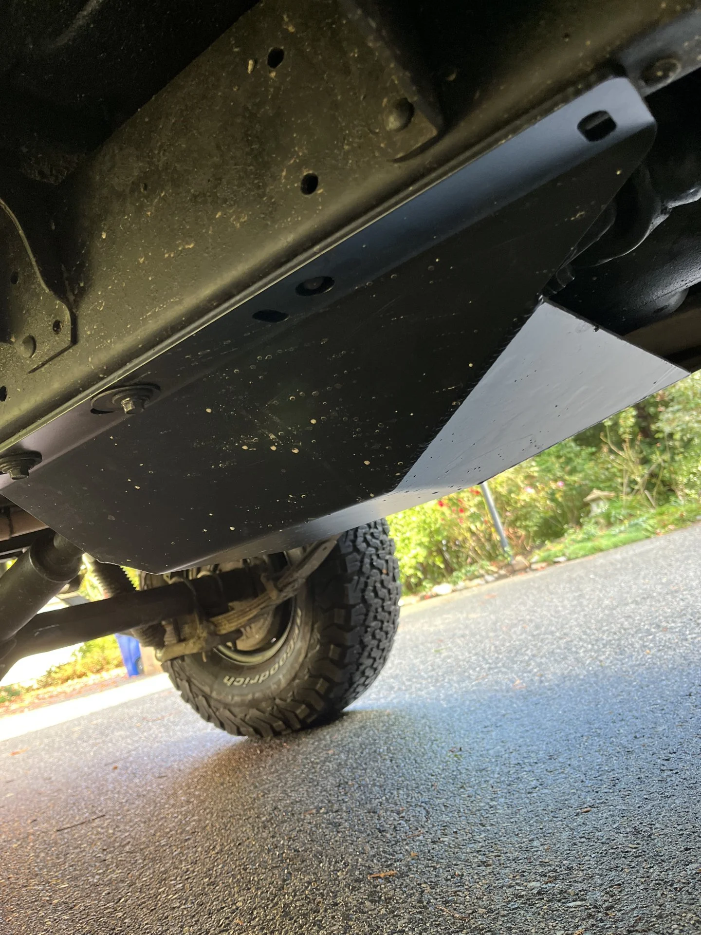

A few weeks ago I did the event that is the highlight of the year for me each time: the Yankee Toys Fall Gathering. 3 days of camping and wheeling and fun. I ordered a new skid plate from Lance at Iron Pig Off Road and he was kind enough to bring it up with him and even help install it. That's service! Had an absolute blast and met tons of other mudders.

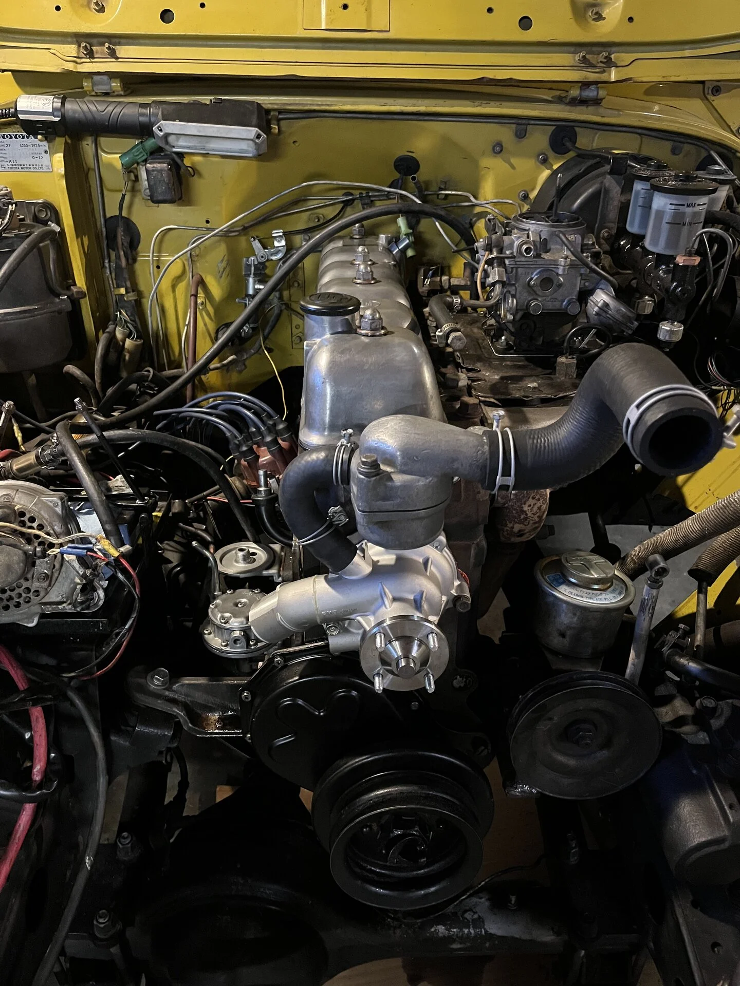

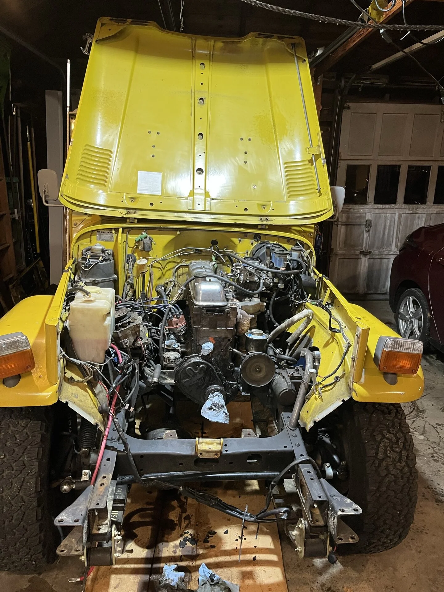

It's that time of year, so I tore apart my perfectly good 40. It's been leaking oil and coolant more and more and the damn power steering/harmonic balancer/alternator whine won't go away. Two things I am determined to resolve.
I ordered up a bunch of OEM gaskets and coolant hoses to reseal the parts of the engine I can get to without pulling it and clean up the coolant stuff at the same time. That was the original plan. Since then, many "while I'm in there" items have been added.
Thus far it's been mainly disassembly, cleaning and parts research and ordering. The list now includes:
Replace engine gaskets with kit from Cruiser Corps and some OEM
New OEM Coolant hoses
New battery cables and lugs and terminals
Replace rubber fuel lines with hard line with this
New OEM thermostat
New water pump from @Racer65
New oil pressure gauge from @Racer65
Install carb heat shield from @cruiserland
Install new 2F harmonic balancer from @cruiserland
Get carb cooling fan to work
Fluid Film, Clean, Polish & Wax

Got the timing cover, timing plate, both gaskets, water pump, fuel pump, side cover gasket, valve cover gasket back on. Re-welded the PS bracket. Next up is trying to improve alignment of the PS and then getting all the coolant hoses in the right spots.
That's the way to do it! Looking really clean in that engine bay wouldn't want it getting all oily.
